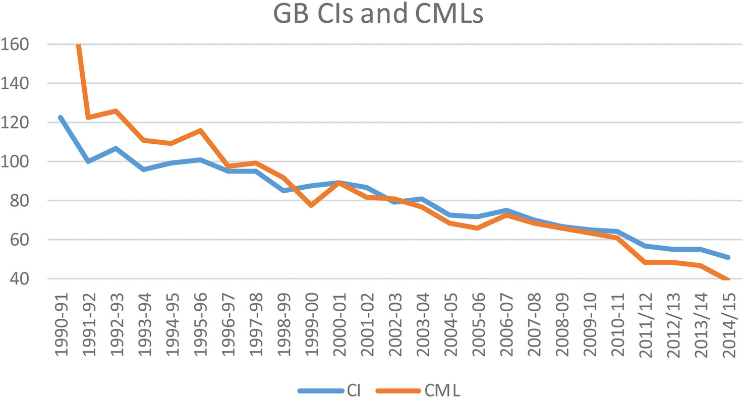

Fig 1 shows the CI and CML improvement from 1990 levels
Fig 1: CI and CML trends post 1990
In the early years of privatisation improvements were mainly due to peer pressure and a new focus and clarity on customer measures. However, this improvement has been maintained, and the last five years show a continuing strong improvement. In part this is due to DNOs installing significantly more system automation. The costs of the automation are not included in DNOs’ RIIO price control allowances, instead DNOs are encouraged to make these investments based on the incentives they earn from performing better.

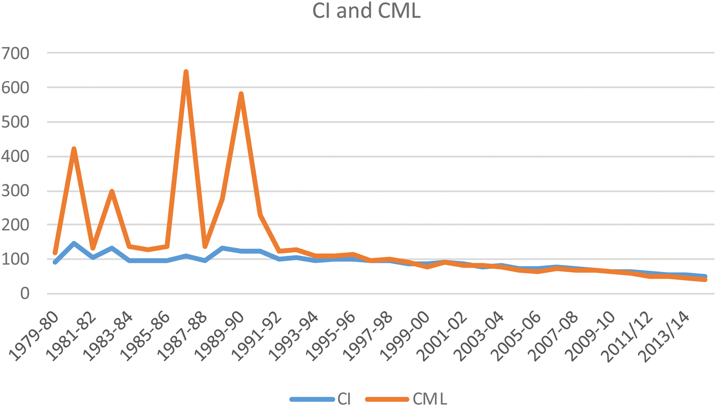

The improvements post privatisation are more stark when compared with the decade prior to privatisation (Fig 2).
Fig 2: CI and CML trends pre and post privatisation
The peaks of CMLs include the hurricane of 1987 and the ice storms of 1990/91. It is worth noting that the severe winter storms of 1997 and 1998 were managed considerably better than periods of historic bad weather in the 1980s, with those two years’ exceptional problems barely visible in the post privatisation data. However, a note of caution is still necessary; it was only with the introduction of the IIS scheme in 2002 that an auditable regime of recording was put in place, and any records before that date could be less accurate.
