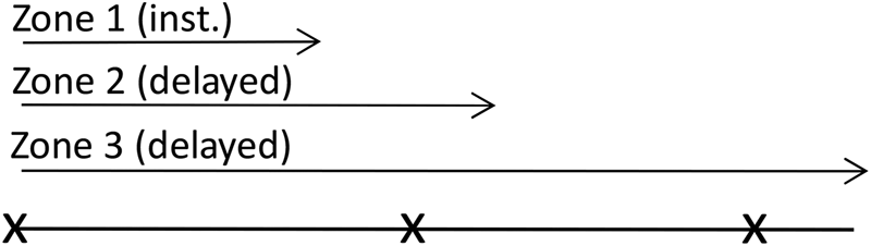

Distance protection – the primary form of protection applied to an interconnected transmission system, allowing fast operation and back-up whilst maintaining adequate discrimination. Correct coordination between distance relays is achieved by controlling the ‘reach’ and tripping times of the various zones.
A conventional distance protection scheme will typically comprise an instantaneous directional element and one or more time delayed elements referred to as ‘zones’.
Discrimination between the protected line sections is achieved by having an instantaneous setting covering (or ‘reaching’) around 80% of the impedance of the first line section (zone 1). This precludes the possibility of overreaching into the second line section, thereby ensuring discrimination with the instantaneous protection on the second line section. A second time-delayed element covering around 120% of the impedance of the first line section (zone 2) ensures complete coverage for the first line section. Remote back-up protection for the second line section will typically be provided by a third element (zone 3) set to cover 120% of the impedance to the remote end of the second line section.

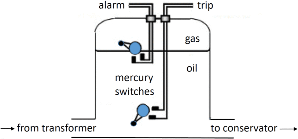

Buchholz protection – is a common form of primary protection for supergrid, grid and primary transformer internal faults. The relay is normally housed in a chamber positioned in the return oil feed from the top of the transformer tank to the conservator.
The Buchholz relay has two modes of operation. A gas alarm will be triggered if sufficient gas accumulates (suggesting an emerging fault condition in the transformer tank) or if the oil level drops below a certain point due perhaps to a leak. It enables early diagnostic assessments to be made (e.g. dissolved gas analysis) and if necessary the transformer to be taken out of service before a potentially catastrophic fault occurs.
A Buchholz surge relay will operate in the event of a short-circuit occurring within the transformer tank, which will initiate a surge of gas and oil, passing through the oil return pipe and the Buchholz chamber, out to an explosion vent. The relay will operate instantaneously to trip the local switchboard transformer incoming circuit breaker, and trigger the substation tripping relay to initiate either an intertrip signal or a FTS operation to trip the remote source circuit breaker. It will be evident from the diagram adjacent that, in the event of the oil level falling sufficiently to operate the lower mercury switch, this will also trigger the substation tripping relay (Fig 1).
Fig 1: Buchholz relay

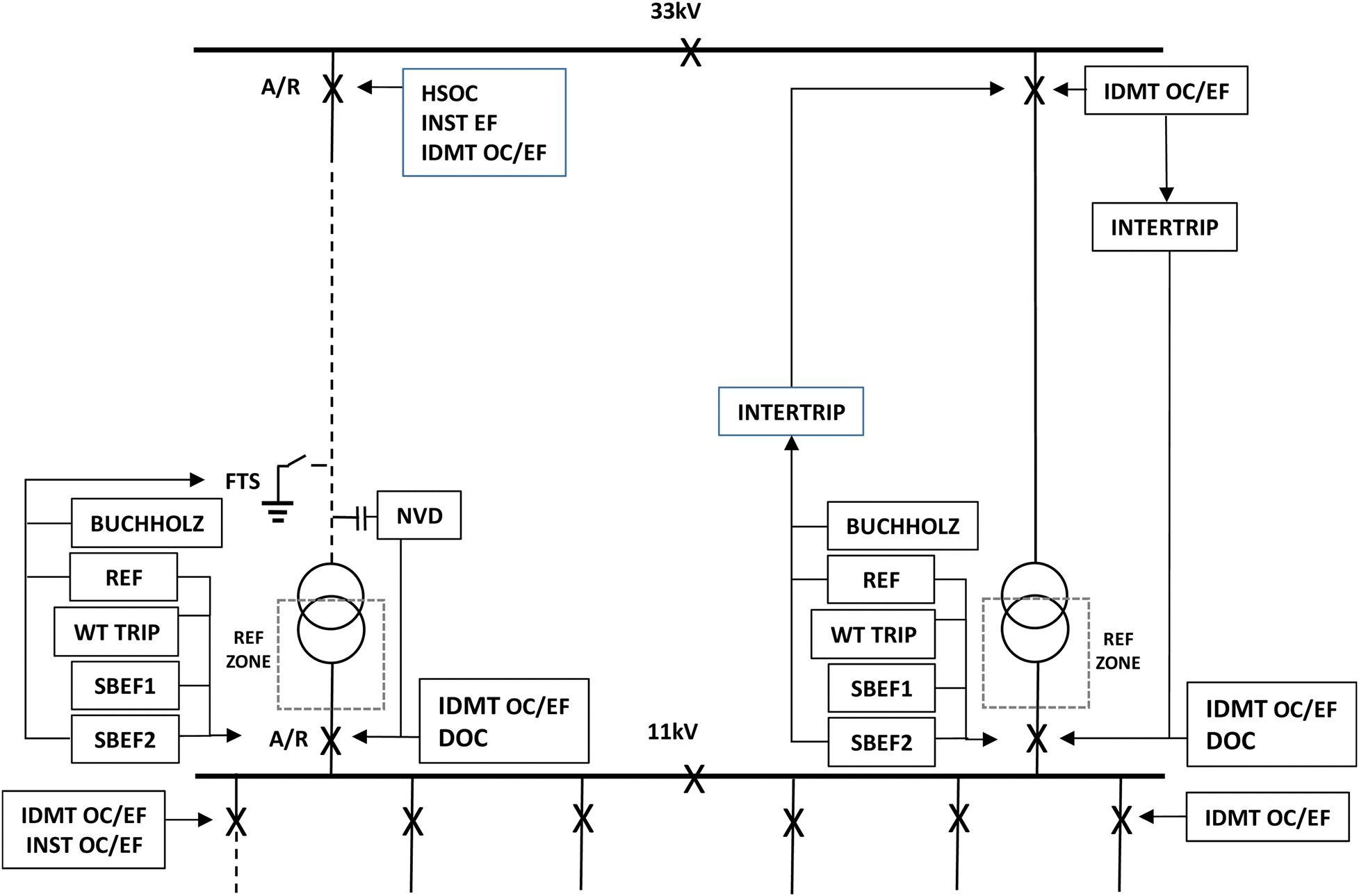

Overall protection schemes
Having taken a look at the most common forms of protection, this section looks at typical overall protection schemes. Note that network companies will have their own standard protection schemes which may differ in detail to the examples shown.
Fig 2 is a simplified block diagram of a typical overall protection scheme for a 33/11 kV primary substation served by two transformer feeders (in this case one overhead and one underground). Note that some components have been omitted or simplified to avoid cluttering the diagram, for example ‘intertrip send’ and ‘intertrip receive’ relays have been omitted as have various alarms such as Buchholz gas, tapchanger out-of-step, winding temperature, etc.
Fig 2: Simplified protection block diagram for a primary substation served by two transformer feeders

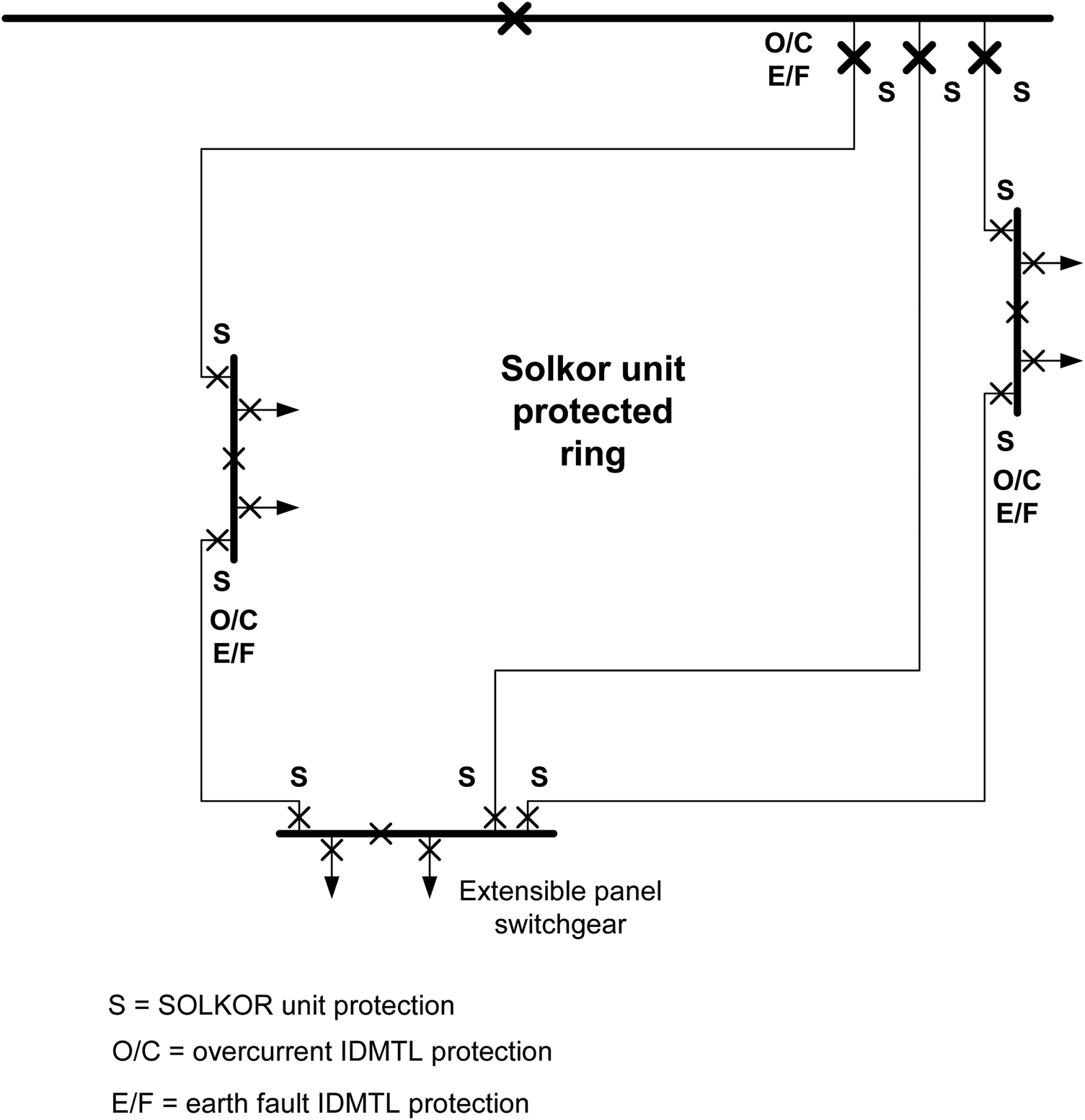

Circuit unit protection
Whilst, as described in the previous section, most 11 kV feeders are protected through IDMT OC and EF protection (along with INST OC and EF2 in the case of overhead line feeders protected by auto-reclose circuit breakers) there are circumstances where a higher level of security than required by ER P2 (see parts 1 and 2 of the guide) is needed by customers due to the sensitive nature of their business.
Fig 3 depicts a unit protected ring. In the event of a fault anywhere on the ring, the circuit breakers at each end of the faulted section of cable at the two adjacent substations will trip – isolating the fault at both ends without any interruption of supply to customers served by the three substations forming the ring. The means of detecting a fault is by comparing the current entering each section of cable at one substation with the current exiting that same cable at the next substation.
Fig 3: Solkor unit-protected ring
It will be evident from Fig 3 that under healthy conditions, for any section of cable, the current flow will be in the same direction and the two measurements will be equal. In the event of a cable fault, the currents entering the faulted section of cable at each end of the cable will be in opposite directions.
For all other sections of cable, although the current flowing under fault conditions will be very much higher, the direction and magnitude of the current flow at each end of the healthy section of cable will remain the same.
The means of comparing current flow and direction is by use of current transformers fitted to the circuit breakers connected at each end of each cable section, and through pilot cables connected between each substation.
Under normal healthy conditions, the CT secondary currents entering each end of pilot cable section will balance. However, in the event of a fault, the currents entering the pilot cables from each end of the faulted cable section will not balance. This imbalance is detected by a relay at each circuit breaker initiating a circuit breaker trip at each end of the cable section.

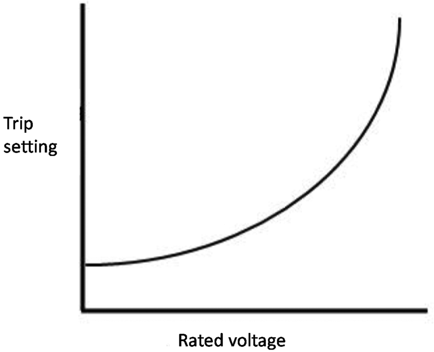

Voltage dependent and voltage controlled overcurrent protection
Overcurrent protection is a further important component of an overall generator protection scheme designed to trip the generator in the event of a line–line fault. However, an initial high fault current will cause the generator voltage to drop, so decaying the fault current potentially below the relay setting. To overcome this, voltage dependent relays incorporate a bias which progressively decreases the overcurrent setting if there is a voltage drop.
A variation on the voltage dependent relay is the voltage controlled relay which has both an under voltage setting and an overcurrent setting which is less than the rated current of the generator. The relay will operate only if the under voltage and overcurrent elements operate at the same time – i.e. in the event of a fault.

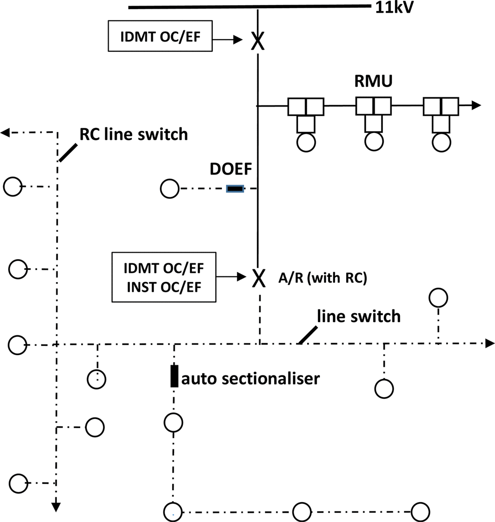

Fig 4 represents a fairly traditional arrangement for a rural 11 kV feeder protected at source by a primary substation circuit breaker. The first section out of the primary is underground cable serving a local underground distributor but with a short overhead line spur protected by drop-out expulsion fuses. The source circuit breaker protection will discriminate with these fuses so that in the event of a fault on the spur the fuse would clear the fault and the main circuit would remain energised.
Fig 4: Traditional arrangement for a rural HV system
Further along the feeder the circuit changes from underground to overhead construction. At this point an auto-reclosing circuit breaker is installed. Again the source circuit breaker protection will discriminate with the auto-reclosing circuit breaker (ARCB) so that transient or sustained faults beyond the ARCB will be cleared by the ARCB leaving the upstream main circuit energised.
In the event of a fault, the ARCB will follow a sequence of auto-reclose attempts to restore the circuit. If the fault is transient, then all supplies will be restored when the ARCB recloses. If the fault is sustained, and on the main line, the ARCB will lock out. If, however, the sustained fault is on the spur protected by the automatic sectionaliser, then the ARCB and auto sectionaliser will co-ordinate – i.e. the auto sectionaliser3will isolate the spur and the ARCB will then successfully reclose energising the remainder of the overhead line circuit.

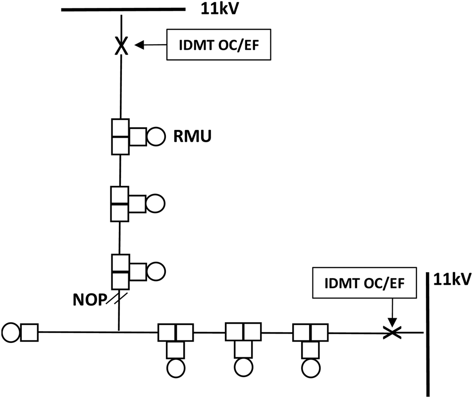

Fig 5 is a typical (albeit simplified) arrangement for an urban or suburban electricity system supplied by underground cables. Distribution substations along the feeder are predominantly based on ring main units (RMUs) but with a number of tees. The feeder is protected by a source circuit breaker with IDMT OC & EF protection and has a normal open point (NOP) which it shares with an adjacent feeder to form an ‘open’ ring.
Fig 5: Traditional arrangement for an urban HV system
It will be apparent from Fig 5 that in the event of a fault on any part of the open ring system, the faulted section can be isolated by use of the RMU ring switches, and supplies subsequently restored by reclosing the tripped circuit breaker at the primary substation and the NOP.
In the event that the fault occurs on a teed section of cable, then the supplies served by the affected substation can often be restored from an adjacent substation through LV backfeeds (i.e. inserting links in link boxes). In some cases, where the LV backfeed is insufficient or non-existent, a mobile generation unit might be deployed.
In this way, the design permits compliance with the ER P2 capability requirement for a class B demand group to restore supplies within 3 hours (i.e. through manual switching). Substation capacity and demand on any teed section will normally be limited to 1 MW (i.e. class A demand group) in order not to infringe the ER P2 3-hour restoration requirement. An exception might be where the tee supplies a single industrial or commercial customer who has elected to accept the higher supply security risk in favour of a lower connection charge.
It follows that attention to overall network loading is necessary to ensure that the ‘alternative circuit’ is able to meet the full demand of the faulted circuit in the event of a fault occurring on the first section from the primary substation.
To aid identification of the faulted section of a feeder in the event of a circuit breaker trip, it is common practice to install fault passage indicators at each RMU. The fault passage indicator will indicate whether or not fault current has passed, and by process of elimination the faulted section can be determined.

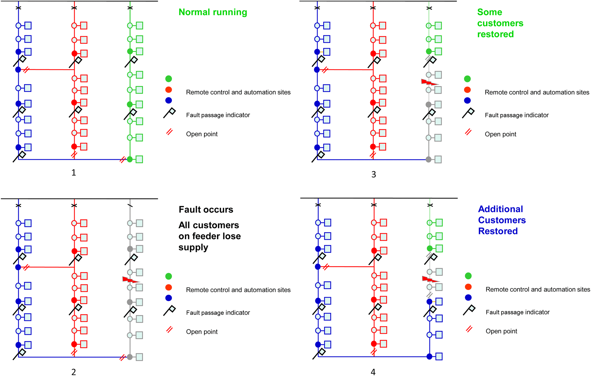

Remote control and automation
Given the now strong regulatory incentive regarding quality of supply (see section on Quality of Supply in part 2 of the guide) DNOs are now extensively applying remote control and automation to their 11 kV networks (since 11 kV faults account for the great majority of customer interruptions and ‘minutes lost’ (CIs and CMLs). RMUs equipped with remotely controlled ring switches are now common, and these will often now form part of an automation scheme.
Switching by remote control will restore supplies far more quickly than by manual switching, hence reducing the CML impact of the fault. However, an automation sequence which completes within 3 min of the fault occurring will also reduce the CI impact as any interruption of less than 3 min is not counted as a CI under the regulatory quality of supply incentive.
Fig 6 demonstrates a typical automated supply restoration sequence for an urban network.
Fig 6: Urban network automation sequence
Remote control and automation is not unique to urban systems; it is now commonplace to apply similar schemes to rural systems (such as depicted in Fig 4) using remotely controlled auto-reclosers and sectionalisers. Such schemes will combine the benefits of automatic restoration for transient faults with the ability to rapidly isolate the faulted line section (or spur) in the event of a sustained fault. Automation of the switching sequence will enable restoration of supplies to all but the isolated section within 3 min.
