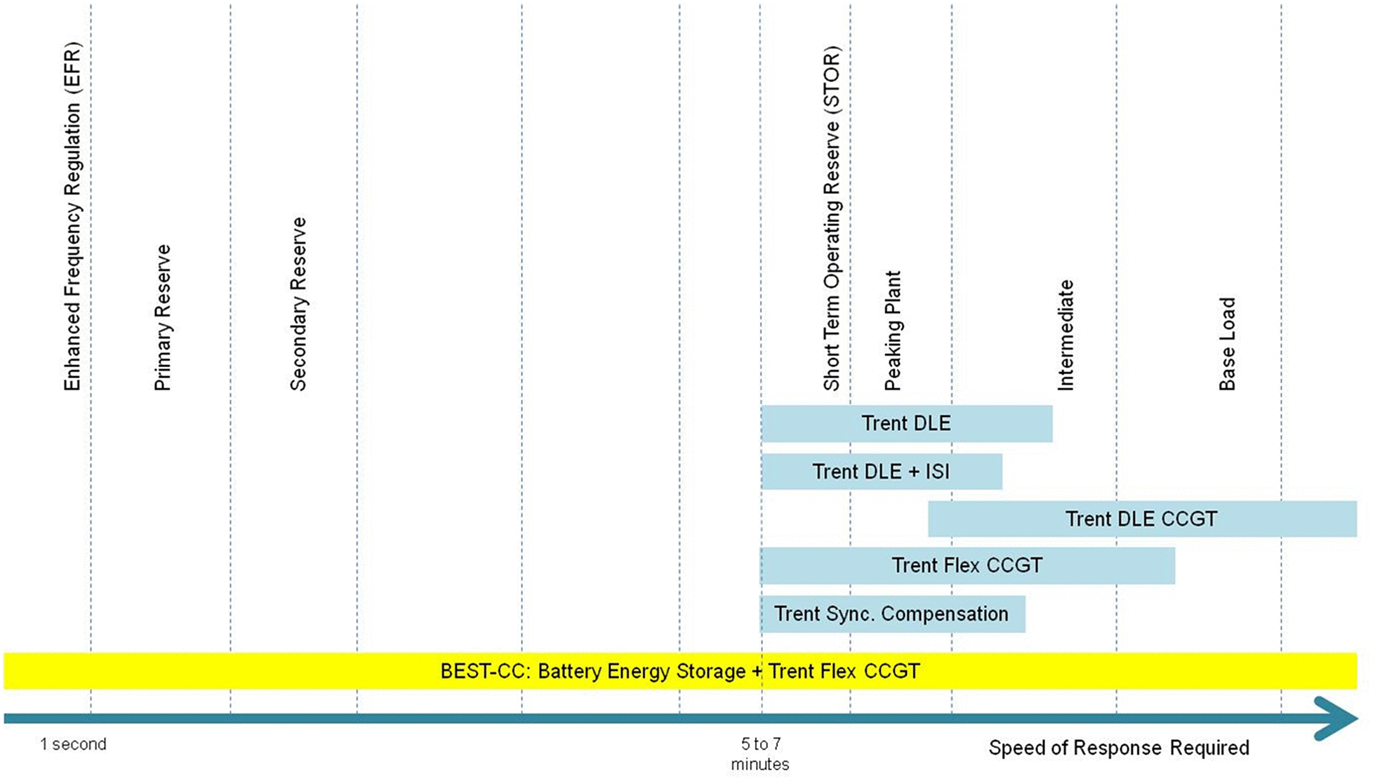

As mentioned previously, an increasing penetration of variable renewable generation requires more flexible plant to compensate volatility and maintain grid stability. In this instance, flexible means resistant to multiple start-ups and shut-downs per day. However, start times and power supply requirements for starting GTs vary greatly. For example, aero-derivative industrial GTs require low starting power (350 kW for the 50 MW Industrial Trent 60), whereas it is closer to 2200 kW for a single shaft industrial GT [ ] of similar output and this would have a significant impact on the sizing and cost of the battery storage system (between £300/kW and £500/kW) [ ]. Therefore, it is important to ensure the most economical and technically feasible combination.
A BESS+DG may be considered a more flexible option due to concern that too many GT start attempts (due to GT combustion chamber burning problems, etc.) could deplete the battery storage. However, this paper is based on an industrial aero-derivative GT that have >99% reliability [ ] and negligible starting load versus the large battery capacity (Fig.  ).
Fig 3: Example of varying start-up times for GTs compared with the requirements of UK grid services

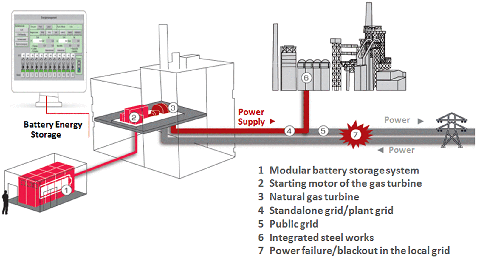

In 2014, Siemens delivered a turnkey BESS project to Vulkan Energiewirtschaft Oderbrücke GmbH (VEO) to ensure the black-start capability of a 40 MW GT at the Eisenhüttenstadt power plant that supplies electricity and heat to the ArcelorMittal Eisenhüttenstadt GmbH (AMEH) steel mill.
VEO is responsible for the operation and maintenance of all electrical networks at the plant. The gas-fired power plant has an installed electrical capacity of 153 MW. AMEH operates the largest integrated steel and rolling mill in eastern Germany at this location, with a closed metallurgical cycle comprising iron works, converter steel mill, hot rolling mill and cold rolling mill as well as various galvanising and finishing plants.
In the case of failure or a severe black-out of the local 110 kV distribution network, VEO's power plant switches over to island mode to continue supply to the site. This island network keeps the critical production processes at the AMEH steel mill operating, and thus prevents consequential damage, which could cost millions of Euros (Fig.  ).
Fig 4: Example of VEO plant interaction with the BESS
Switching a running GT plant from grid connection to island mode is not an easy task and because testing is impossible during normal operation there remains a risk of failure. To mitigate this risk, the black-start functionality provides assurance against extended outages that would result in large consequential losses.
To start the stand-by GT from a de-energised state, a starting motor is used to bring the turbine up to speed. Under normal conditions, this starting motor requires power from the grid. However, this power would not be available in the event of a grid outage. Therefore, the BESS is now used to provide the power supply, thus ensuring reliability. The BESS at VEO uses lithium-ion batteries and has a power rating of 2.8 MVA/1.2 MW and a capacity of 1080 kWh.
This solution guarantees the black-start capability of the gas-fired power plant at any time and ensures the power supply in the event of failure of the upstream 110 kV distribution network.
Having the storage facility located at the power plant not only enables the plant operator to have secure and reliable black-start capability but also means that the plant can now participate in the primary reserve market and attract additional revenues.

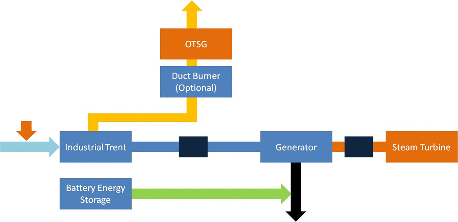

Fig.  shows the operation of a typical CCGT configuration as used in peaking/cycling applications, combined with BESS to provide ultra-fast response and ultra-flexible operation.
Fig 5: Process flowchart of flexible CCGT
Standard CCGT operation can be enhanced in the following ways to make the plant more flexible:
  • Addition of inlet spray inter-cooling to boost power output (optional).
  • Flexible, fast-start CCGT using single shaft concept with double end drive alternator to boost power during peak periods, and to enable higher fuel efficiency for longer periods of operation, with full combined cycle power output available within 30 min.
  • Addition of BESS to enable black-start capability of the gas GT, allow instantaneous response to grid demand for balancing; providing 100% station output power until GT or CCGT starts up, with option for additional power during peak periods.
  • BESS recharged by power plant, during run down at end of operation period or by grid at times of low power prices.
  • Optional addition of duct burner and larger ST to boost power output of ST during peak periods.
  • Optional addition of clutch between GT and alternator to enable plant to operate as synchronous condenser to provide voltage regulation.

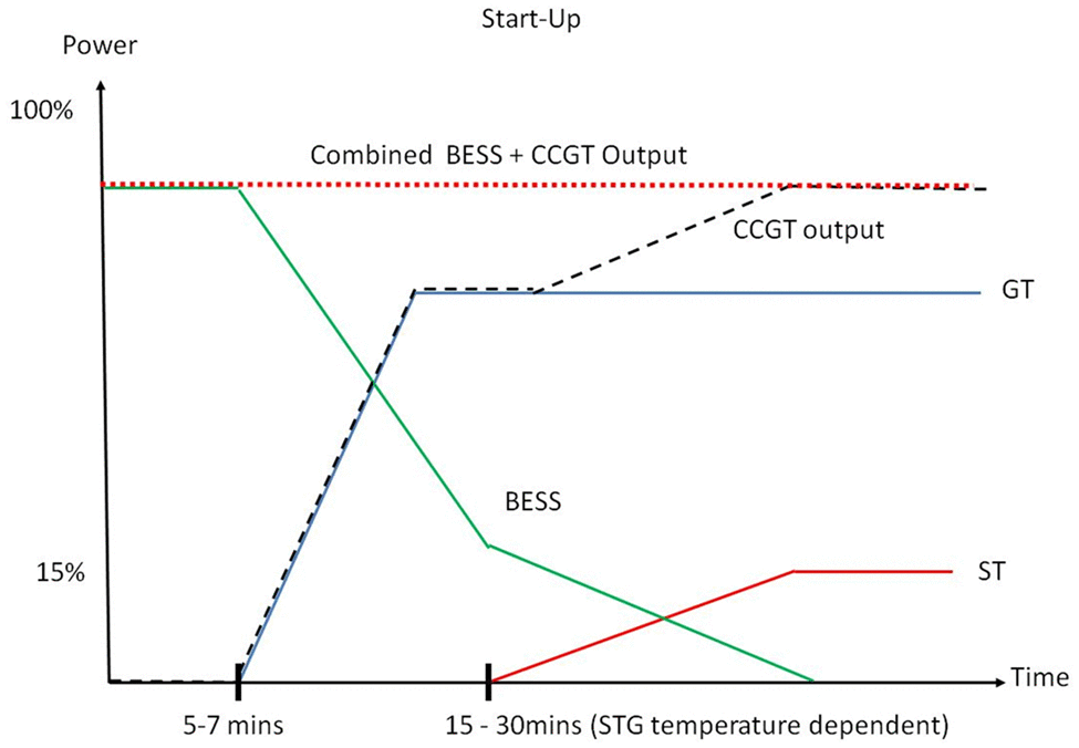

The timing diagram in Fig.  shows the optimal starting sequence for a CCGT plant based on an industrial GT and how the BESS could support almost instantaneous start-up; allowing the plant to participate in higher-paying/faster grid services.
Fig 6: Example of start-up sequence for GT and ST and ramp-up to meet peak demand

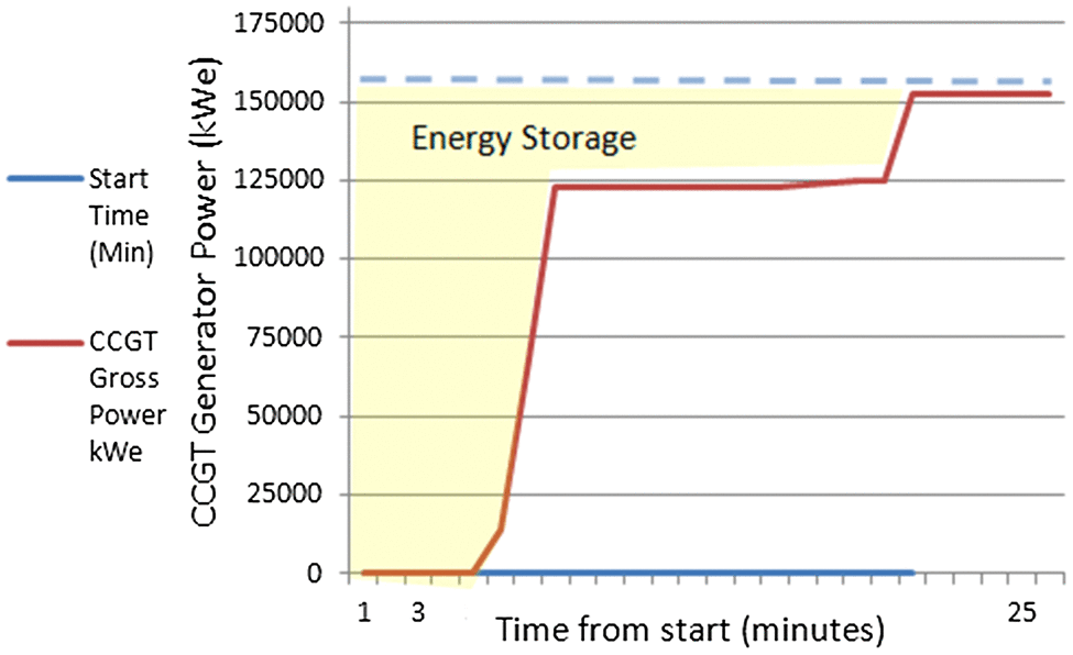

The BESS capacity requirement considering the combined start-up needs of the CCGT is shown in Fig.  7 . The hot-start sequence represents a 2 + 1 configuration using an industrial TRENT 60 GT with a once-through steam generator and Dresser-Rand ST with a total rated capacity of 150 MW.
Fig 7: Example of energy storage capacity requirements
Note: For this example, hot-start means running up again, e.g. after midday downturn due to photo-voltaic, warm-start means running up after an overnight downturn and cold-start means start-up after a weekend downturn. Warm-start moves the knee-point to the right by 10 min and cold-start by 40 min.
