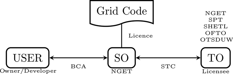

The responsibilities for ensuring harmonic compliance are embodied in the codes of the relevant country. The main parties involved in the compliance of wind farms in the UK are shown in Fig 1 along with an indication of the contractual mechanisms through which harmonic compliance is secured.
Fig 1: Contractual relations between the main parties involved in wind farm developments
The responsibilities for harmonic compliance in the UK are set out in the Grid Code [1] and the SO/TO Code (STC) [2]. The Grid Code applies to users of the system and to the SO, which is National Grid Electricity Transmission plc (NGET). The wind farm developer/owner is a user and the two are bound by a Bilateral Connection Agreement (BCA) through which NGET places requirements on the user to comply with the Grid Code. The STC is the mechanism through which the SO places obligations upon each TO in order to ensure that the Grid Code requirements are met.
Harmonic compliance is secured at the planning and design stage of a user connection by reference to the planning levels of Engineering Recommendation (ER) G5/4-1 [3]. These planning levels are either equal to or more stringent than the compatibility levels, also documented in ER G5/4-1, with which the SO is obliged to comply within operational timescales.
For harmonic compliance, Section K of the STC stipulates that, when planning and developing its transmission system, a TO shall ensure that their system complies with the minimum technical, design and operational criteria and performance requirements set out, or referred to, in the Grid Code Section CC 6.1.5; this in turn refers to ER G5/4-1. Through this mechanism, the responsibility for compliance within planning timescales is transferred to the host TO with ER G5/4-1 established as the standard against which compliance is assessed.
The host TO must perform a harmonic assessment, based upon the plant details submitted by the user, to ensure that the system is planned in compliance with the planning levels set out in ER G5/4-1. The users are obliged by the Grid Code to submit their plant data to enable the host TO to carry out the necessary system studies. The host TO can, but is not obliged to, adopt the methodology set out in ER G5/4-1 to ensure that planning levels are not exceeded by the connection. This responsibility extends beyond the PCC into all other transmission and distribution networks to the extent that they are affected by the connection. To exemplify this point, an Offshore TO (OFTO) is required to study the effect of a wind farm connecting to its network on the onshore transmission and distribution system, as well as other offshore networks, to ensure the continued compliance of all affected substations. Alternative methodologies must be agreed with the SO because the operational compliance is dependent on appropriate planning standards being followed.
On completion of the harmonic assessment, the host TO will submit a corresponding harmonic performance specification to the SO to complement the relevant BCA. The SO may either adopt the specification directly or modify the specification according to its own criteria so as not to prejudice existing or future connections while being fair to the user. The user is obliged to comply with the specification which might imply a need for harmonic filtering at the PCC. It is normal practice for the host TO to carry out harmonic monitoring prior to and post energisation of any wind farm installation. Pre-energisation monitoring is carried out to establish a baseline of distortion for any subsequent investigation into non-compliance on the system.

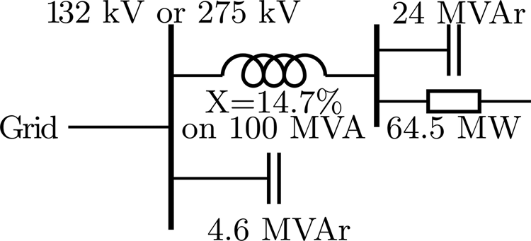

As part of the UK offshore transmission regime introduced by OFGEM in 2009, a scenario has arisen where the wind farm developers are responsible for the construction of the associated offshore transmission assets, with a view to transfer them to an OFTO upon completion through a tendering process. In this instance, the wind farm developer acts as the host TO in a role referred to as an Offshore Transmission System Development User Works party and is thus bound by the same codes as any other TO.

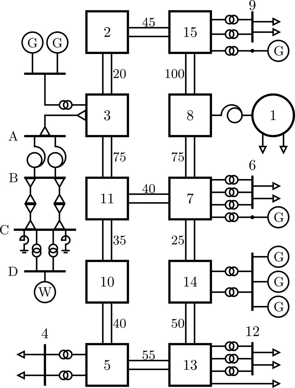

To demonstrate these consequences, consider Fig. 2 which is used to investigate the effects of a 250 MW wind farm connection using 132 kV AC export infrastructure. The model is derived using typical values based on the transmission system of England and Wales, the data for which is presented in the Appendix.
Fig 2: System model under investigation with the PCC at Substation 3

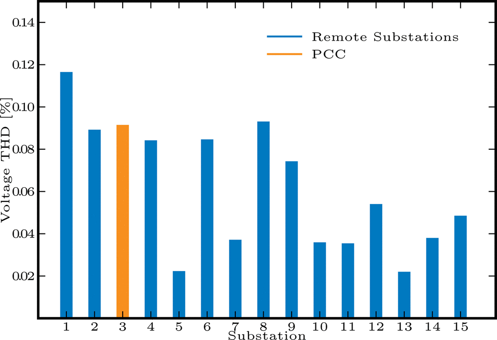

Fig 3 illustrates the percentage voltage total harmonic distortion evident at each of the remote substations resulting from these wind farm emissions alone. This illustrates the propagation of harmonics from the wind farm installation through to the remote substations. The incremental distortion at the PCC is 0.090% while the maximum transfer is 0.117% through to Substation 1. A significant transfer through to a remote substation will necessitate a limitation on the incremental individual harmonic voltage distortion (IHDv) permissible at the PCC, based on a limiting aggregate harmonic distortion at the remote node.
Fig 3: Propagation of wind farm harmonics through the network

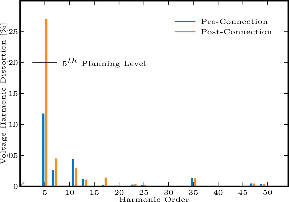

Fig 4 illustrates the simulated pre- and post-connection voltage IHD at the PCC, without the emissions from the wind farm being considered. This represents the modification of the existing background through the modification of the system impedances.
Fig 4: Modification of background voltage IHD at substation 3 (PCC)
For all harmonics below the 50th order, the pre-connection scenario is compliant with ER G5/4-1; post-connection, the 17th harmonic order is non-compliant at the PCC for which the planning level is 0.5%. For the specific modification shown for h = 17, (1) shows the corresponding percentage change in the reduced bus impedance matrix. This relates the PCC to the substations at which harmonic current emissions are known (or would be measured on a physical system). From this matrix, it is possible to inspect which transfers are most affected by the connection of the wind farm.
(1)
For the purposes of the modification of the PCC harmonic compliance, inspection of the row indicated by shows a 340% increase in the transfer impedances from harmonic injections emanating from substations marked by , where # represents the substation number. Using both the impedance and harmonic current phasors, it can be shown that this impedance matrix modification at the 17th harmonic order corresponds well to the pre- and post-connection levels of 0.32 and 1.11%, respectively, as shown in Fig 4 .

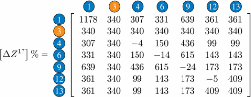

Modification of background levels at remote substations
Although most assessments of background modification only consider the modification at the PCC, the connection of the wind farm does significantly affect the system impedance matrix such that the emissions transfer through the system differently at each harmonic and to each substation.
Fig 5 illustrates the simulated pre- and post-connection IHD at remote Substation 5, without the emissions from the wind farm being considered. From the plot, it is evident that the 5th harmonic order is significantly affected at Substation 5, even though the connection was at Substation 3. The increase is from 1.2 to 2.7% which exceeds the 2.0% planning level of ER G5/4-1.
Fig 5: Modification of the background voltage IHD at substation 5

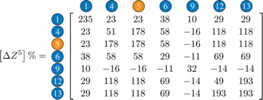

(2) shows the corresponding percentage change in the reduced bus impedance matrix. This relates Substation 5 to the busbars at which harmonic current emissions are known (or would be measured on a physical system).
(2)
With the exception of ΔZ55−5ΔZ5−55 , which is ineffective because there are no emissions at Substation 5, the weighted average (according to load magnitude) of all the remaining values in the row indicated by is 159% which, when considering that this simple average does not take into account the impedances’ phases, corresponds well to the 125% increase shown in Fig. 5 .
