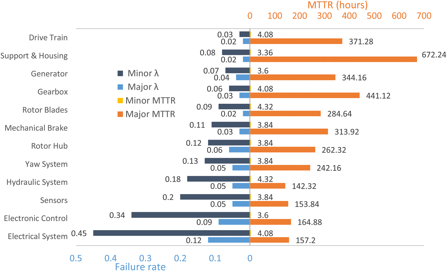

Fig 5: Historical onshore failure rate and MTTR categorised as major and minor classes [20]
The key trend identified from Fig. 5 is that failure rate and MTTR are broadly, inversely proportional. Failures that occur regularly have a small MTTR whereas significant periods of downtime are associated with rare major failures of the drive train, blades, gearbox, generator and structure. In addition, these are the components that require specialist heavy lift vessels offshore and therefore have a significant additional financial cost making them critical to overall O&M performance. The one offshore data set that has sufficient information to allow a direct comparison with the onshore analysis comes from Offshore Wind Park Egmond aan Zee (OWEZ) in the Netherlands [10]. The operational reports for this site report total ‘faults’ rather than absolute failures and so are not directly comparable. However, the average number of annual visits to each turbine is reported as 7.5 per turbine over the first three years of operation and the contribution to downtime from each subsystem is reported. It is therefore possible to scale the faults to represent failure rate and estimate the MTTR. This result is provided in Fig 6.

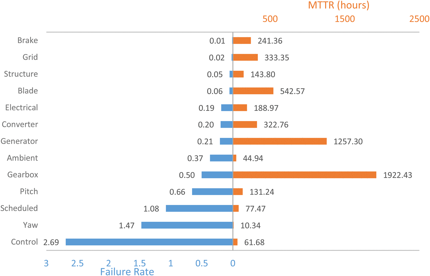

Fig 6: Scaled failure rate and MTTR at Egmond aan Zee wind farm, adapted from [10]
Comparing the onshore based and offshore results it can be seen that the general relationship between failure rate and MTTR is observed and that the gearbox, generator and blade have the highest MTTR. The higher than expected failure rates of the generator and gearbox are attributed to the serial defects present in these subsystems. The resultant contribution to downtime is shown in Fig 7 confirming that despite being in the middle of the observed failure rates, gearbox and generator failures dominate overall downtime. Improving reliability and reducing maintenance of these subsystems is critical to the industry moving forward. An additional observation is that the next largest contribution to downtime comes from the control system despite the small MTTR. This highlights the fact that there is a significant time cost associated with any failure offshore. As wind farms are constructed in more remote locations the contribution of frequent, low impact failures on overall availability is likely to increase. This has led to investigation of failure analysis techniques such as failure mode effect analysis for offshore wind [21] in order to minimise overall failure rate and implement advanced maintenance approaches which are discussed in Section 6.

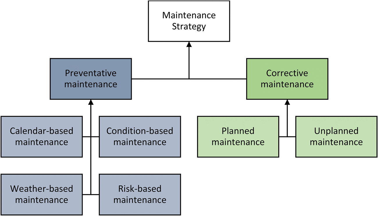

Condition monitoring will allow a number of different maintenance strategies to be implemented. Classification of different strategies is shown in Fig. 10 [28] and the impact on maintenance levels for three different approaches shown in Fig. 11 . Traditional corrective approaches adopted onshore are shown on the right-hand side branch while strategies considered necessary for offshore wind are shown on the left-hand side of Fig 10. Fig 11 shows that condition-based maintenance can reduce the number of maintenance actions while avoiding downtime associated with corrective maintenance. Repairs are also cheaper than complete replacement providing a financial benefit from successfully implemented asset management strategies.
Fig 10: Schematic overview of different maintenance strategies, adapted from [28]

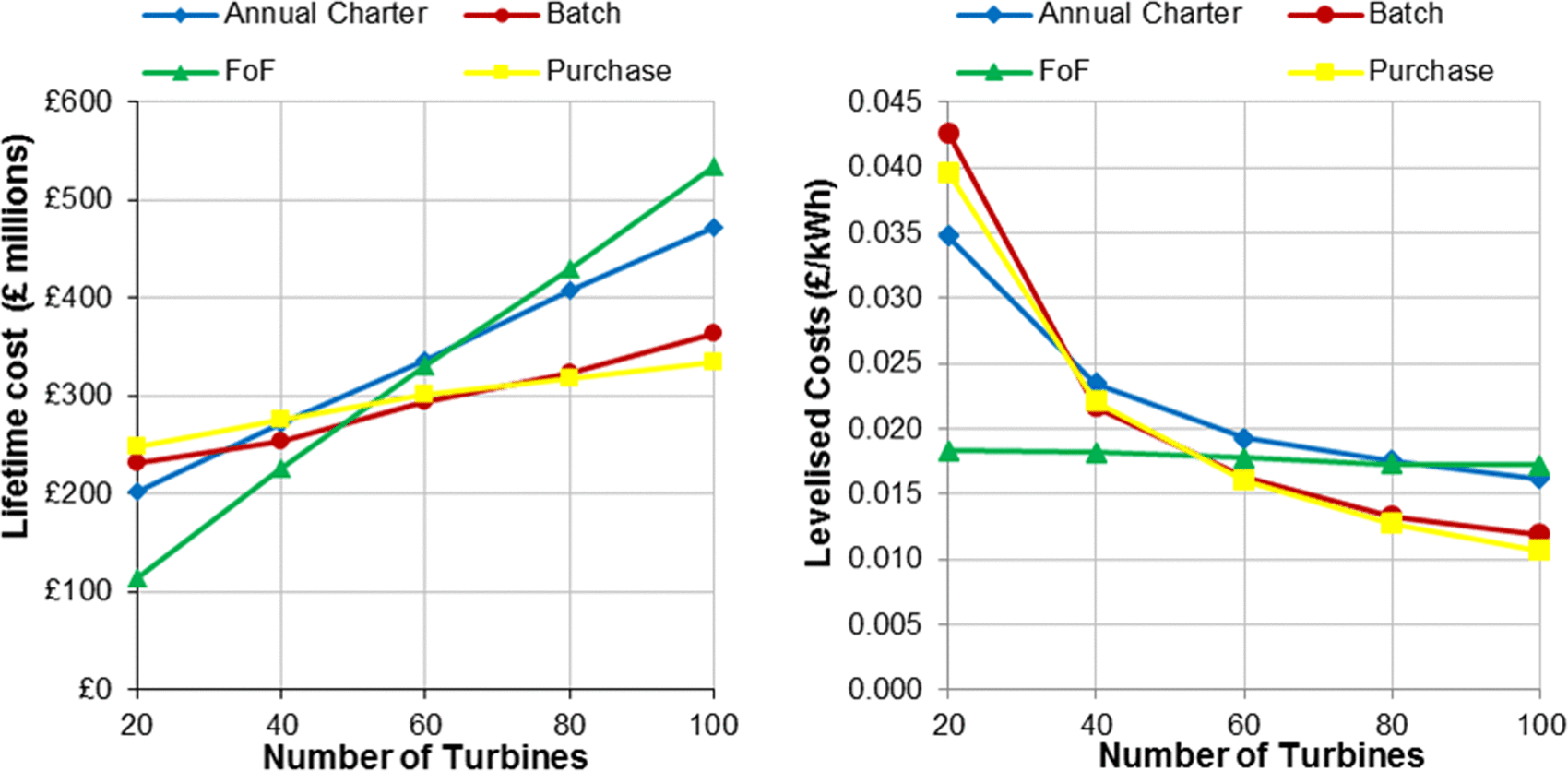

Case Study 2: Optimal Strategy for Large Maintenance Vessels
Vessel costs contribute a significant proportion of direct O&M costs and the largest contribution comes from the specialist heavy lift vessels required for major repair and replacement of drive train components and blades. The procurement of specialist vessels for these maintenance actions are typically Jack-Up platforms. The CAPEX cost associated with such vessels are in the hundreds of millions of pounds while mobilisation costs involved in chartering can be millions of pounds along with associated day rates of hundreds of thousands. A number of operating strategies can be adopted in order to minimise the sum of spending on vessels and lost revenue. Four potential operating strategies are described below and explored over a range of wind farm size in Fig. 13 to demonstrate how different strategies are optimum for different wind farm configurations [29].
Fix on fail (FoF) – Charter vessel when after failure. Only pay for duration of the vessel charter, however, exposure to long mobilisation periods where the turbine will not be generating electricity.
Batch repair – As FoF but vessel not chartered until a threshold number of failures have occurred. Reducing total number of charters but increasing exposure to lost revenue.
Annual Charter – Short term (1–12) month yearly charter each year, failures falling outside the charter period do not receive maintenance until the start of the next charter period.
Purchase – Purchase a vessel for the duration of the wind farm life, high additional cost at start of project but removes exposure to market and lost revenue but is not flexible.
Fig 13: Heavy lift operational strategies for different wind farm sizes
For different wind farm sizes, different strategies are more cost effective. For very small wind farms the conventional FoF approach is the most effective. As wind farms become larger, purchasing a vessel becomes optimal. However, this is an inflexible strategy and increases the difficulty in financing large projects. A batch approach offers similar lifetime costs without the large up-front investment and may therefore be the preferable strategy.
