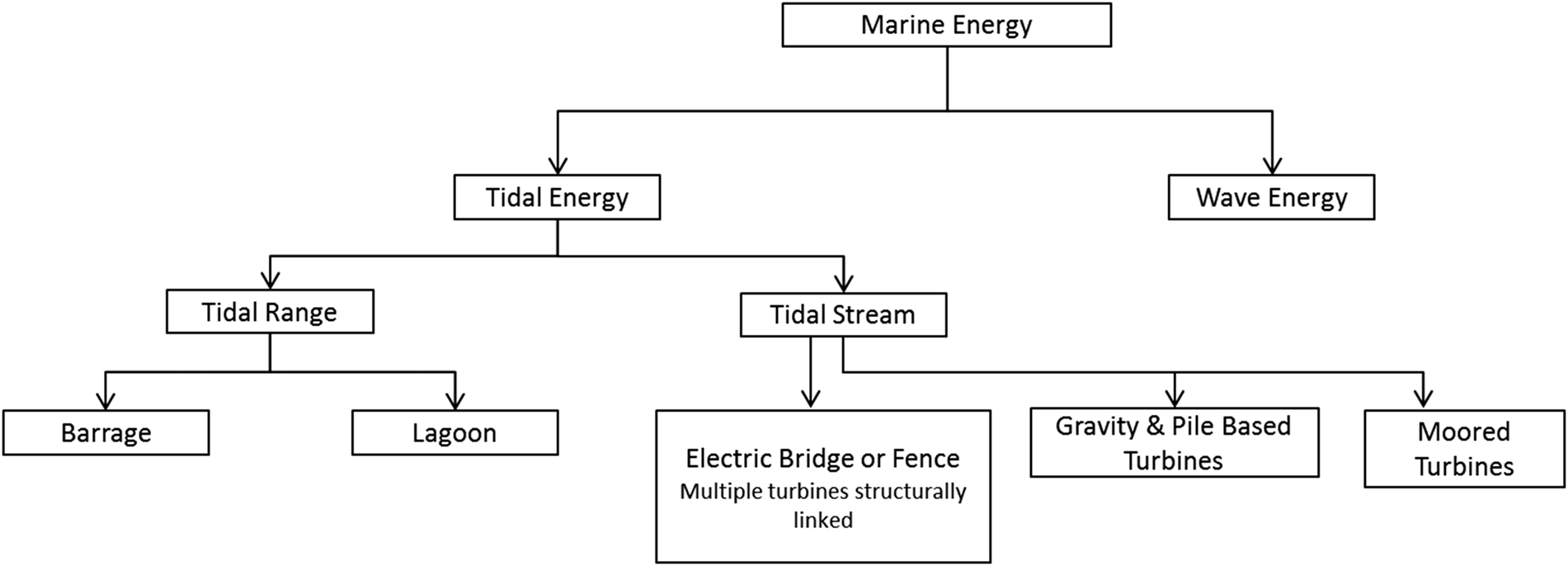

Fig 1: Basic categorisation of tidal lagoons within marine energy
Tidal barrages contain turbines within a barrier that extends between the banks of an estuary or river. Tidal lagoons differ as they contain bodies of water in a basin, which is either constructed along one side of an estuary or river, or located completely offshore [].
Both tidal barrages and lagoons extract energy from the tides by creating an artificial difference in water levels, or head. Higher water levels are constrained by the lagoon walls and sluice gates; when these are opened, the flow of water drives turbines to generate electricity.

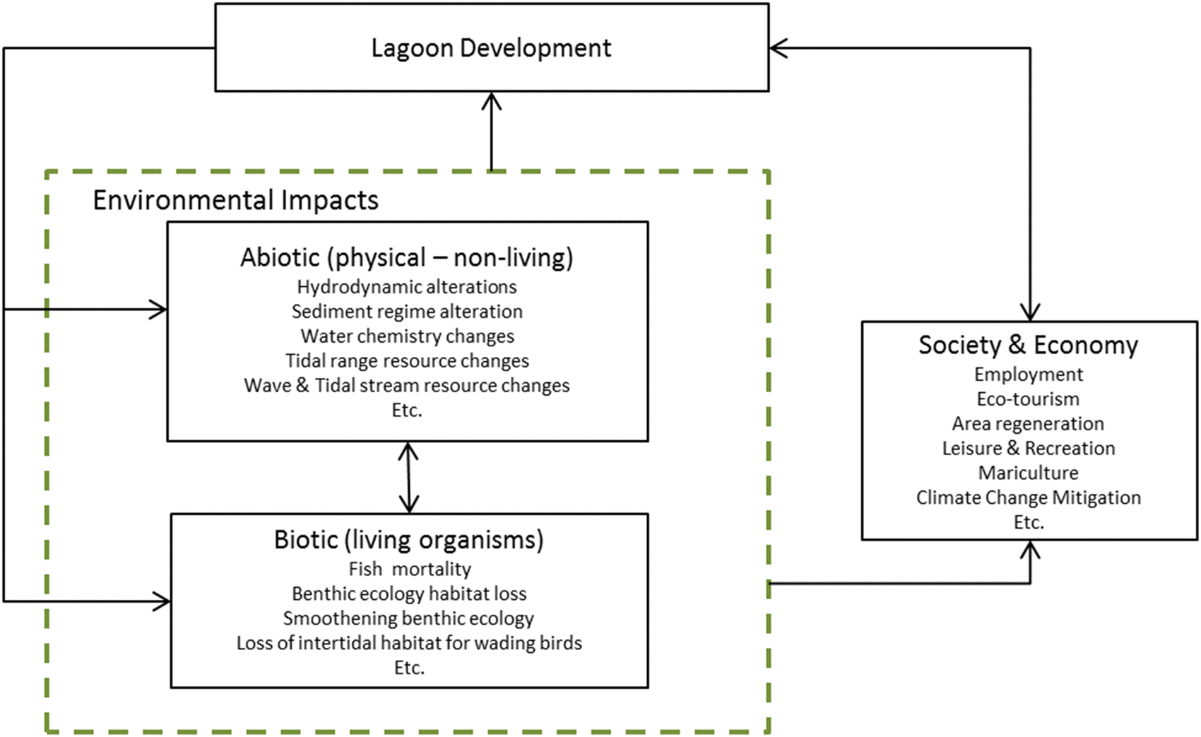

Lagoon environmental interactions
Assessing the environmental impacts of a tidal lagoon is a complex activity. Ecosystems are a detailed web of interactions between the physical, or abiotic, environment and the living, or biotic, environment. Further complexity is added through the site- and design-specific nature of any interactions, the potential cumulative impacts and the fact that these interactions are in a constant state of flux. As a result of this, any environmental impacts of a lagoon will be site specific, will have knock-on implications through the ecosystem, society and local economy, and are likely to alter over the course of a lagoon's 100-year life span.
Rather than attempting to list all of the potential environmental impacts of tidal lagoons, this paper proposes a conceptual framework (Fig.  ) and provides examples of impacts to illustrate this framework. Fig.  shows the grouping of environmental impacts in the framework and how these are linked to the lagoon development, society and the economy. The arrows in Fig.  describe the links, often two-way, between each of the groups, for example, the abiotic environmental impacts will have a two-way interaction with the biotic impacts. These interactions are discussed further below.
Fig 2: Grouping of environmental impacts and interactions with tidal lagoon developments, society and economy

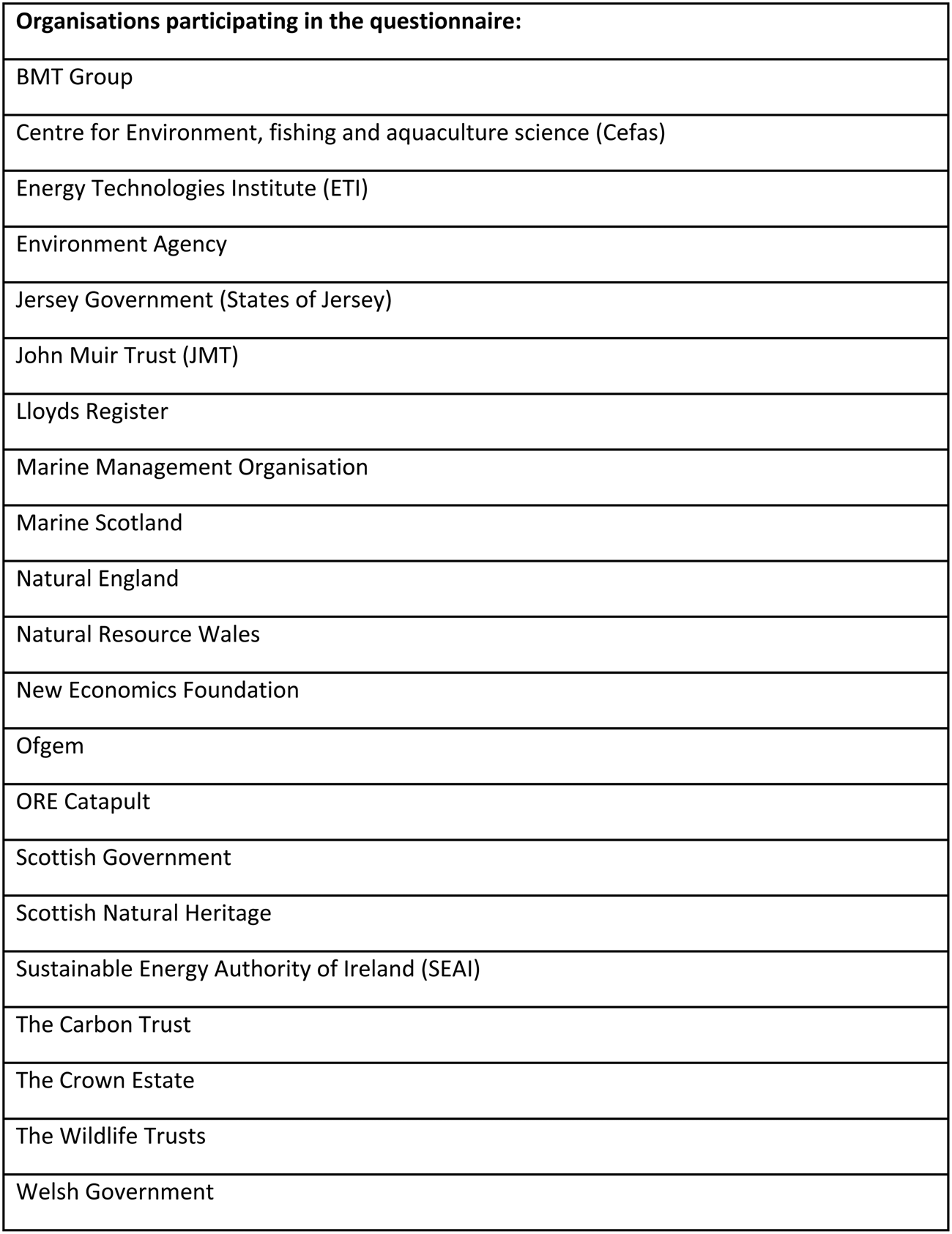

The questionnaire received a 51% response rate with a total of 21 different organisations contributing (Fig ).
Fig 3: Organisations participating in the questionnaire

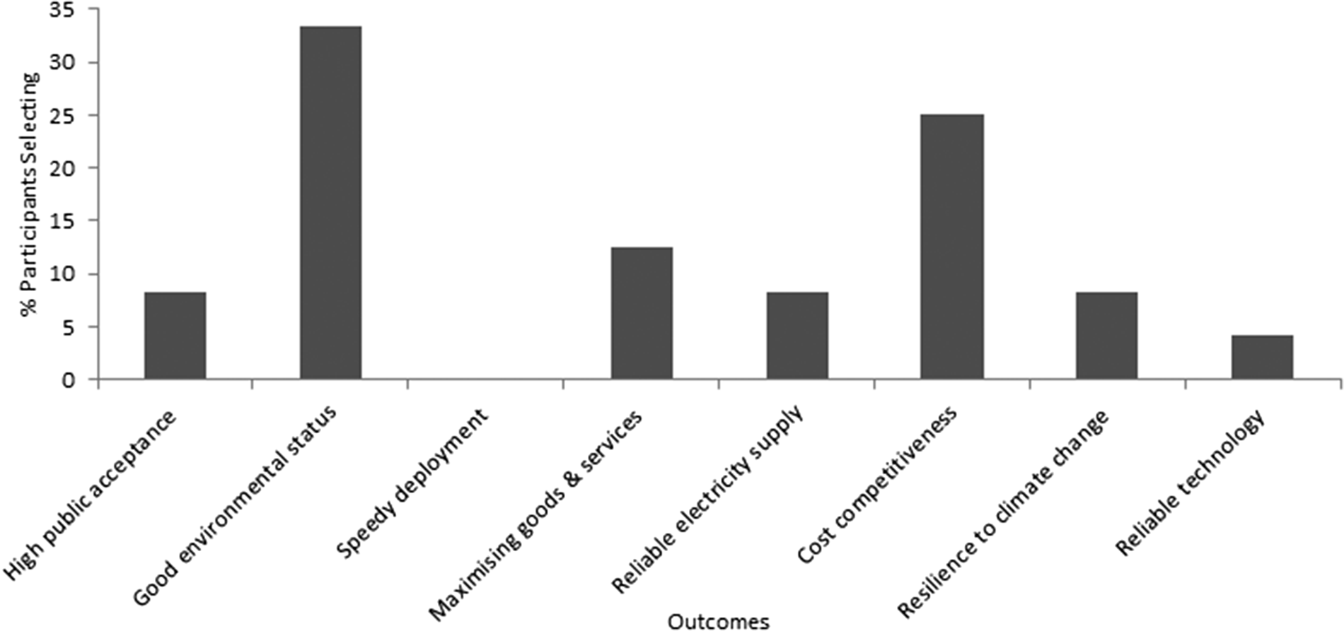

Participants believed the most desired outcomes for future tidal lagoon developments to be a ‘cost competitiveness’ and a ‘good environmental status’ (Fig.  ). Good environmental status here was defined as reducing negative impacts and enhancing positive impacts where possible. This is not linked to the marine strategy framework directive which defines ‘good environmental status’ differently [ 30 ].
Fig 4: Response to question: ‘What outcomes do you believe to be the most important for future tidal lagoon developments?’

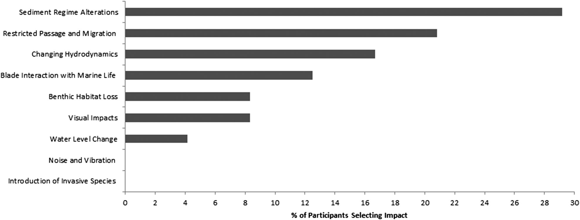

Participants deemed the three most significant environmental impacts to be ‘sediment regime alterations’, ‘changing hydrodynamics’ and ‘restricted passage and migration’, as shown in Fig 5. It is important to remember here that these impacts will interact with each other, the wider biotic and abiotic environment, society, economy and even the lagoon itself.
Fig 5: Response to question: ‘What do you consider to be the most significant environmental impact of tidal lagoon developments?’

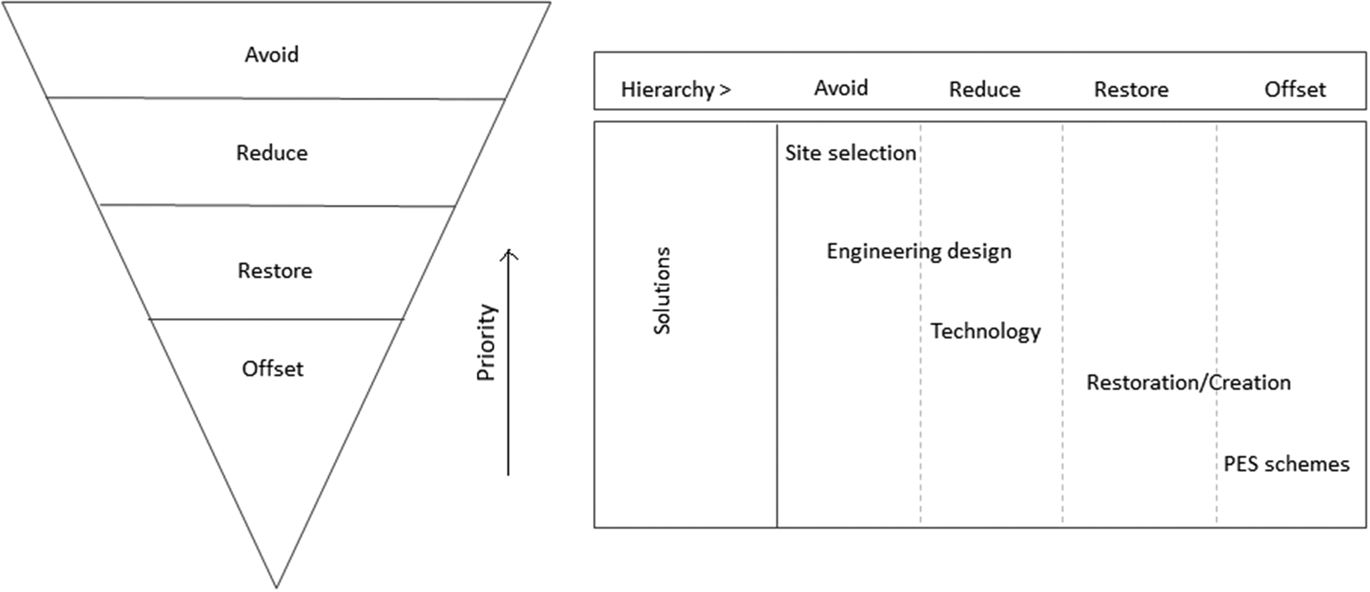

Range of solution options
Whilst avoiding impacts should be a priority there are a range of other solution options to be aware of. Typically, negative impacts are addressed and positive enhancements sought working down the mitigation hierarchy. The mitigation hierarchy is a strategy for addressing impacts; it works to first avoid impacts, then reduce and then finally compensate or offset. There is also potential to harness benefits in this way, by delivering enhancements at each stage of the hierarchy to offset the negative impacts. Within the hierarchy, strategies for impact solutions such as site selection, engineering design and technology, biodiversity offsetting by restoration, creation of habitat and catchment-based measures such as payment for ecosystem services (PES) schemes can be categorised (Fig.  ).
Fig 6: Mitigation hierarchy and potential strategies at each level

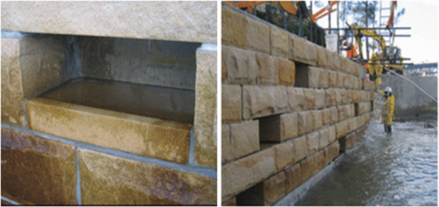

Achieving a good environmental status is not only about addressing negative impacts but also about enhancing positive impacts wherever possible. This allows a project to work towards an environmental net gain. Environmental enhancements can be developed within the lagoon design itself or through later compensatory or offsetting stages of the hierarchy.
Case studies – built-in enhancements, Sydney Harbour: Adding new infrastructure in the sea will be a driver for change in the marine environment [ 35 ]. Building in enhancements early on in the engineering design can increase the positive environmental impacts of a development, contributing towards achieving environmental net gain. An example here is the intertidal habitats created in seawalls in Sydney Harbour. The designs do not compromise the engineering requirements or cost but do increase the diversity of species able to live on the sea walls [ 35 ]. Fig.  shows a photograph of their construction.
Fig 7: Built-in rock pools in Sydney Harbour walls. Source: [ 35 ]
