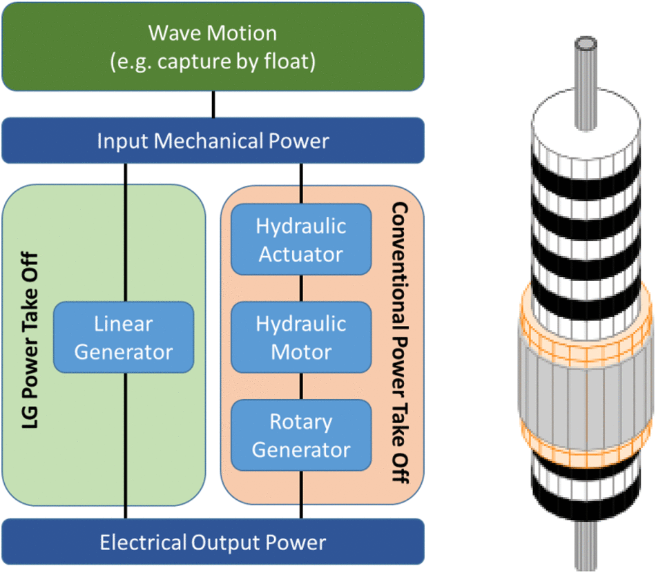

Fig 1: Generic PTO and linear generator [ ]
The ambition is to create a modular generator which, by adjusting a few key parameters such as armature length and number of generators in parallel, can act as a single point PTO for many different applications. Trident Energy subcontracted significant work packages (WPs) to enable them to rapidly assemble the required expertise – 42 Technology were responsible for the concept design of the improved linear generator and are now working on the detailed design.

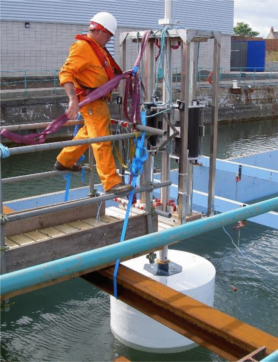

Fig 2: Early Trident prototype linear generator being tested at NAREC, 2007 [3
As an SME Trident Energy has decided to limit its in house research and development capability, preferring to partner with/contract other companies and leading academic groups to bring flexibility and expertise into its product development team and project delivery. This has enabled them to deliver a complex project more flexibly and more rapidly than building an in house team.

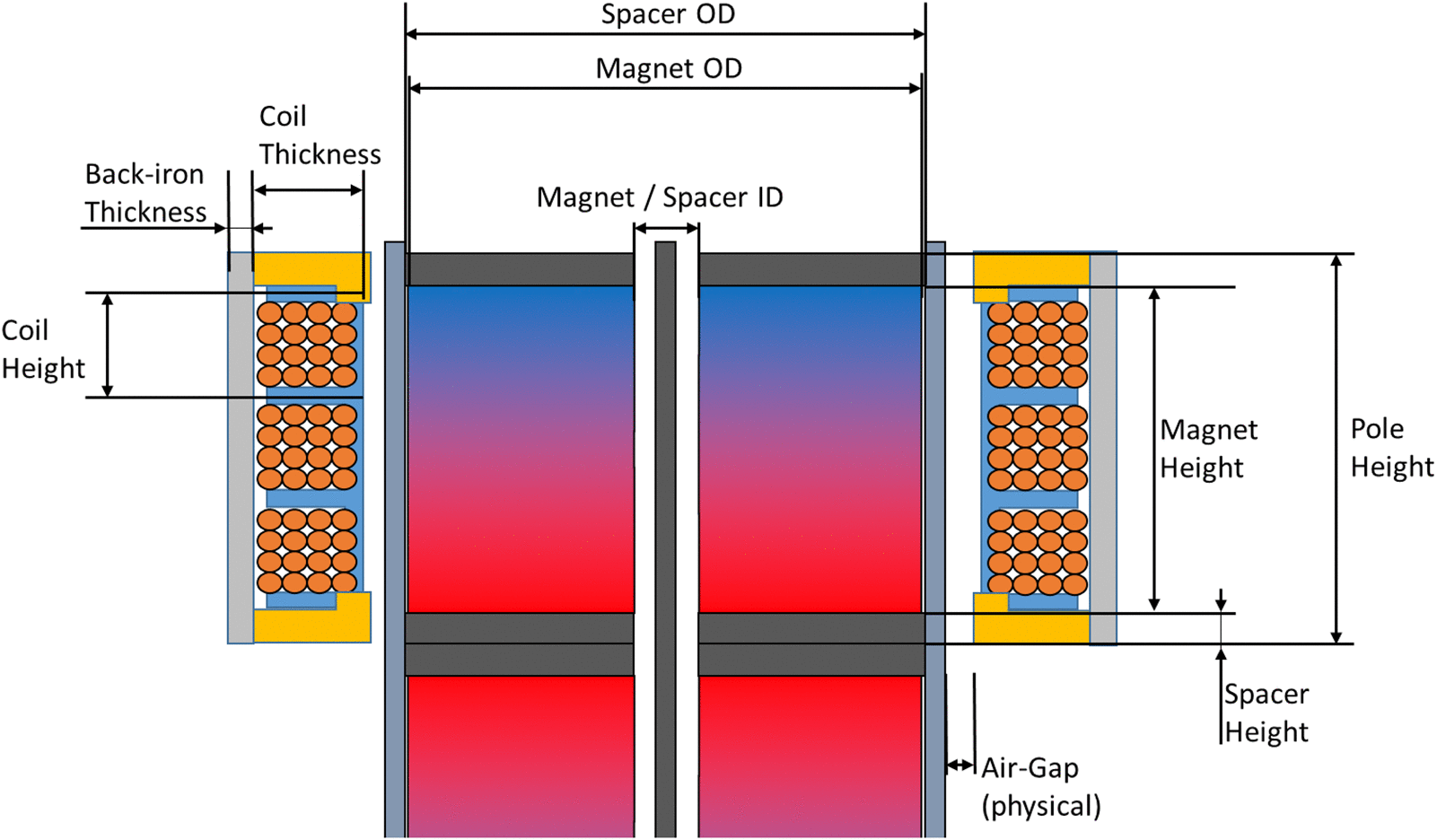

The first two objectives, affordability and performance, are both related to the capital cost per kW of installed capacity. A critical parameter for generator performance is the air gap between the central magnet stack and the outer coils (see Fig.  3 ). Trident Energy's linear generator design uses back-iron around the outside of the coils to improve the magnetic flux linking the coils. However, the remaining air gap acts as a resistor in the magnetic circuit – by reducing this gap the magnetic reluctance of the circuit is reduced, which in turn increases the flux linking the coils, enabling greater performance without increasing the capital cost. A small air gap and improved flux linkage also result in a higher power density package which means that the same linear generator design can be used in a wider range of WECs. However, if the gap is too small then the tolerances in the magnet stack need to be very tight, increasing manufacturing costs, or the device risks collisions and impacts which have an impact on reliability and availability and hence operating cost. The process and analysis undertaken to minimise the air gap is detailed in Section 5.
Fig 3: Illustration of linear generator showing the air gap [5]

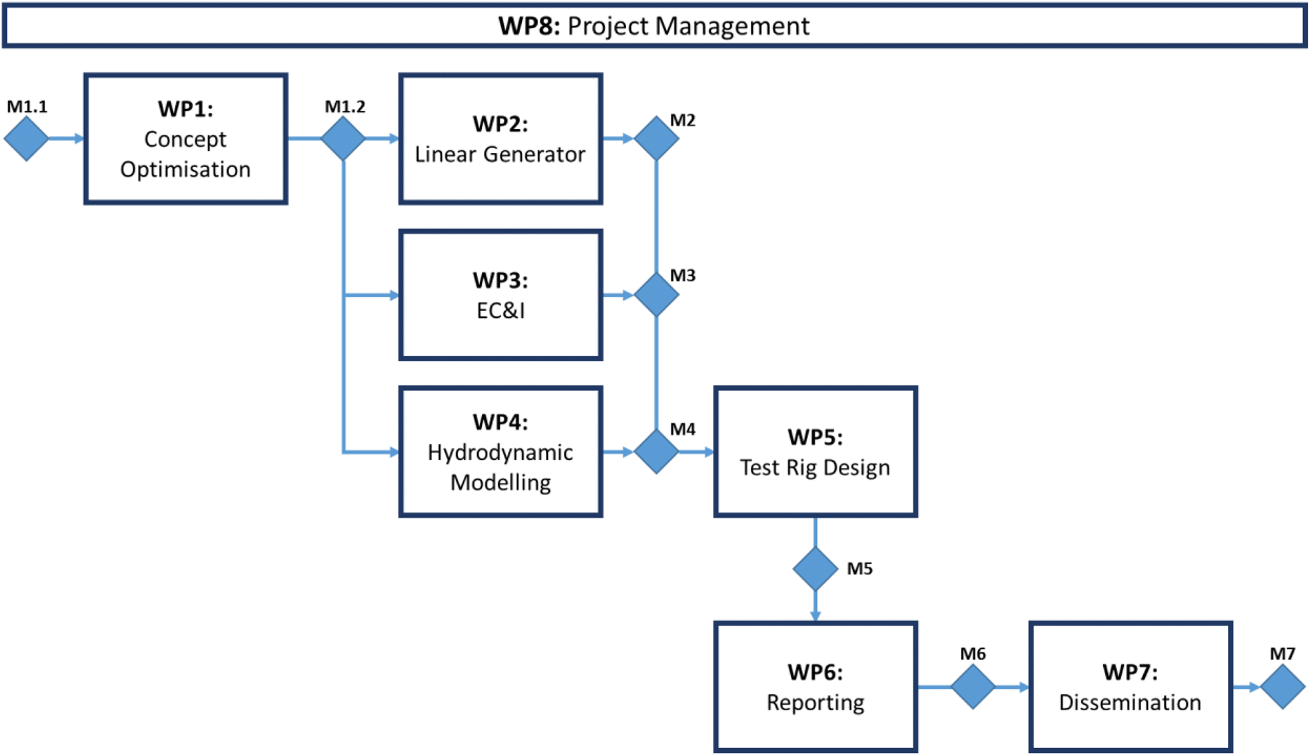

The project was divided into a number of WPs as shown in Fig.  .
Fig 4: Overall wave drive project structure [4]
The WPs were led by different project participants as follows:
• WP1: Concept Optimisation[Trident Energy]
• WP2: Linear Generator[42 Technology]
• WP3: Electronics, Control & Instrumentation (EC&I)[University of Warwick]
• WP4: Hydrodynamic Modelling[West Coast Wave Institute]
• WP5: Test Rig Design[Energy Technology Centre]
• WP6-8: Reporting, Dissemination and Project Management[SgurrEnergy]

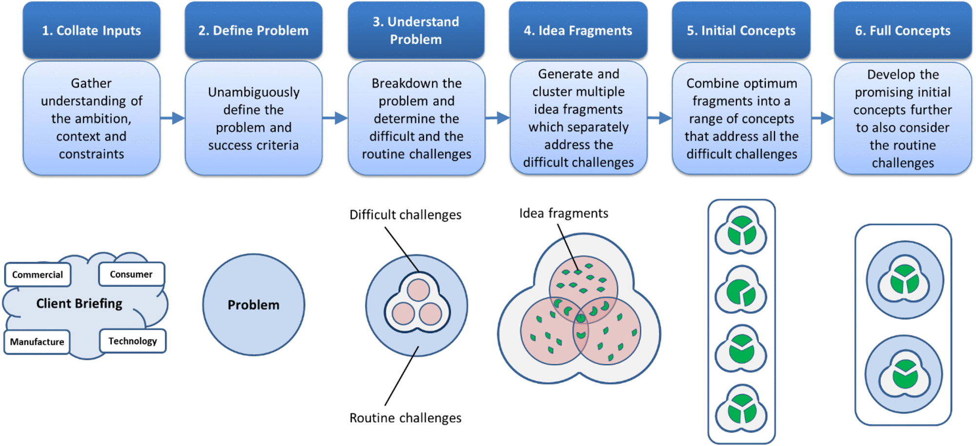

42 Technology were responsible for WP2: electrical and mechanical design of the enhanced linear generator. This includes redesigning the magnet stack, armature and bearing interface as well as considering reliability, ease of maintenance and manufacturability. 42 Technology used a variant of its standard product development process (Fig.  ).
Fig 5: 42 Technology concept development process [4]

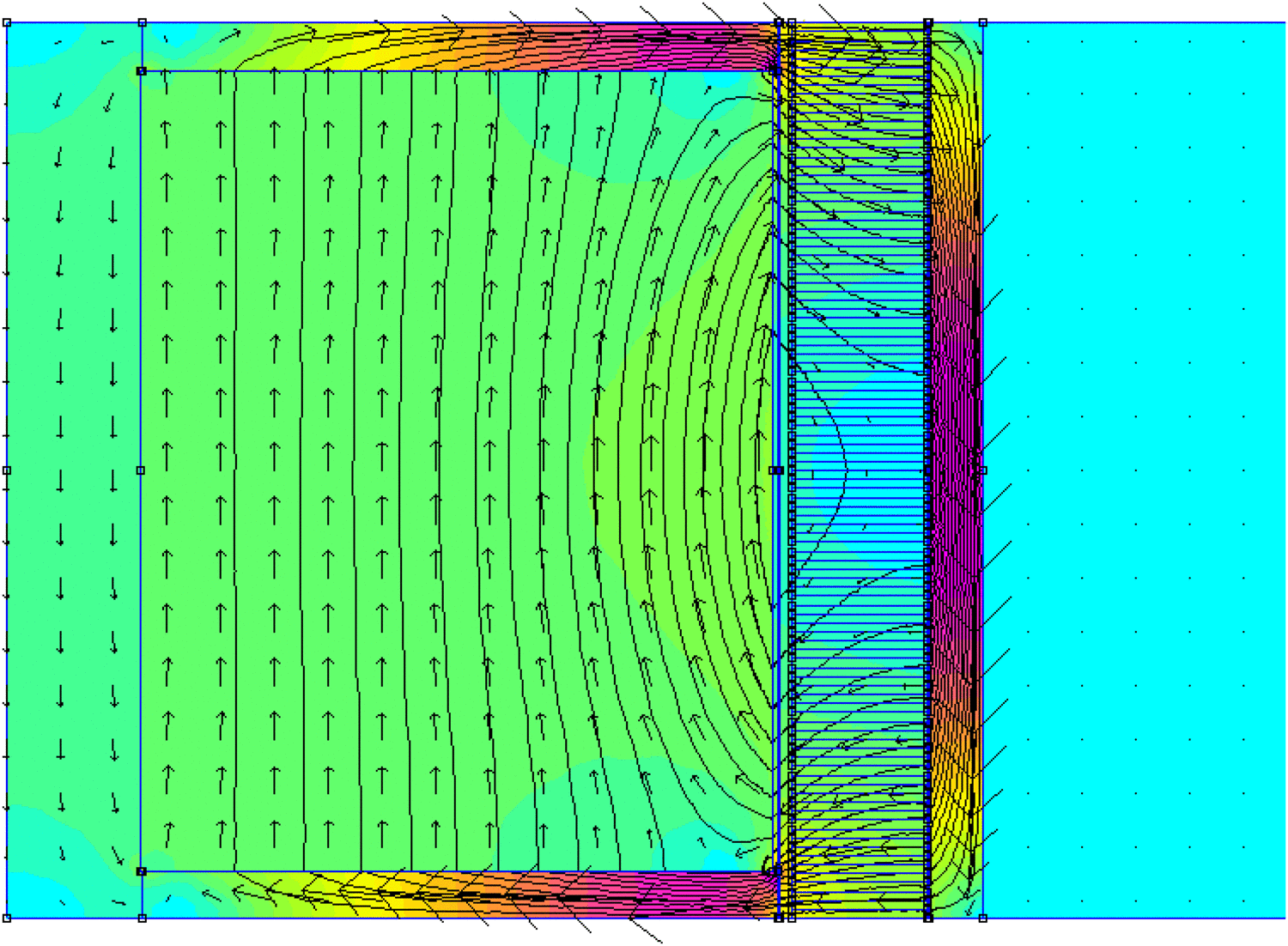

There were a number of specific challenges that merited technical ‘deep dives’ to resolve, for example the selection of magnetic material. The Trident Energy approach is to optimise for performance per unit cost. Although rare earth magnets do provide markedly improved magnetic field strengths, these more exotic materials are inherently costlier and more difficult to work with and ultimately do not provide enough performance gain to justify the increased cost. Later the magnetic design was modelled optimised and compared to the previous design iteration using magnetic finite element analysis (Fig.  ).
Fig 6: Modelled relative performance of candidate magnetic materials [ ]

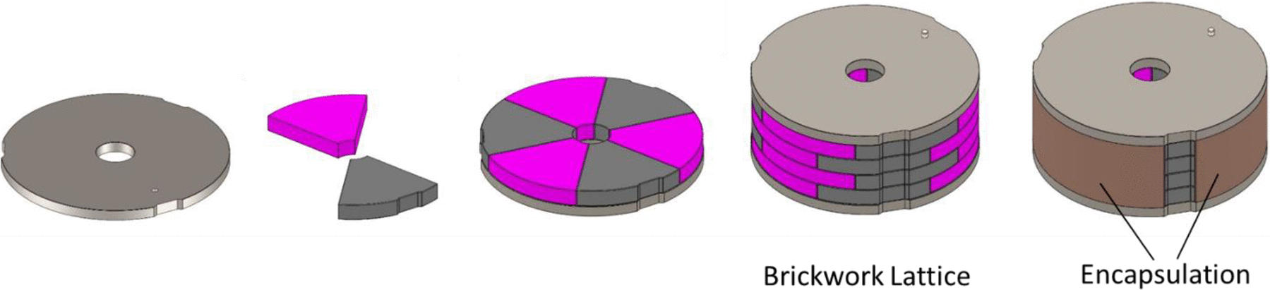

A second example of a technical deep dive was air gap minimisation to improve the capital cost/performance trade off. Reducing the air gap while maintaining reliability requires an improvement in the manufacturing tolerances associated with the magnet stack. The magnet stack is created from a large number of layers of ferrite assembled and encapsulated into axially magnetised poles separated by steel discs to help orientate the magnetic flux (see Fig.  7 ). Each ferrite/steel slice has dimensional manufacturing tolerances, as well as tolerances associated with how accurate these are assembled relative to each other and how ‘true’ the resultant assembled stack is.
Fig 7: Magnet stack assembly [4]
42 Technology established how accurately each the components and the stack could be made and conducted analysis to establish how small the air gap could be with current manufacturing technology without creating reliability issues or increasing manufacturing costs. By adopting a modular design for the magnet stack allows for the use of well toleranced steel discs, aligned using an assembly tool, and low toleranced ferrite segments. The resultant encapsulated module has a well toleranced outside diameter and enables running the generator with a smaller air gap.

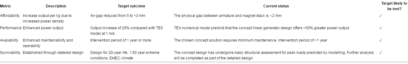

The project successfully achieved all four of the initial target outcomes as shown in Table  .
