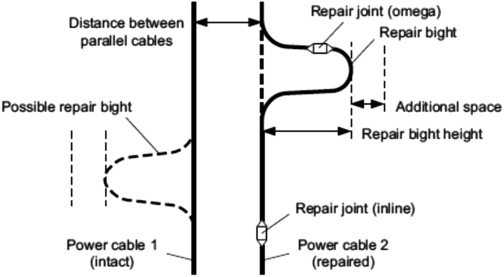

In the UK, the owner of the territorial seabed (The Crown Estate) normally specifies a cable corridor to have a width of N × 30 m + 2 × 235 m, where N is the number of power cables of the same project. The formula basically allows a 250 m space from each side of the cable bundle.
The reason to allow space at each side of the cable or cable bundle is to provide a degree of installation flexibility to: (a) avoid any localised obstructions, such as wrecks or unexploded ordnance which are only discovered in the final pre-installation surveys; (b) avoid localised areas of difficult ground conditions, such as small rock outcrops, boulder formations or glacial till outcrops; and follow the troughs of sandwaves in areas where mobile seabeds are known to exist and (c) avoid sensitive locations, such as areas with dense aggregations of a particular marine life.
Another important reason to reserve space alongside a submarine power cable is to facilitate repair during the operating phase when necessary. This is because in nearly all the cases cable repairs will need to involve cutting away the faulty section and replacing it with a section of new cable long enough to allow jointing at a vessel deck or at least at a level out of water. As a result an omega (Ω)-shaped loop or repair bight will be formed as a result of the repair. This is illustrated in Fig.  .
Fig 1: Illustration of the omega bight for cable repair [9] (note: the additional space on the right hand side of the bight is for future repair needs)
he size of the repair bight depends on water depth, repair vessel deck height, deck length required and crown radius of the bight. For a 35 m water depth, the repair bight height may be above 90 m. In this case, the cable length to form the omega-shape can reach around 250 m. In fact an actual project had a length of 400 m in the omega loop. This also means that a spare cable up to the omega length or longer is required to be kept on stock.

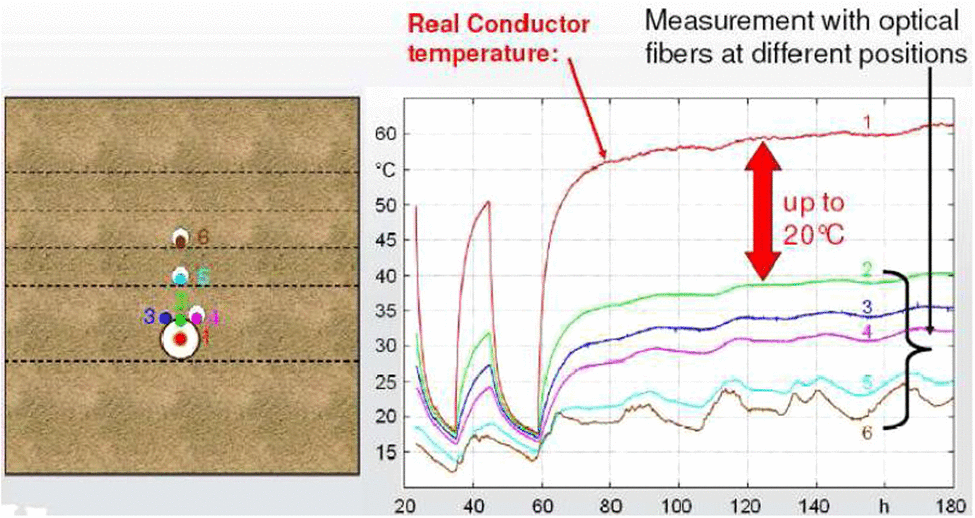

Cable operating temperatures are the most important operating parameter deserving close and constant monitoring. This is for two main reasons: one is to enable full exploitation of the cable power transmission potential which mainly depends on the cable operating temperature and the other is to ensure this is done without the sacrifice of cable usable life. This is because cables ‘age’ predominantly through deterioration of their insulation material under the influence of electrical stress, mechanical stress, temperature and chemical aggression (including humidity and ultra-violet irradiation). Well protected submarine power cables can achieve a service life of 30–40 years. A rule of thumb is that the useable life of most insulation materials (either paper or polymeric materials) could be reduced by half by either increasing the operating temperature above its designed operating limit by up to 10°C or increasing the operating voltage above its designed operating limit by up to 10%. It is important to observe these limits.
To effectively monitor and make use of operating temperature information, it is critical to establish a starting point by verifying that a cable system can safely transmit the required power for a sustained period (say, 6–8 h) without exceeding the maximum permitted conductor temperature (e.g. 90°C for XLPE insulated cables). The measured maximum operating temperature of a power cable should be checked against the theoretical maximum permitted temperature, which can be derived from the maximum design temperature and then corrected using correction factors related to seabed/ground temperature, sediment/soil property, proximity to other cables and burial depth [11].
It should be made clear that there are many different temperatures within a power cable, such as temperature of the optical fibre, or temperature of the core, or temperature of the insulation. Caution should be exercised to avoid confusion among different temperatures. If an operator indicates that their XLPE transmission cables were running at 20°C at full power, it is important to understand if the reading of 20°C is corrected from the temperature of the optical fibre for the conductor of the cable or the temperature of the optical fibre. Attention should also be drawn to avoid confusion whether a temperature reading is obtained through direct measurement or indirect calculation.
Correlation between the measured temperature of the optical fibres and the actual temperature of the conductors is a delicate and complex matter. A sophisticated calculation involving thermal modelling and multiple variables/factors (such as power loading levels and ramping rates, time delay factors and insulation materials/conditions) would be required to derive the temperature of the conductors from readings from the optical fibres. The higher the load gets, the higher the difference between the two temperatures will be. The time delay aspect is because heat needs to propagate through the insulation and as a result the fibre sees a delay.
Fig.  illustrates an example of various temperatures during load cycles at different positions of the sensor for a single-core land cable [8]. The optical fibre marked as position 2 in green in the figure is located in the insulation screen area of the cable.
Fig 2: Illustration of temperature readings for a power cable [8]
In terms of physical implementation of temperature measurement, optical fibres normally obtain temperature data by using the DTS technique based on the Raman effect [12]. This is because an optical laser pulse sent through the fibres results in some scattered light reflecting back (referred to as ‘Raman scattering’) to the transmitting end and the intensity of the Raman scattering is a measure of the temperature along the fibres. The location of the temperature reading is determined by measuring the arrival timing of the returning light pulse similar to a radar echo. DTS can function continuously regardless whether the power cables are energised or out of service.
The sensing fibres are either embedded in three-core power cables or deployed along the outside of a single-core cable. Naturally the data from embedded fibres is more useful for calculating the conductor temperatures (with an accuracy of around 5°C or 5 K) than measurements taken using the fibres outside power cables. In fact the data from the fibres in a land duct alongside land power cables may be of very limited use owing to poorer correlation accuracy.
The other limitation of DTS based temperature monitoring is that it currently may only be able to cover a length of 30 km from the signal transmitting end, or a power cable of 60 km if the sensing signals are transmitted from both ends [12].
In other words, although DTS has the potential to offer effective temperature measurement and detect hot spots and temperature anomalies, further developments and innovation are required to resolve the two limitations discussed above in order to obtain a full and accurate temperature of conductors. Accurate information on conductor temperatures becomes more essential when a power cable is operated to its maximum temperature rather than its nominal ampacity limit to enable better utilisation of the cable potential without causing overheating. This would be the prerequisite for any attempt to operate power cables to their power ratings in a real-time manner (so called dynamic power ratings).
It should also be noted that DTS information has the potential to be used for wider purposes, for example, using DTS information from strain sensing optical fibres to detect cable installation issues or fault locations or using DTS information about changes in temperature to detect cables becoming unburied or further burial.

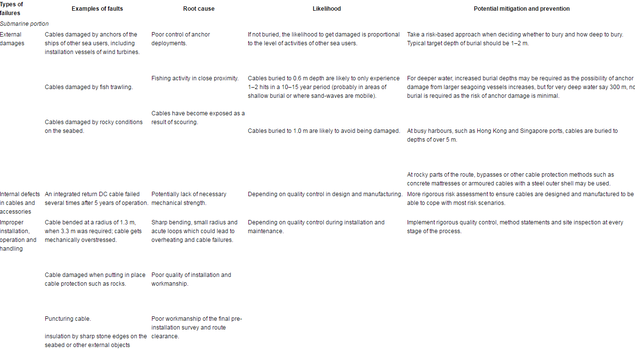

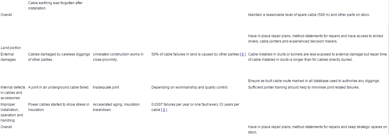

Power Cable Failures and Prevention
Within the offshore transmission and offshore power generation sector, the most serious failures in terms of impact on power transmission and generation are related to power cable faults. An insurance company indicated that in the European offshore wind sector alone, during the 7 year period from 2007 to 2014, there have been over 60 submarine power cable incidents ranging from £0.5 million to £13.5 million in claims and in total costed insurers £75 million and project owners £20 million [13], although it must be stated that the vast majority of insurance claims occur during installation or are caused by latent defects from installation. One recent case is a submarine power cable in the UK that failed five times over a period of 3 years, probably owing to the cable being over stressed during installation.
Faults and problems with submarine power cables include: defects in cable design and manufacturing, poor transportation and storage, difficulties with burying the cable to specified depth, installation errors, damages from jack-up vessels and anchors, poor landfall design, and poor termination workmanship at the offshore substation and so on. In broad terms, cable related problems can be divided into two categories: one is of a technical nature and the other is due to poor project management. Table  attempts to list some of the cable faults/failures, their causes and prevention of a technical nature, although industry practice seems to indicate that project management and quality control aspects have a greater share of responsibility for cable faults and failures.
Table 3: Selected cable faults/failures, their causes and prevention
It should be noted that once a cable fault has occurred offshore, the time taken to get the cable repaired may be much longer than the actual duration taken to do the repair. Three months or longer of downtime is not unusual for a submarine power cable incident. To replace an in-line submarine joint alone may take a month. For comparison, a cable fault onshore can be attended and repaired much quicker. It is reported [8,14] that more than one-third of the cable faults in land were repaired and re-energised again within one week and more than 75% within one month. This includes fault location, repair and testing.
The reason why offshore repairs take much longer is because a number of other factors will substantially increase the overall downtime. These factors include the following, some of which can be progressed simultaneously:
