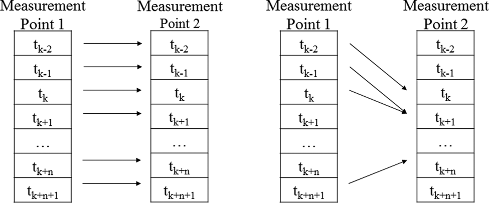

The spatial calibration as described in (1) is only suitable to adjust two measurements made relatively close to each other (between 2 D to 4 D). That methodology does not take into account the time a registered phenomenon will take to propagate from one measurement point to another.
A calibration equation more suitable to extrapolate registered phenomena to another location is obtained by adding the time shift variable τ
with
where, ϕ represents the angle formed by a line segment connecting the two measurement points and the north [°], τ is the time advance/delay variable [s] and  is the mean wind speed in bin j, within an interval of 4 m/s, according to the U  [m/s].
It is implied that τ can assume either positive or negative values depending on the relative position of the measurement points in relation to the direction of the wind. The most notable consequence in comparison with the procedure established by step A is that average measures taken synchronously are no longer directly related. Instead, depending on the direction and propagation speed of a phenomenon, the relatively large distance between the measurement points will require to relate a measurement to another measurement taken at a different instant (before or after) to be determined in each case (Fig 2). For a 10 min average wind time series, the τ values are rounded to the nearest interval, for example, for a time shift of 16 min the τ value will be 20 min.
Fig 2: Time association between measurements in step A of the methodology (left) and step B (right)

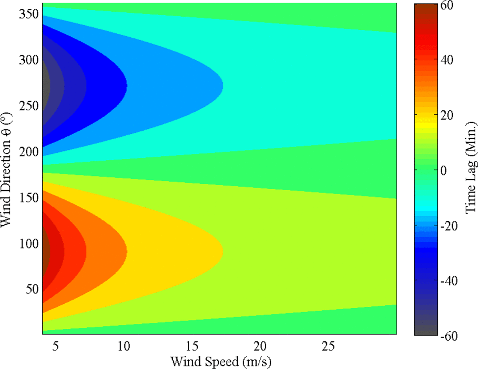

Fig shows the results of the methodology application for the time shift calculation (3) in the case study under analysis. Further information of the case study configuration and data is provided in the section ‘Wind Resource Assessment Results’.
Fig 3: Time lag (in minutes) for the case study calculated through eq. 3
The results were obtained for each wind direction sector (θ ), with distance (D) equal to 15 km and ϕ equal to 0°
The results depicted enable us to understand the temporal shift correction needed to adjust the data measured in the onshore mast, according to the different wind direction and wind speed associated to each meteorological phenomenon. As expected the minimum values of time shift (advance/delay) are observed when the phenomena propagated perpendicular to the two met masts, and on the other hand, the maximum values are found when it propagated parallel to the monitoring systems.

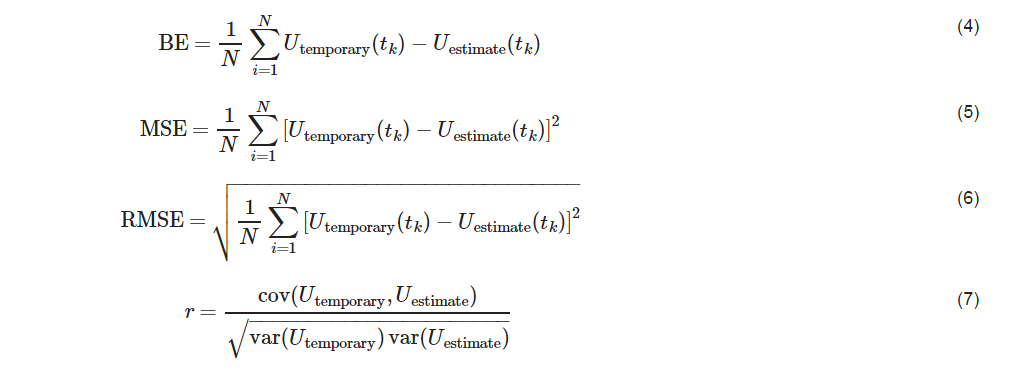

The quality of the wind data series obtained by the methodology application can be inferred through the evaluation of the following statistical parameters bias error (BE), mean square error (MSE), root mean square error (RMSE) and Pearson Correlation (r), which are mathematically defined as
where N is the total number of wind observations.

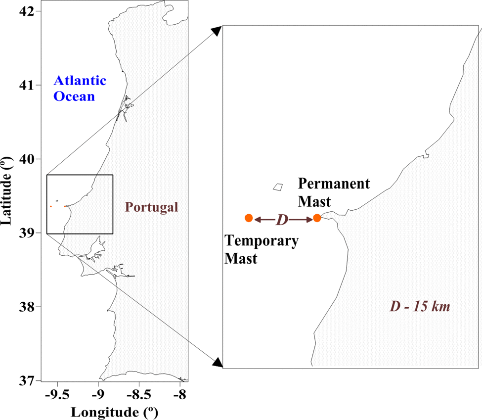

As part of the development of this methodology a case study was designed considering one year of data from an experimental setup composed by an onshore coastal permanent mast (OCPM) and a temporary offshore LIDAR (TOL) sited 15 km away from Portuguese coast, (Table and Fig 4). The offshore data (for 80 m a.g.l.) used for this case study was obtained from a LIDAR system installed in the Berlenga Islet after applying orography correction factors obtained in wind tunnel scale model [13].
Fig 4: Location of measurement points at the Portuguese coast

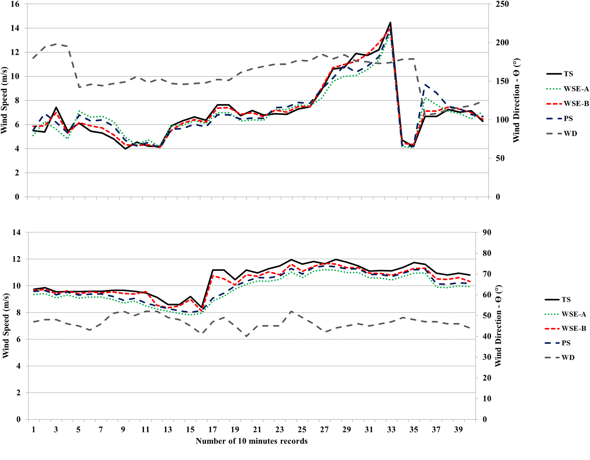

Following the methodology presented and according to (1) and (2), the wind flow correction factors (α) were obtained with the wind data (direction and average wind speed) from the LIDAR installed at the Berlenga Islet acting as a (temporary) floating LIDAR and permanent mast during a short synchronised period between 01 June 2011 and 30 September 2011 (summer period). The remaining period was used for methodology validation. In Fig.  , are presented a short period of the wind speed data from the temporary mast (TS), permanent mast (PS) and both wind speed estimates (step A – WSE-A; step B – WSE-B) with the correction factors application.
Fig 5: Example of the methodology application for two different periods
Black solid line represents the data from the TS; the dashed green line represents the WSE using the step A; the dashed red line represents the WSE using the step B; and the blue dashed line represents the data from the PS
Gray dashed represents the wind direction observed in the PS
