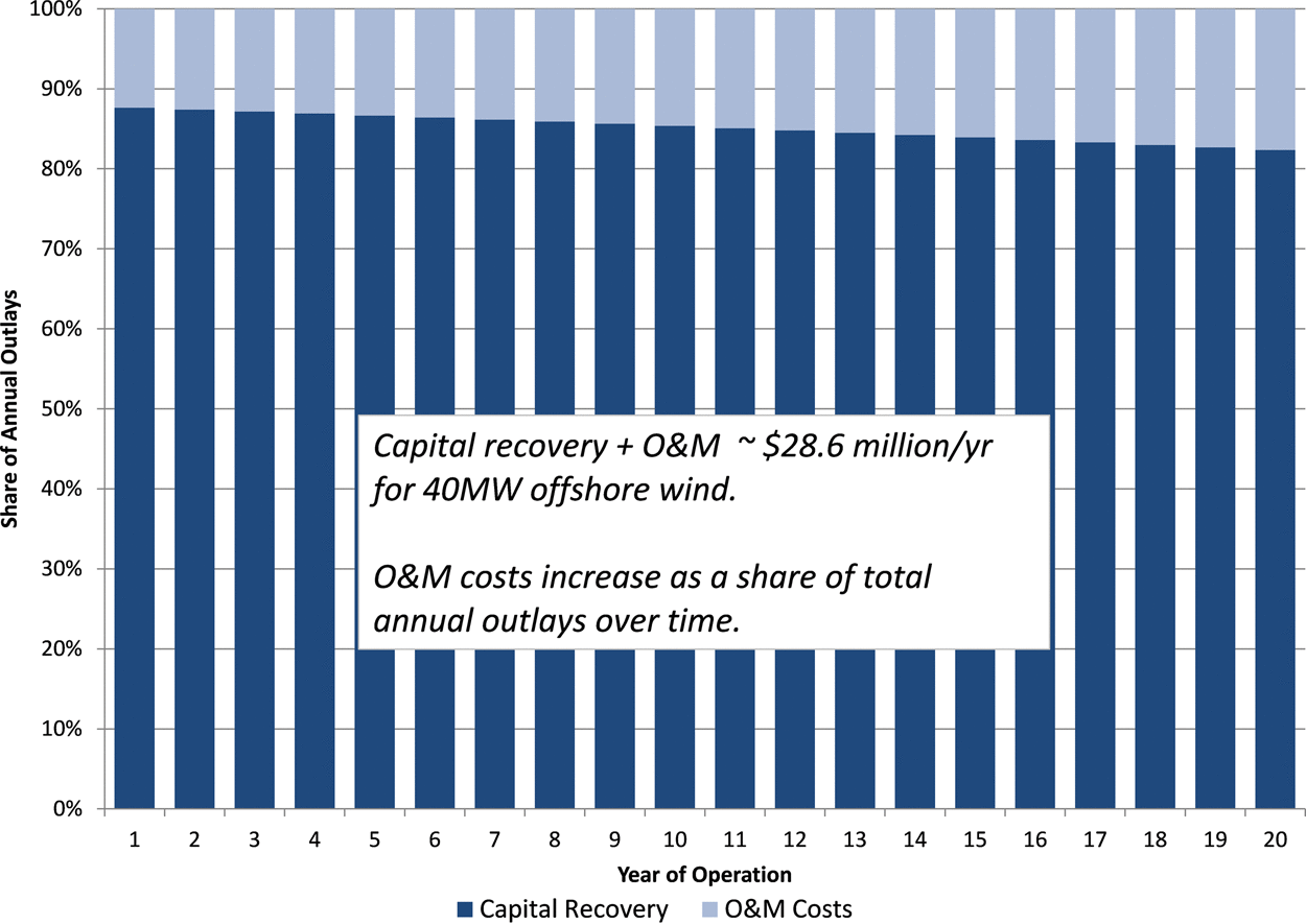

Wind Farm Capital Costs and O&M Costs
For an electric generating project to move forward, the revenue expected to be received by the owner and operator of the project must be sufficient to cover the costs of construction and operation and the cost of capital. Thus, a capital recovery model is required. Large utilities and public institutions may maintain in-house capital recovery models and/or may have resources to create such models as needed. Public models also exist and can be used directly or adapted for the purpose of a rate impact assessment. We used the Cost of Renewable Energy Spreadsheet Tool (CREST), a cash flow model developed under the direction of NREL [10].
The CREST model computes capital and O&M costs per kWh for a facility, using generating capacity, project lifetime, installed cost, financing parameters, and available incentives. It also computes the total cost of energy production each year over the life of the facility. The CREST model accounts for tax liability, asset depreciation, debt service, and equity investor return requirements. Inputs such as installed cost may be obtained from public sources such as the US Energy Information Agency (EIA). Financing inputs may be obtained from public filings for regulated vertically integrated utilities, or potentially sourced from developers for projects expected to be owned by third parties.
Key assumptions in the capital recovery model are:
  • Capital cost of construction is financed over 20 years from 2017 to 2036.
  • Operations and maintenance expenditures occur during years 2017–2036.
  • The proposed wind farm is jointly owned by SC's electric utilities; accordingly, the project's weighted-average cost of capital is a blended rate based on these utilities’ recent capital structures and cost of debt and equity financing.
  • Financial incentives are excluded from the capital recovery model.
We obtained installed cost per MW of generating capacity and annual O&M cost estimates from an in-state utility. These figures were based on internal research and equipment vendor contacts developed as part of ongoing investigations into offshore wind development in SC. Key inputs to the CREST model are provided in Table 3. Fig shows the annual capital recovery and O&M costs of the proposed wind farm over its assumed 20 year life.
Fig 1: Project capital recovery and O&M costs

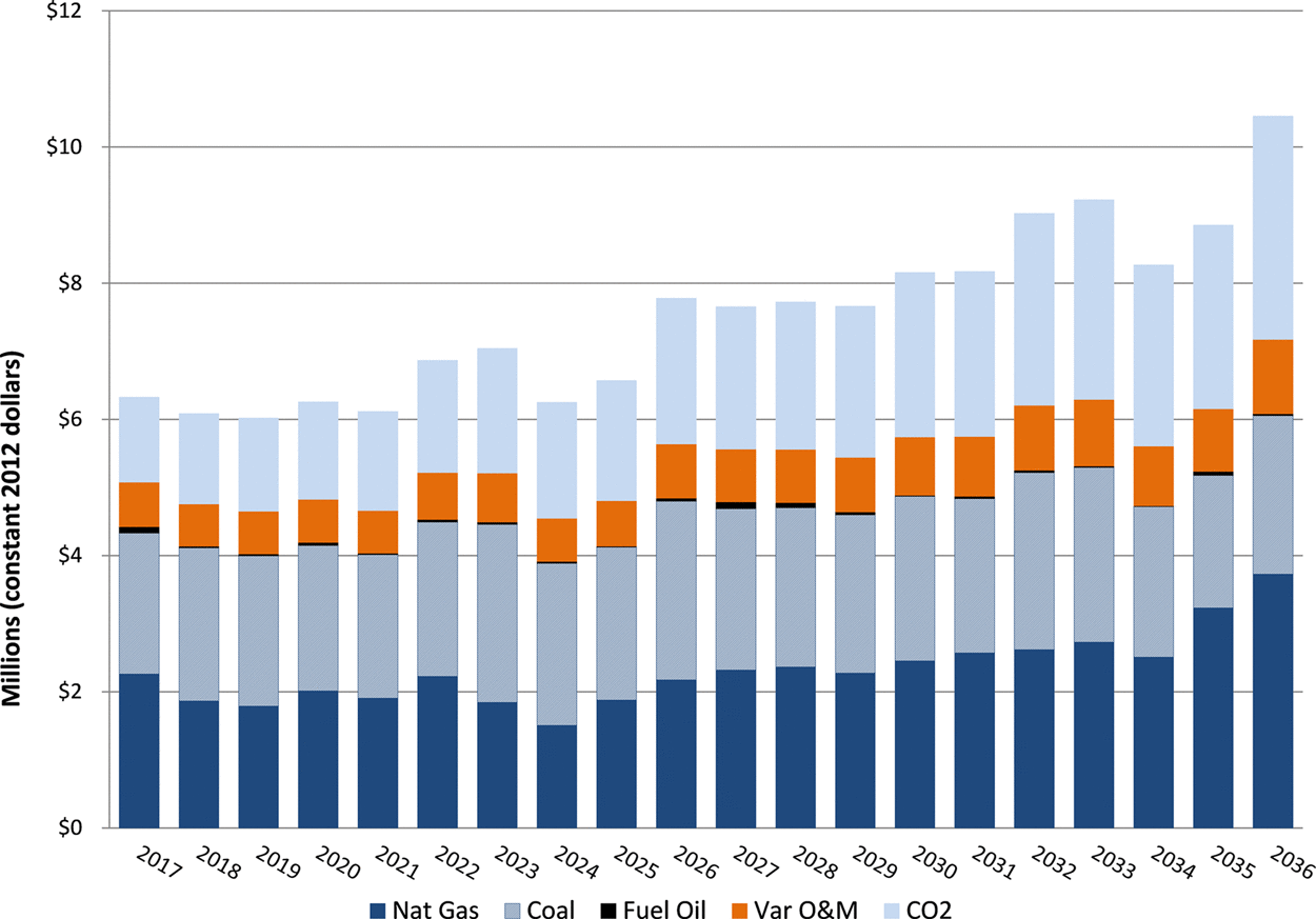

Fuel and CO rice assumptions
Numerous energy industry consulting firms and government agencies maintain fuel price projections and potential CO  allowance price scenarios. We used delivered fuel price projections for the power sector in the South Atlantic region of the US developed by the EIA for its Annual Energy Outlook publication [15]. For CO  prices, we used EIA's medium case trajectory from the Annual Energy Outlook and assumed CO  compliance begins in 2017.
Production cost modelling results
Fig shows the estimated annual production cost savings resulting from wind farm operation, broken down by cost category. Annual savings range from just over $6 million in the first year of wind farm operation to over $10 million in 2036.
Fig 2: Avoided costs of conventional electric power generation
