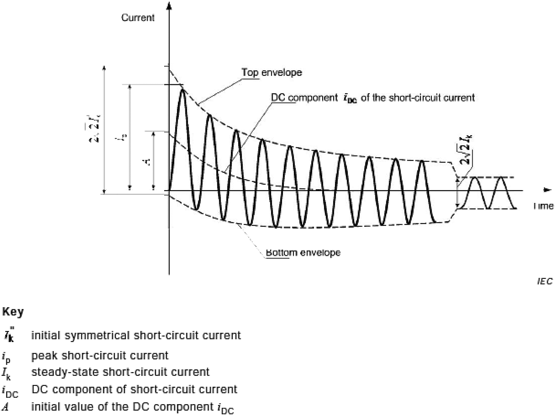

Fig. 1 Short circuit current of a near-to-generator short-circuit with decaying AC component
Fig 1 Short circuit current of a near-to-generator short-circuit with decaying AC component
This well-known curve indicates the behaviour of a three-phase fault, and shows how the AC fault changes over time. The short-circuit current in the first few cycles is all of a similar magnitude, but it decays with time as the DC component drops off; as time progresses, the magnitude of the AC fault drops off further as the synchronous generators move from sub-transient, to transient and then steady state. The implication of the DC offset is twofold, first, the peak short-circuit current is increased and second, the root mean square break current, at the point of the circuit breaker contact separation is also increased.
Reviewing the curve in Fig , it should make it apparent that there is also another factor in play; and this is the time when the circuit breaker opens. If a circuit breaker is fast acting and operates at around 20 ms, it will be subjected to a much higher percentage of DC component than a slower circuit breaker that operates at around 100 ms, because the DC component will have had a chance to decay. In practice, most circuit breakers will usually operate within 50–100 ms, so under normal circumstance the DC component will have had chance to decrease by a significant portion, such that the fault current appears either with a small DC offset.
The area of interest for short circuit studies is primarily when the DC component decays more slowly than normal, or when the operating time of the circuit breaker is fast; as the fault level experienced by the circuit breaker appears to be much higher due to the higher percentage of DC component. In this case, the circuit breaker is placed under increased duty, and can potentially put people and the system at risk, as it may not be able to successfully break the fault current. The percentage DC component in the fault current is therefore the key variable that must be understood when undertaking short circuit studies.
In extreme cases the DC offset can be of sufficient magnitude that the AC fault current waveform does not pass through a current-zero for several cycles, and operation of the breaker must be delayed, or the circuit breaker will chop the current, or fail to extinguish the arc. Fortunately, delayed current zeros are unusual for smaller systems, and tend only to be encountered on large generating stations, but where a system has a very high XR ratio engineers should be alert to their possibility. A more detailed discussion of the implications of this phenomenon is beyond the scope of this article but when dealing with large power generation equipment engineers should be alert to this potential scenario.
It should therefore be clear that when undertaking a short-circuit study, there will almost always be a DC component in the fault current, and in most cases the value of this DC component is sufficiently low, that it does not affect fault current calculations. Where a fault current has a high DC component, this causes the symmetrical AC component of the fault current to be offset, making it appear larger. It is therefore important that any engineer undertaking short circuit studies understands the importance of the DC component and how it can potentially increase the duty on circuit breakers.

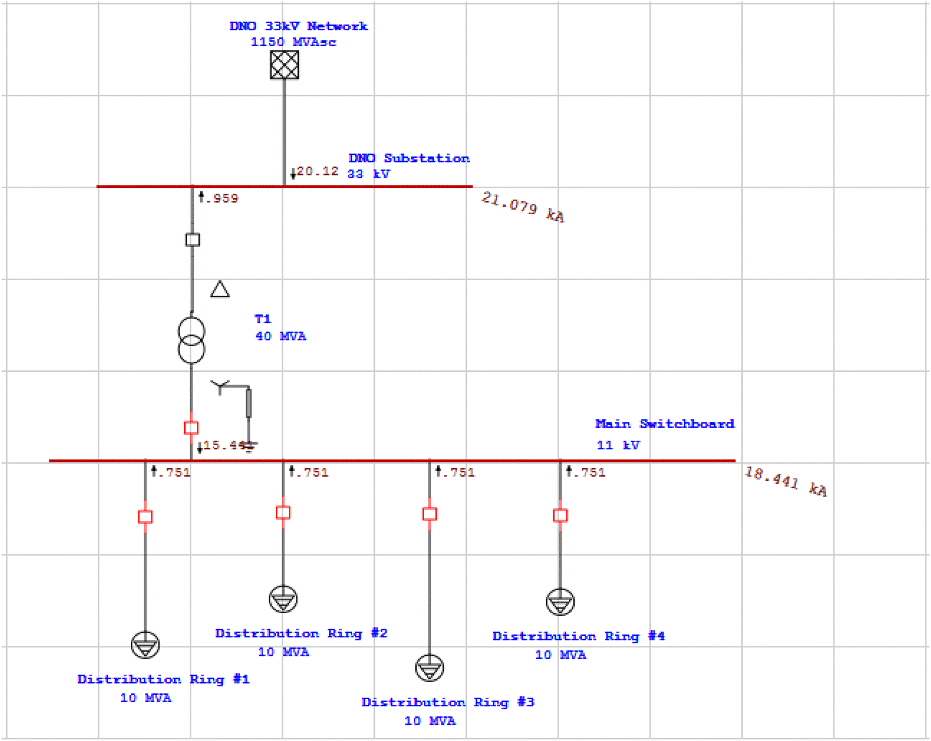

The discussion in the previous sections may have seemed remote from many day-to-day design projects, but it is important to realise that these concerns can appear on what seem to be comparatively simple systems. To help demonstrate this point, a few typical scenarios have been modelled using the computer simulation package ETAP.
The first example, as shown in Fig. 3 , is a part model of a simple 33/11 kV substation and associated 11 kV distribution rings. This is a configuration that would be encountered by many DNOs, or large customers who have their own 11 kV distribution system. On first review, this system appears straightforward, as there are no major motor load, no embedded generation, and only a single large 33/11 kV, z = 10%, 40 MVA transformer, supplying an 11 kV, 20 kA switchboard, with some back-fed 11 kV fault contribution (the 11 kV distribution detail is omitted for clarity).
Fig. 3 Simple substation fed by a large transformer modelled in ETAP
Fig 3 Simple substation fed by a large transformer modelled in ETAP

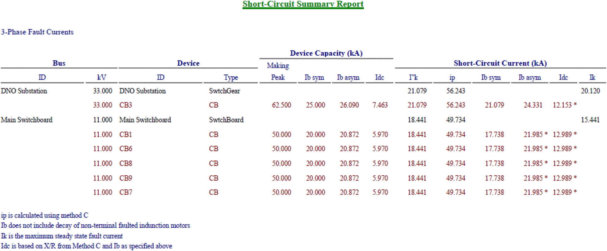

The test circuit shown in Fig. 3 is subjected to a normal IEC 60909 short-circuit study, with the results presented in Fig. 4 . It can be seen from Fig. 4 that the initial symmetrical short-circuit current ( I″ k) levels and break current ( I ) are high, but are within the equipment's rating by an acceptable margin. However, when a more detailed inspection of the output results is performed, it can be seen that the peak short circuit ( I ) current is nearly at the equipment limit, the asymmetrical break current ( I ) has been exceeded by over 1 kA and the DC current rating of the switchgear has also been exceeded.
Fig. 4 Simple substation fed by a large transformer ETAP short-circuit results
Fig 4 Simple substation fed by a large transformer ETAP short-circuit results
Normal hand calculations, or simple computer analysis programs of this system would have potentially missed these results, and an engineer giving only a cursory review of the system would not have identified the position. This could then have led to an unsafe operating condition, posing risk to both personnel and the system. Looking in more detail at Fig. 4 , the high asymmetric switching duty is primarily due to the transformer having a high XR ratio of 40, this leads to a long network time constant and slow DC decay. This simple example highlights a very common scenario at larger substations, where the simple presence of a large transformer can cause problems. In practice many substations of this nature, could have the problem exacerbated by the presence of embedded generators, or motor load downstream on the 11 kV network, which would further increase the fault level.

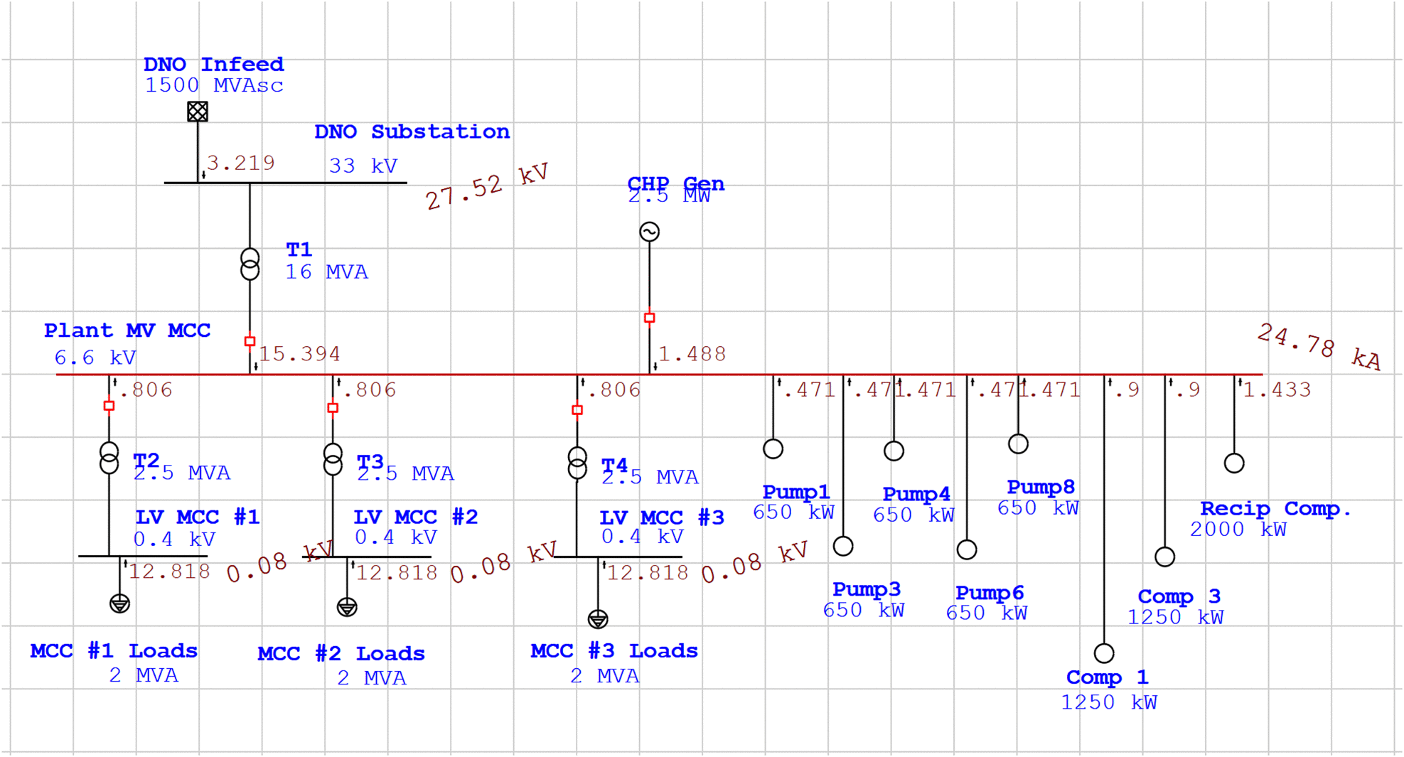

A second example is shown in Fig. 5, which considers a small industrial plant with a main 6.6 kV, 25 kA switchboard, containing several large MV motors, a small embedded generator, several LV MCCs and a utility infeed from a 33/6.6 kV, 16 MVA, z = 8% transformer. This a more complex plant, than the previous example, but is representative of the type of plant that industrial companies may operate.
Fig. 5 Typical industrial plant modelled in ETAP
Fig 5 Typical industrial plant modelled in ETAP

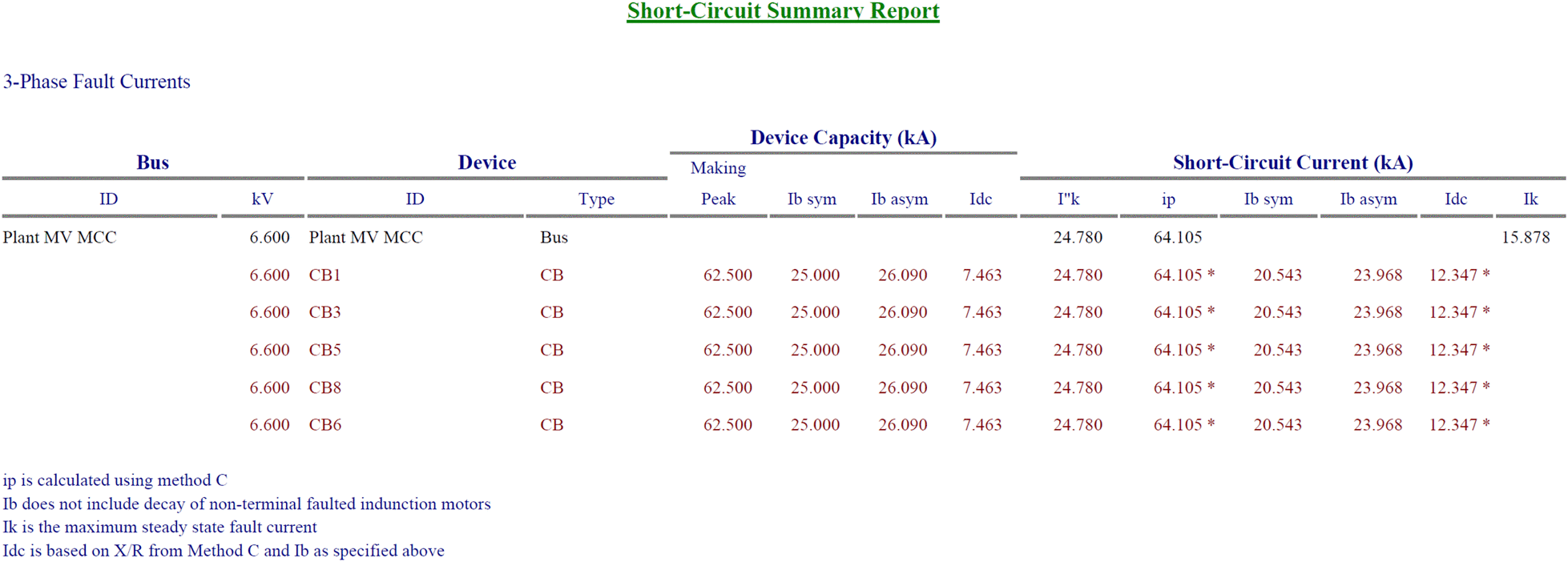

The test circuit shown in Fig. 5 is subjected to a normal IEC 60909 short-circuit study, with the results presented in Fig. 6. It can be seen from Fig. 6 that the initial symmetrical short-circuit current ( I″ k) levels, break current ( I ) and asymmetrical break current ( I ) are high, but are within the equipment's rating by an acceptable margin. However, it can be seen that the peak short circuit ( I ) current has been exceeded by nearly 2 kA and the DC current rating of the switchgear has also been exceeded
Fig. 6 Typical industrial plant modelled in ETAP short-circuit results
Fig 6 Typical industrial plant modelled in ETAP short-circuit results
As with the previous example, normal hand calculations, or simple computer analysis programs would have potentially not picked up this condition. Looking in more detail in Fig. 5 , the high peak current is due to the combination of transformer, MV motors and generator, with some contribution from the LV system. This is a more complex example, but shows how it is important to consider the peak fault current as well as the break current.

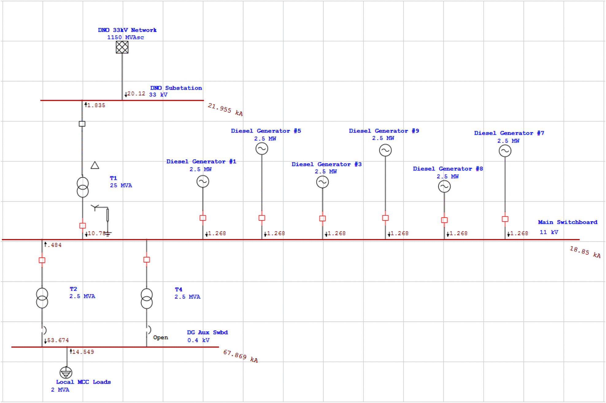

A third example, as shown in Fig. 7 , considers a small 15 MW peak matching generation station, containing an 11 kV, 20 kA switchboard and six small 2.5 MW diesel generators, which are connected to the DNO network via a 33/11 kV, z = 10%, 25 MVA transformer. The presence of a large amount of directly connected generators should be an immediate flag for any system designers and an indication that the fault levels could be problematic.
Fig. 7 Simple peak matching DG plant modelled in ETAP
Fig 7 Simple peak matching DG plant modelled in ETAP

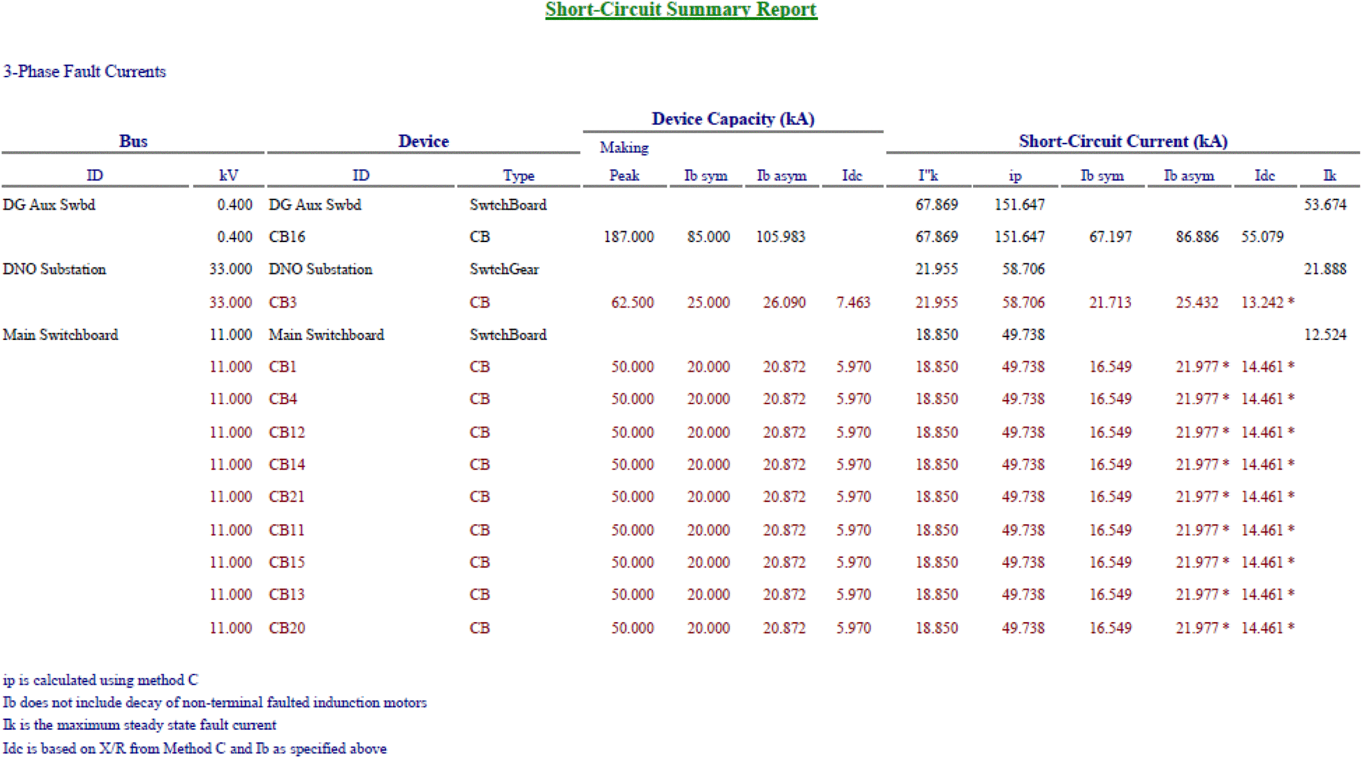

The test circuit shown in Fig 7 is subjected to a normal IEC 60909 short-circuit study, with the results presented in Fig 8. The results are similar to the first example and it can be seen from Fig.  8 that the initial symmetrical short-circuit current (I k) levels and break current (I ) are high, but are within the equipment's rating of 20 kA by an acceptable margin. When a more detailed inspection of the output results is performed, it can be seen that the peak short circuit (I ) current is nearly at the equipment limit, the asymmetrical break current (I ) has been exceeded by over 1 kA and the DC current rating of the switchgear has also been exceeded.
Fig. 8 Simple peak matching DG Plant ETAP short-circuit results
Fig 8 Simple peak matching DG Plant ETAP short-circuit results
This scenario is much less common, but as with the other it is also a deceptive case, as hand calculations, or a simple computer analysis programs would have potentially not picked up this problem, and led to an unsafe operating condition, posing risk to both personnel and the system. The asymmetric switching duty is caused by a combination of the transformers and generators both having high XR ratios, which combine to cause an overall XR ratio on the 11 kV busbar to become high, leading to a longer network time constant and a slow DC component decay.
