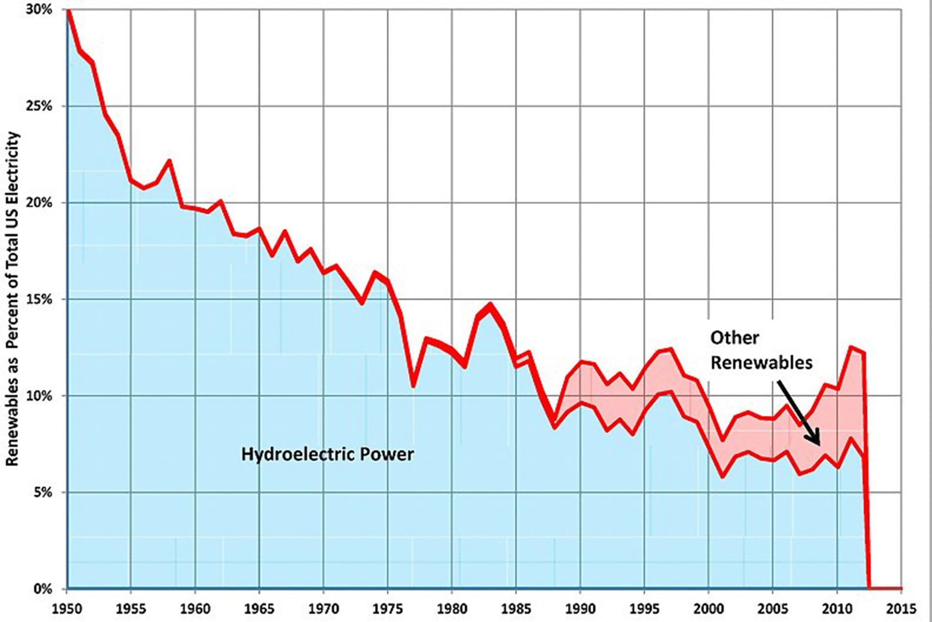

Fig 1: Electricity generated from renewable energy sources from 1950 to 2013 [4]
To estimate the extent to which US renewables can increase, many studies have examined their future potential [5–10] and predicted that they will either slightly or significantly increase. For example, the reference scenario shows that renewable energy sources for US electricity generation could comprise as much as 18% of total electricity production in 2040 (909 TWh of 5056 TWh) [6]; and another study forecasted that by 2050, they could account for as much as 80% [5]. Using commercially available techniques, both studies, while showing different growth rates, estimated that US renewables would continuously increase. Therefore, the objective of this article is to (a) examine the recent trends in renewable energy sources for electricity generation in the US and (b) discuss the projections of their future. For this purpose, this article initially examines the current activities devoted to US renewable energy sources in the following order: hydroelectric, wind, biomass, PV, and geothermal energy sources. Then, it compares several case studies that forecast their potential and success. This article is organised as follows: ‘Renewable energy resources in the US’ section introduces the current status and future potential of hydroelectric, wind, biomass, PV, and geothermal electricity generation. ‘Future renewable energy resources in the US’ section summarises the future potential and predicts the success of US renewables. Finally, ‘Conclusion’ section presents the major conclusions of this article.

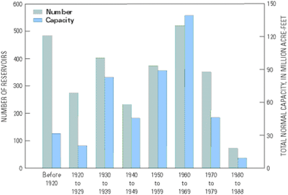

Fig 2: Number and total capacity of large reservoirs in the US [12]

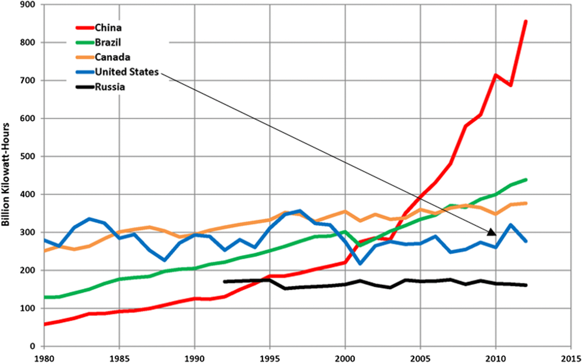

Fig 3: Top five hydroelectricity producing countries [13]

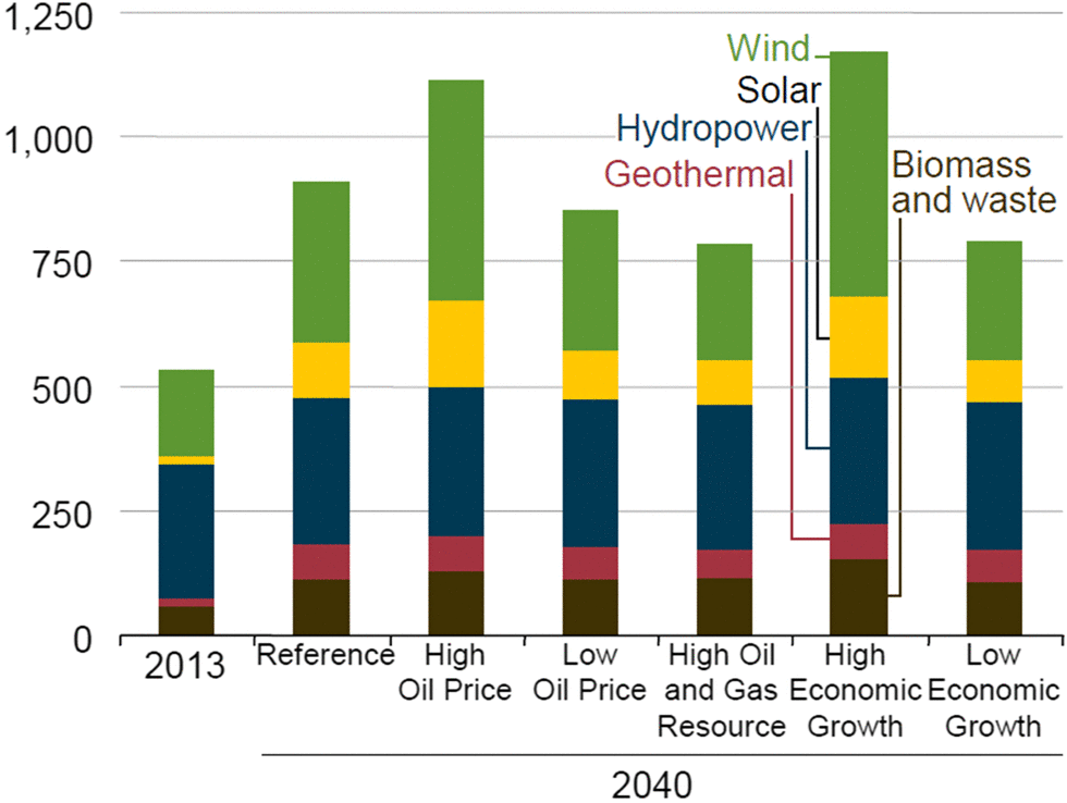

To project the long-term future of US renewables, including hydropower, the US Energy Information Administration modelled the national future energy portfolio of a reference in six cases, shown in Fig 4: low-economic growth, high-economic growth, low-oil price, high-oil price, and high-oil and gas price cases. The figure shows that using the projection model, the model estimates that in the reference case, US hydropower will produce 297 TWh in 2040, 5.9% of total electric power generation in the US in 2040 (e.g. 5056 TWh), and 32.7% of total renewable power generation (e.g. 909.1 TWh). Their net generation capacity will be 80.4 GW, 6.9% of total net generation capacity (e.g. 1170 GW), and 29.2% of total renewable generation capacity (e.g. 275.2 GW) [6]. Using the Regional Energy Deployment System (i.e. an economic dispatch model developed by the National Renewable Energy Laboratory), another study projects that if renewable energy sources for electricity generation could supply about 80% of total US electricity generation (referred to as the 80% renewable scenario) in 2050, a cumulative installed capacity of US hydro power plants could increase to between 81 and 170 GW, which corresponds to 8.3–16% of the overall renewable electricity generation capacity of the US projected in 2050 [5].
Fig 4: Projection of renewable energy sources for electric power generation in TWh in 2040 [6]
Owing to its geographical- and water-dependence, US hydropower production appears to remain relatively constant or increase slightly during several decades, as shown in Fig 4. Note that in all six future cases, production remains relatively constant. Therefore, the following strategies could be effective:

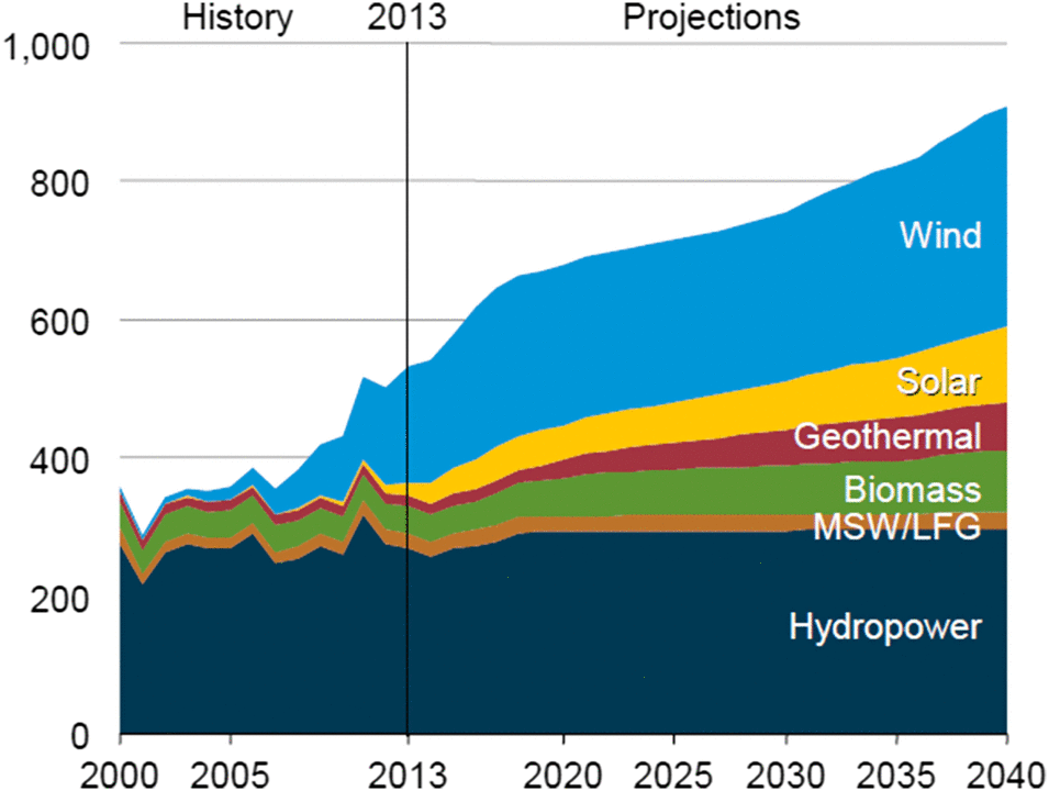

Fig 5: Projection of renewable energy sources for electric power generation in TWh (in the reference scenario) [6]
Unlike in previous years, the US wind industry experienced a busy year in 2015. In the first quarter of 2015, the country installed 68 wind turbines with a capacity of 131–110 MW in Texas alone. On a national scale, wind power plants with a capacity of more than 13,600 MW were under construction in 23 states: more than 7800 MW in Texas, 890 MW in Oklahoma, 870 MW in Kansas, 680 MW in New Mexico, and at least 500 MW in Illinois, Iowa, and North Dakota [16]. In addition, total power purchase agreements (PPAs) signed by utilities and their customers during 2013–2014 were <11,300 MW [16]. New PPAs of 750 MW were signed in early 2015 [16] and previously signed PPAs of 5000 MW will begin construction in 2015 or 2016 [7]. These PPAs include long-term contracts of Dow Chemical (200 MW), Walmart (50 MW), Google Energy (43 MW), and Kaiser Permanente (43 MW) for wind turbines in their data centres [16].

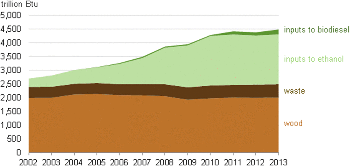

Fig 7: Biomass energy consumed from 2002 to 2013, by type of material [20]
Future status of biomass power generation
The steady growth of the US biomass power industry, including the rapid growth until the early 1990s, is the result of the following: (a) biomass power generation can be used for base load, dispatchable power, or cogeneration; (b) biomass fuel (e.g. agricultural residues, forest residues, wood waste, mill residues, and energy crops) is abundant in many areas of the US, particularly the midwestern states; and (c) the costs of generating electricity from biomass material are relatively low compared with the costs of generating other renewable energy sources such as geothermal, PV, fuel cell, and microturbine sources [17]. Therefore, many studies have predicted that biomass power generation in the US will increase in the next few decades. For example, one study estimates that US biomass power generation will produce 113.1 TWh in the reference case in 2040, which corresponds to 2.2% of total electric power generation of the country in 2040 (e.g. 5056 TWh) and 12.4% of total renewable power generation (e.g. 909.1 TWh). In 2040, its net generation capacity will be 15.4 GW, accounting for 1.3% of total net generation capacity (e.g. 1170 GW) and 5.6% of total renewable generation capacity (e.g. 275.2 GW) [6]. Another study estimates that in the 80% renewable scenario, the US biomass power industry will have a cumulative installed capacity of 52–98 GW, which corresponds to 7.9–15% of overall US renewable electricity generation capacity in 2050 [5]. Therefore, US biomass will be a steady source of electricity generation (e.g. at an average growth rate of 3.1% in generated energy [in TWh] and 1.1% in capacity [in GW] between 2013 and 2040 [6]).

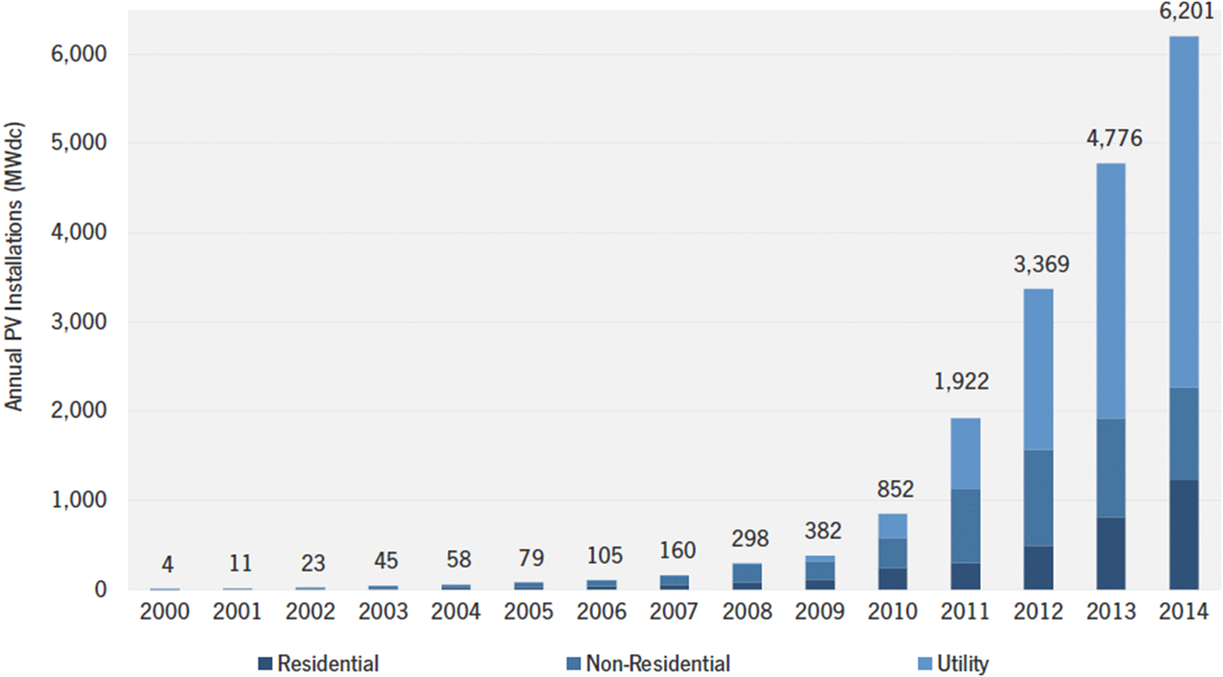

Fig 8: Annual PV capacity of newly installed systems in the US [22]
As shown in Fig , the US solar PV industry has grown dramatically during the past decade, even during difficult economic times. The reasons for such rapid growth include the following:
  • Falling PV module prices: The prices of PV modules decreased by about 20% whenever cumulative PV module production doubled, shown in the learning curves regarding PV modules during the past three decades [23]. In addition, in 2014, total system prices decreased by as much as 10% as a result of a decrease in the prices of balance-of-systems [22].
  • Financial solutions and regulations: Many solar PPAs, which are contracts between producers or sellers of electricity and buyers regulated by the Federal Energy Regulatory Commission, are now being signed in many states. For example, California, a cumulative capacity of which is 10,695 MW (in June 2015), ranking first in the country, is now successfully utilising the benefits of PPA [24]. For example, the Multifamily Affordable Solar Housing Program (started by the California Solar Initiative) interconnected solar PV systems with a capacity of 20.5 MW to multi-family homes in 323 statewide projects [25]. In addition, users of residential and commercial solar systems can receive a 30% solar ITC, a federal policy that has been largely responsible for the expansion of the US solar PV industry. In fact, since the ITC was initiated in 2006, the US PV industry has experienced an approximate sixteen-fold increase in solar installations annually [26].

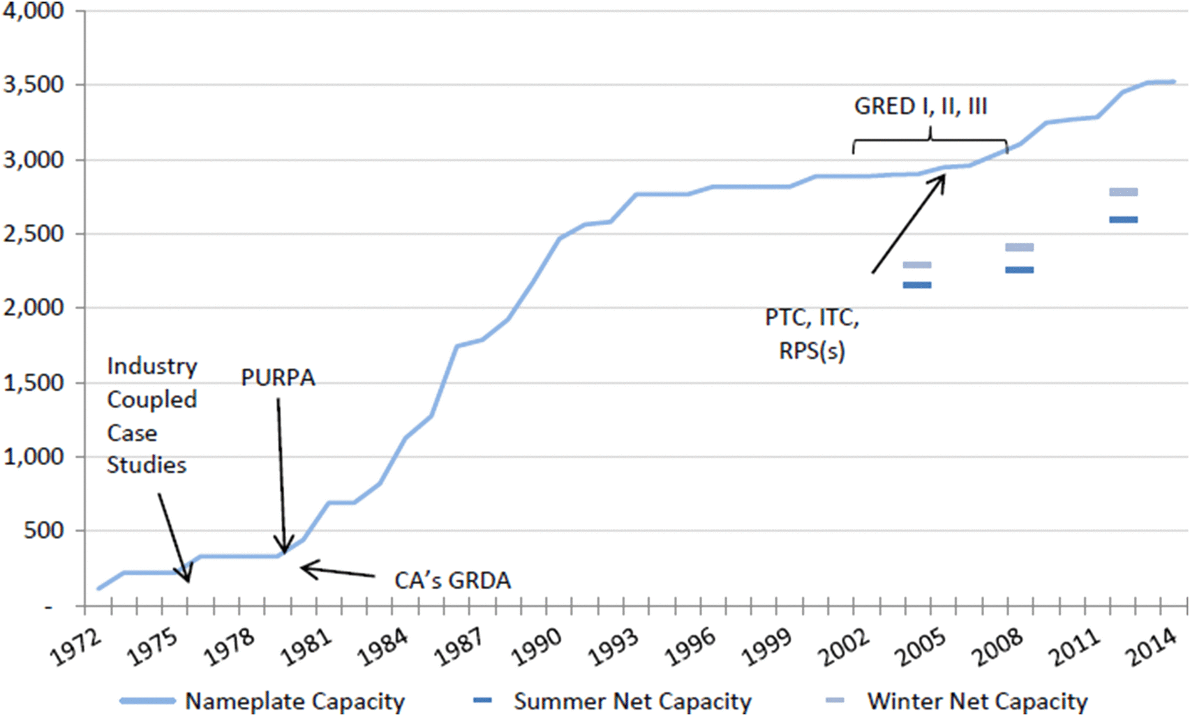

Geothermal power generation converts hydrothermal fluids (e.g. steam, water, and their heat or thermal production) generated or stored in the Earth into electricity. By the end of 2014, the US had reached a nameplate capacity of <3.5 GW and a net capacity of 2.7 GW [10]. In the 12 months prior to 31 March 2015, it had produced 16.76 TWh, <0.4% of total US electricity generation, and 3.1% of total US renewable generation, ranking fifth in the renewable energy sources of the country [11]. Fig 9, which shows the US geothermal nameplate and net capacity in MW during the past three decades, indicates that it has exhibited steady growth. However, in 2014, its growth was impeded by the following:
  • Low demand for new electric power generation: The growth rate of the demand for new electric power generation remained relatively low and even declined after 2000, as shown in Fig 10.
  • Uncertainty in legislation: In 2014, after the PTC debates, the US Congress extended the PTC, a corporate tax credit for the operation of renewable energy facilities for the first 10 years (e.g. 2.3 ¢ per kilowatt-hour for geothermal [ 28 ]) only until the end of 2014, so it has expired. Only the 10% ITC has been extended to the end of 2016 [ 29 ]. Therefore, the US geothermal industry, waiting for further acts of Congress that will determine the future of renewable energy policy, is reluctant to invest in, secure financing for, or develop new projects.
Fig 10: US geothermal capacity in MW [10]
Future status of geothermal power generation
As the generation of geothermal power remained relatively constant in 2014, a number of studies have predicted that it will grow more slowly than that of the other renewables for the following reasons:
  • Costs: Costs for new technology (e.g. for enhanced geothermal plants) are higher than those for conventional geothermal plants [30]. In addition, the costs of generating electricity from geothermal renewable energy are still higher than those of generating electricity from wind, biomass, and utility-scale solar energy [17].
  • Constraints of location and construction time: Geothermal plants, most located in the western US, have geographical constraints that require not only accessible and sufficiently large deposits of high-temperature groundwater but also accessible transmission lines. Thus, the estimated time necessary for constructing a geothermal plant is longer than that of other renewable energy plants [30].
As a result of cost, location, and time constraints, studies have predicted that the growth of the US geothermal power generation industry will be slow. For example, one study estimates that US geothermal power plants will produce 69.6 TWh in the reference case in 2040, 1.4% of total electric power generation in 2040 (e.g. 5056 TWh), and 7.7% of total renewable power generation (e.g. 909.1 TWh). Their net cumulative generation capacity will be 9.1 GW, 0.8% of total net generation capacity (e.g. 1170 GW) and 3.3% of total renewable generation capacity (e.g. 275.2 GW) [6]. Another study estimates that in the 80% renewable scenario, the cumulative installed capacity of US geothermal power plants will range from 12 to 25 GW, which corresponds to 2.1–4.2% of overall US renewable electricity generation capacity in 2050 [5]. According to these studies, the US geothermal industry will continue to grow for several decades but more slowly than other renewables such as wind, solar PV, and biomass energy.
