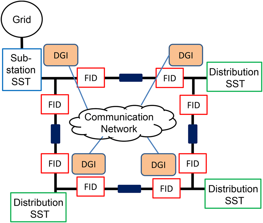

FREEDM distribution system
A key concept in the FREEDM system [ 13 ] is to flexibly integrate distributed generation and storage resources and to autonomously reconfigure the systems. Feeder operation should allow optimised incorporation of distributed resources, and support both grid-connected and islanded modes, i.e. microgrid capabilities. Power electronics play an important and enabling role (i.e. enhanced controllability) today already, and combined with new means of information sharing and communication, a decentralised means of system monitoring and operation is established. A graphical depiction of an example of the FREEDM system concept is shown in Fig.  .
Fig 1: FREEDM distribution system concept
Distributed controls at devices such as solid-state transformers (SSTs) [14] and fault-isolation devices are the core of feeder operation that is implemented through distributed grid intelligence (DGI) [15]. The embedded DGI devices run dedicated algorithms that establish new means for routing and sharing power, controlling voltage, and handling faults. The overall objective is to improve power and energy management capabilities and increase reliability.
The system as depicted in Fig 1, though with varying structures and number of components, was implemented in the form of a real-time testbed. As described in detail below, the electric power subsystems and communication network are simulated with dedicated tools and interfaced to embedded controllers.

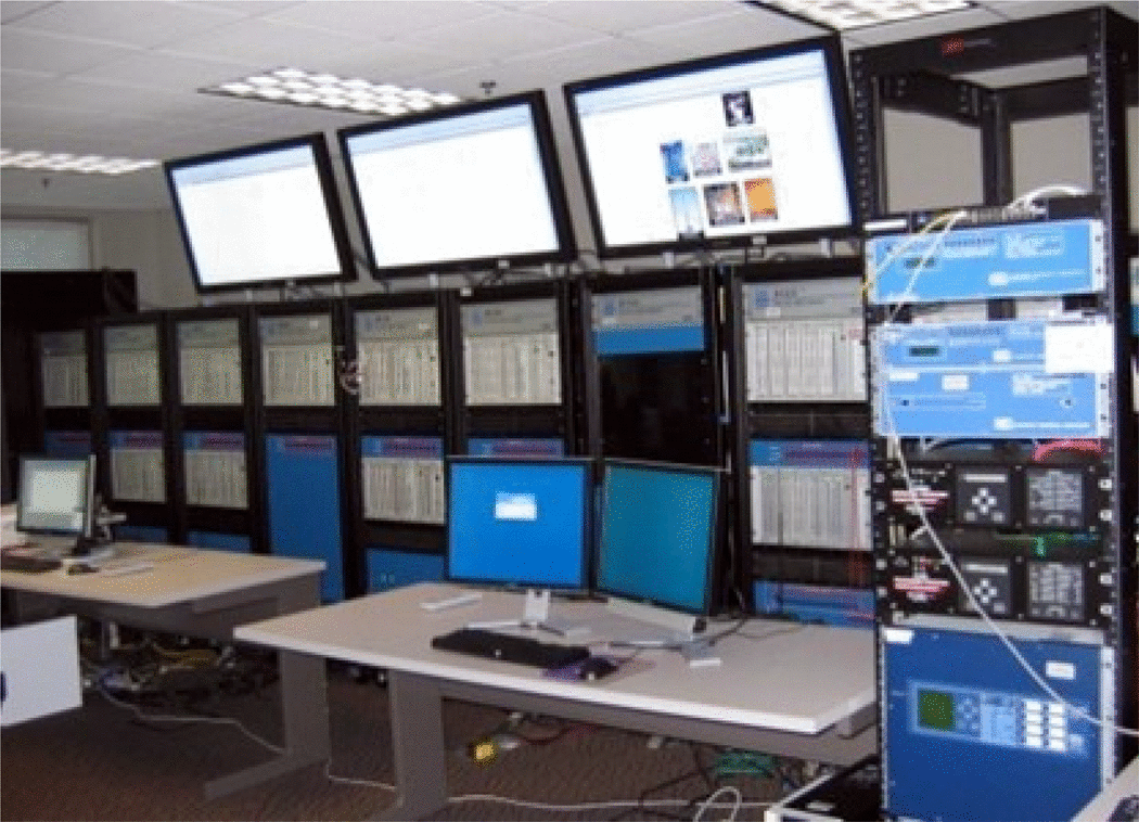

Real-time power system
The real-time simulation is realised through a dedicated real-time simulator (RTS) platform, the real-time digital simulator (RTDS®), see Fig [16]. The RTS is a parallel processing platform specifically designed for power system modelling and simulation. One of the fundamental differences to general computing platforms is the availability of and access to signals and measurements in both directions, i.e. analogue and digital I/O-capabilities. Furthermore, standard protocols such as Modbus, DNP3, and IEC 61850 are supported, and the possibility to develop custom extensions using field programmable gate arrays exists. This capability allows, e.g. to implement communication based on TCP and PCI express, which can be interfaced with the simulation at every time step.
Fig 2: RTS
The RTS has an accurate internal clock on its own, but it could also be synchronised through GPS to avoid time drifts in case of linking testbeds hosted at different sites. The discrete time step solver is typically executed with time steps of 50 µs for network, machines, and controls, and 2 µs for power electronics-based converters with pulse-width modulation-based controls. The system is designed to meet the real-time deadline and halts if the deadline is not met.

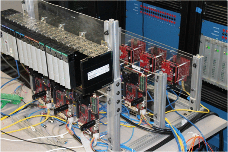

As distributed controls and algorithms are an integral part in the development process of the FREEDM system, embedded computation platforms and their integration into the testbed is a major objective. Several choices exist, but currently two commercially available solutions, one based on the Mamba x86- and one based on the ARM-architecture (see [18,19], respectively), are deployed. Both embedded platforms are operating with a modified Linux and a real-time scheduler (see Fig 3). These platforms allow rapid development and deployment of the envisioned concepts and come with support for multiple Ethernet interfaces and TCP/IP and UDP protocols.
Fig 3: Distributed control platform
The FREEDM distribution system development specifically concerns a distributed and autonomous concept that is referred to as distributed grid intelligence (DGI [20]). The DGI builds on SW agents that are computing nodes with the following features: (i) operate and manage power and energy distribution, (ii) reconfigure if necessary, and (iii) handle a subset of faults (i.e. faults that can be isolated) through reconfiguration to reenergise the feeder.
DGI components interface with SSTs – the power actuators – and are a means of operating and controlling at a higher system level. Local ‘brokers’ coordinate group behaviour and maintain state-of-the-system information, and part of the messages exchanged support making the SSTs plug-and-play capable, i.e. SSTs can become part of the system and leave through a defined process.

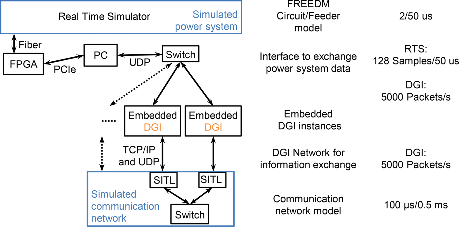

System integration
After introducing the salient components of the testbed, this section reviews the system integration aspects of building a coherent real-time modelling and simulation platform. A graphical overview of the FREEDM system testbed implementation is shown in Fig 4. The individual components included are the RTS, custom interface exchanging power system model data, embedded platforms with embedded DGIs, and the SW network simulator. In addition, the figure shows the timing information for the real-time testbed: the RTS is a hard real-time system with fixed time steps, the simulated network is soft real time, and the number of messages is a conservative limit experienced while testing. Examples included in the discussion section below provide experimental measurements of message throughput.
Fig 4: Integrated FREEDM system testbed and timing information
With respect to the subsystem performance, the RTS guarantees real-time execution or halts operation in case of time overruns. The DGIs are implemented on dedicated, embedded HW and execute using a scheduler that ensures that all tasks get a fair chance (i.e. avoids starvation). OPNET's performance simulating a network has been compared to a HW implementation and it does depend on the platform (using PC/Linux here), but experience shows satisfactory results for the networks of interest.
The modelled subsystems exchange data via a server-client-based communication model. Part of this process is a custom implementation to access RTS-values, which is feasible by direct access to data in digital format avoiding conversion to analogue signals.

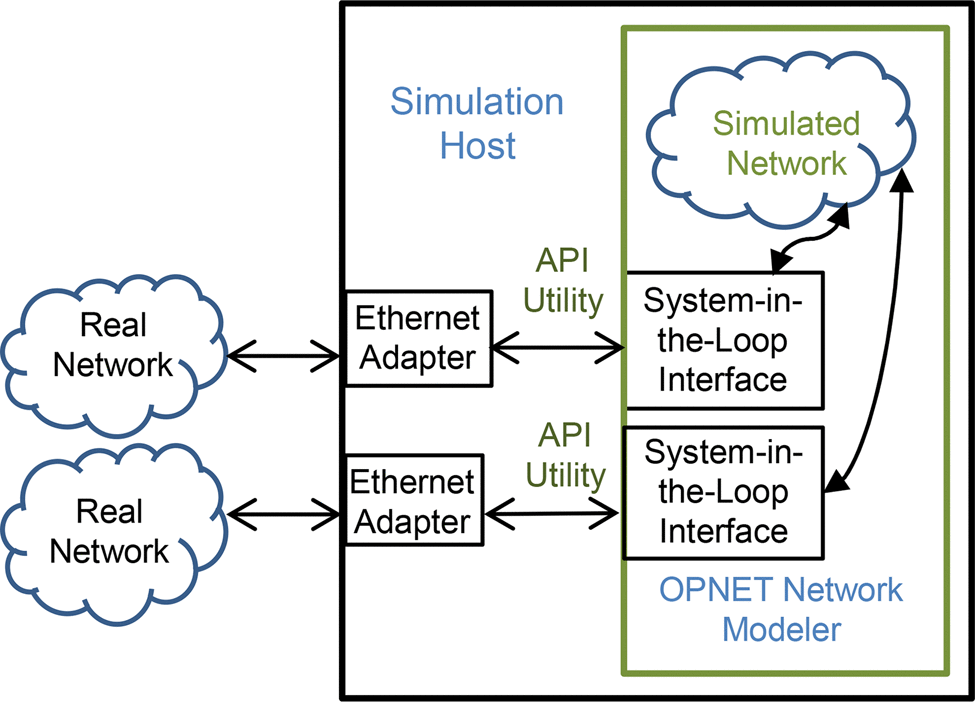

System integration aspects with respect to the communication networks are the following. Real (HW) networks and workstations/computing nodes interact with simulated networks. The networks are implemented via Ethernet, and the SW tool supports the ability to link multiple physical and SW networks. As shown in Fig.  , the simulation host is the workstation simulating a desired network in SW and exchanges data with physical (real world) networks.
Fig 5: Communication network system integration
Helper tools and Application Programmer Interfaces (APIs) are available for configuring simulation hosts, and SW libraries either exist or can be extended (best though C-code implementations) to implement a desired network in SW. Packet filters provide a means of configuring the simulated SW network during an operation.

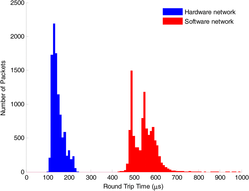

To evaluate the networked platform capabilities, example studies were performed and the following summarises salient features and characteristics. The first example evaluates the HW- and SW-based communication capabilities in a switch-based network. For the purpose of this test, the probing traffic is based on UDP packets of 1024 bytes between two embedded x86-nodes. The communication timing results for the HW- and SW-based implementations are depicted in Fig 6. As shown, the average communication round trip time for the HW-based network (150 µs) is about 400 µs shorter than for the SW-based (i.e. OPNET with 550 µs) implementation. The difference in round trip times is acceptable with respect to the intended applications of the cyber physical testbed.
Fig 6: Communication round trip times between two embedded x86-nodes using a switch-based network: comparing HW and SW implementations

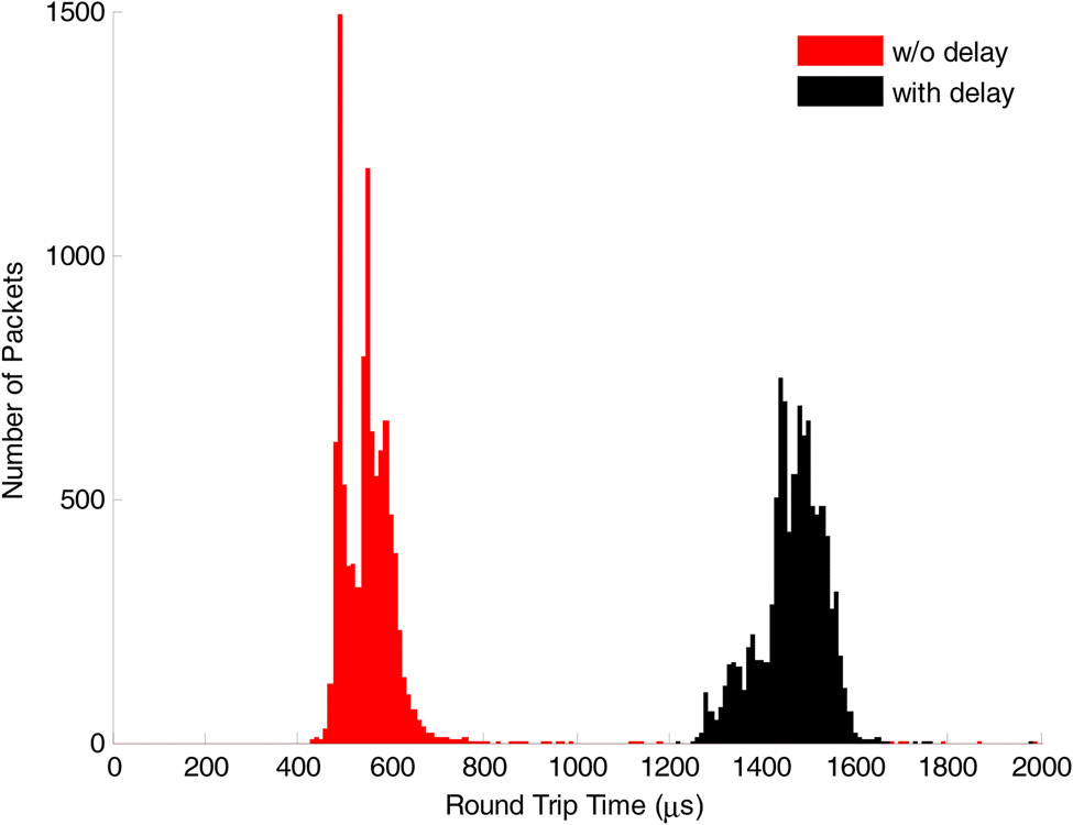

As a second example, the capability to introduce customary delays into the SW emulated network is evaluated. The network configuration and traffic are as described above, but a delay of 1 ms is introduced in the simulated network. The communication timing results are depicted in Fig 7, and these demonstrate that the delay is emulated as the round trip times increase from an average of about 550–1500 μs.
Fig 7: Communication round trip times between two embedded x86-nodes using a switch-based network: SW implementation without and with 1 ms delay

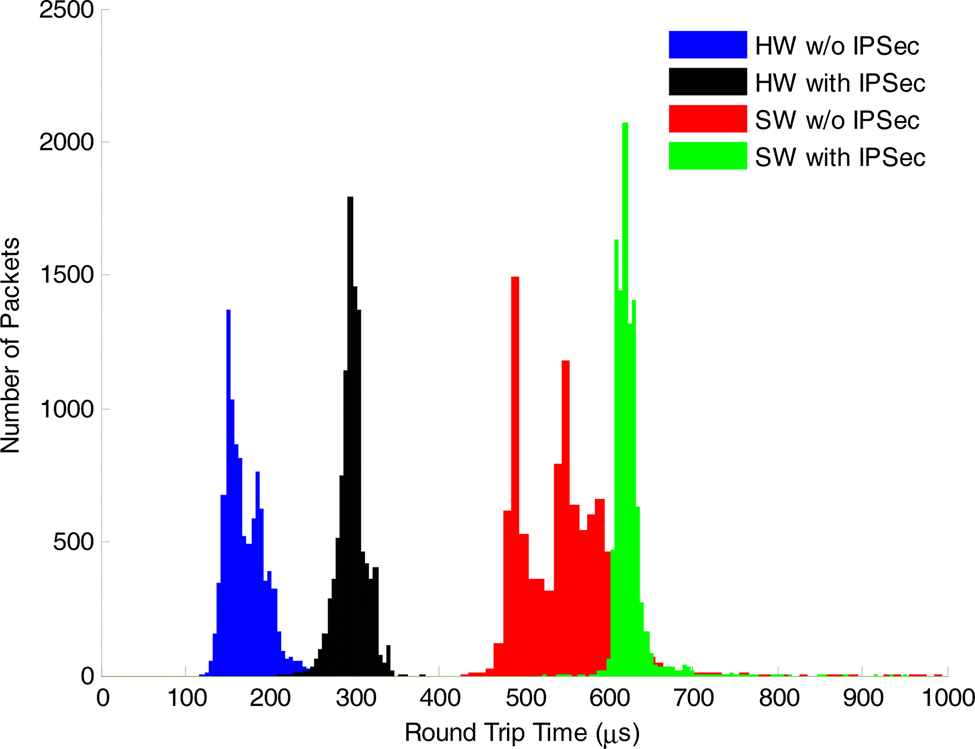

To provide authentication, data integrity, encryption and decryption for the DGI traffic, IPSec [21,22] is implemented on all the embedded x86-boards. As expected and shown in Fig.  , introduction of the IPSec increases the delay in communication between the nodes. The timing results of the SW-based implementations are appropriate for emulating the expected network traffic type and amount of the envisioned FREEDM distribution system.
Fig 8: Communication round trip times between two embedded x86-nodes using a switch-based network: HW and SW implementations without and with IPSec

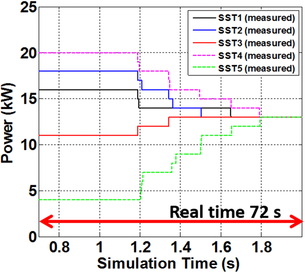

What challenges can and are being addressed by building and using this testbed? First, of most concern is the stability of algorithms as several new features are introduced to the FREEDM system concept, and convergence properties considering latencies need to be established. In case of discrepancies between the expected and testbed results, differences need to be investigated. As expected results are most often derived by using an analytical approach while making simplifying assumptions, the testbed provides a great means of ensuring validity of assumptions and expectations, and facilitates finding root causes of differences.
As an example the testbed helped uncover performance issues with DGI's distributed control algorithms, as convergence times for dispatching power were higher than expected and resulted in discrepancies between analytically determined and measured testbed values [23,24]. Figs and 10 show a comparison study that was performed when DGI was first ported to the embedded controllers on the HIL testbed. The data in Fig was recorded by the FREEDM team from MS&T and shows DGI executing its load balance algorithm (see [15] for details on the algorithm) with five distributed controllers participating. In this experiment, the distributed controllers were run on a Windows PC cluster, and the controllers interacted with a non-real-time PSCAD power system simulation. The total simulation time for the experiment was approximately 2 s, and required just over a minute to complete. In this experiment, the load balance operation completed in approximately 600 ms. Using the same initial conditions, and an identical power system simulation on the RTDS, a companion experiment was performed on the HIL testbed. While similar load balance behaviour is shown in Fig 10, the time required to complete the operation is markedly different. In the non-real-time test environment, DGI was able to complete its load balance operation in less than 1 s (∼600 ms). On the HIL testbed, DGI requires more than 20 s to accomplish the same task. These discrepancies were due to unanticipated latencies in the data communications network and the assumptions made in power system dynamics. These issues were missed earlier in the less realistic system verification environment.
Fig 9: DGI load balance operation performed in non-real-time environment
Fig 10: DGI load balance operation performed on HIL testbed at CAPS

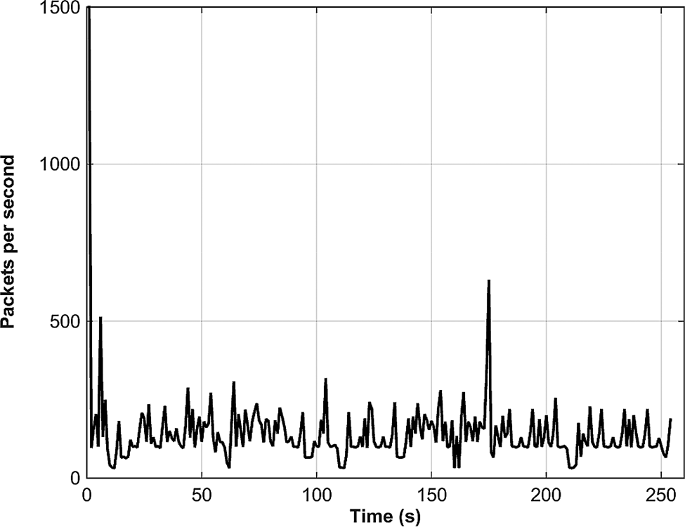

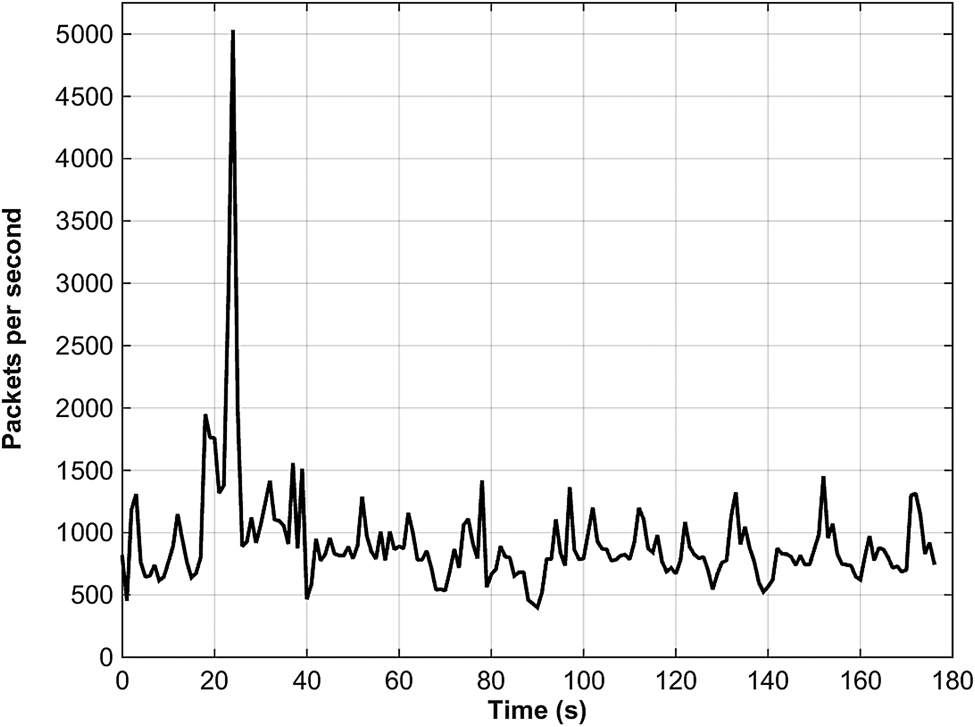

Another example concerns the network communication emulation capabilities of the HIL testbed. These capabilities allow to place embedded controllers in non-ideal (i.e. more realistic) operating environments. Figs 11 and 12 show the results of an experiment designed to investigate the quantity of network traffic generated by varying number of distributed control processes during routine operation. Fig 11 shows the quantity of network traffic per second generated by six distributed control processes, one on each of the Mamba embedded controllers, during a typical DGI load balance cycle. The six participating controllers communicate and coordinate their efforts as expected, and generate an average network traffic of 142 packets per second over the course of the experiment.
Fig 11: Testbed distributed controller network traffic measured using OPNET, six distributed control processes communicating
Fig 12: Testbed distributed controller network traffic measured using OPNET, 24 distributed control processes communicating
The number of participating distributed control processes was then increased to 24 in order to analyse how the network traffic scales. Fig 12 shows the quantity of network traffic per second generated by 24 distributed control processes, 4 on each of the MAMBA embedded controllers, during an equivalent DGI load balance cycle. Increasing the number of control processes by a factor of four resulted in an average network traffic of 920 packets per second. This represents a factor of 6.46 increases in network traffic.
The spikes in network traffic, shown in both Figs 11 and 12 represent periods in which DGI’s group management algorithm sends extra messages to coordinate group formation among peers. These traffic bursts occur at non-periodic intervals depending on the stability of the distributed controller groups. This network traffic data was measured using OPNET and provided verification of the suitability of the testbed to handle the maximum expected message traffic during network traffic bursts.
