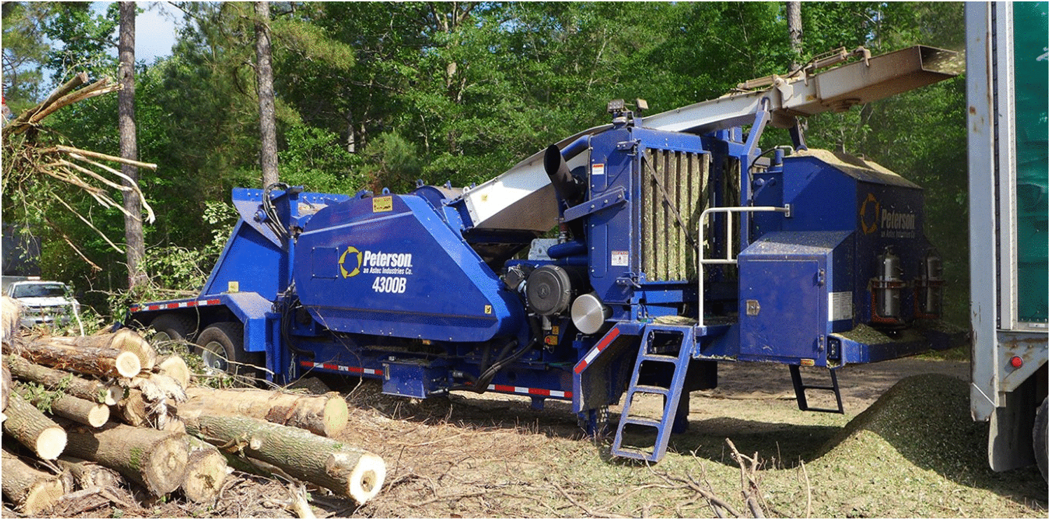

New generation of chippers
Historically, in-field disk and drum chippers produced a typical 2″ × 2″ × 1/4″ (50 mm × 50 mm × 6 mm) chip for pulp wood or hog fuel use. This is the predominate size, but there was a range of over and undersize too. The new generation of microchippers is finding use for the pulp and paper market and wood fuel market. An example of diesel powered drum microchipper is shown in Fig 1. Examples of these machines can be found on manufacturer's websites. Microchipper manufacturers include Peterson [5,6], Vermeer [7], Morbark [8] in the US and LHM in Finland [9].
Fig 1: Diesel powered whole tree drum type microchipper (courtesy Peterson)
For fuel and pulp markets, the chips are blown into a 20–23 ton (18–21 metric ton) chip van, which then goes direct to the end user or to a rail head if rail transport is employed for longer hauls. In northern Europe, the maximum gross truck weight limit is 76 metric tons (84 short tons)

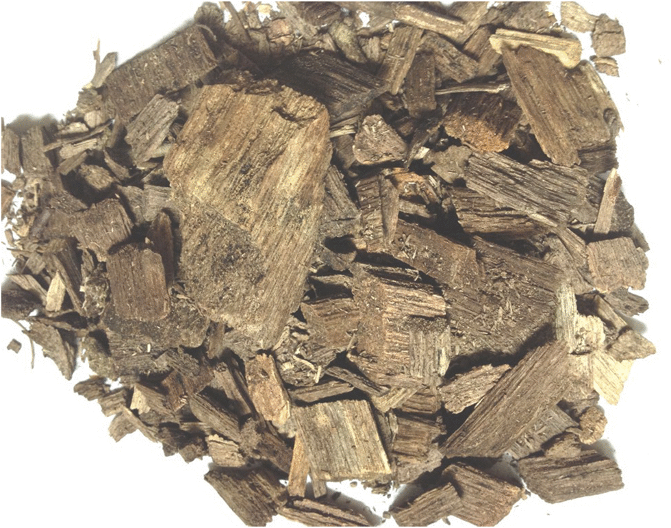

Fig shows both microchip fuel (at left) and wood pellets (at right). Fuel wood pellets are about 3/8″ (10 mm) diameter × 5/8″ (16 mm) long. Dry microchip fuel's smaller size makes drying much easier and faster (as compared with the old standard 2″ × 2″ × 1/4″ whole tree chips or 2″ hog fuel), getting the job done with shorter dryer residence time and smaller dryer shells. Combustion (including drying, devolatilisation/pyrolysis, carbonisation, and carbon burnout steps) is much more rapid for dry microchip fuel, due to the thinner 1/16″ against 3/8″ (1.5 mm × 16 mm) (one sixth the thickness) minimum dimension, and for some combustors, a final grind before the fuel entering the furnace may not be required for dry microchip fuel.

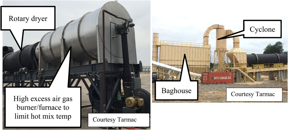

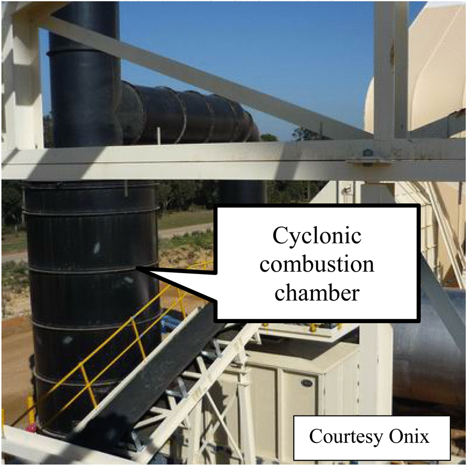

Drying is traditionally done in a direct fired rotary dryer followed by a cyclone and baghouse (Fig 4). High excess air or recycled flue gas is required to reduce hot gas temperature into the dryer and reduce the tendency to ignite embers that can burn pinholes in bag filters and start baghouse fires. When drying pine chips, an regenerative thermal oxidiser or other oxidiser maybe required to control volatile organic compounds (VOCs) and blue haze. Dryer fuels maybe natural gas, fuel oil or dry wood. Dry wood is usually burned in vertical cyclonic burners such as that shown in Fig 5.
Fig 4: Direct fired dryer, furnace, cyclone, and baghouse
Fig 5: Vertical cyclonic wood burner to supply hot gas to dryer

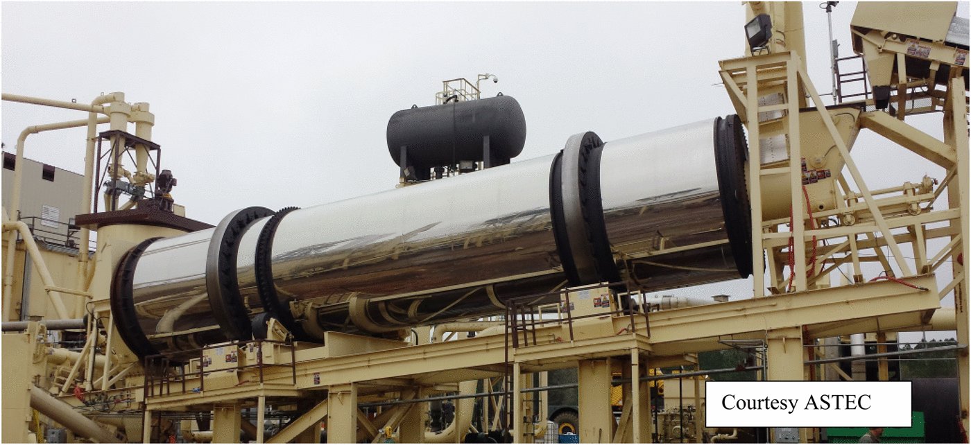

Another approach is to use an indirect fired hot oil or steam tube dryer, which reduces dryer exhaust flowrate and a small amount of tramp air (Fig.  ). This more concentrated exhaust can be taken into a burner and burned for fuel recovery to heat the hot oil or steam. If this is done, there is no need for a VOC oxidiser.
Fig 6: Indirect fired hot oil heated dryer

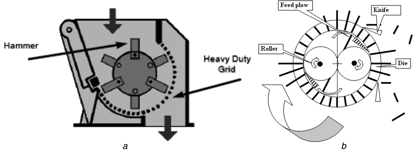

The production of dry microchips eliminates the pellet grinding step to ∼1/16th of an inch top size (1.5 mm) before passing it through the pellet mill. Fig a is a cross-section of a hammermill, where swinging hammers grind and break material up until it can pass through chosen size holes in an abrasion resistant grate. The pellet mills traditionally (as shown in Fig b) use internal rollers that force the ground and dried wood through thick rotating dies. Both the grinding and the pelletisation processes use considerable power (about 125 hp or 93 kW per ton per hour pellet production) for their motors. The coal-equivalent fuel used by an electric utility to produce power for such hammermills and pelletisers is equal to about 7% of the heat available in the pellet product. Both inlet moisture content and temperature control of the process is critical to make strong pellets. In terms of carbon dioxide (CO) emissions, the 125 hp per ton per hour to grind and pelletise would generate 216 lb (98 kg) of CO  per ton of pellets using coal-based electric power.
Fig 7: Hammermill and pellet mill
a Hammermill cross-sectional end view
b Rotary pellet mill cross-sectional end view
Reproduced with permission, biomass and alternate fuels systems: an engineering and economic guide, American Institute of Chemical Engineers (AIChE)/John Wiley & Sons, 2009

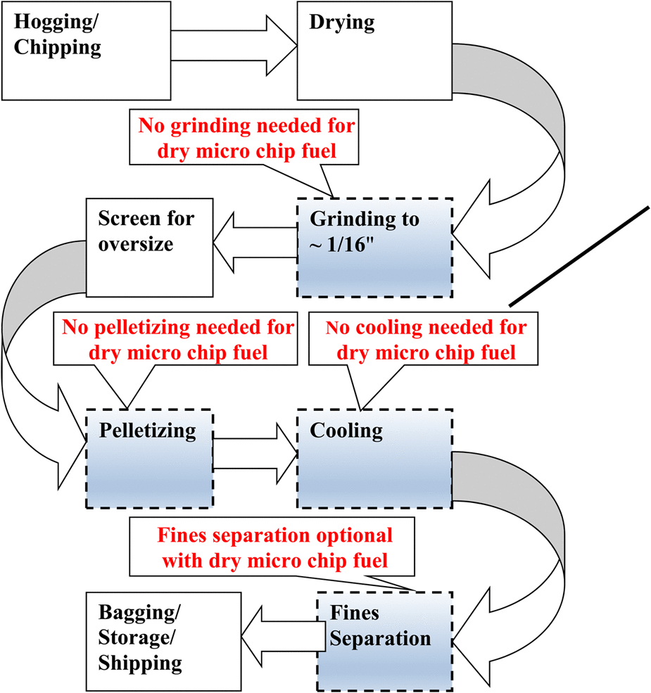

Fig 8: Flowsheet for pellets and differences for microchip fuel
How much more fuel does it take to transport the lower density fuel in larger volume/lower bulk density ships? A study done by the University of Iowa [13] for export grain shipments shows net ton-miles per gallon of fuel for various sized ships, with fuel use decreasing up as deadweight tonnage (dwt) goes up. Wood pellets in a dry bulk carrier at 1.8 million cu ft (50,000 m 3) capacity would load 40,000 short tons (36,400 metric dwt) at 45 lb/cu (720 kg/m 3) foot density. Dry microchips in a chip carrier with 3.6 million cu ft capacity ships would load 27,000 short tons (24,500 metric dwt) at 15 lb/cu foot (240 kg/m 3) density. Pellets would require 8.1 gallons (31 l) of fuel oil for the ship per ton transported versus 9.7 gallons (37 l) or 20% more fuel for ocean transport for dry microchip fuel for the 4500 mile (7200 km) trip. This transport fuel use is equivalent to about 9% of the energy contained in a ton of either wood fuel.
More detail on carbon footprint estimates can be found in [14].
Elimination of equipment from the flowsheet (the hammermill, multiple pellet mills, pellet cooler, interconnecting conveyors etc.) cuts purchased equipment cost by 57%. Total savings for power, maintenance, labour, reduced amortised cost of capital is in the range of $30–$35/ton of dry product. Estimates of the premium for transatlantic shipping of lower bulk density product via chip carriers suggest an added cost of $15/ton, resulting in a net savings on dry microchip fuel delivered to the EU of about $20/ton when compared with wood pellets.

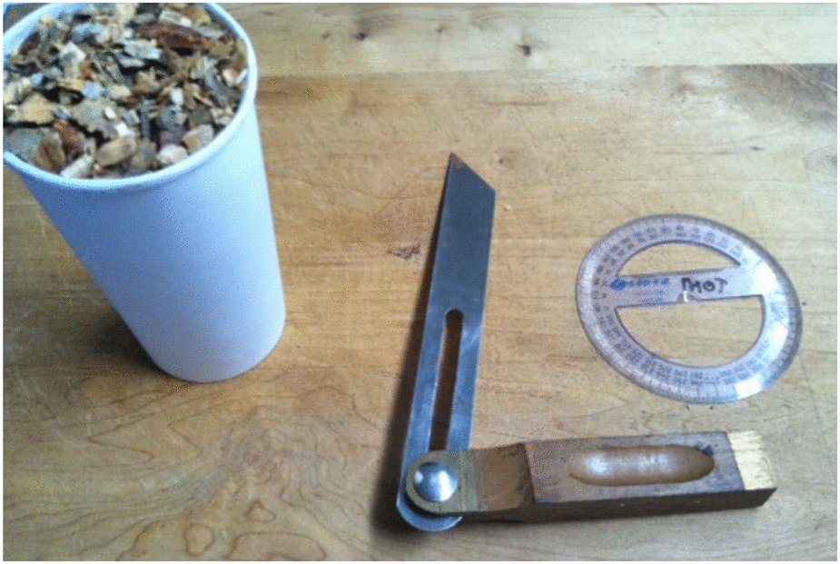

In-house testing was done on bulk density and poured angle of repose (see Figs and 10). The bulk density and angle of repose are reported in the above table.
Fig 9: Angle of repose testing tools
Fig 10: Poured conical pile of dry microchips

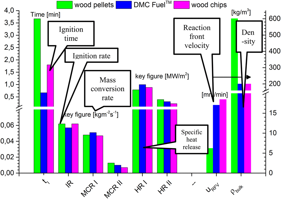

Combustion tests with a pilot scale grate burner were done by Karlsruhe Institute of Technology (KIT) wood pellets, larger, and slightly higher moisture content wood chips and DMC Fuel ®. Fig 11 shows the comparative combustion properties, with DMC Fuel® showing good potential for its use on grate type burners [15].
Fig 11: KIT combustion test results
