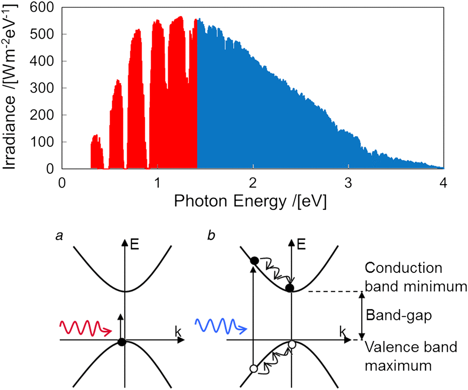

The broad spectral nature of sunlight results in this large efficiency penalty because a solar cell operates as a two-level system, with an energy gap (or band gap) separating a mobile (conduction band) and non-mobile (valence band) energy level. Light with energy equal to, or in excess of the band gap can be absorbed, promoting an electron to the mobile level for extraction, but any light with energy below the band gap is not able to be used by the cell. Similarly, because it is a two-level system, only the difference in energy between the two levels is able to be exploited. Light with energy in excess of the band gap is absorbed and contributes to the current, but the extra energy is lost as heat to the rest of the cell in a process termed ‘thermalisation’. These two loss mechanisms and the broad solar spectrum that gives rise to them are illustrated in Fig 1, with the energy gap plotted at the optimum value of 1.31 eV, which results in a maximum efficiency of 32.5% under single-sun illumination. All incident light which is of too low energy to be absorbed is shaded in red, and all light which is absorbed, but with a thermalisation loss, is shaded in blue. An illustration of how light with these energies interacts with our two-level system is shown below the spectral plot.
Fig 1: Top: Spectrum of sunlight plotted as a function of photon energy. Bottom: Energy–momentum diagrams for electrons in a semiconductor showing the effect of absorption of light with different energies
a No absorption of light with energy less than the band gap (red)
b Absorption of light with energy in excess of the band gap (blue) followed by energy loss to thermalisation
This limit represents a fundamental limit on conversion efficiency, with many groups approaching this limit and any further gains being made subject to a law of diminishing returns. With Sharp [2] and Panasonic [3] achieving efficiencies in excess of 25% in silicon photovoltaic cells and Alta devices of nearly 29% [4] in GaAs, if we want to achieve significantly higher efficiencies, it will be necessary to change the way solar cells operate. It is the aim of this paper to outline a few of the methods that could lead to higher efficiency cells and present a particular case study of our own work in developing a hot carrier photovoltaic cell.

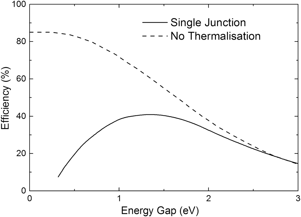

Fig 2 shows how much more efficient a solar cell can be if this extra energy can be used in the cell. In this figure, the efficiency of a cell under maximally concentrated solar illumination is plotted against the cell's energy gap, demonstrating that the maximum efficiency of 42% for a single junction cell is achieved at a band gap which balances the low-energy non-absorption loss with the high-energy thermalisation loss. However, if the thermalisation loss could be circumvented, then the optimum energy gap would be zero and an efficiency of 85% could, in principle, be achieved if we found some new way to exploit absorption in a material with no energy gap.
Fig 2: Efficiency of a single junction solar cell under full concentration as a function of its energy gap, with and without the loss of energy to thermalisation
Essentially, all the next generation concepts are methods to solve this issue and seek to either minimise or use this extra energy rather than waste it. The most prominent next generation concepts are briefly discussed in the following subsections and separate into two categories. Those which seek to minimise the extra energy given to the system on absorption, such as the multi-junction and intermediate band cells, and those which seek to exploit the extra energy given to the system, such as the multiple-exciton generating and hot carrier cells.

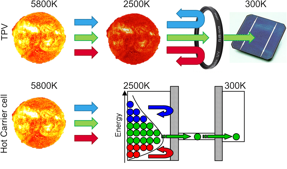

To further understand the concept, it is useful to compare the hot carrier cell with the thermophotovoltaic (TPV) system [11], another next generation concept which addresses the thermalisation loss, with both concepts schematically illustrated in Fig 3.
Fig 3: Comparison of the working scheme of a TPV setup (top) with a hot carrier solar cell (bottom)
In a TPV system, light from the sun is absorbed by an intermediate body, causing it to heat up and radiate. The radiation from the intermediate body is filtered such that only light optimally matched to the band gap of an adjacent solar cell is allowed to pass to it. The rest of the radiation is reflected back to the intermediate body and reheats it. This scheme has an efficiency limit of 85% as well [12], since it deals comprehensively with the thermalisation loss in the cell. However, to reach this efficiency limit, it presents several complex engineering challenges, not least to find an intermediate body and a filtering mechanism which can withstand temperatures up to 2500 K and avoid any other heat losses, such as to convection.
The hot carrier solar cell is similar to the TPV system, but instead of holding this energy as a lattice temperature it is held as an electron temperature after absorption of light from the sun. Electrons at an optimum energy are then allowed to leave this absorption region to a cooler region, while electrons at non-optimum energies are reflected back to reheat the rest of the electrons and repopulate the optimum energy level. In this way, it was shown as long ago as 1982 that this concept could reach 85% efficiency too [13].

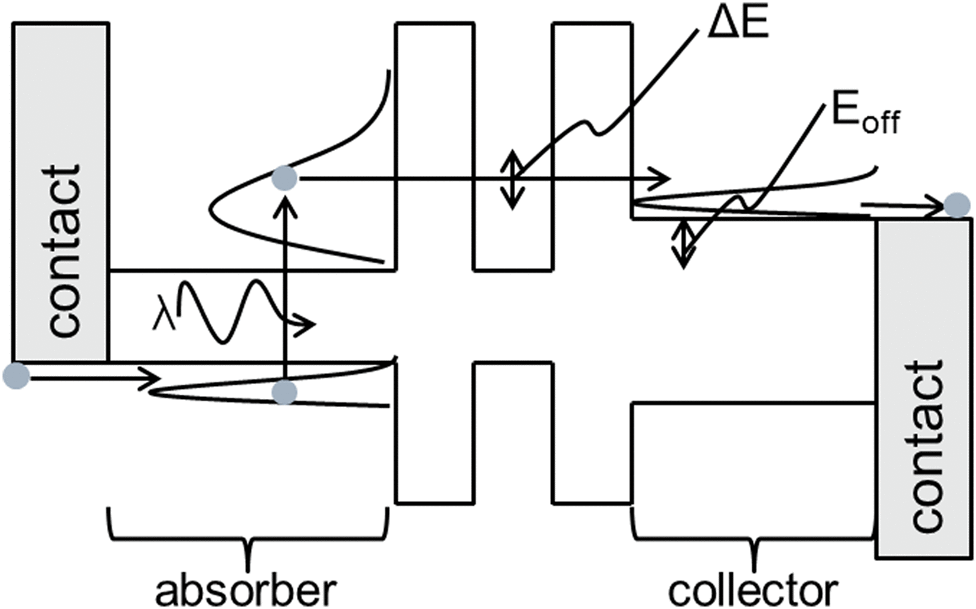

We have realised a hot carrier photovoltaic cell [22] by placing a quantum well between two semiconductor regions with different band gaps. The narrower band gap material is used as the absorber region, where hot electrons are photogenerated, and the wider band gap region is used as the collector region, with the electrons maintained at ambient temperature. The difference in band gap ensures that carriers can be photogenerated in only the absorber region, while the quantum well that separates the two regions gives ultrafast and energy selective transfer, through tunnelling, between them.
A schematic of our hot carrier photovoltaic cell design is presented in Fig 4, in which hot electrons are photogenerated in the absorber before being rapidly, and selectively, removed by tunnelling over an energy range Δ E. The energy range Δ E is the spread of energies around the confined state of the quantum well for which the transmission probability from the absorber to the collector is greater than 1/ e.
Fig 4: A schematic of the band structure of the hot carrier solar cell, showing extraction of carriers after photogeneration in an absorber region by fast tunnelling of a carrier to a collector region
This cell was realised in a prototype system in which GaAs was used as the absorber region and AlGaAs was used as the collector region, grown by molecular beam epitaxy. We then demonstrated that electrons could be extracted before they thermalised by illuminating the device with various different monochromatic wavelengths of incident light. Changing the wavelength of light changes the extra energy that the electrons have after being photogenerated, so demonstrating a wavelength-dependent signature in the current–voltage (IV) characteristics is important evidence of hot carrier operation.

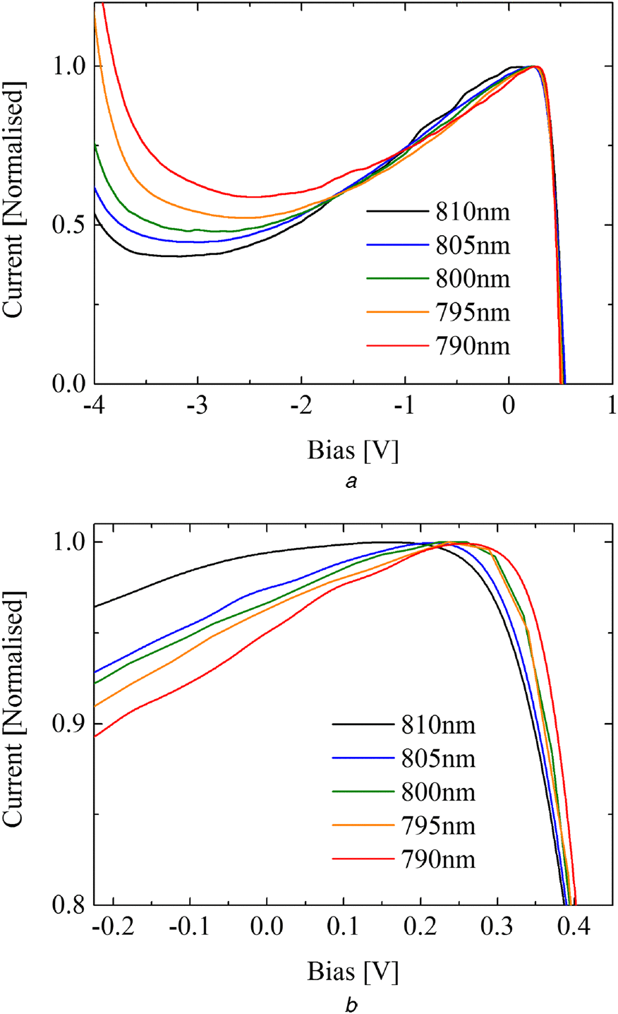

Fig 5 shows the IV characteristic of our cell at 93 K under illumination from 790 to 810 nm. Its characteristic peak and valley shape is similar to a resonant tunnelling diode, with the difference being that a current exists at zero bias in this device and thus power can be extracted from it. The IV curves in Fig  5 demonstrate two key effects showing evidence that hot electrons are being extracted. The current peak location and the current peak-to-valley ratio (PVR) in these curves are dependent on the electron temperature, with higher temperatures giving rise to a peak at a higher forward bias and also a lower PVR. The shift of the current peak to a higher forward bias for a higher temperature (shorter wavelength) is shown most clearly in Fig 5 b, which shows a magnification of the peak current region of the IV characteristic shown in Fig 5 a.
Fig 5: Experimental IV characteristics for the hot carrier cell
a The IV characteristic of our prototype hot carrier cell showing a wavelength dependence that indicates extraction of hot carriers
b A magnified section of the IV characteristic at the peak current region, highlighting the wavelength dependence of the bias of the peak current point
If the temperature of the electrons was the same, independent of wavelength of illumination, the IV characteristics would be identical and we could conclude that electrons were thermalising before extraction. The fact that we see a shift in the peak and the PVR with wavelength demonstrates that electrons are being extracted before they can thermalise fully in this device.
This demonstrates that a hot carrier cell is experimentally achievable and has recently been extended to study the carrier transfer processes in more detail and to use the hot carrier effect as a supplement to a standard field driven solar cell [23].
