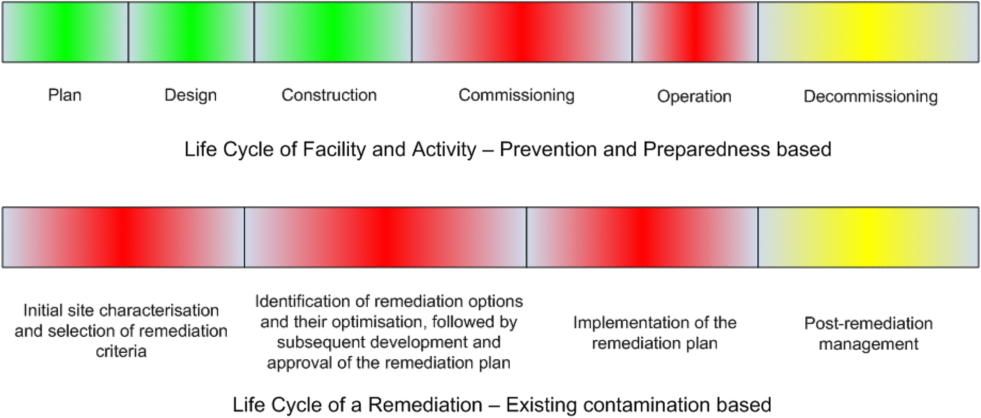

Fig 1 highlights that a site has a lifecycle, where in simple terms plants and facilities are planned and designed, constructed, operated and finally decommissioned. Remediation activities are often undertaken on cessation of a site's activities (and in many instances will be part of the decommissioning lifecycle) but as the drivers highlighted above show there might be a requirement for remediation at any stage within the lifecycle. So, as Table 1 shows the timing and the drivers for undertaking remediation are clearly interlinked.
Fig 1: Site/facility and remediation lifecycles (sourced from the IAEA)

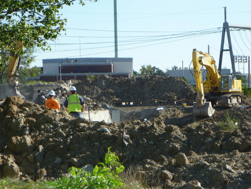

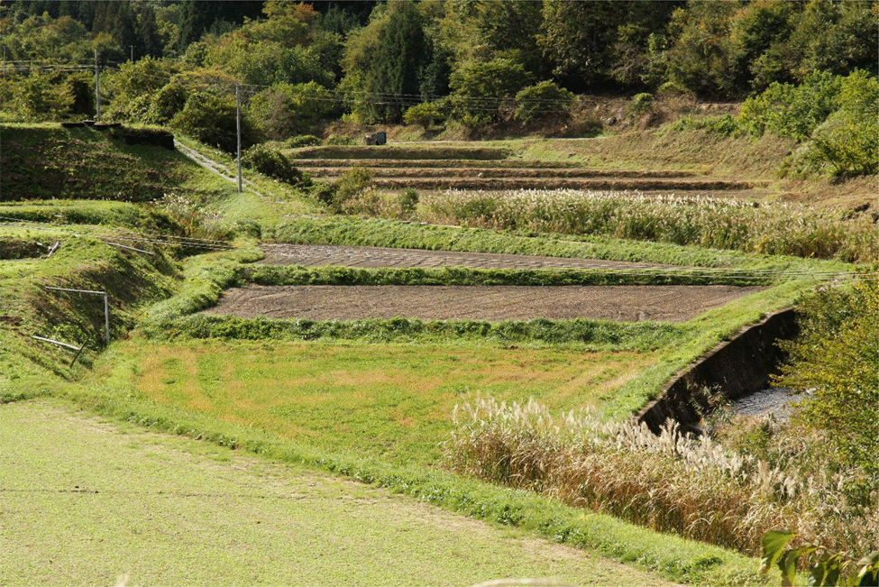

Contamination can be physically removed from the site through simple approaches such as conventional earth moving, scraping or turf removal and then moved offsite for disposal. This approach was extensively adopted in Fukushima. Fig 2 shows where paddy fields in Fukushima Prefecture have been remediated. At the Harwell site in Oxfordshire (UK), the chemical pits and beryllium pits were successfully remediated through a thorough characterisation and removal of waste materials. Contaminated soils underneath and adjacent to Building 330 which housed the Chicago Pile 5 reactor on the Argonne National Laboratory site near Chicago (US) were excavated and disposed of offsite. Fig 3 shows some of the characterisation and soil removal work taking place around B330.
Fig 2: Remediation of paddy fields in Fukushima Prefecture
Fig 3: Site characterisation and soil removal around B330 at ANL’s Chicago site

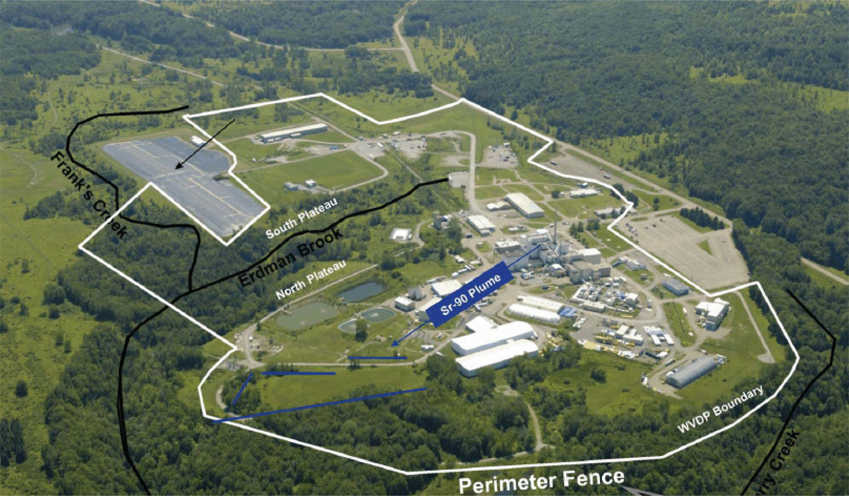

Contamination can also either be concentrated, treated and then subsequently removed through a series of remediation techniques such as physical separation, soil washing, pump and treat, electrokinetics, phytoremediation and chemical extraction. A permeable reactive barrier, for example, was installed at the West Valley Reprocessing site in the US in order to remove Sr 90. I believe that such an approach can be very successful for targeting groundwater plumes but the level of success depends heavily on the confidence in the site characterisation data and the choice of barrier design and reactive materials. Fig 4 shows the West Valley Reprocessing site depicting the area of the Sr 90 plume.
Fig 4: West Valley Demonstration Project (photograph courtesy of Erie Research Projects)

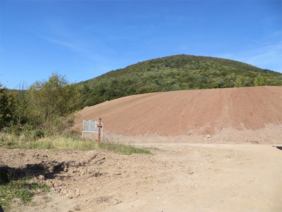

Fig 5 shows the result of remediation and landscaping work of rock piles and tailings at the Lisava mine in Romania, whereas Fig 6 highlights the remediation of uranium mining waste rock piles in Bad Schlema, Germany.
Fig 5: Remediated Lisava mine waste rock piles and tailings in the Banat region of Romania

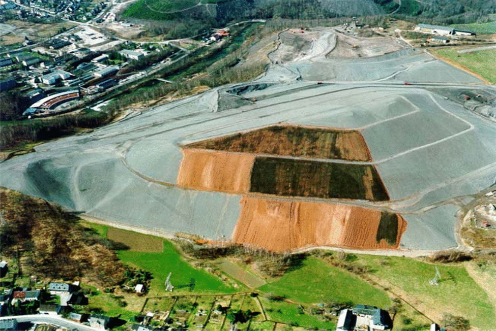

Fig 6: Remediation of rock piles at the Bad Schlema site
These kinds of sites all bring different kinds of challenges, especially where institutional control is not in place. A brief description of the accident at the Fukushima Daiichi NPP is provided below in order to highlight how the specific drivers for this situation dictated the remediation approaches taken.

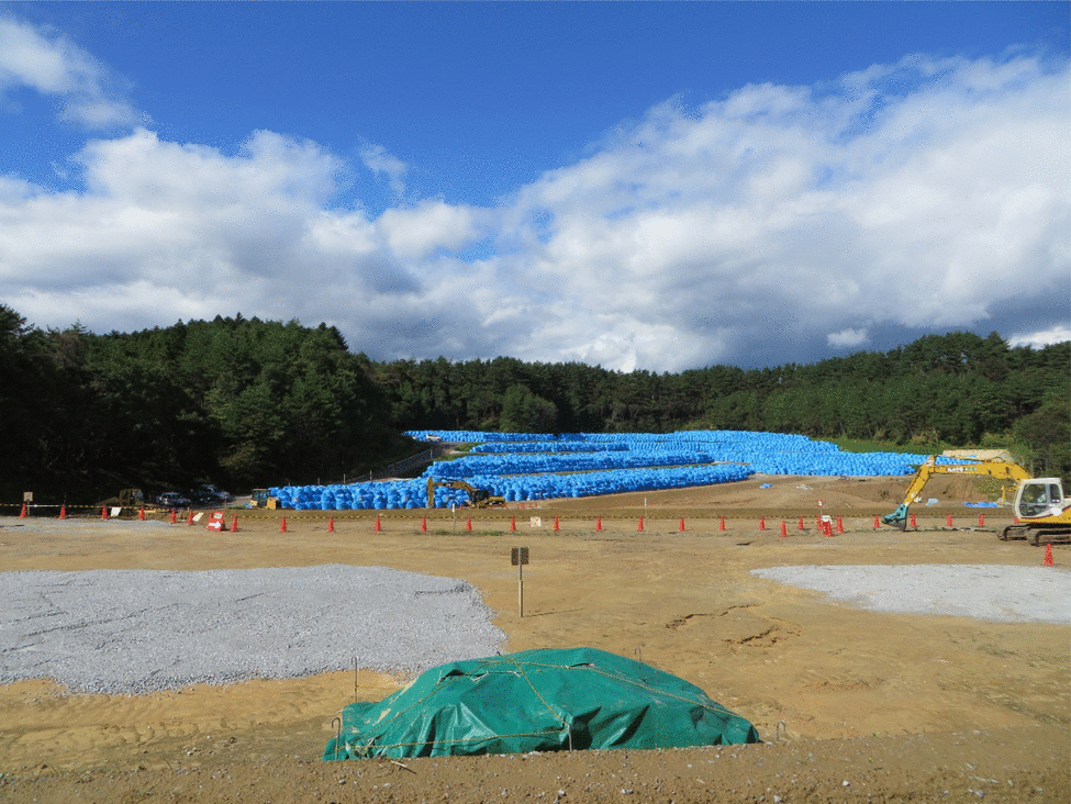

While largely successful, these remediation activities have cost a lot of money and created significant volumes of radioactive waste (mostly in the VLLW category). This has presented a separate challenge as the waste material has been located at hundreds of temporary waste storage sites (which initially only had a projected 3 year lifetime) with very few interim waste storage facilities (projected 30 year lifetime) being successfully located and approved by stakeholders. Fig 7 shows a photograph of a Temporary Waste Storage site within Fukushima Prefecture where the majority of the bags contain contaminated soil and leaf litter. Remediation activities ideally need to provide a balance between dose reduction and the associated costs and potential wastes. The example at Fukushima emphasises the importance of considering lifecycle management principles, as a desire to undertake thorough remediation has resulted in the creation of significant waste volumes which eventually local residents will wish to see removed from the temporary waste storage sites.
Fig 7: Temporary Waste Storage Site within Fukushima Prefecture
