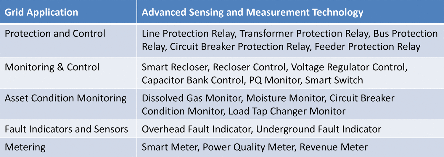

Sensing and measurement
The purpose of advanced sensing and measurement technologies is to acquire data from the field and provide it to system operators and others. This data would source from the distribution grid as well as customer premises and would include – fault location, transformer and line loading, feeder voltages, equipment health, power factor, outage notification, energy consumption and so on. Some of these technologies are presented in Fig 2, along with their corresponding applications [5,6].

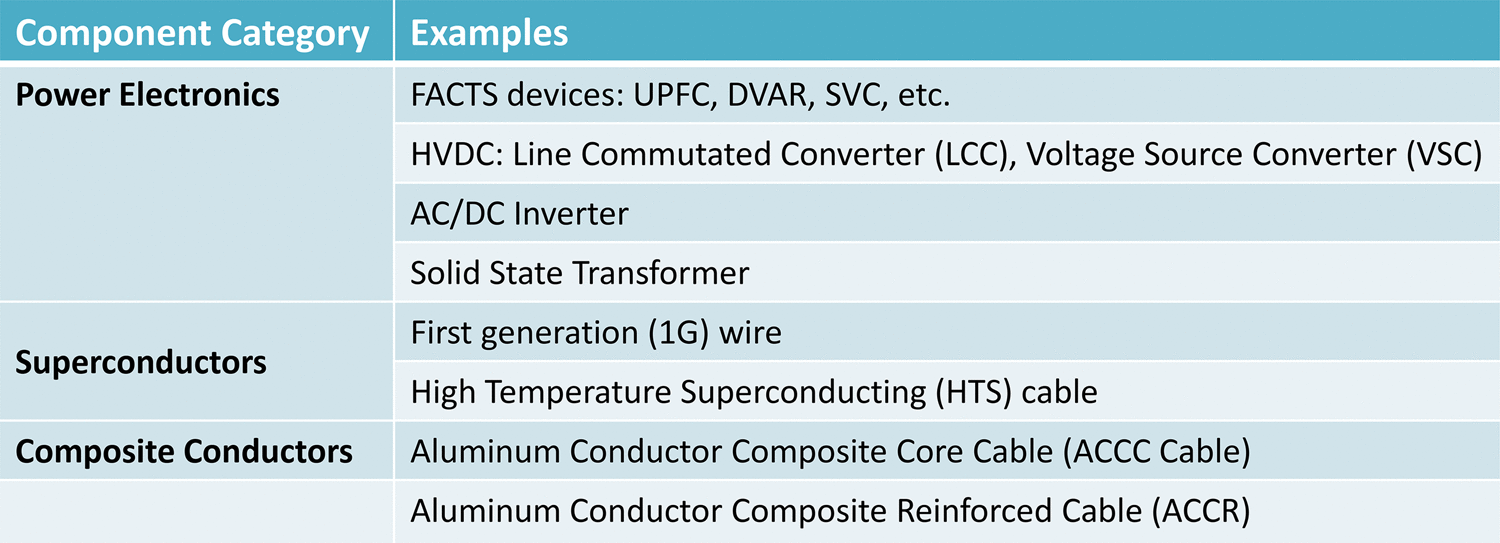

Examples of advanced components as shown in Fig 3 are another critical group of technologies that enable automation [8]. Some of them are still research or pilot/prototype stage, but they reach out across a broad set of areas such as power electronics, superconductivity, materials, chemistry and microelectronics. They have the ability to drive grid behaviour and can be applied in either standalone applications or connected together to create complex systems [9].
Fig 3: Advanced components by category

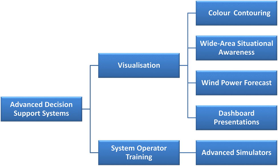

Advanced decision support systems
It is easy to see how the data gathered from both the sensors and that created as outputs from the various applications and algorithms can be overwhelming. However, the system operator could use as much help in this rapidly changing system in order to stay ahead of developments and be able to continue to keep the system reliable and resilient to attacks by providing a broader view of the grid. Advanced decision-support systems are therefore a key piece of the automation puzzle that provide visualisation, decision support and system operator training to utility control centre personnel. Fig 7 presents examples of some of these technologies [10].
Fig 7: Examples of operator decision support systems
The three parts of advanced operational systems form the underpinning of the implementation arm of DA and provide the basics of the steps towards the self-healing grid.

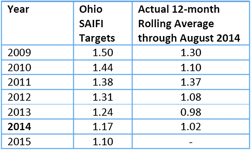

Duke's customers are seeing measurable improvements in outage frequency and faster restoration after disruptions from ‘self-healing’ capabilities built into 64 distribution circuits in Ohio. These self-healing capabilities are made possible by 30 groups of field devices that enable fault detection and automate rapid isolation and restoration of the fault. By August of 2014, Duke's 30 self-healing device groups in Ohio had activated 84 times, reducing outage frequency and duration. Fig 9 shows measurable improvements in system average interruption frequency index (SAIFI) – which measures average interruptions per customer [17].
Fig 9: Duke Energy's self-healing teams show year-over-year reductions in SAIFI

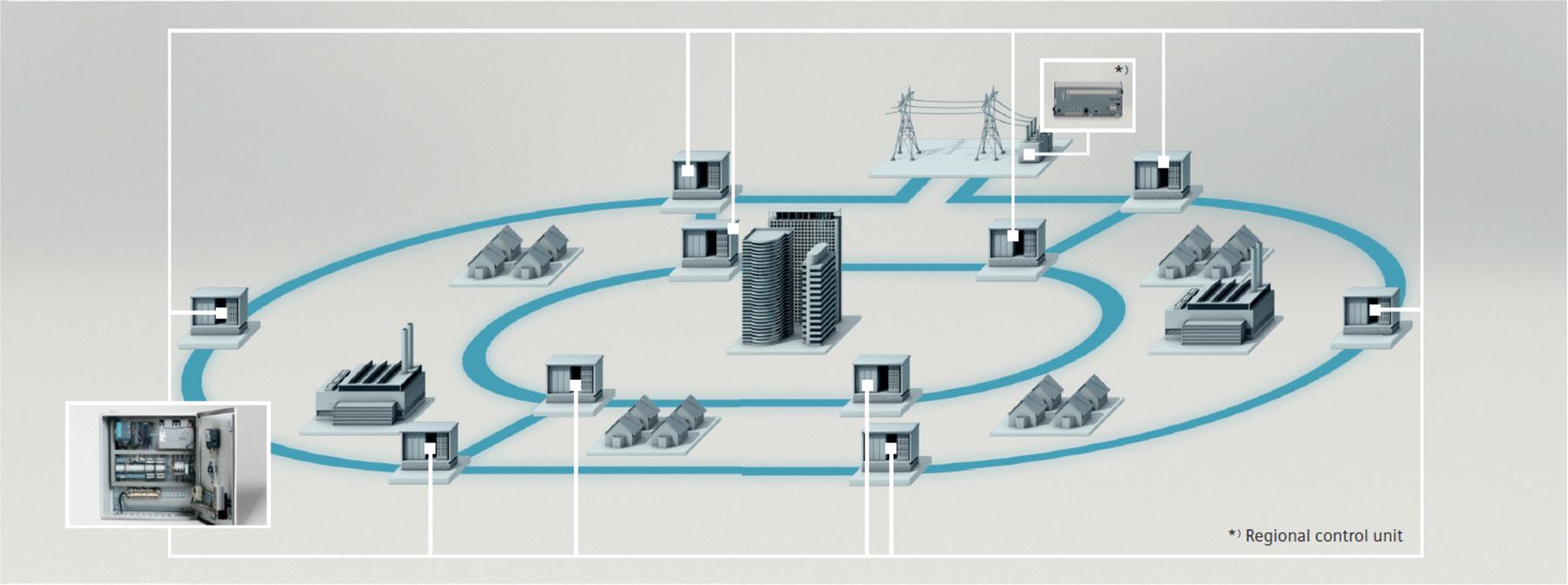

Case study 2 – Stedin, DA
Stedin, one of the largest distribution network operators in The Netherlands, has a total of 21,240 secondary substations in service and serves approximately two million customers in the Randstad region, which is one of the largest conurbations in Europe. Stedin has experienced power failures in its distribution grid, in the past. Not only did these outages displease customers, but they entailed expensive compensation payments for Stedin. Stedin's main objective was therefore to significantly reduce the system average interruption duration index (SAIDI) in their medium-voltage grids.
Its distribution grid consists mainly of underground cables, which cannot be quickly repaired in the event of faults, and cannot be fixed with automatic reclosers either. Therefore, it developed a self-healing network solution that would work for its MV network (Fig 10).
Fig 10: Distribution network with local control units in each secondary substation
The solution is based on a regional controller at the substation level, which ensures automatic fault localisation, isolation and restoration. It was implemented by upgrading its substation automation with new distribution grid automation functions. The regional controller serves as an interface to the control centre, which collects data from the distribution grid and hosts the regional, centralised applications of Stedin's self-healing grid. Part of its solution consists of an intelligent local substation. Upgrade kits were either installed to modernise older ring main units (RMUs), or were replaced with new RMUs.
With the innovative self-healing grid solution installed, Stedin is expected to significantly reduce its SAIDI and restore power to most of its customers in less than a minute in the event of a power outage. This is expected to increase customer satisfaction as well as provide considerable cost savings by minimising the heavy contractual penalties that must be paid in case of power outages [18].
