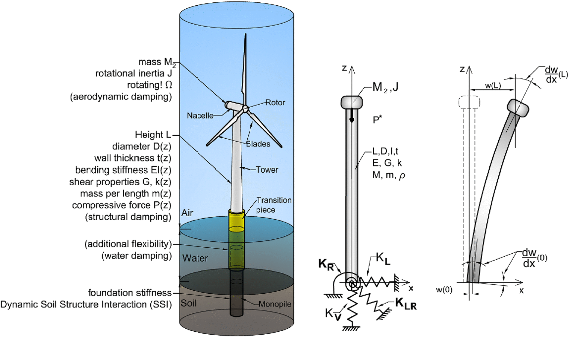

Offshore wind turbines (OWTs), because of their shape and form (i.e. a long slender column with a heavy mass as well as a rotating mass at the top) are dynamically sensitive because the natural frequency of these slender structures are very close to the excitation frequencies imposed by the environmental and mechanical loads. Fig 2 shows a simple mechanical model of the whole system showing the different components and the design variables. In the model, the foundation is replaced by four springs: K L (lateral spring), K R (rocking spring), K V (vertical spring) and K LR (cross-coupling spring). It is therefore clear that the stability and deformation of the system is very much dependent on these four springs. A few things may be noted regarding these springs:
  • (a) The properties and shape of the springs (load-deformation characteristics) should be such that the whole structure should not collapse under the action of extreme loads and the deformation is acceptable under the working loads.
  • (b) The values of the spring (stiffness of the foundation) is necessary to compute the natural period of the whole structure as this is linear eigenvalue analysis. Further details on the analysis required can be found in [2,3].
  • (c) The values of the springs will also dictate the overall dynamic stability of the system because of its non-linear nature. It must be mentioned that these springs are not only frequency dependent but also change with cycles of loading because of dynamic soil structure interaction. Further details on the dynamic interaction can be found in [4,5].

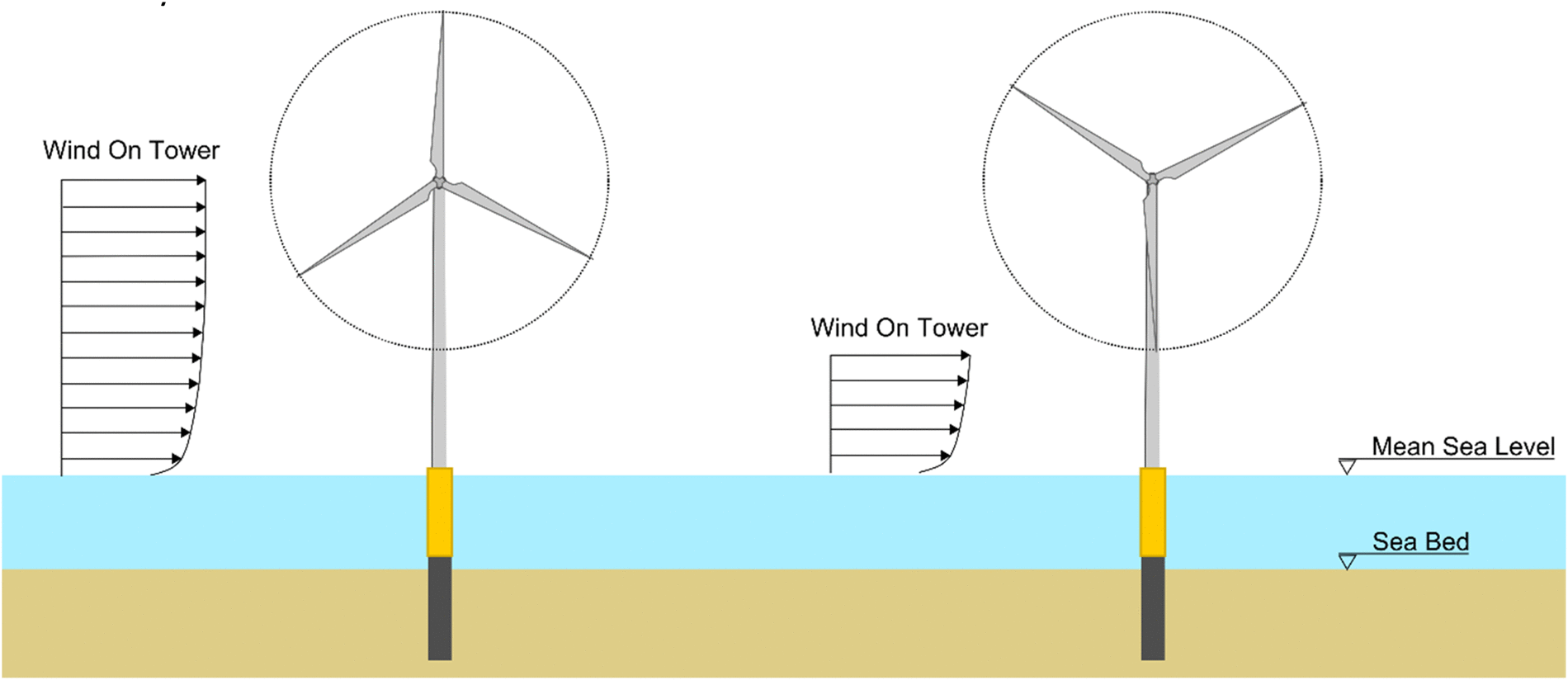

  • (d) Loads in the tower because of the vibrations caused by blade shadowing effects (referred to as 2P/3P in the literature). The blades of the wind turbine passing in front of the tower cause a shadowing effect and produce a loss of wind load on the tower and is shown in Fig 3. This is a dynamic load having frequency equal to three times the rotational frequency of the turbine (3P) for three bladed wind turbines and two times (2P) the rotational frequency of the turbine for a two bladed turbine. The 2P/3P loading is also a frequency band such as 1P and is simply obtained by multiplying the limits of the 1P band by the number of the turbine blades.

Fig 2: Simplified mechanical model of an offshore wind turbine

Fig 3: Blade shadowing load on the tower (3P load)
Left-hand side diagram shows the load on the tower when the blades does not shadow the tower

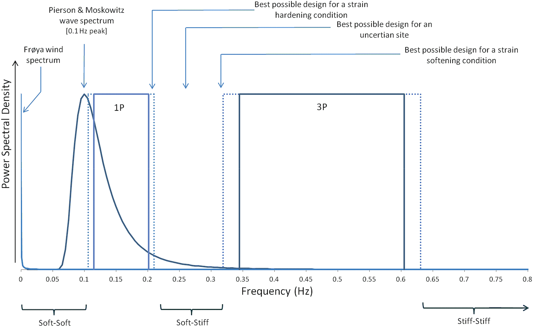

Design options
It is clear from the frequency content of the applied loads (see Fig 4) that the designer has to select a system frequency (the global frequency of the overall wind turbine including the foundation) which lies outside these frequencies to avoid resonance and ultimately increased fatigue damage. From the point of view of the first natural frequency ( f 0) of the structure, three types of designs are possible (see Fig 4)
  • (1) Soft-Soft design where f 0 is placed below the 1P frequency range which is a very flexible structure and almost impossible to design for a grounded system.
  • (2) Soft-Stiff design where f 0 is between 1P and 3P frequency ranges and this is the most common in the current offshore development.
  • (3) Stiff-Stiff designs where f 0 have a higher natural frequency than the upper limit of the 3P band which will need a very stiff support structure.
It is of interest to review the codes of practice in this regard. DNV [11] code suggests that first natural frequency should not be within 10% of the 1P and 3P ranges as indicated in Fig 4. It is apparent from Fig 4 that for soft-stiff design, the first natural frequency of the wind turbine needs to be fitted in a very narrow band (in some cases the 1P and 3P ranges may even coincide leaving no gap).
A few points to be noted:
  • (1) From the point of view of dynamics, OWT designs are only conservative if the prediction of the first natural frequency is accurate. Unlike in the case of some other offshore structures (such as the ones used in the oil and gas industry), under-prediction of f 0 is unconservative.
  • (2) The safest solution would seem to be to place the natural frequency of the wind turbine well above the 3P range. However, stiffer designs with higher natural frequency require massive support structures and foundations involving higher costs of materials, transportation and installation. Thus from an economic point of view, softer structures are desirable and it is not surprising that almost all of the installed wind turbines are ‘soft-stiff’ designs and this type is expected to be used in the future as well.
  • (3) It is clear from the above discussion that designing soft-stiff wind turbine systems demands the consideration of dynamic amplification and also any potential change in system frequency because of the effects of cyclic/dynamic loading on the system, that is, dynamic-structure-foundation-soil-interaction. Typically, the first modal frequency of the wind turbine system lies in the range of 75 to 120% of the excitation frequencies and as a result, dynamic amplifications of responses are expected.
  • (4) Clearly, for soft-stiff design, any change in natural frequency over the design/operation period of the turbine will enhance the dynamic amplifications which will increase the vibration amplitudes and thus the stresses and fatigue damage on the structure. Therefore, fatigue is one of the design drivers for these structures. Predicting fatigue damage is undoubtedly a formidable task because of the complexity associated with the uncertainty in the dynamic amplification (owing to changes in system characteristics over time and number of cycles), randomness of the environmental loading and last but not the least, the impact of climate change.

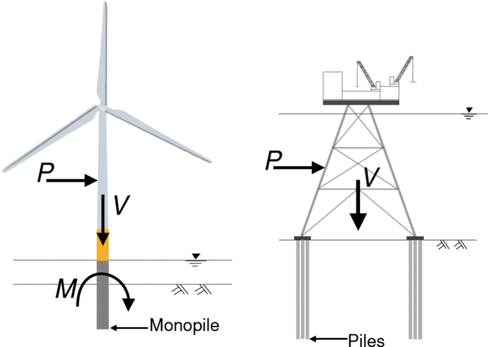

OWTs are new types of offshore structures and are unique in their features. The most important difference with respect to oil and gas installation structures is that they are dynamically sensitive (as explained in Section 2) and moment-resisting. Fig 5 shows a typical monopile supported wind turbine and a pile supported fixed offshore jacket structure. There are, however, obvious differences between those two types of foundations. Piles for offshore structures are typically 60–110 m long and 1.8–2.7 m diameter and monopiles for OWTs commonly 30–40 m long and 3.5–6 m diameter. Degradation in the upper soil layers resulting from cyclic loading is less severe for offshore piles which are significantly restrained from pile head rotation, whereas monopiles are free-headed. The commonly used design method using a beam on non-linear Winkler springs (‘p-y’ method in API code or DNV code) may be used to obtain pile head deflection under cyclic loading, but its use is limited for wind turbines because:
  • (a) the widely used API model is calibrated against response to a small number of cycles (maximum 200 cycles) for offshore fixed platform applications. In contrast, for a real offshore wind turbine 10 7–10 8 cycles of loading are expected over a lifetime of 20–25 years.
  • (b) under cyclic loading, the API or DNV model always predicts degradation of foundation stiffness in sandy soil. However, recent work by [4,6,7,10] suggested that the foundation stiffness for a monopile in sandy soil will actually increase as a result of densification of the soil next to the pile.
  • (c) The ratio of horizontal load (P) to vertical load (V) is very high in OWTs when compared with fixed jacket structures.

Fig 5: Offshore wind turbines and offshore oil and gas installations

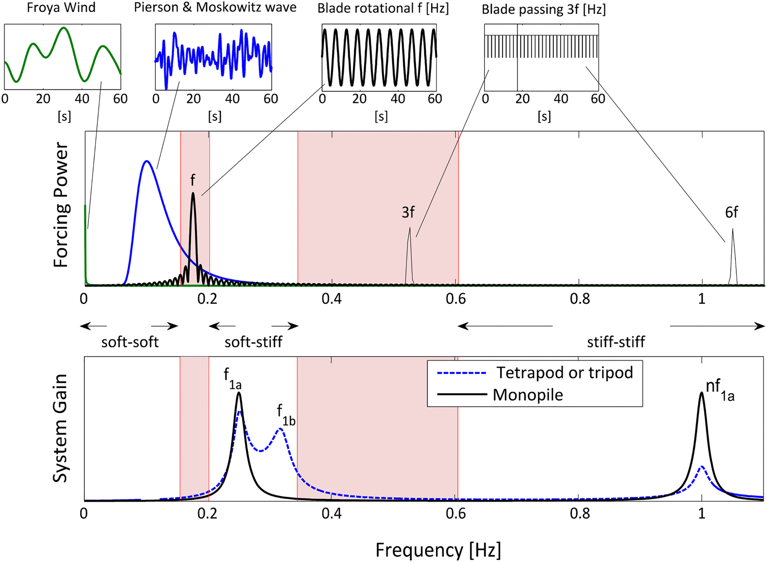

Fig 6: Relationship between effect of natural frequency of suction caisson and monopile on the forcing frequencies
The following conclusions could be reached from the study
  • (a) The change in natural frequencies of the wind turbine system may be affected by the choice of foundation system, that is, deep foundation or multiple pods (symmetric or asymmetric) on shallow foundations. Deep foundations such as monopiles will exhibit sway-bending mode, that is, the first two vibration modes are widely spaced – typical ratio is 4 to 5. However multiple pod foundations supported on shallow foundations (such as tetrapod or tripod on suction caisson) will exhibit rocking modes in two principle planes (which are ofcourse orthogonal). Fig 6 shows the dynamic response of monopile supported wind turbine and tetrapod foundation plotted in the loading spectrum diagram.
  • (b) The natural frequencies of wind turbine systems change with repeated cyclic/dynamic loading. In the case of strain-hardening site (such as loose to medium dense sandy site) the natural frequency is expected to increase and for strain-softening site (such as normally consolidated clay) the natural frequency will decrease.
  • (c) The results showed that the multipod foundations (symmetric or asymmetric) exhibit two closely spaced natural frequencies corresponding to the rocking modes of vibration in two principle axes. Furthermore, the corresponding two spectral peaks change with repeated cycles of loading and they converge for symmetric tetrapods but not for asymmetric tripods. From the fatigue design point of view, the two spectral peaks for multipod foundations broaden the range of frequencies that can be excited by the broadband nature of the environmental loading (wind and wave) thereby impacting the extent of motions. Thus the system lifespan (number of cycles to failure) may effectively increase for symmetric foundations as the two peaks will tend to converge. However, for asymmetric foundations the system life may continue to be affected adversely as the two peaks will not converge. In this sense, designers should prefer symmetric foundations to asymmetric foundations.
