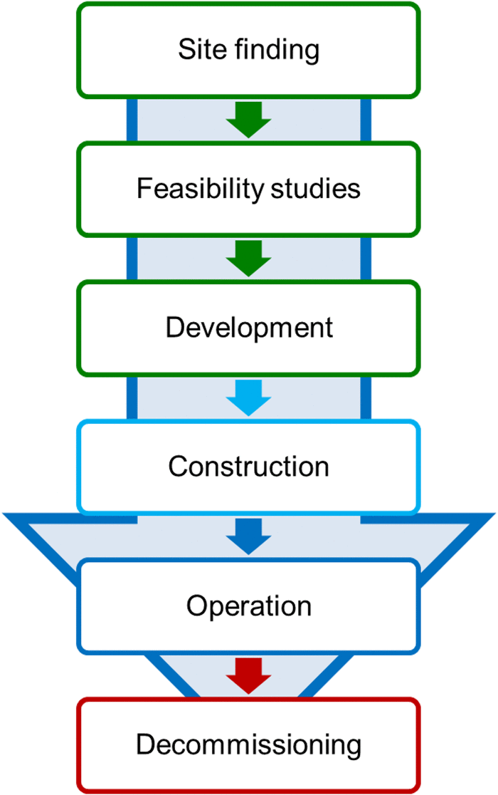

Fig 1: Key project phases for a typical wind energy development
Throughout the project development process it is important to understand the potential wind resource of the site, as this allows for an evaluation of the future energy production and a prediction of the profitability of the project. At very early stages (site finding and feasibility on Fig 1), the wind resource is often estimated using crude wind resource maps, however in order to more accurately value the project a more confident prediction is required. This can be achieved through a wind resource assessment – which is one of the early significant investment decisions – requiring anywhere upwards of £30,000 of capital, but often in the order of £100,000 depending on the size of the project. The investment includes the cost of wind measurement equipment, installation, maintenance and also the cost of a bankable wind resource assessment report. The wind resource assessment is almost always required by potential investors in a project. This investment is required several years before a wind energy project becomes operational and therefore the return on this investment is slow to be realised.

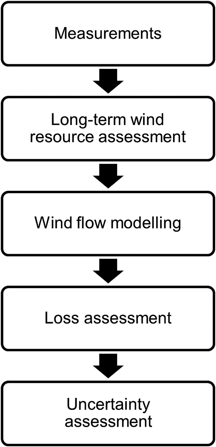

Fig 2: Outline of a standard wind resource assessment
Each stage follows a simple structure of inputs, analysis and output – with the quality of the inputs and also the process or analysis directly impacting on the certainty of the output.

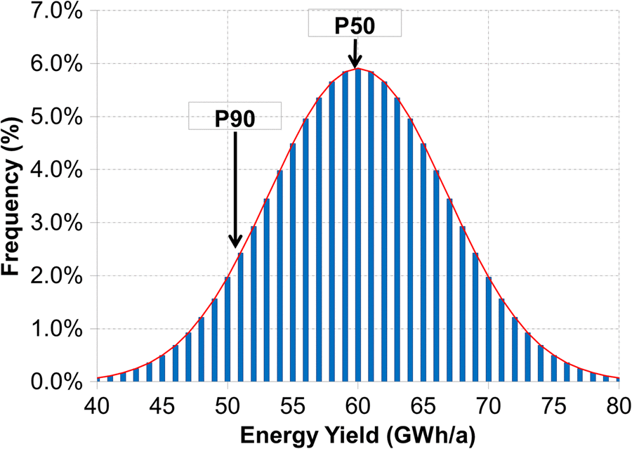

Fig 3: The results of a typical wind resource assessment displayed as a probability distribution
The figure shows the P50, and also the P90 (the figure of which there is 90% confidence of exceeding) which is a commonly used figure within project financing. The P90 figures are typically stated with a return period (in years) which reflects increasing certainty over longer averaging periods (reflecting the uncertainty associated with inter-annual variability of wind speeds).
The P90 figure is often used by investors in projects to assess the attractiveness of any investment, this figure is a direct input to the financial model. By reducing the uncertainty of a project, the P90 is increased and therefore the project becomes more attractive for investment.

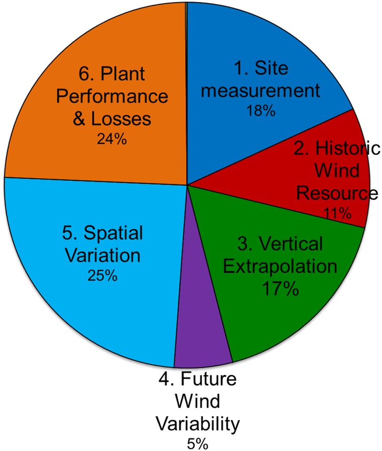

Fig 4: Breakdown of contributors to project uncertainty
Based on this chart, it is possible to identify possible areas for reductions in uncertainty in order to improve confidence in the analysis, which are discussed in the following sections.
