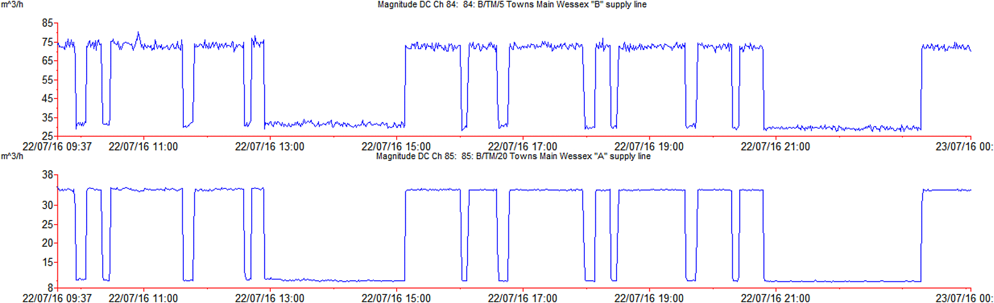

To record HPB's total town's main usage, a recent project has been recently completed to install new permanent flow meters that provide a more accurate representation of how much water is used and which lines the water is supplied from, see Fig.  1 . The top graph is the main inlet to site via valve B/TM/5 and the bottom is the cross flow between A and B station through valve B/TM/20. As can be seen, both flow rates cycle between two levels, following each other profile identically but at different volumes. Fig.  1 shows a ‘usual’ water consumption trends from our two main inlets (in cubic metres per hour); any deviations from this trends can then be investigated accordingly.
Fig 1: Live feed of HPB's Towns Main water consumption
Before the new installations, the two main distribution lines to HPB and HPA/HPC had one magnetic flow meter on them each, originally installed by Wessex Water. However, they are not an accurate measure of our consumption as there are cross links between HPA/HPB which these flow meters do not account for; data was only logged every 15 min and there is a day lag before it is able to be collected. With the new ultrasonic flow meters, that have been placed on the main distribution line and cross-linking pipes between the sites, the data is logged every minute and it has a live feed that can be tracked on a station computer logger. This instantaneous read out with intervals between recordings of only 1 min allows for greater accuracy in mapping water usage to work being undertaken on site. An example of this is when town's main water is required to supply heat exchangers; this allows intrusive maintenance to be undertaken on their normal sea water supply pipework or pumps. A general breakdown of key water consumption areas and their dependence can be seen in Fig 2.

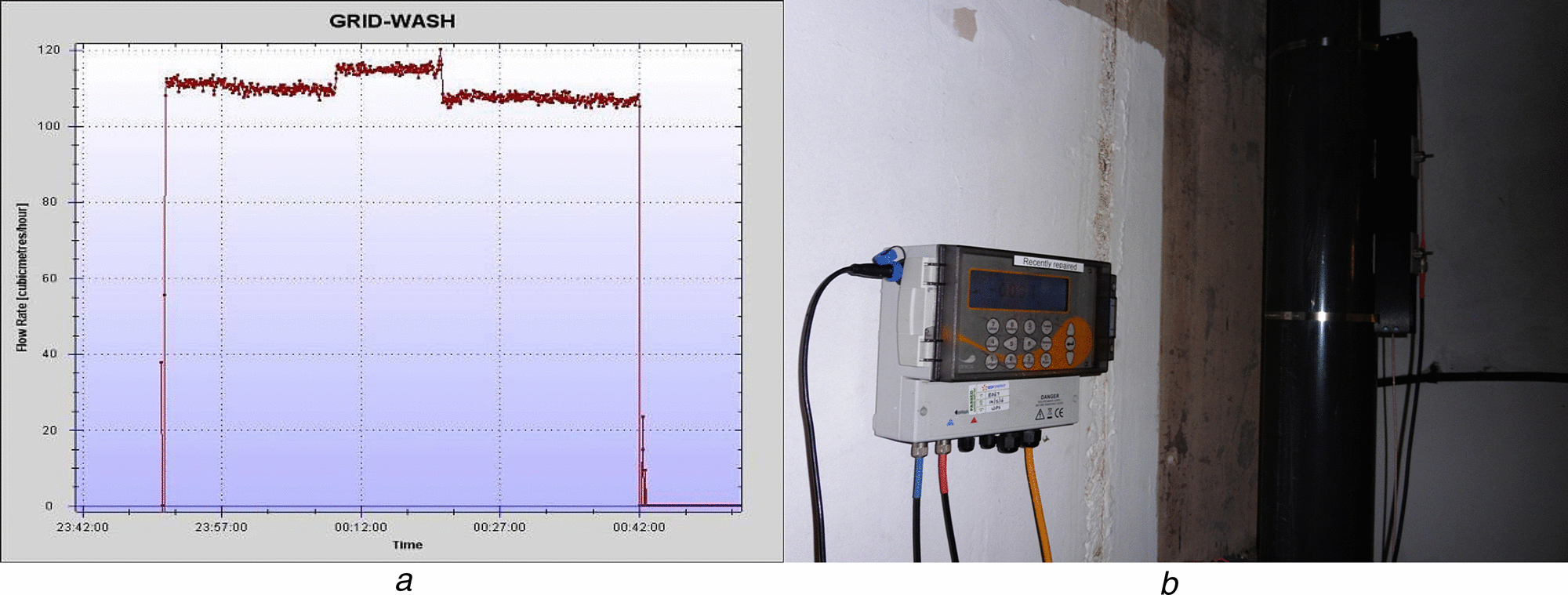

Initial water surveys carried out on the 400 kV Grid wash quickly identified that a substantial amount of water was being used per wash due to unknown specific duration of the automatic wash and also the total amount of water required, see Figs.  3 and 4 . By performing a tank drop test, the duration and actual volume of water required to complete a 400 kV grid wash were calculated, this is the actual water required for an ‘optimal’ grid wash without any surplus water been added to the tank which would result in an overflow going to waste. A tank drop test is the process of ascertaining the required volume of water or flow rate needed through a system to perform is designed function by means of monitoring the change in fluid level within the tank (or drop) with an isolated fluid supply, i.e. no additional water added in a specific amount of time.

Fig 4: 400 kV grid wash
a 400 kV grid wash results
b Grid wash permanent flowmeter and sensors
After acquiring this information, an ‘optimal’ grid wash (in terms of duration and volume) was identified. Herewith, results were captured and incorporated into station operating procedures and communicated to all relevant staff in order to improve the efficiency of the system.
Fig 4 shows the installed ultrasonic flow meter and the volume and total duration for an ‘optimal’ grid wash after been implemented, ∼100 m 3 and ∼50 min. The surveys conducted identified that the pumps were sometimes left on for up to 3 h in order to ensure the tank always had water available for the wash, this equates to an average of 175 m 3 being lost per wash. After implementing the identified recommendations, these demineralised water through manual interventions losses were reduced to less than 15 m 3 per wash. An average loss of 15 m 3 with the optimal wash when compared with previous losses of 175 m 3 show an improvement of more than 90% for the process!

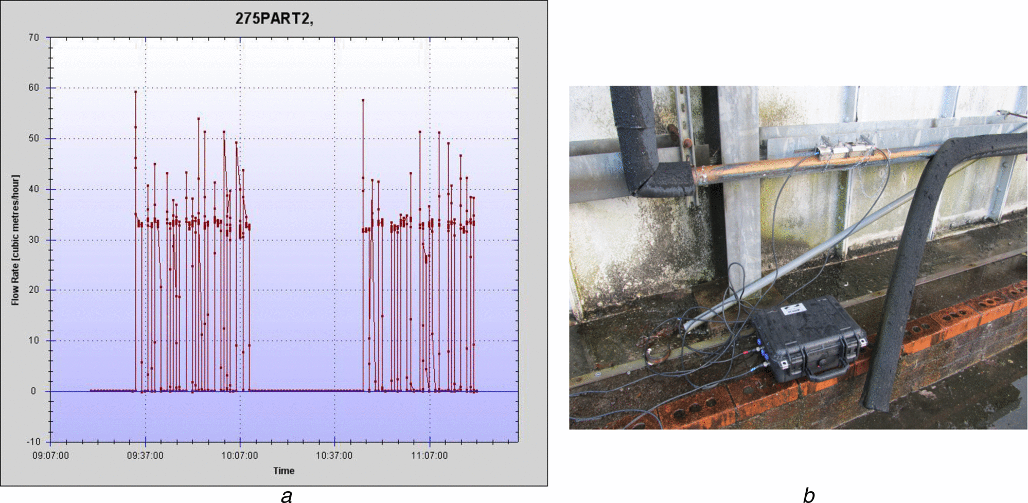

As mentioned earlier, within the 275 kV substation live washing takes place manually with pressure washers that are connected via detachable hoses to various standpipes across the substation. This occurs weekly/bi-weekly dependant on the season (washed more frequently throughout the winter months). It was originally thought that due to being a laborious manual process which was never recorded or measured, it could be ineffective and a large amount of water lost per wash. In order to prove this theory, the flow and volume required for the manual live washing in the 275 kV substation required to be accurately calculated.
To achieve this, a portable battery powered ultra-sonic flow meter was used; this instrument was connected to the external pipe which is downstream of the town's main header tanks. Fig.  5 shows half of the total data that is required for a grid wash, from which it has been calculated that approximately 40 m 3 are used for a full grid wash. This was found to be far more efficient than initially thought, especially in comparison with the 400 kV substation, dedicated human intervention in this case helping to optimise the process and reduce water losses!
Fig 5: 275 kV grid wash
a 275 kV grid wash results
b Grid wash portable flowmeter and sensors
The main reason for the large difference in volume used in the 275 and 400 kV substations is that the 275 kV substation has 174 insulators to wash, unlike the 400 kV substation which has approximately 980 insulators. This combined with the insulators being larger on the 400 kV substation means far more water is required. The decision was made that the benefits of pursuing a live washing automated process for the 275 kV were not required given the near optimal water utilisation under the manual grid operator process.
