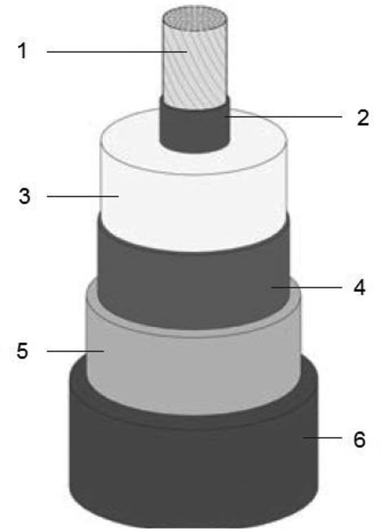

Principal features of power cables
A basic in-land alternating current (AC) power cable and its components are shown in Fig 1.
Fig 1: Illustration of a basic in-land single core AC power cable and its components [1]
1 – conductor, 2 – conductor screen, 3 – insulation, 4 – insulation screen, 5 – metallic sheath (and basic water barriers) and 6 – outer sheath
In principle, power cables consist of two functioning components: conductor and insulation.
  • Conductor: Suitable materials for conductors on a commercial scale are copper and aluminium. Cables using copper have a smaller cross section diameter than those using aluminium as copper has higher conductivity and requires a smaller cross section area for the same current carrying capability (sometimes called ampacity). Copper also has better corrosion resistance than aluminium. The majority of land cables use aluminium conductor whereas the majority of submarine power cables use copper conductor, although some submarine projects have used aluminium conductors for cost reason. It is also possible to use copper for some parts of the route, and aluminium for others, for example, to use aluminium conductor for the deeper cold part of the submarine cable route and copper conductors for the warmer parts buried close to the beach. Jointing between copper and aluminium conductors is feasible. Superconducting materials, such as carbon nano-tubes are being researched.
  • Insulation: The insulation is required to bring the voltage potential of the conductor down to close to zero at the outside surface of the cable (connectable to the earth). Two main types of insulation that are used on a commercial scale are oil impregnated paper and polymeric materials, among which the latter is relatively newer and came to use in 1980s at a transmission voltage.
All other components of power cables are for supporting purposes but also essential. These components include:
  • Screens: Normally there are two sheets of screens, both are made of semiconductors. One is between the conductor and the insulation to equalise the electric field and the other screen sheet is immediately outside of the insulation to seal off the electric field directly generated by the cable and prevent it from leaking to outside of the cable.
  • Sheath: This consists of layers made of lead alloy, aluminium, copper and polymeric material. It provides protection for the insulation and the entire cable. The sheath along with the metallic screen and armour wires (when available) also carries fault current. Some basic water barrier layers are normally installed just inside the sheath. The sheath also has a function to prevent corrosion.

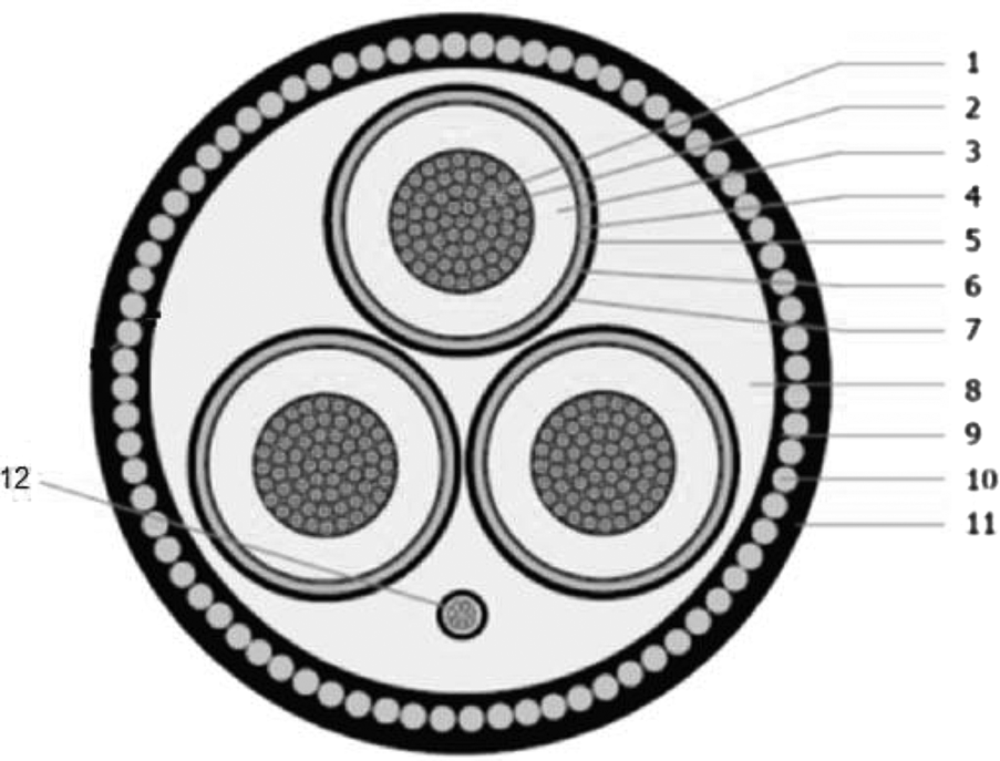

Principal features of submarine power cables
In comparison with a standard land AC cable, power cables designed for submarine application need to take into account a number of special factors and address different physical and installation constraints and opportunities. This is explained in Table 1 and Fig 2.
Fig 2: Illustration of a three-core AC submarine power cable and its components (sketch: Courtesy of Prysmian)
1 – conductor, 2 – conductor screen, 3 – insulation, 4 – insulation screen, 5, 6, 7 – water barrier and metal or semiconductor sheath, 8 – fillers, 9 – bedding tapes and inner sheath 10 – wire armour, 11 – outer serving and 12 – optical fibres

Opportunity for 3-core in AC
When cables are installed across seas, it is feasible and also preferable for AC submarine cables to have three cores built together to save cost thanks to the fact that seawater can mitigate the resultant heat dissipation problems. This also gives an opportunity to have a bundle of optical fibre data and communication cables built-in and offer effective temperature measurement.
A structure sketch of a three-core cable is shown in Fig 2.
Three single-core cable systems may still be used in AC submarine application if a three-core structure makes the overall diameter of the large ampacity cable too large to handle and becomes technically and economically undesirable.

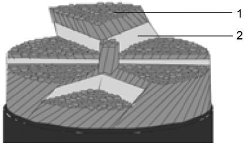

Most conductors of large capacity power cables are stranded from round wires. Although the same compressed round wire conductors can be used for both AC and DC applications, it would be more economic if the final formation of the conductor cores takes into account the different characteristics of AC and DC.
As is known, when the AC flows in a conductor, an alternating magnetic field is generated which produces an electromagnetic force that concentrates the current flow lines into the peripheral parts of the conductor (the ‘skin’). As a result of this ‘skin effect’, the current density in the inner part of the conductor decreases causing reduction of the effective cross section area of the conductor which leads to an increase of the resistance. Therefore, the manufacturing of AC cables should avoid and mitigate the impact of the skin effect, whereas this does not need to be a concern when manufacturing a cable for DC application.
For this reason, the conductors for AC power cables are produced in a segmental manner following a so called Milliken method whereby a number of segment stranded sub-conductors are first formed from individual wires then rolled, twisted and laid up into a round conductor [2]. This is shown in Fig 3.
Fig 3: Conductor manufactured using the Milliken method [1]
1 – conductor in Milliken segments, 2 – semi-conductive or insulating tapes separating the Milliken segments
In this way, each individual wire changes its radial position from close to the centre to far from the centre as the wire proceeds along the conductor. As the electromagnetic force causing the skin effect at the centre and at the periphery have opposite signs and cancel each other to certain extent, the skin effect is reduced. The application of extra insulation, such as oil film, thin paper strips or lacquer between the wire layers or between individual wires can further help reduce the skin effect [2]. All of these measures mitigating the skin effect will inevitably increase the cost of conductors for AC cables.
The conductors for DC power cables on the other hand can be produced without sophisticated process although stranded wires will still be used.
Incidentally, following the analysis above, it can be expected that the conductor for a low frequency application, such as 16.7 Hz power transmission, can be manufactured at a cost lower than that for a 50 Hz application.

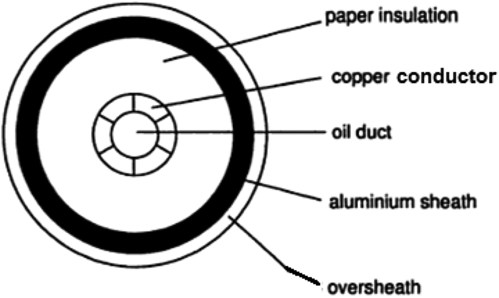

Oil filled paper insulated power cable
Oil filled or fluid-filled paper insulated cables, also known as SCFF (self-contained fluid filled) cables, are a veteran in power cables and have been in use since 1920s. An indicative structure of an oil filled paper insulated single core power cable is given in Fig 4.
Fig 4: Structure of an oil filled paper insulated single-core power cable [3]
The insulation paper tapes are made from conifer pulp (kraft paper) and are pre-impregnated then lapped or stacked to form an insulating wall around the conductor. Thinner paper with higher dielectric strength is used closer to the conductor as electric stress is higher in the inner part of the cable. Lesser layers of thicker paper tapes are used in the outer parts of the cable. The paper tapes in the insulation wall also provide great mechanical strength.
The oil used during the operation stage is a very low viscosity (lower viscosity than water) synthetic hydrocarbon oil, which is contained and flows in a duct in the conductor centre. The purpose of the oil is to fill any gaps between paper laps which may grow with thermal expansion and between the insulation and the conductor, suppressing the formation of any ionisation or voids. The continuous flow of oil is fed into the cable through the end terminations using pumping stations.
For voltages above 275 kV AC, paper polypropylene laminate (PPL), a sandwich structure inserting one sheet of polypropylene laminate between two sheets of paper, has been adopted on some occasions to improve electrical performance, reduce losses and increase the transmitted power, thanks to the special low permittivity and low loss of the PPL insulation [4].
Oil filled paper insulated power cables are usually in a single core construction, however, three-core constructions are also available in which each core has a compact stranded conductor insulated with paper tapes and the cores and oil ducts are laid up together under a common metallic sheath [4].

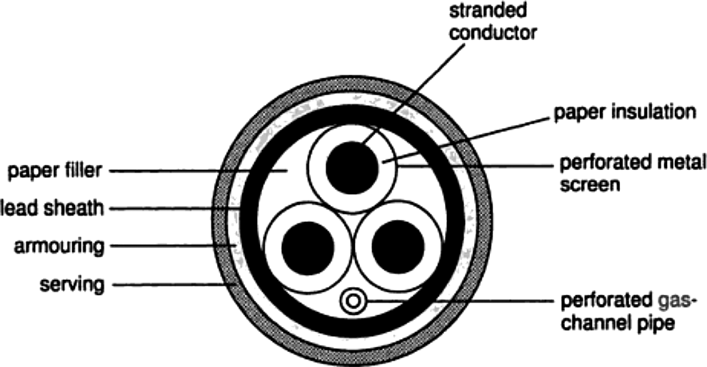

Gas filled paper insulated cables were first developed in 1937. A structure of gas filled cables is illustrated in Fig 5.
Fig 5: Structure of a gas filled paper insulated three-core power cable [3]
Their design elements are largely the same as those in a standard oil filled paper insulated cable and again the cable insulation is provided by pre-impregnated and lapped paper tapes. The difference here is that pressurised nitrogen gas is used to fill the gaps in between the paper tapes. The nitrogen gas is pressurised and injected from both ends once the cable is installed and vacuum treated.
It should be noted that gas filled paper insulated cables are different from gas insulated (transmission) line. The former uses gas to facilitate paper insulation whereas the latter uses gas (a mixture of mainly nitrogen and a smaller percentage of SF 6, typically in 80:20) as the insulation.

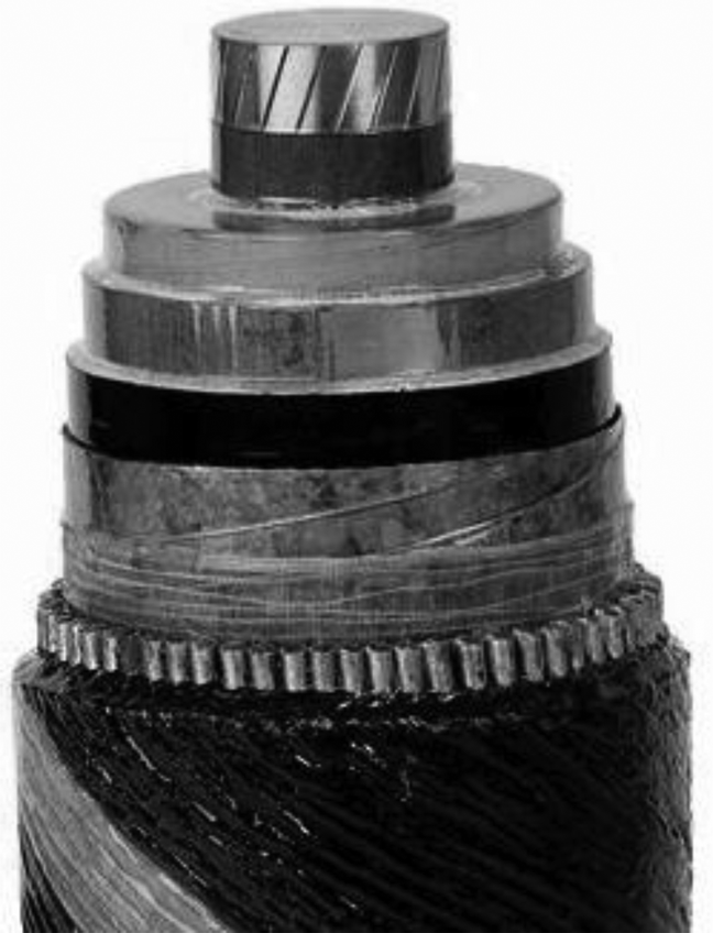

MI paper insulated power cable
An example of MI paper insulated power cables (or, in short, MI cable) is presented in Fig 6.
Fig 6: MI paper insulated single-core power cable (Courtesy of ABB)
The key feature of a MI cable is that the insulation is formed onto a conductor core using a large number of layers of lapped high-density paper tapes and the entire mass (i.e. the core and insulation) is loaded into an impregnation tank and filled with a high-viscosity compound. The purpose of the impregnation is to ensure that the gaps between adjacent turns of paper tapes are permanently filled. The compound also provides a degree of water blocking between the insulation and overlying metallic sheath in order to restrict flow of water in the event of a breach of the metallic sheath [5]. The manufacturing process should ensure that there is no draining of the impregnation fluid from the cable and the compound should remain highly viscous throughout the expected life of the cable. There is no need of oil feeding during operation. For this reason MI cables may be fully called ‘mass-impregnated paper lapped non-draining cable’. MI cables can be used for very long lengths thanks to no need of oil feeding.
MI cables have a higher requirement for factory space and longer manufacturing time because of the need to immerse the cables in large tanks for several months [5].
The maximum operating temperature of the insulation is around 55–60°C owing to the electrical and thermal performance of the insulation paper. Continuous improvements in MI cables are to develop new impregnation compounds, including those with non-linear viscosity and temperature characteristics, so that the operating temperature can be increased so does the cable ampacity.
Following the use of PPL in oil filled paper insulation cables, it is also feasible to use PPL insulating tapes instead of paper tapers in MI cables to increase operating temperature and power transfer capabilities.
MI cables have been used in the past for medium voltage AC applications, but are presently used only in high capacity DC application hence are only in single core structure, although two cores bundled in parallel or in a concentric configuration are possible.

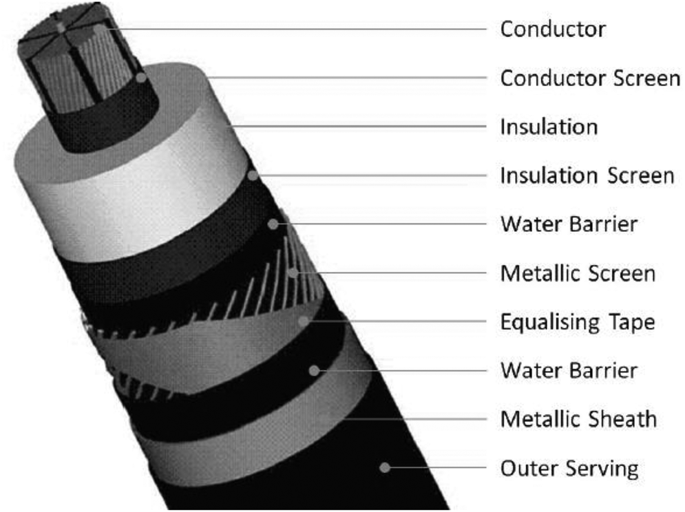

Single core extruded AC cable
A typical structure of single core extruded polymeric insulated AC cables, shown in Fig 7, is broadly similar to any other single core cables discussed so far.
Fig 7: An illustration of a single-core extruded AC cable (Courtesy of Prysmian)
The unique feature of extruded polymeric insulated cables is the formation of the polymeric insulation layer (or wall). This is carried out by following an extrusion process at the same time as the screens over the conductor and the insulation. The extrusion process generates a number of by products including water vapour and methane gas to be removed by heating and drying the insulated core.
There are two main variations from the basic extruded PE insulation materials: cross-linked PE (XLPE) and ethylene propylene rubber (EPR).
  • XLPE: It has been used for submarine cables since 1973 and for underground land cables even earlier. The cross linking refers to cross linking of the PE molecules after extrusion to form three-dimensional networks. This is to increase the tolerable temperature of the insulation to increase the power transfer capability of the cable. The cross linking is an irreversible process and gives the polymer a higher melting point higher than the normal limit of 80–110°C and in fact XLPE may not be pyrolysed until at 300°C. This allows the conductor to be loaded until it attains a temperature of 90°C.
  • EPR: Some manufacturers use EPR in place of XLPE for submarine cables. EPR has a higher loss factor and permittivity values than XLPE hence incurs higher dielectric losses. This makes EPR cables less attractive than XLPE cables in terms of cable losses. However XLPE is more vulnerable to water treeing in case of moisture ingress and requires an impervious metallic lead sheath to be applied over each core to avoid direct contact with water. EPR compounds on the other hand can be formulated to give a satisfactory performance in terms of both electrical reliability and ageing, thus removing the need for an impervious metallic sheath thus qualified to a so called ‘Wet Design’.
Hence the choice between XLPE and EPR seems to be a choice of lower operating losses against lower manufacturing cost. It seems common to use XLPE for higher voltage, such as 132 kV and above as the need of lower losses prevails over the extra cost of ‘Dry Design’. In other words, submarine transmission power cables are normally in ‘Dry Design’ but offshore wind farm array cables tend to be in ‘Wet Design’ [6].

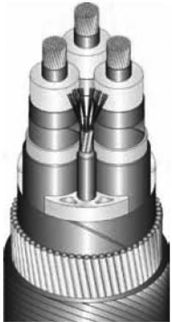

Three core extruded AC cable
The discussion on the polymeric insulation for single core extruded AC cables above is fully applicable to three core extruded AC cables. The uniqueness here is that once the three cores and their insulation and screens have been manufactured, they are twisted together along with any optical fibre cables. The bundle is then bound together after fillers are put. A three-core power cable is illustrated with optical fibres, lead sheath and wire armour in Fig 8.
Fig 8: Three-core power cable with optic fibres, lead sheath and wire armour (Courtesy of ABB)
In some constructions a layer of bedding for the armour is applied. A continuously extruded anti-corrosion layer of semi-conducting PE may also be made to provide corrosion protection and prevent the lead sheaths from binding together. The extruded layers over each core are in contact to allow the cancelling of the three-phase charging current and the sharing of any fault current among the sheaths [5].

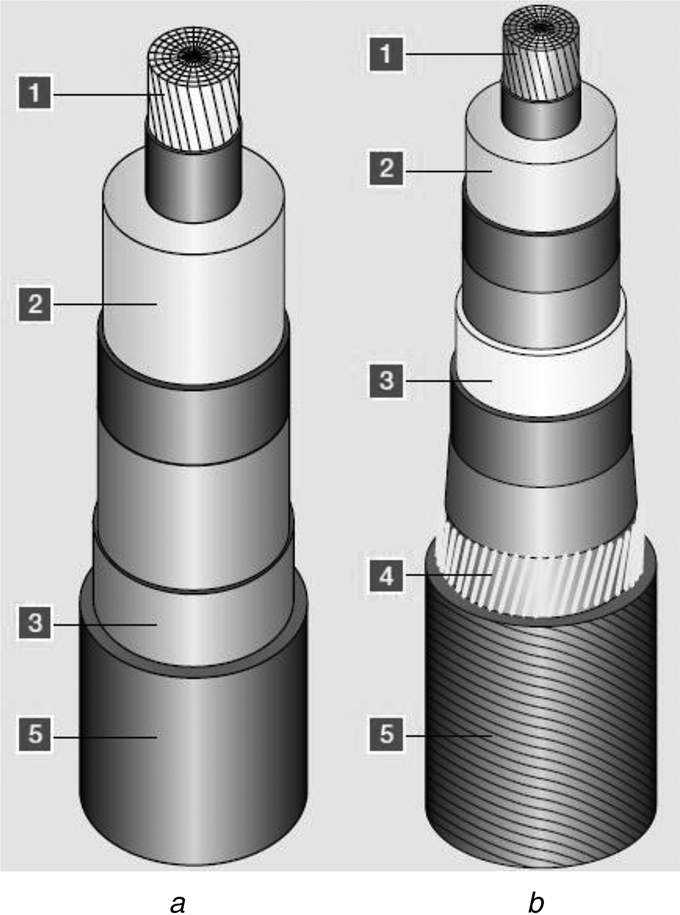

Single core extruded DC cable
Extruded DC cables are normally in a single core construction, although two cores bundled in parallel or in a concentric configuration are available. Extruded DC cables have components similar to those for extruded AC cables. The key feature of extruded DC cables remains to form the polymeric insulation using an extrusion process.
Fig 9 shows the principal composition of DC cables for both land and submarine applications.
Fig 9: Illustration of a single-core extruded DC cable [7]
A Land application
B Submarine application
1 – conductor, 2 – insulation, 3 – water barrier, 4 – wire armour and 5 – outer sheath/serving
As discussed in the Impact of AC and DC Operation on Conductors and Insulation of Power Cables, there are different implications of the manufacturing process of the conductors and insulation for DC application in comparison with that for AC application. In particular, there is a unique problem with the DC polymeric insulation, that is, space charge building up across the insulation thickness affects the life longevity of the insulation and hence the cable. With space charge issues being resolved and mitigated, extruded DC cables can be expected to reach an operating temperature of 90°C.
