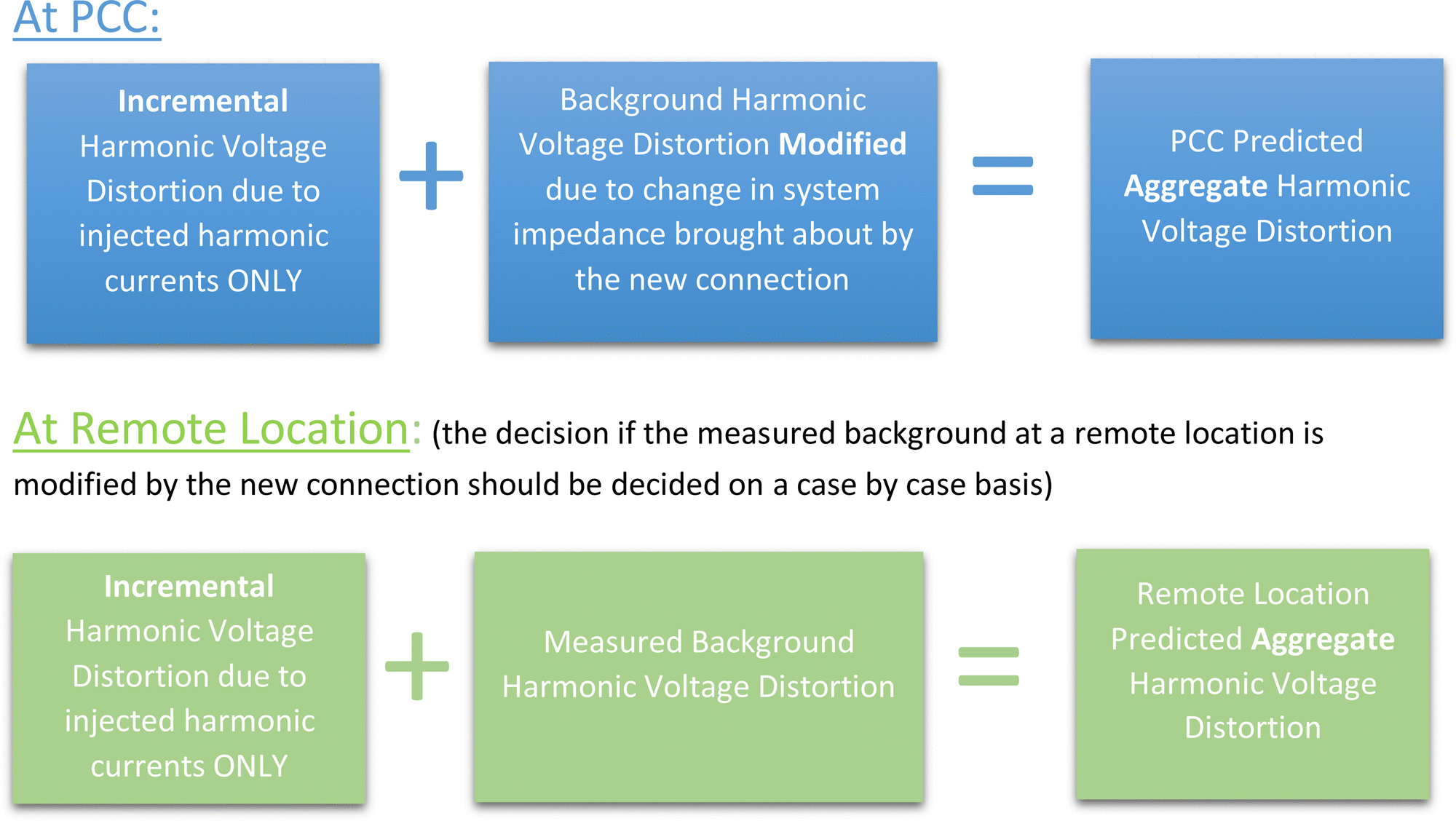

Modified background harmonic voltage distortion
In the harmonic assessment, the network impedance at the PCC is taken to be affected by the new connection and so the background voltage distortion measured there is modified to reflect the change in impedance. It is possible to assume that the connection only affects the point of connection and has a lesser effect on the background harmonic voltage distortion at all other locations in the network. However, the decision to extend the analysis such that it covers modification of background harmonic voltage distortion at other locations can only be determined by looking at each case individually.
The methodology for calculating the expected modified background harmonics at the PCC can be based on the assumption that the existing background harmonics are because of a constant voltage source. On this basis, it can be shown that the background harmonics at the PCC change by the same factor as the self-impedance at the point of connection, known as an amplification factor. The expected modified harmonics can then be calculated by multiplying the measured initial background harmonic voltage distortion values by the calculated amplification factors at each individual harmonic. Self-impedance values are normally calculated as part of frequency sweeps using power systems analysis software with harmonic capabilities. The existing background harmonic voltage distortion can also be recreated by modelling multiple harmonic current sources, but this can prove to be extremely difficult especially in highly meshed networks and should only be attempted when precise locations of major harmonic current sources are known.
Aggregation
The overall harmonic voltage distortion is calculated from the incremental harmonic voltage distortion and the appropriate background using the summation method defined in section 8.3.2 of ER G5/4-1. For the particular harmonic with the largest summated magnitude, it is assumed that the background harmonic distortion and the incremental distortion because of the new harmonic source peak at the same time and are in phase and so are added linearly. All other harmonics are assumed to have 90° phase difference between the background and the new distortion and are therefore added by taking the square root of the sum of squares.

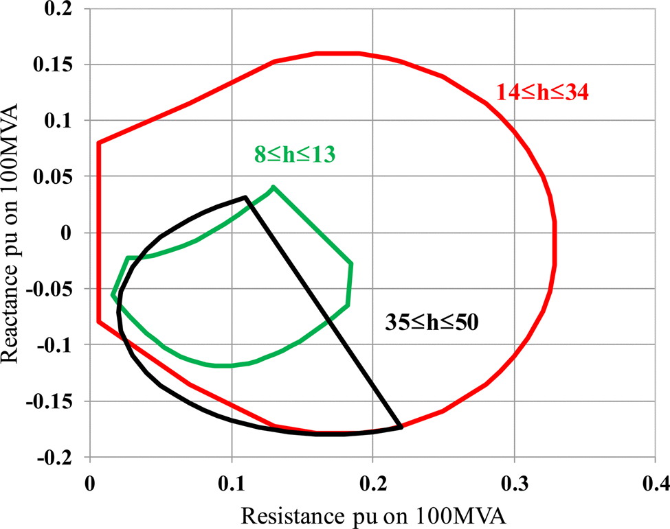

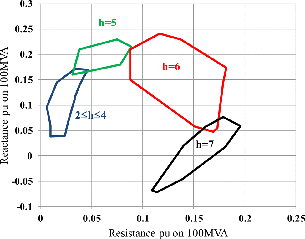

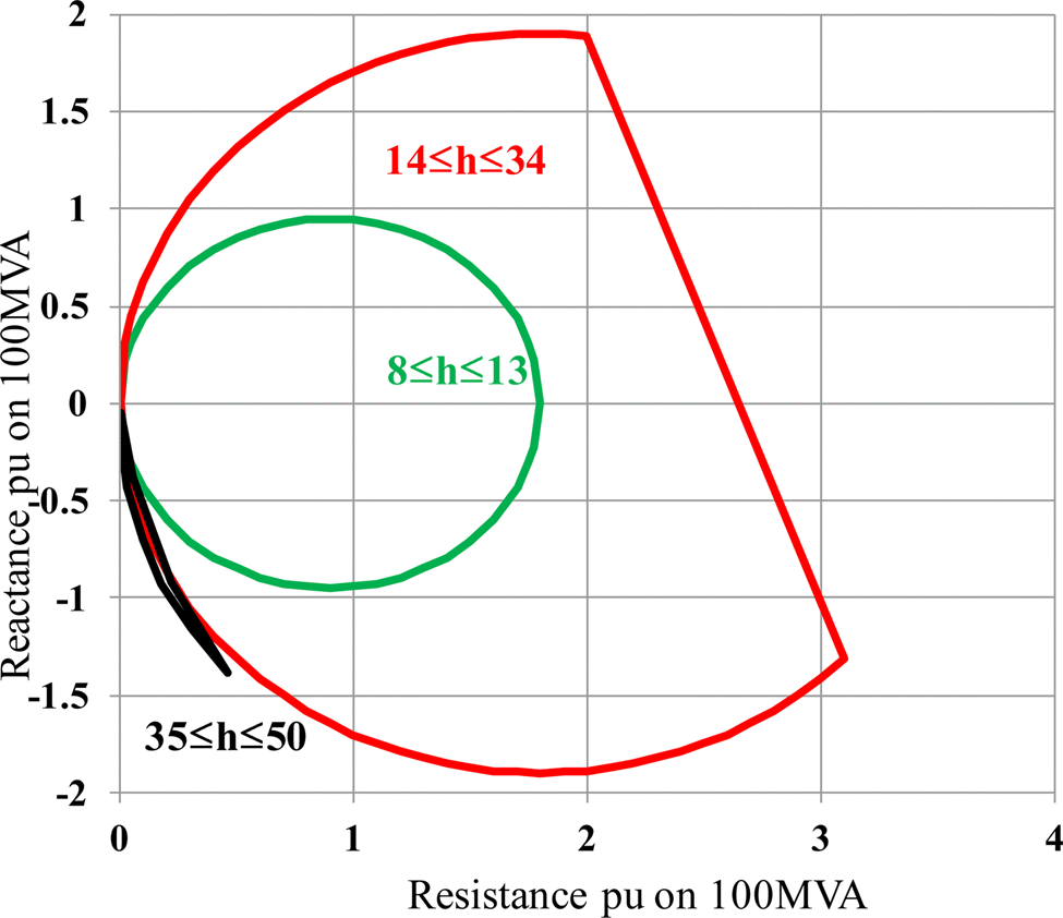

Impedance loci
The incremental and aggregate harmonic voltage specifications should be accompanied with information defining the impedance of the network at the point of connection. Such impedances are necessary to enable filter design to fulfil the allowable voltage distortions included in the specification. Owing to the aforementioned range of impedances as a result of variations in the system operation, a set of network harmonic impedance envelopes is often the most appropriate way of presenting this information. These envelopes are formed for each harmonic by plotting the system impedance for each system configuration in the R– X plane. Some plots may be formed for a small band of harmonics if the range of impedances is similar. It is particularly important to define the boundaries of these ranges such that resonance points do not coincide with the boundaries.

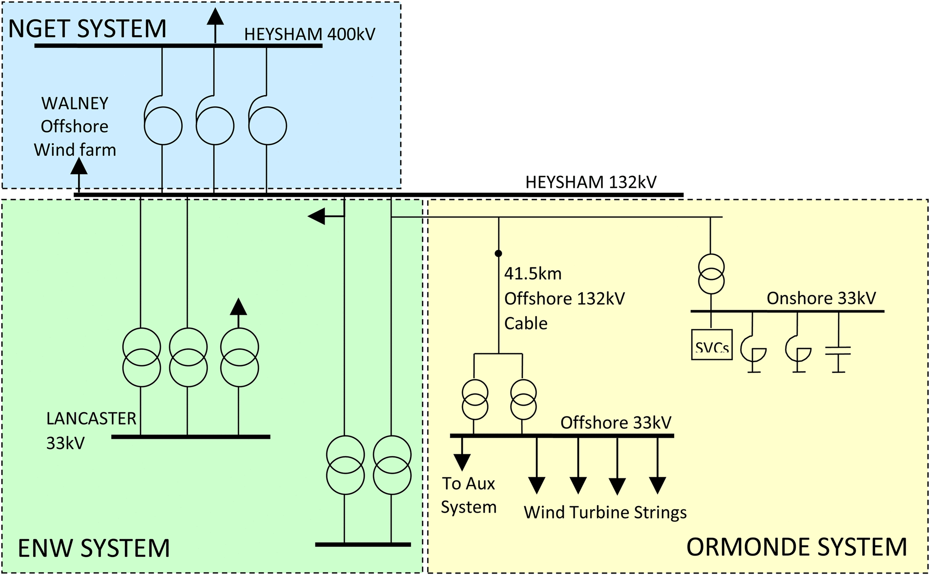

The connection of Ormonde Offshore Wind Farm (OOWF) involved following the harmonic assessment, specification and review process as described in [9]. A Stage 3 assessment according to ER G5/4-1 [1], requiring determination of harmonic voltages based on a harmonic impedance model, was necessary for the assessment of the OOWF development.
OOWF, located 10 km off Barrow-in-Furness in the Irish Sea, comprises thirty 5 MW offshore wind turbines. It is connected to the Electricity North West Limited (ENWL) power network at Heysham 132 kV. A 132 kV subsea cable 41.5 km long connects the offshore substation to a cable interconnection facility on shore, from where a further 2.8 km land cable makes the connection at Heysham 132 kV substation.
The local connectivity is depicted in Fig 2. To avoid being overly cautious, the assessment considered single outage scenarios, specifically an outage in either the ENWL or National Grid (NGET) system.
Fig 2: Schematic showing the connectivity of the Ormonde wind farm system
At the time of the harmonic assessment, the connection of Walney offshore wind farm at Heysham was also being planned and had been the subject of NGET harmonic assessments. Two connections at the same point and at the same time added some complexities, but also provided a temporary advantage. It meant that some delays were caused because the assessments were sequential and the Ormonde assessment could not start until the Walney assessment was completed. Also, the Ormonde assessment was complicated by having to consider an outage of the Walney wind farm connection meaning that the studies needed to be repeated for both with and without the Walney network connected. However, further down the line when installation of the Ormonde filter was delayed, the close proximity of the Walney system meant that Ormonde could agree with ENWL temporary conditional operating regimes to ensure harmonic voltage distortion compliance before the Ormonde filter was installed.
Data from the system operators and also the manufacturers of the new equipment was used to develop a detailed representation of the wind farm power network connected to the ENWL system with a simple equivalent of the transmission system. This model was used to evaluate the incremental harmonic voltage distortion because of the new harmonic current sources in the wind farm. Utilising measurements of the background harmonics in the existing system, the same system representation was used to evaluate the expected modified background harmonic voltage distortion at the PCC based on amplification factors. Power system simulation software with harmonic analysis capability was utilised to calculate the voltage distortion from the new harmonic source and the self-impedance values used within the determination of the modified background harmonic voltage distortion. However, some subsequent processing of this data was then required to calculate the overall prospective harmonic voltage distortion (in this case a spread sheet).

The specified limits presented in Table 1 were accompanied with the set of network harmonic impedance envelopes, applicable to the point of connection, presented in Figs 3–6.
Fig 3: Network impedance envelopes seen from Heysham 132 kV for 2 ≤ h ≤ 7 without Walney
Fig 4: Network impedance envelopes seen from Heysham 132 kV for 8 ≤ h ≤ 50 without Walney
Fig 5: Network impedance envelopes seen from Heysham 132 kV for 2 ≤ h ≤ 7 with Walney
Fig 6: Network impedance envelopes seen from Heysham 132 kV for 8 ≤ h ≤ 50 with Walney
During the harmonic assessment process close co-operation ensured that the harmonic specification was based upon the most suitable parameters and was adjusted to match the expected performance of the wind farm system with the planned filter design.
