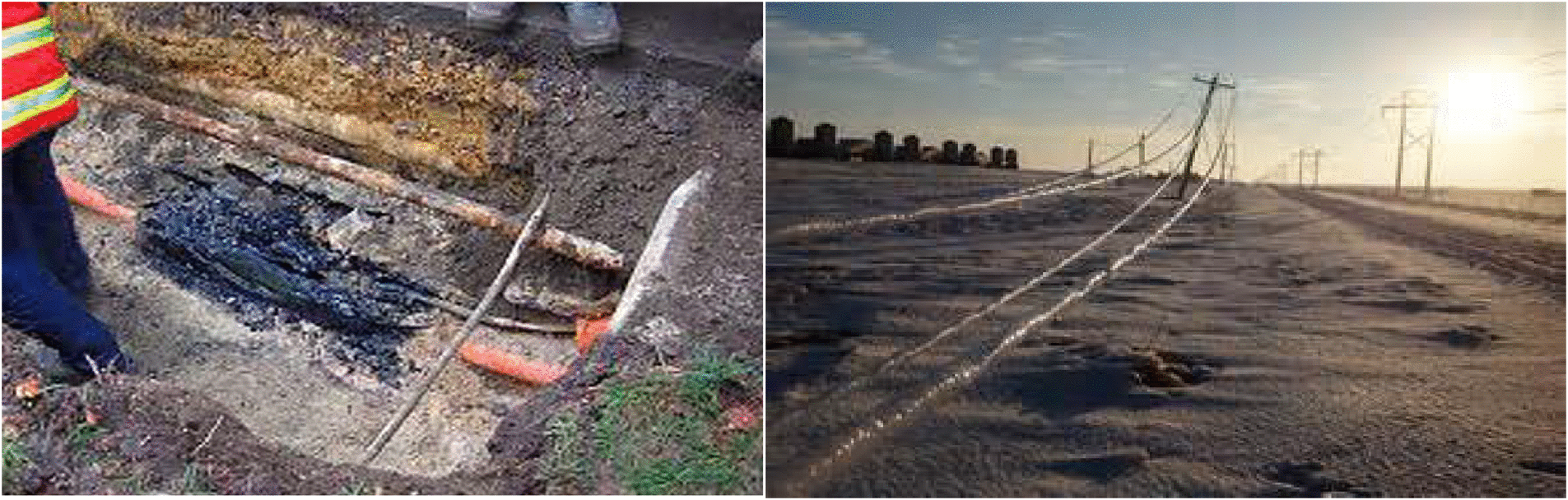

Underground cables are inherently very reliable if installed correctly and not subjected to overloads. Generally, the investment strategy for cables is to replace when there is a fault, unless there is a known reliability issue or safety concern associated with the asset. Underground cables can be subject to third-party damage and it is essential that parties working in the vicinity of cables deploy safe digging practises including detailed cable records. The main cause of cable faults are joints or wear and tear of an ageing asset. There is very little opportunity for non-invasive inspection or maintenance of these assets.
Overhead lines are a significant asset type for most DNOs and generally perform well; however, they can be affected by severe weather and other environmental factors. Weather is the main cause of network faults, though trees and third-party interference are also common factors. Overhead lines can be easily inspected and maintained and are replaced following a condition-based assessment.

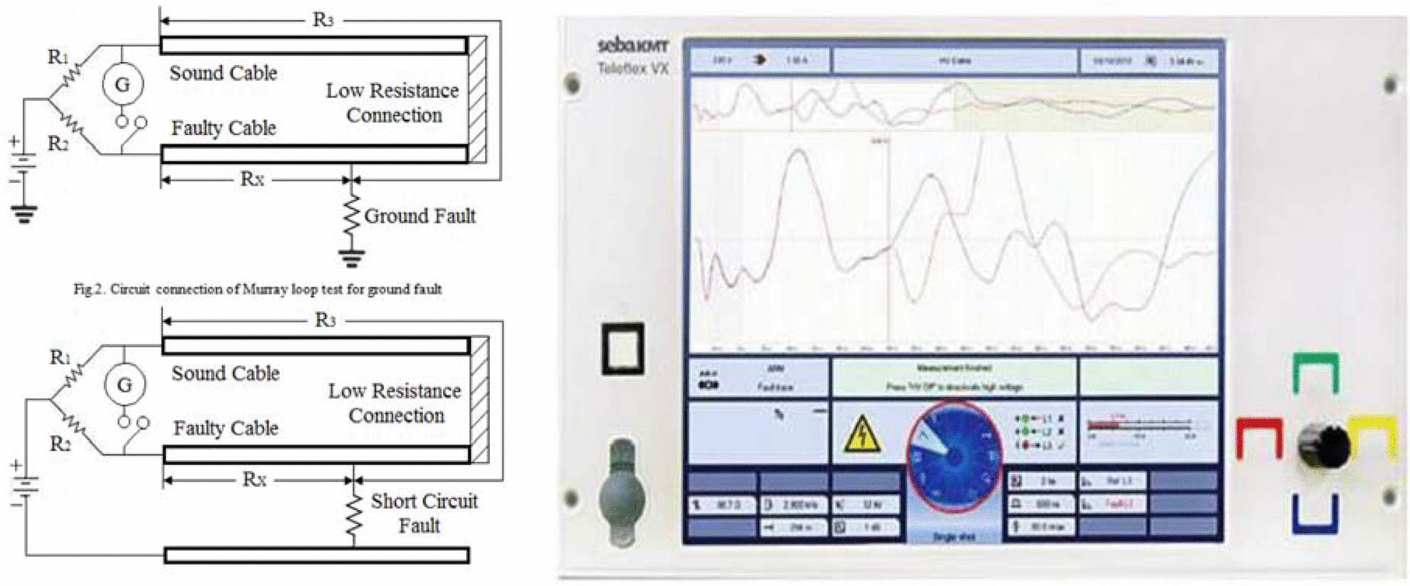

To achieve an efficient fault location, DNOs have over the past 50 years used various methods and technology, ranging from loop techniques (Murray/Varley) with Bridge Meggers to voltage and current impulse techniques with time-domain reflectometers (TDRs). Both aforementioned methods are ‘pre-location’ practises that locate the fault to within a few metres and the final location (pin-pointing) is done with an acoustic process of putting a high-voltage surge down the cable that discharges at the point of fault which can be heard. The loop method and TDR are shown below.

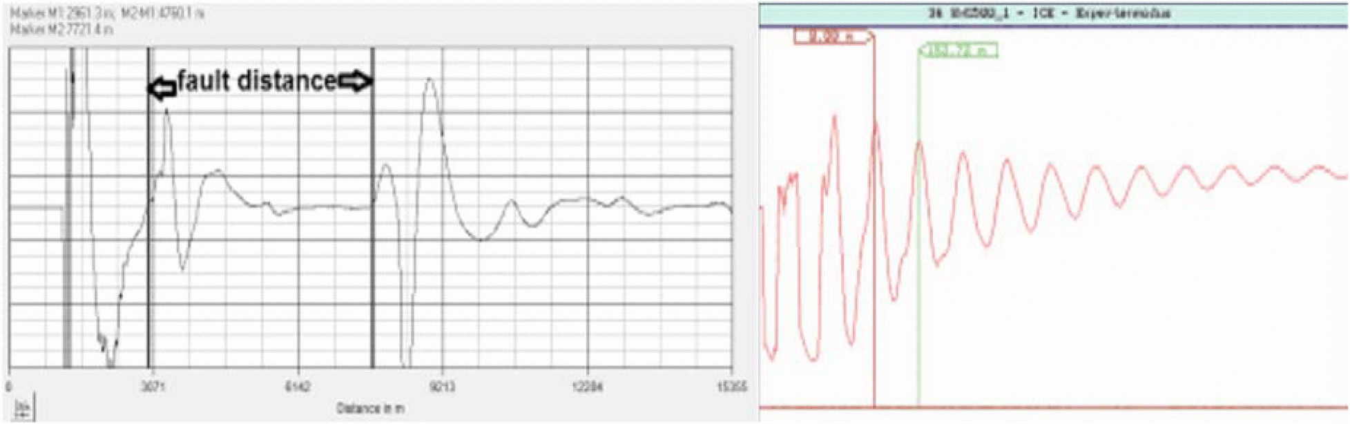

The current techniques all employ the TDR, which in simple terms is cable radar: a small pulse is sent down the cable every few milliseconds and any reflection from an impedance change is shown on a screen. The difficulty with this process is that very few HV cable faults are a low enough impedance to show up on a TDR. To assist with this process, we have to change the properties of the fault either permanently or just long enough for the TDR to capture a picture.

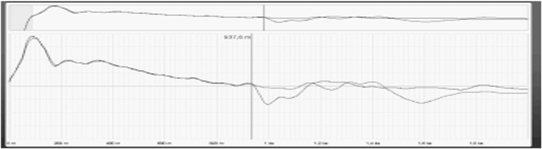

The most successful technique currently used is arc reflection method (ARM), which sends a significant charge (c. 1750–3500 J) via a surge-wave generator into the cable at a voltage high enough to cause a breakdown. When the breakdown occurs, the resultant arc is stabilised for around 20–30 ms with a further surge generator; the stabilised arc is usually zero impedance and the TDR can capture several pictures of this breakdown. On the basis of the information seen on the TDR screen and available cable records, we can calculate a rough estimate of the fault location. An example of this fault is represented and can be seen in the traces below. The cursor on the TDR shows the estimated location.
Despite ARM being the most successful method, we occasionally need to use others, the majority of which are known as transient methods utilising voltage or current. The most utilised of these is impulse current equipment. Two differing methods are encompassed here: a single-phase option or a three-phase one; the single phase is purely a high charge discharged into the cable with the TDR measuring the ‘echo’ of the breakdown on the cable. The three-phase option is used very successfully to locate very high resistance faults, particularly on 33 kV cables where the protection systems are extremely quick and the cable damage from the system energy is low. This method uses the TDR to identify the breakdown and then uses a healthy core on the cable as a reference that allows a measurement to be taken between the two to calculate an accurate distance to the fault.

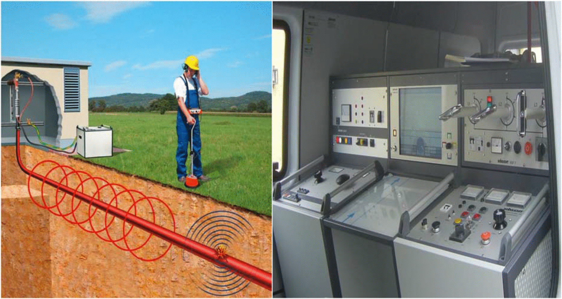

Once a location has been obtained, this distance is mapped on the cable records, which gives the engineer an area to visit and listen for an acoustic signal to pinpoint the exact location of the fault. To achieve this, we again employ the ‘surge-wave generator’ to apply a suitable charge to the cable, again typically 1750–3500 J that will discharge at the point of fault; this discharge can be heard or even felt as a shock wave on the ground. To assist on this process, the engineer utilises a listening device that can detect very small acoustic and magnetic pulses – this aids in the search for the exact point of fault. When this location is obtained, the ground above is usually marked with paint and coordinates taken to be passed onto the excavation team to open the ground around the cable in preparation for the repair process to begin.

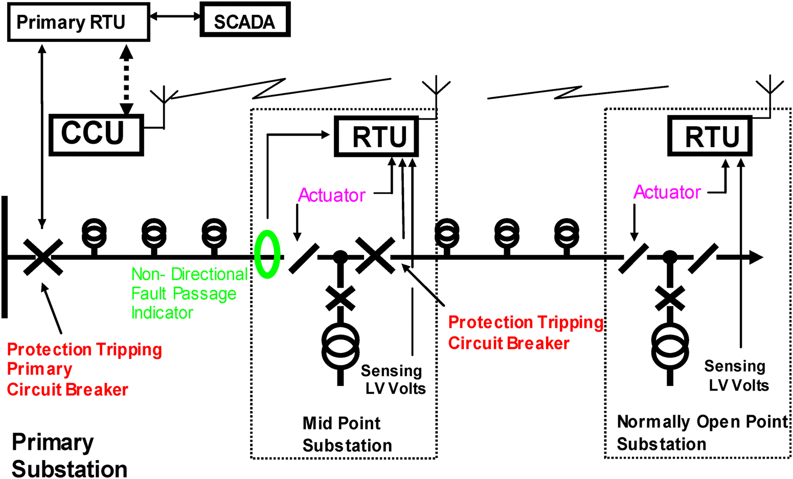

SCADA automation schemes
Modern SCADA systems also have automation applications that can create a logic-driven decision-making tool based on plant indications and alarms received under fault situations. Exploiting the increased telemetry deployed in the Distribution Network and bespoke SCADA applications results in customers being restored safely and quickly. These applications deliver tangible benefits to both customer service and the DNO IIS targets during fault outages.

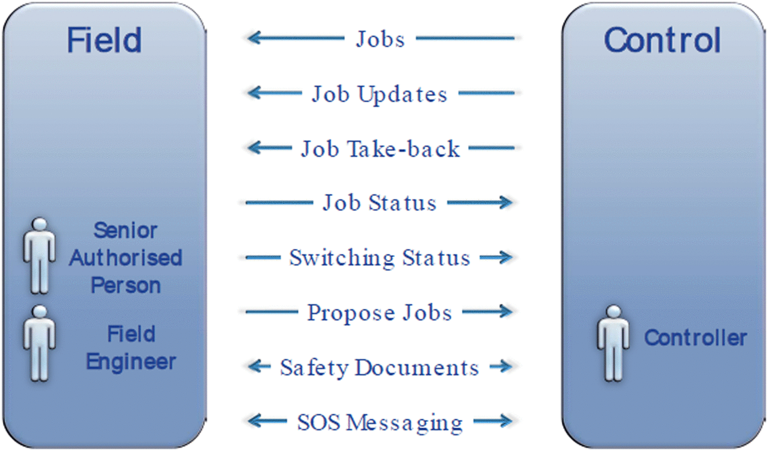

SCADA mobile solutions
Modern SCADA systems have mobile applications which allow the centralised control centres to communicate with field staff electronically via hand-held devices. This delivers efficiencies in reduced call volumes and allows the field staff to have accurate network and customer information where previously they relied on paper diagrams and verbal updates from control centres. Field staff also can update fault information in real time, allowing this to be shared with customers regarding the cause of the fault, fault progress and estimated restoration times.

Fig 1: Fault location loop method and TDR
Fig 2: TDR fault trace
Fig 3: Fault distance trace
Fig 4: Acoustic listening device and test van equipment
Fig 5: Example of faulty underground cables and overhead lines
Fig 6: Typical distribution automation architecture
Fig 7: Basic SCADA mobile functionality
