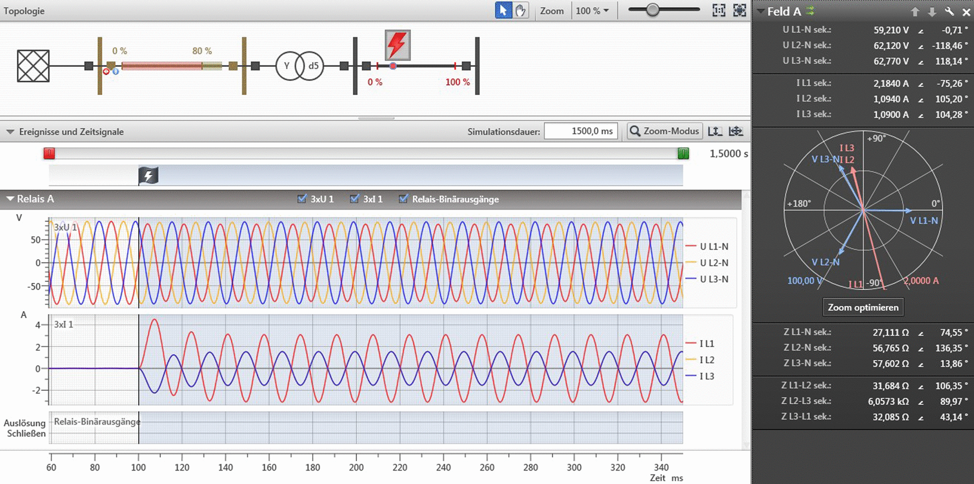

Different to conventional protection testing the injected test quantities are calculated directly from a model of the primary network topology. Within a new simulation software the topology of the protected primary power system is modelled and different fault cases can be executed with the test devices directly. The software is capable to control multiple time-synchronized test devices from one PC, so that simultaneous injection into multiple relays, which implement complex schemes using relay communication, is possible easily, even if the relays are located in different substations.
Additionally the software can adapt the simulated quantities in an iterative way to mimic a real-time closed-loop simulation even for testing of distributed protection systems in the field. In that way even complex relay logic can be observed and assessed easily.

Different to conventional functional protection testing, where usually steady-state signals are used for injection, with system-based protection testing the transient voltage and current signals are calculated directly from a model of the primary power system. Therefore, the primary network has to be modelled and the parameters of the network elements have to be entered into the test system software. On the other hand, the detailed settings of the protection devices under test are not relevant for the test (black-box approach).
First the topology of the primary network has to be defined, which is done within the test software using an easy to use graphical editor. The individual network elements are placed and connected with each other. Network elements are connected to nodes, whereas a node is either a bus bar or a simple node.

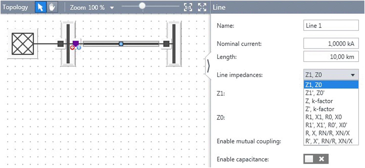

For system-based testing, the parameters of the protected lines are relevant. Therefore, they can be entered into the software in different ways, as shown in Fig 1. The software then converts the values from one to the other variant.
Fig 1: Input of line parameters

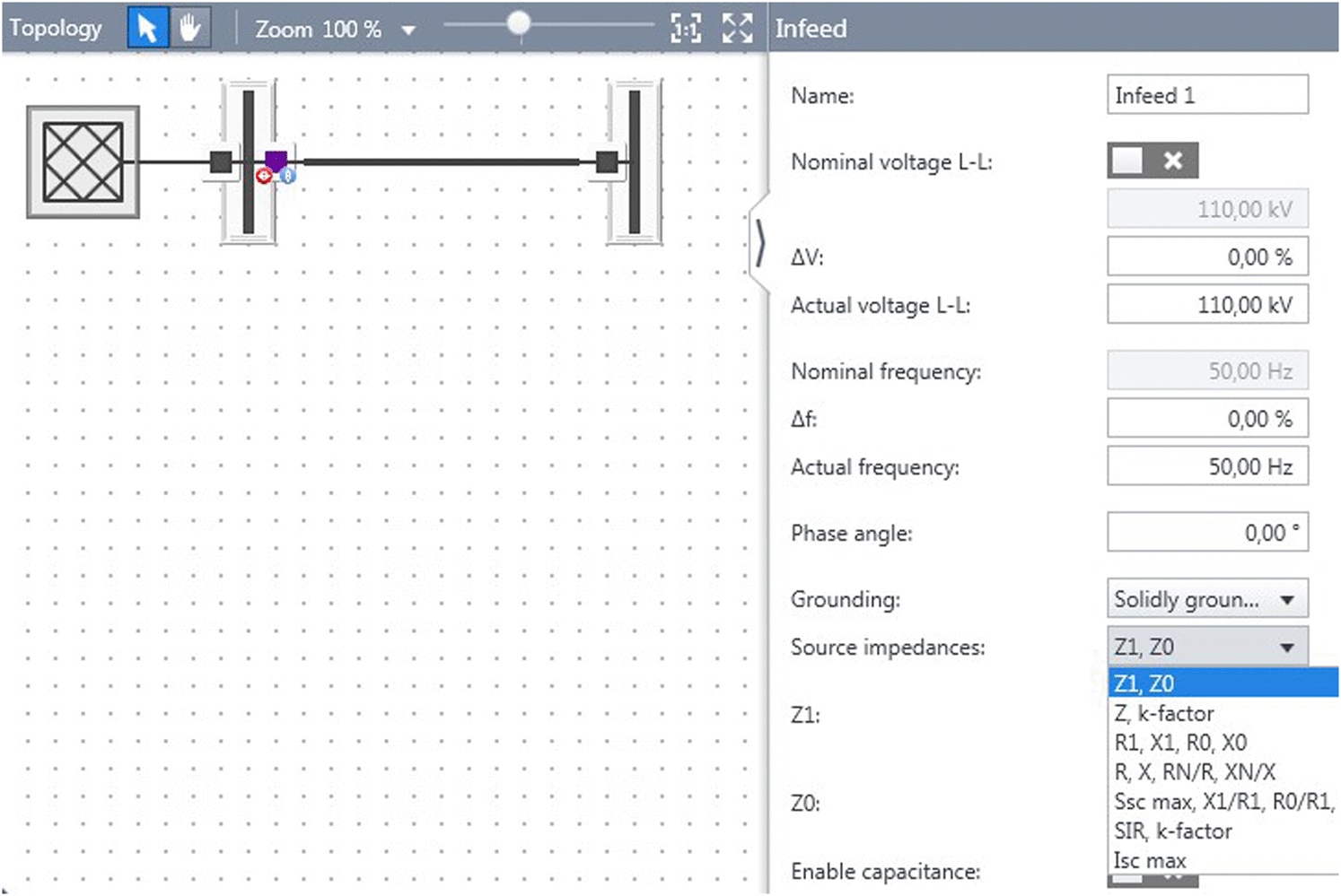

For a simulation of short-circuits in the primary system, the infeed conditions, or the short-circuit power of the infeeds, determine the magnitude of the short-circuit currents. The infeeds are modelled as voltage sources with a certain source impedance. This can be entered in different variants as shown in Fig 2.
Fig 2: Definition of infeed conditions
The short-circuit powers/short-circuit currents on network nodes (e.g. on a bus bar) can be verified within the software and compared with calculations or specifications from other sources (e.g. other offline network calculation software).

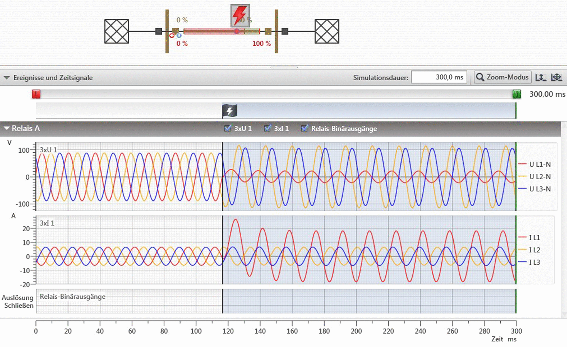

Double infeed, superimposed load flow and arc resistances
The protected line is mostly fed from both sides, a considerable load flow current is superimposed and different arc resistances at the fault location can occur. With a dynamic simulation based on a model of the protected line, the transient signals for voltages and currents for a realistic fault scenario are calculated as shown in Fig 3.
Fig 3: Simulation of a realistic fault on a line with double infeed, superimposed load flow and arc resistance
From the application software, this fault scenario can be executed directly with a test device on the protection relay and the trip behaviour can be checked and assessed. During practical tests within a substation, an overreach of a distance zone on a short line into a power station due to extreme load angle at full load has been detected and the protection settings had to be adapted accordingly.

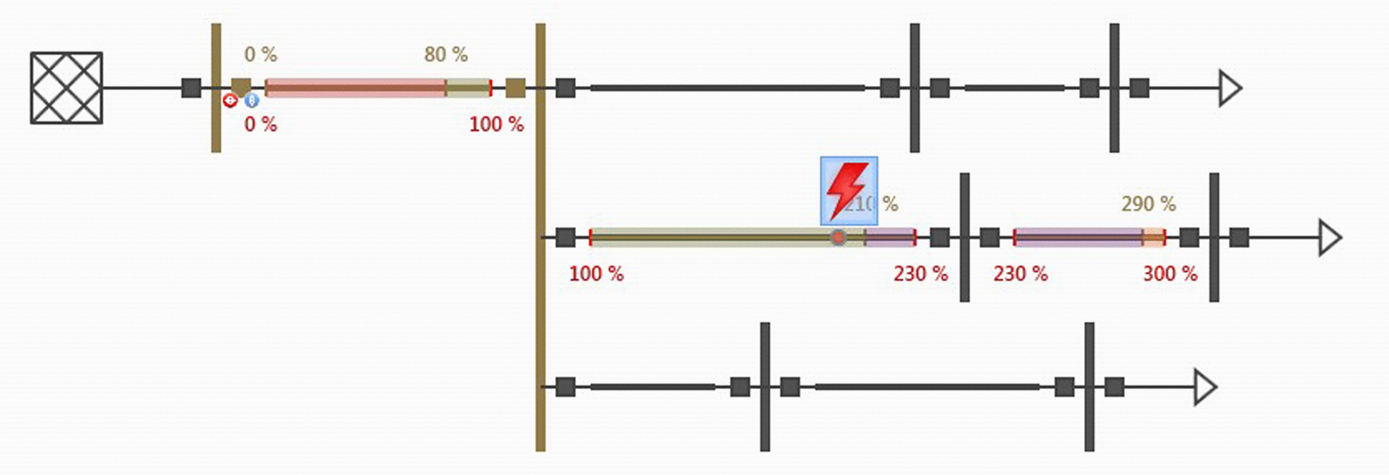

Reaches for branched feeders and across parallel line segments
The time grading of distance relays for the upper zones is set to reach beyond the primary protected line and is used as a backup protection for the following line segments. For branched feeders, correct reaches for faults on the different parallel feeders are required, as shown in the topology in Fig 4.
Fig 4: Zone reaches for branched feeders
Load flow in the parallel feeders influences the reaches of the zones which can be simulated and verified during a test.

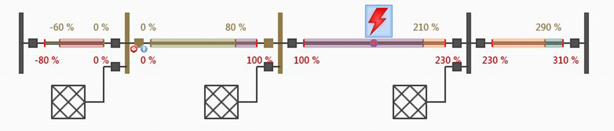

Effect of intermediate infeeds
Reaches of upper zones are considerably affected for successor lines with intermediate infeeds. A correct test of the protection behaviour is only possible if this effect is modelled and simulated properly. Then the time grading across multiple line segments for a topology as shown in Fig 6 can be verified.
Fig 6: Multiple successor lines with intermediate infeeds
For the test, different infeed conditions, as they are expected in reality, can be simulated in a row and the trip behaviour of the protection relay can be assessed.

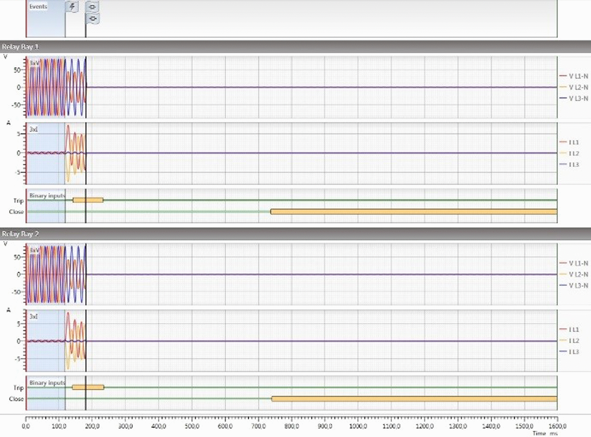

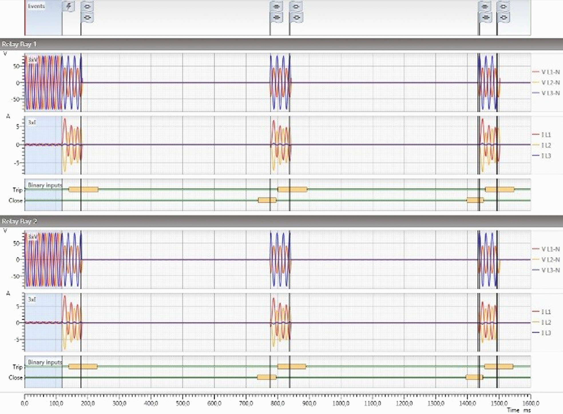

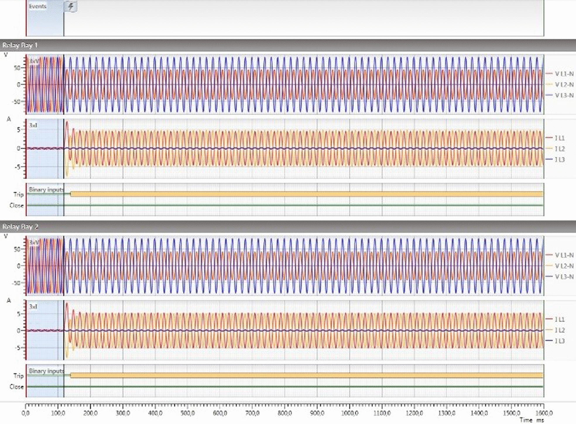

Iterative closed-loop tests for distributed tests in the field
An iterative approach for a closed-loop test is possible even for distributed test devices in the field. Therefore, the behaviour of a real-time closed-loop simulation is mimicked using multiple repetitions of individual test steps. A single scenario is simulated repeatedly where the reactions of all relays, which have been recorded during previous iterations, are considered correctly.
If we assume that all protection devices behave deterministically, that is they show the same reaction if we repeat the same scenario (some time tolerance is accepted by the application), using an automatic iteration of the test steps with the final test step we get exactly the same behaviour as with a real-time closed-loop simulation. The test is repeated again and again, until no further new reactions of the protection devices, not already recorded, are seen.
As an example, the following figures show some iterations of a test of an automatic reclosing from an end-to-end line protection system. Within the first iteration, the simulation cannot react on the instantaneous trips of both relays, so the fault persists during the whole simulation duration, as shown in Fig 8.
Fig 8: First iteration
Within the next repetition, the simulation considers the trip of the circuit breakers on both ends (after a certain circuit breaker delay time set within the software), so that the fault is cleared. Again the application cannot foresee that the relays will try to reclose after about 500 ms, which is shown in Fig 9.
Fig 9: Iterative test step after application of trip commands
This is repeated automatically until no further new reactions from the relays are seen. The final test step, including two (not successful) reclosing cycles, is shown in Fig 10 and is identical to a real-time closed-loop simulation.
Fig 10: Final test step after application of all trip and close commands
The iterative closed-loop simulation is controlled from application software which is capable of controlling multiple test devices, even remotely using a network connection. The software repeats all the test steps automatically, so that no manual interaction of the user is necessary. Using this approach, complex fault scenarios can be simulated, where the software adapts according to the reactions of the protection relays and without the need for the user to manually configure a complex sequence of events within the application.
For analysis and assessment of the results, the same tools are available as for a single-end test. All reactions of all relays are available as binary traces within the application and it is possible to measure and assess time delays between any event and any slope of a binary signal.
Using this approach, several issues with co-ordination of auto-reclosing for end-to-end line protection could be identified. A potential problem can occur if the pause times of the relays on both ends of a line are not set up accordingly (considering different circuit breaker delay times) so that a temporary line fault cannot be extinguished during the pause time.
An additional problem was found regarding the pickup of a distance zone during the pause time of an auto-reclose cycle with superimposed load flow, which could be simulated using the new dynamic testing approach in an end-to-end test.
