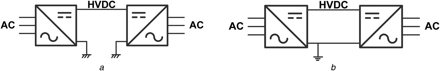

Asymmetrical monopole
The simplest arrangement of a two AC/DC converters for HVDC transmission is the ‘monopole’ arrangement, as shown in Fig 1 a. Here, there is only one high-voltage conductor connecting the two high-voltage converter terminals and this conductor could be overhead line underground/submarine cable or some combination of both. The other terminal of each converter is connected to the earth or to the sea, with the earth and/or sea providing a return conduction path. In a practical case, the actual connection to the earth or to the sea is made with ‘electrodes’ [3] and these are typically connected to the low-voltage terminal of the converter via short (10–20 km) electrode lines which, again, can be either overhead line or underground cable.
Fig 1: Monopole HVDC interconnection
a) Monopole with earth return
b) Monopole with metallic return
A disadvantage of the use of electrodes is that the electrode material at the anode will be depleted with ampere-hours of usage, requiring replacement after some time. Also, current flow in the earth or sea will find the lowest path of resistance and this maybe a third party’s buried infrastructure, potentially resulting in erosion. It should also be noted that in some countries the use of ground or sea return is not permitted. In the case of the UK the amount of compass deviation induced by submarine cables is limited. To control this, the go and return currents need to follow a similar path such that the induced magnetic field of one cable cancels that of the other leaving little residual magnetic field at the surface. Hence, an alternative arrangement is to use a second overhead line or cable to connect the low-voltage converter terminals together, earthing only one end, Fig 1 b. Note that, as one end is earthed, this second conductor, referred to as a ‘metallic return’, is at a much lower voltage and hence lower cost, when compared with the high-voltage connection.

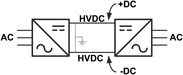

Symmetrical monopole
A ‘Symmetrical monopole’ is similar to the monopole with metallic return as shown in Fig 1 b, except that in this arrangement both conductors are operating at a DC voltage of equal magnitude but opposite polarity. Compared with the monopole, for the same DC current rating, the high-voltage conductor’s voltage rating with respect to ground is halved; however, there are now two. A typical arrangement for a symmetrical monopole is shown in Fig 2.
Fig 2: Symmetrical monopole HVDC interconnection
When comparing Figs 2–1 b, it can be seen that the mid-point voltage of the converter in the monopole arrangement is at 50% of the DC voltage whilst in the symmetrical monopole arrangement the nominal DC voltage at the mid-point is zero. This impacts on the design of the AC side of the converter, where the converter consists of only one bridge a symmetrical monopole arrangement will mean that the AC side of the converter will be exposed to approximately zero DC voltage and this will, in turn, reduce the cost of the transformer connecting the converter to the AC power grid. As discussed in Sections 4 and 5 below the single bridge arrangement is more common with a VSC converter than with an LCC converter.

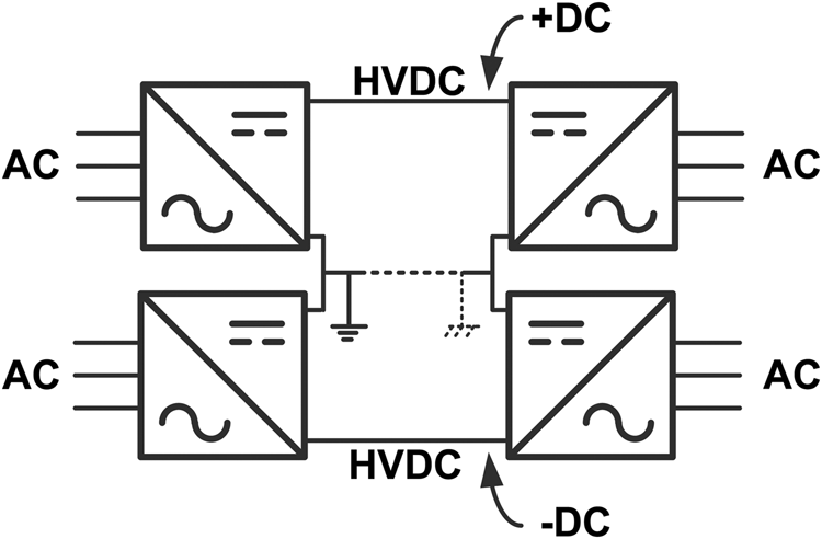

Bipole
By taking two monopoles, Fig 1, and using a common return path for both, the ‘bipole’ arrangement shown in Fig 3 can be created. By balancing the currents in Pole 1 and Pole 2 in Fig 3 the DC current will flow in the two high-voltage conductors only; thereby, eliminating any losses associated with the metallic return conductor (I 2R) or erosion of the electrodes, if used. However, in the event of the failure of either Pole 1 or Pole 2, the remaining, healthy, Pole retains a DC current path and hence can continue to transmit power.
Fig 3: Bipole HVDC interconnection
The bipole arrangement can be further enhanced, in terms of its flexibility, with the addition of DC commutating switches which permit the high-voltage conductor of the Pole out of service to be used as a metallic return path of the healthy pole in order to either parallel the existing metallic return path and hence reduce the transmission losses or to minimise the ampere-hour depletion of the electrodes by commutating the current into the new ‘temporary’ metallic return path.

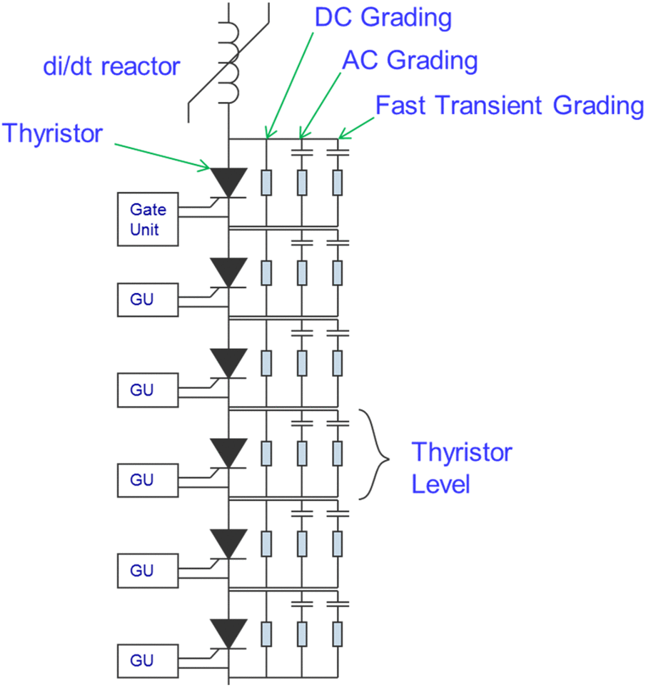

The basic building block of an LCC converter is the thyristor which is a semiconductor switch that can conduct current, in one direction only, when both positive voltages are placed across its terminals and a ‘gate pulse’ is applied. By controlling the time when the gate pulse is applied within each AC system cycle, the DC voltage produced by the converter can be controlled and hence the DC power flow can be controlled.

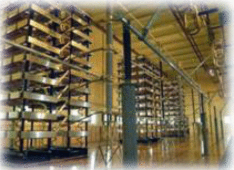

The thyristor, as a single device, does not have sufficient voltage rating for HVDC applications and hence a single valve (phase arm) of a converter consists of many devices in series in order to achieve a higher-voltage rating. For example, a 500 kVdc converter may comprise 12 valves, each valve comprising around 72 series connected thyristors. The challenge for the valve designer is therefore to ensure that the AC, DC and transient voltages are shared across the series string of thyristors and that coherent switching is achieved. This necessitates the addition of extra components within the valve making the thyristor a small, but necessary, part of the complete valve, Figs 4 and 5.
Fig 4: Typical section of an LCC thyristor valve indicating six series thyristors plus associated components
Fig 5: Interconnection France-Angleterre HVDC 3-phase thyristor valve arrangement [5]

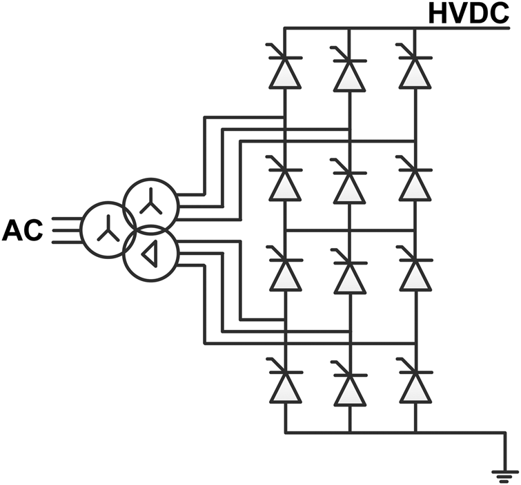

The AC–DC conversion and vice versa is achieved by switching the part of the AC waveform that is connected to the DC terminals throughout the 3-phase AC cycle. The actual conversion process is discussed in many texts [4,6] and is not elaborated further here. The converter operation produces harmonics: AC current harmonics and DC voltage harmonics. The DC side harmonics do not always require filtering, particularly when the DC transmission circuit is entirely via underground or submarine cables. However, the AC side harmonics always require filtering, necessitating the inclusion of 3-phase AC filter banks to shunt the harmonic currents away from the AC system to which the converter is connected.
The basic building block of the LCC converter is the 6-pulse bridge, consisting of six valves and this produces AC harmonics of the order of 6n ± 1 (i.e. 5th, 7th, 11th, 13th, 17th, 19th, 23rd, 25th etc.). The 5th and 7th harmonics in particular are problematic for the filter designer as they are of a large magnitude [Ih=Ifundamental⋅(1/h)Ih=Ifundamental⋅(1/h)] and relatively close to the fundamental frequency making it difficult to design a filter that can remove the majority of the harmonic current without incurring any fundamental frequency losses (i.e. the active power that is being exchanged). For this reason, almost all LCC converters are constructed in a 12-pulse arrangement, comprised of two 6-pulse converters, series connected on the DC side and parallel connected on the AC side, Fig 6. By utilising different transformer side connections (one star, one delta), the harmonics of the two 6-pulse bridges are phase shifted such that 5th and 7th cancel, 11th and 13th add, 17th and 19th cancel, 23rd and 25th add etc. Hence, with the 12-pulse arrangement the number of harmonics are reduced and the lowest AC harmonic frequency to be filtered is the 11th harmonic, reducing the complexity of the filtering.
Fig 6: 12-Pulse LCC converter
Another consequence of the operation of an LCC converter is that it will always absorb reactive power and the amount of reactive power absorbed will be approximately proportional to the active power flow; irrespective of the power flow direction. To avoid having to exchange excessive amounts of reactive power with the AC system to which the converter is connected reactive power is typically supplied local to the converter in the form of 3-phase AC capacitor banks. To optimise the utilisation of equipment, the reactive power banks are typically designed to be AC harmonic filters. However, noting that the reactive power changes with active power, the reactive power supply has to be changed in proportion. This is achieved by subdividing the reactive power supply into switchable banks (utilising AC circuit breakers). The designer’s task is to optimise the number and size of the reactive power banks whilst ensuring that the reactive power exchange with the AC system is maintained and that the correct banks are connected to give the required AC harmonic performance.

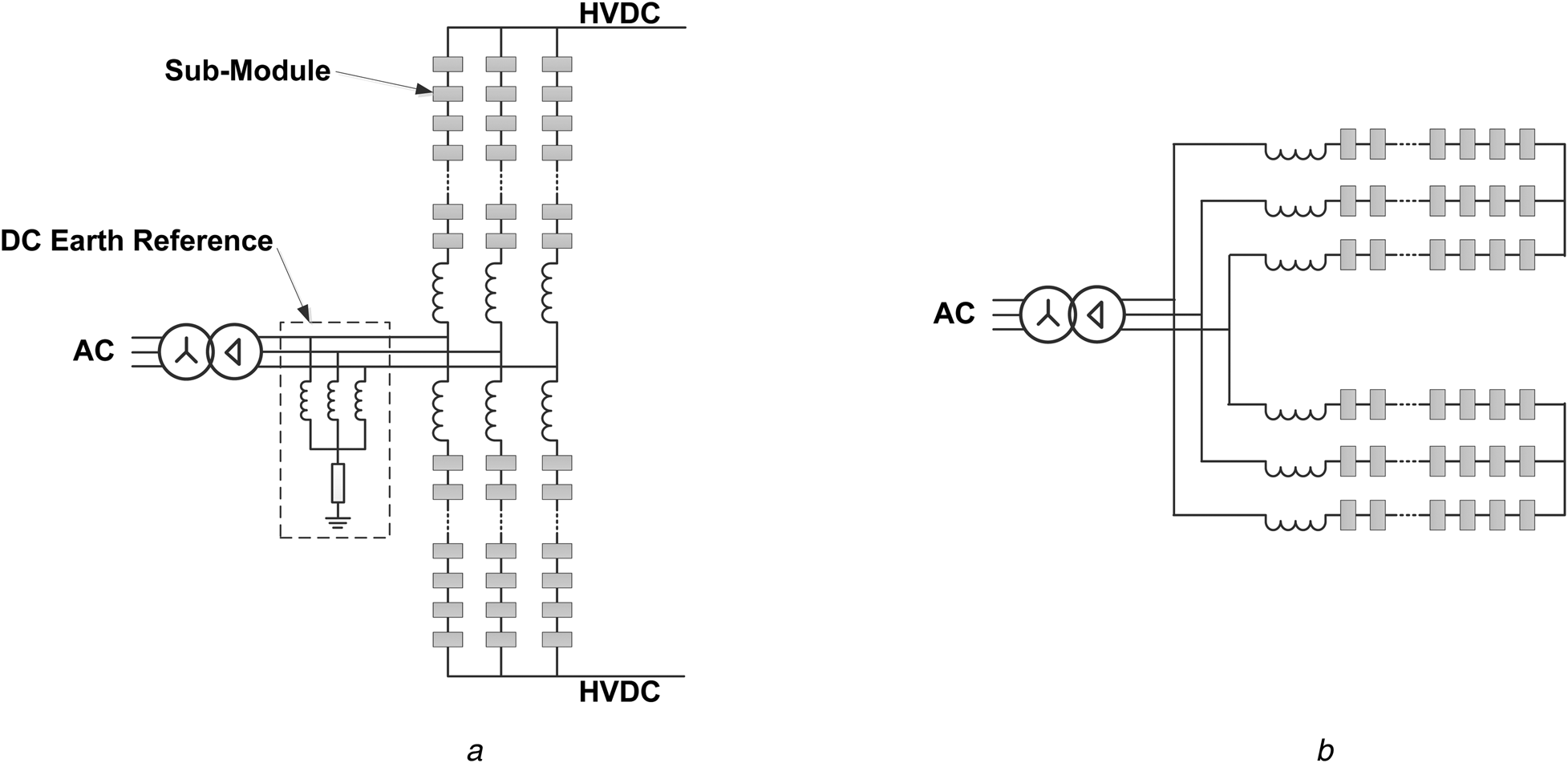

The VSC HVDC converter has gone through a number of generations of topology since its first introduction in the late 1990s. However, today the majority of new schemes are based on the MMC topology, Fig 7 a. In this arrangement, each valve consists of multiple switchable sub-modules. Each sub-module has, associated with it, an energy storage device, typically a capacitor. By switching in or bypassing each sub-module, the valve voltage can be modified. By correctly sequencing the module switching a waveshape, with a very low harmonic content, can be synthesised.
Fig 7: MMC VSC converter
a) As an HVDC converter
b) As two STATCOM’s

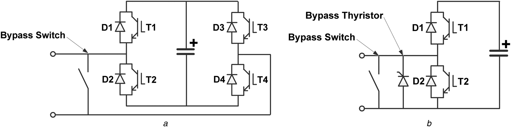

Deconstructing the converter topology depicted in Fig 7 a, it can be seen that the MMC converter is constructed from two STATic COMpensator (STATCOM) circuits, Fig 7 b [7], parallel on the AC side and series connected on the DC side. The converter is, therefore, capable of operating as a STATCOM, providing reactive power and an active power source at the same time. However, it should be noted that the converter conducts both the AC current and the DC current simultaneously and hence there is a direct relationship between the total amount of reactive power available from a converter which is rated for a defined active power and vice versa.
Whilst the STATCOM utilises a ‘full-bridge’ arrangement [8], Fig 8 a in order to optimise the overall circuit design this can be simplified [9] when the main function is active power transfer between AC and DC to the ‘half-bridge’ arrangement as shown in Fig 8 b. This half-bridge arrangement has reduced the number of semiconductors through which the current must pass, hence both reducing the capital cost and the converter losses. However, this arrangement means that there is an uncontrolled conduction path between the AC and DC terminals via the free-wheel diode D2. Under normal operation, the peak of the AC voltage must always be lower than the DC voltage in order to ensure that D2 is reverse biased and hence does not conduct. This therefore dictates, to a large extent, the selection of the converter AC side voltage. Under DC fault conditions where the DC voltage magnitude falls below that of the AC voltage D2 will conduct necessitating the opening of the converter AC circuit breaker. Where the HVDC transmission connection is a point-to-point and comprises only cable as the transmission media, the fault is likely to be permanent, resulting in an outage until the cable is repaired. However, in the event of an overhead DC line being part of the HVDC conduction path, this may suffer from temporary faults, once cleared, power flow can be restored. However, having tripped the AC breaker the power restoration time will be in excess of the typical AC system auto-reclose time which must be considered in the scheme planning.
Fig 8: MMC sub-module types
a) Full-bridge
b) Half-bridge

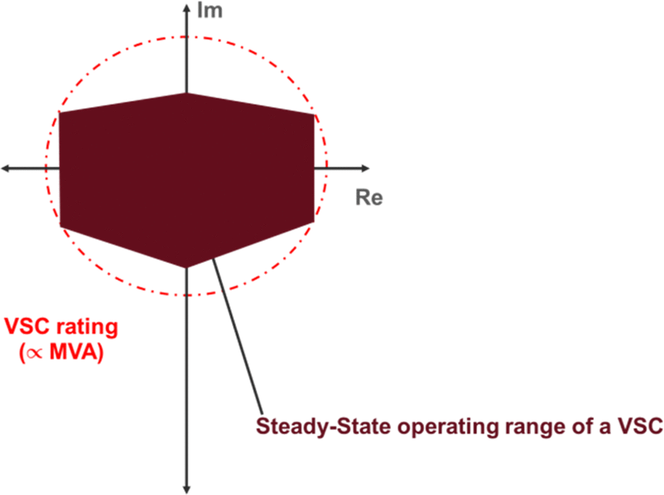

As previously noted, the real and reactive power capabilities of the converter are interdependent. However, the total available power is not simply a function of the current rating of the converter. The peak AC valve voltage is a function of the voltage generated across the valve reactors and the connection transformer leakage reactance (which will be a function of the reactive current). This peak AC valve voltage must be maintained below the DC voltage to avoid D2 conduction hence reactive power and the circuit inductance influence the selection of the nominal valve winding voltage and hence the nominal converter current and hence the losses associated with active power transfer. The result of these interactions is that a typical real/reactive (P/Q) capability characteristic for a VSC converter is similar to that shown in Fig 9.
Fig 9: Typical real/reactive power operating range of a VSC converter

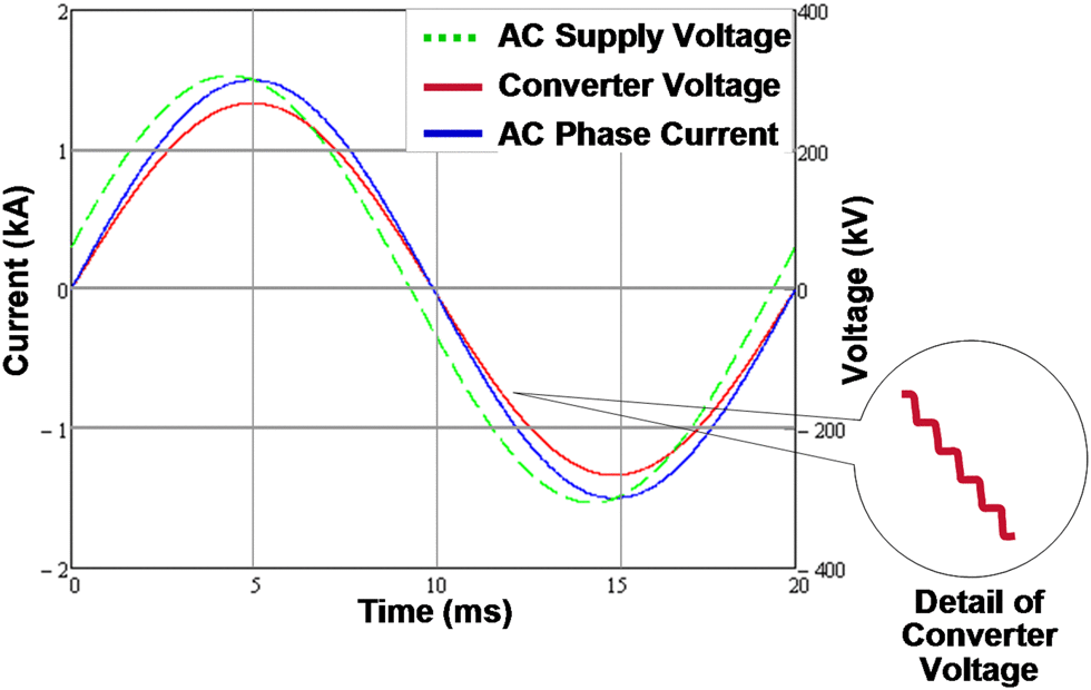

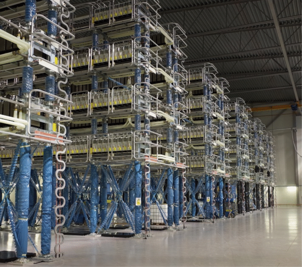

A typical ±320 kVdc converter will consist of in excess of 300 sub-modules per valve in a 6-valve arrangement as shown in Fig 10. By individually switching each of these sub-modules, the resulting synthesised waveform has minimum harmonics, Fig 11. The need for harmonic filters is therefore, in most cases, obviated from the perspective of converter-generated harmonics. However, the converter presents an inductor/capacitor circuit to the AC system which could, under some conditions act to magnify existing background harmonics. The design engineer is therefore responsible for optimising the design and deciding on whether to use the converter to damp these interactions or whether to include a passive filter to provide the necessary damping.
Fig 10: Typical ±320 kVdc VSC converter
Fig 11: Output voltage waveform from a VSC converter
