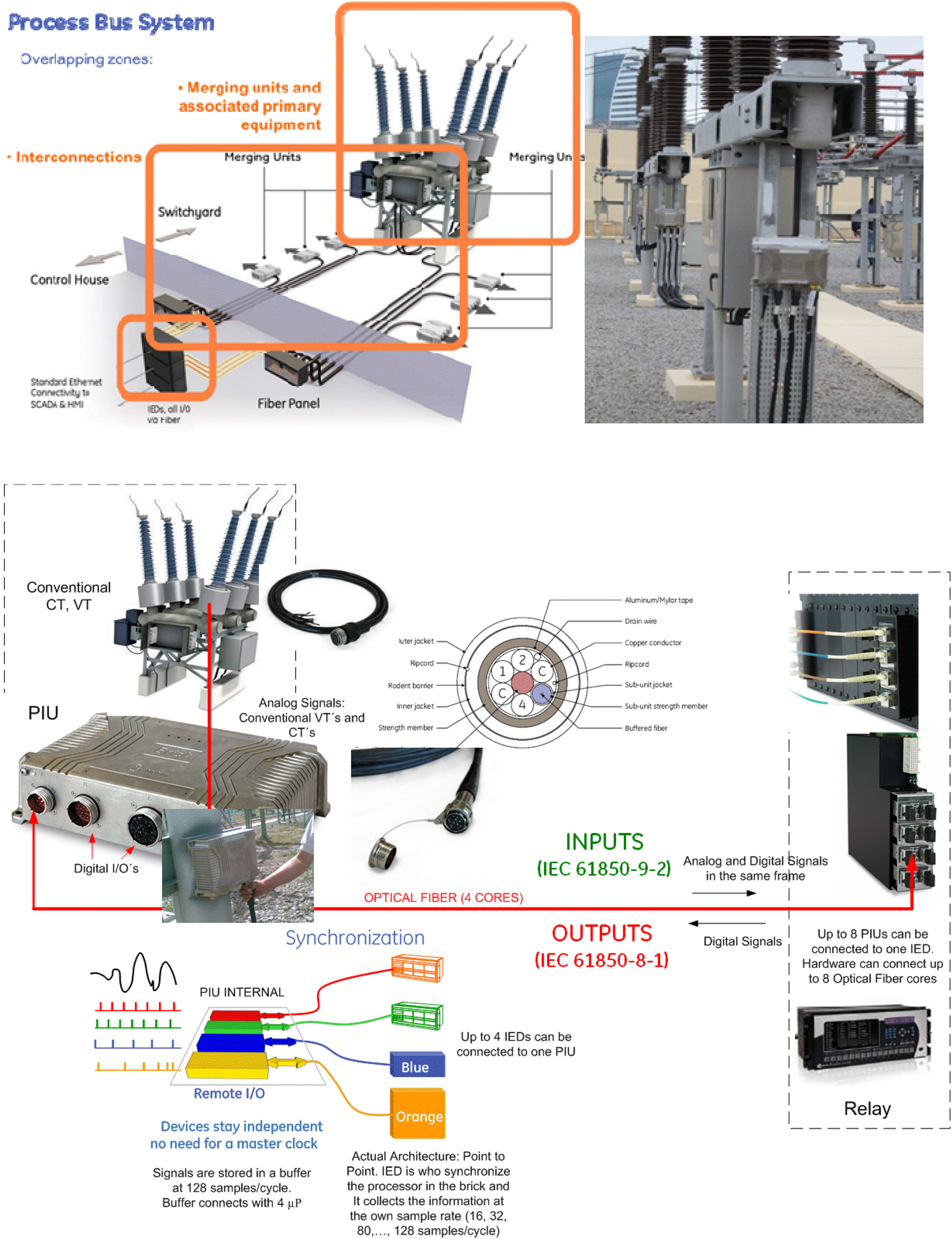

Process bus standard, as described in IEC61850-9-2, helps reducing dramatically costs and engineering efforts during installation and maintenance, resulting in less costs and enhanced security. Process bus eliminates the need for thousands of different copper cables for controls and analogue signals and substitutes them with fewer fibre optic ones (plug and play) [1]. Fig 1 shows this concept. Digitisation of primary equipment can be achieved with the use of a process interface unit (PIU), installed close to the primary equipment in the substation switchyard. This PIU converts the analogue signals of the primary equipment into digital signals. No need to duplicate signals or use interposing transformers.
Fig 1: Process bus system overlapping zones – input and output

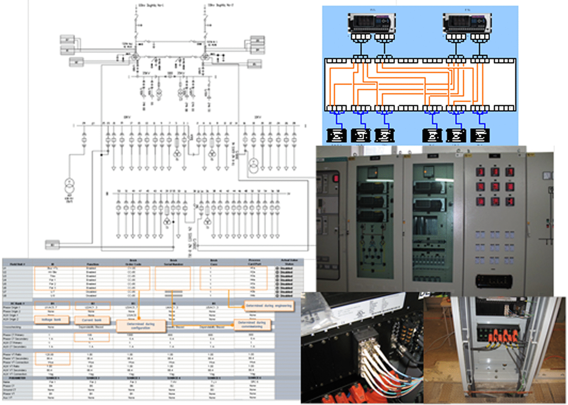

Process bus architecture used for DAGLIQ substation is depicted in Fig 2 PIU/Bricks deployed together with hardware and software interfaces are shown on the drawing.
Fig 2: Process bus architecture used for Dagliq substation

The solution proposed was, as mentioned before, a full digital substation. The use of process bus was key in achieving many of the proposed targets as it enabled huge savings. As the utility had no real experience in using IEC 61850, Araz Energy led this project as engineering, procurement and construction company (EPC). BEG took the responsibility of building P&C panels, cabling and installation manpower.
DAGLIQ substation's voltage level is 110/35/10 kV. A number of eight hard fibre PIUs/Bricks were used to protect the HV section of the substation. Hard fibre PIUs were connected to the line, CTs, PTs and power transformer protection relays, using fibre optics, avoiding most of the traditional field wiring. Fibre optic cables were in turn connected to patch panel installed inside the control panels located in the control building and routed to the corresponding protection relays. Substation single line diagram is depicted in Fig 2.
The way PIUs and relays are connected is very straightforward and allows the use of the same signal to four different protection relays. Synchronisation of samples is always ensured because of the four independent digital cores that the PIU has. This feature allows a considerable saving in hardware as one PIU can share samples between four different intelligent electronic device (IEDs). Sampling is independent for each core and it is managed by every protection relay. This system avoids the need for using network merging unit and solves the main technical issue of sample synchronisation w/o need of an external synchronisation device. All connections to the PIUs, between PIU and the patch panel and between relays and the patch panel(s) are ‘plug and play’, i.e. the related cables and connectors to PIUs, the patch panels and relays are all prepared in the factory and not in the site with no way to connect to a wrong female terminals on the PIUs, the patch panels and relays, that makes huge saving in time and skilled labours during installation and commissioning.
The scope of this project included also a complete SAS for this substation. Araz Energy designed a complete automation system maximising IEC 61850 benefits. All four substations with process bus have gateway, GE UPS for redundant servers, monitors and printers, Low Voltage DC distribution panel (LVDC)/Low Voltage AC distribution panel (LVAC) panels, 120 VDC batteries and redundant chargers; and the last three of them have 68’ DLP as monitor for the single line diagram of the substation, real time values, breakers’ status (provided by GE Power software package for substation automation) and so on.

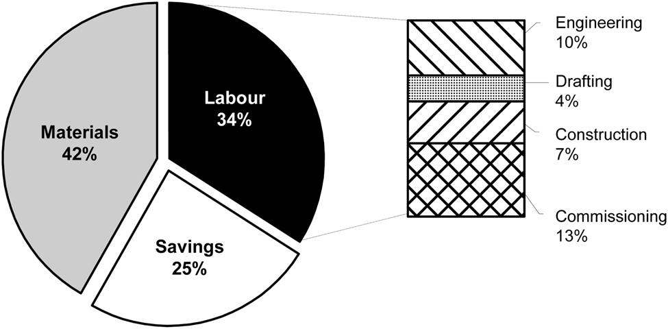

After the construction of this pilot substation three more transmission and distribution substations were built using the same technology to leverage all the advantages described earlier and take the full advantage of the new possibilities that digital substations bring.
Araz Energy signed EPC contract for all three substations at the end of July 2011, and commissioned them in the following dates: Bayil in October 2011, 227 on December 2011 and DARNAGHOL on January 2012.
The average applications per substation were: line protection (six bays), bay control (one bay), transformer protection with separate backup (two bays) and feeder protection (16 bays, but this last w/o process bus).
Reduction in time achieved in the execution of the main tasks is resumed in Table 3 and Fig. 3 (*):
Fig 3: Reduction in time achieved in the execution of the main tasks
(*) Note: Above-mentioned specific statistic data (tables and figures) is based on following parameters in Azerbaijan that would be different in other countries (based on local requirements, regulations, specifications and layouts, manpower's rate of performances and skills, etc.:
  1. Manpower (culture, efficiency, expertise etc.)
  2. When the customer asks for process bus system plus conventional mimic for manual controlling as well; otherwise, installation and cabling will decrease from 30 to 15 days, test and commissioning from 30 to 15 days and relay configuration from 45 to 30 days
  3. Coordination with the other disciplines (switchyard equipment, canals for cables, constructions of structures, control room, etc.) in the country
  4. This table is for the substations under retrofit and renovation, hence it would be different for a new substation (much less time is required)
  5. Configuration time decreases over more practices to much less than required times for regular SAS substations because of modularity and typicality of the process bus system. Hence the showed numbers are average, and we do believe it would be 20 to 25 days for our future project (depends on the size substations, number of relays, number of bays, etc.).
  6. All mentioned percentages on Tables 2 and 3 and graphs of 4 and 5 will definitely vary with voltage level, number of bays, incoming and outgoing feeders, switchgear configurations, and so on.
