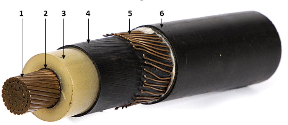

Fig 5 shows a 33 kV single-core cable with XLPE insulation, copper wire earth screen and medium density polyethylene (MDPE) oversheath. Cables to this design with rated voltages 11 and 33 kV meet BS 7870-4.10 and are typically installed by utilities. They are also available with a sheath having low emission of smoke and corrosive gas. A variant of this 33 kV cable has a lead sheath under the MDPE oversheath and is specified in BS 7870-4.11. Cables of the same basic design but with aluminium wire armour in place of the copper wire screen are commonly used in industrial applications.
Fig 5: 33 kV single-core cable with stranded copper conductor, XLPE insulation, copper wire screen and extruded oversheath
Components of Fig 5 cable:
  1. Stranded copper conductor.
  2. Extruded conductive screen.
  3. XLPE insulation (thickness 8 mm for 33 kV).
  4. Extruded conductive screen (semicon layer).
  5. Copper wire earth screen.
  6. MDPE or low-smoke and corrosive gas oversheath.

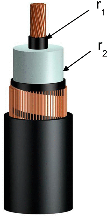

Through the range of MV and HV rated voltages the major design features are the same, the main differences being in the choice of metallic screening and outer protection. Primary insulation thickness must, of course, must be appropriate to the rated voltage of the cable. Insulation thicknesses for MV cables are defined in standards and have remained unchanged for many years. The standard thickness for each U m is the same across the range of International Electrotechnical Commission (IEC), CENELEC and associated national standards.
The variables determining the electric stress E in the cable insulation for each rated voltage are the diameter over the conductor screen and the insulation thickness. Stress at a radial position r within the insulation is given by
E=V/r⋅ln[r2/r1]E=V/r⋅lnr2/r1
where, V is the phase-earth rated voltage U 0; r 1 is the outer radius of the conductor screen and r 2 is inner radius of the insulation screen.
Maximum stress is at the surface of the conductor screen. This is the design stress of the cable. For an 11 kV cable ( U 0 = 6.4 kV) with 185 mm 2 conductor, the conductor screen diameter will be about 20 mm. With standard insulation thickness 3.4 mm the stress at working voltage is 2.2 kV/mm. This is a very modest stress for a dielectric such as XLPE which has a test breakdown strength many times this value. A short length of 11 kV XLPE cable subjected to a short-time test to breakdown might be expected to withstand up to about 80 kV test voltage, equivalent to a maximum stress in the insulation of 28 kV/mm. What has to be taken into account, however, is the very large volume of insulation in a cable network, and the length of time (hopefully at least 40 years) during which the insulation will be under stress. Both these factors influence statistical breakdown probability, which users will require to be as low as possible and within an acceptable limit.
For cables of higher rated voltage, design stresses increase. For example, the stress in a 185 mm 2 33 kV cable with standard insulation thickness 8 mm is 3.2 kV/mm. For HV cables the insulation thickness is graduated according to conductor size, to take account of the fact that maximum stress is higher for smaller conductor diameters. One manufacturer's data sheet for 132 kV cables specifies insulation thickness 18 mm for a 500 mm 2 cable. In this case the maximum stress is 6.6 kV/mm. One practical reason for accepting higher stresses in higher voltage cables is the physical size of the cable if stresses as low as 2.2 kV were maintained through the voltage range. For example, a maximum stress of 2.2 kV in the 132 kV cable necessitates an insulation thickness of 150 mm, which is clearly a practical nonsense. From the statistical point of view, the total length of installed 132 kV cable is many times less than that of 11 kV, which to some extent mitigates the effect of increase in operating stresses at higher rated voltages.

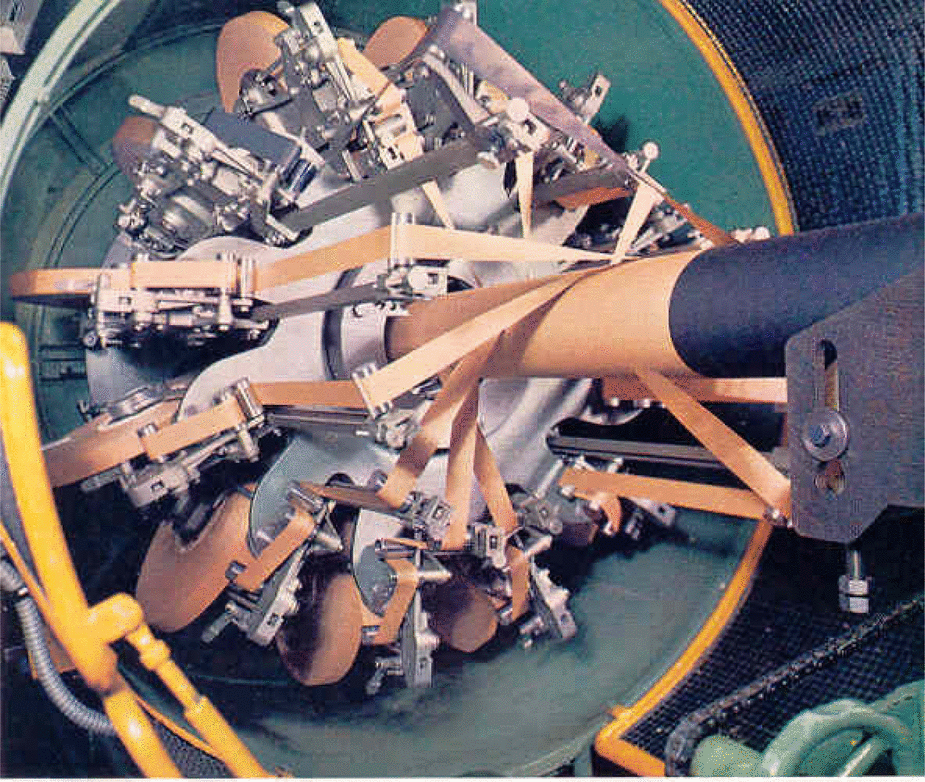

Special cellulose paper for cable insulation is applied as tapes helically wound (lapped) over the conductor layer-by-layer until sufficient thickness is built up. Typical tape dimensions are 20 mm width and 0.1 mm thickness. The full insulation thickness is applied in one pass through a bank of lapping machines within a factory area of controlled humidity and temperature (Fig 7). Small gaps (known as butt gaps) are left between each helical turn to enable the cable to bend without the tape edges creasing against each other. Bending of the cable without damage to the insulation by tearing or creasing of paper tapes is possible because of the advantageous mechanical properties of cellulose paper. Because butt gaps are electrically weaker than the paper layers, the gap positions are staggered with respect to underlying and overlying turns in order to maximise the dielectric strength of the bulk insulation perpendicular to the paper layers.
Fig 7: Paper lapping machine applying paper tape insulation
The cable at this stage of manufacture is vacuum-dried to reduce the moisture content of the paper. The drum of cable is then flooded with an impregnating compound, with the objective of filling all voids including those within the microscopic structure of the cellulose paper. Paper on its own has poor dielectric strength because of the included air in the fibrous mat structure. This manufacturing process is called mass impregnation and is followed by extrusion of a continuous metallic sheath to form a protective impermeable environment for the impregnated paper insulation.
Traditional impregnating compounds were based on mineral oils though in the later years synthetic compounds were developed and claimed to have improved properties. High viscosity compounds that would not drain from a cut cable were the preferred option in the UK for LV and MV cables because of clear advantages during jointing and terminating. This type of cable is known as MIND. Cables for transmission voltages were impregnated with low viscosity oils that could be pumped through the installed cable and maintained under low pressure to prevent the entry of air or contaminants in the event of damage to the cable sheath.
An alternative manufacturing process was the application of paper tapes that had been pre-impregnated with compound. Because of the inevitable presence of voids within the insulation body, this type of cable is maintained under pressure from an external source of gas, typically oxygen-free nitrogen.

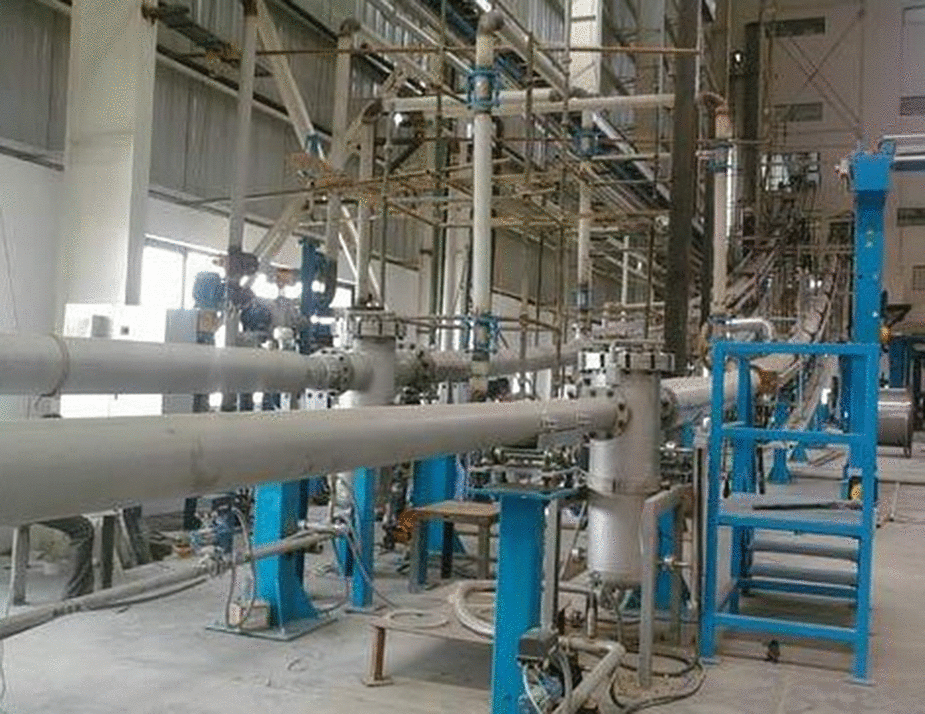

Cross-linking of XLPE takes place when active bonding sites are created on polyethylene molecules, leading to the formation of permanent chemical bonds between sites on nearby molecules. Once the polymer is cross-linked to a certain level, it is no longer thermoplastic and becomes a thermoset with changed physical properties. The other material which emerged in the 1970s as a suitable cross-linkable polymer for cable insulation is ethylene propylene rubber (EPR), with XLPE competing with EPR for technical leadership. During subsequent years, improvements in materials, manufacturing and cable design opened the way for development of MV and HV extruded cables for rated voltages eventually up to 400 kV.
Manufacture of cables with XLPE or EPR insulation involves extruding the un-cross-linked compound over the conductor as it passes through an extruder head. In the process most commonly employed by cable manufacturers, cross-linking of the insulating compound takes place immediately downstream of the extruder head by the application of heat. The cross-linking reaction is promoted by chemical additives in the compound. After the cable has passed through the heating zone it is cooled and taken up on drums to await the next manufacturing stage. This well established process is known as continuous catenary vulcanisation (CCV) and takes its name from the shape of the pipe which is attached to the outlet of the extruder head and encloses the cable during the heating and cooling stages (Fig 8). Heating used to be provided by pressurised steam but the resulting moisture content of the insulation proved to be deleterious to long-term electrical performance.
Fig 8: CCV machinery for cross-linking XLPE and EPR insulation

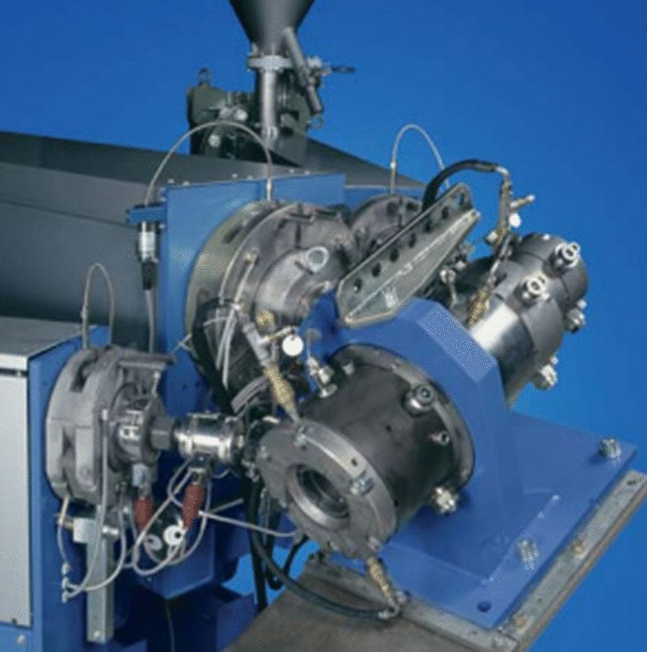

Modern MV and HV polymeric cables are all made using the triple extrusion process, in which three concentric layers are simultaneously extruded over the conductor in a single pass through a special extruder head. These three layers comprise;
  • a thin layer of conductive polymer over the conductor, forming the conductor screen;
  • the insulation of specified thickness
  • an outer thin layer of conductive polymer forming the insulation screen.
Fig 9 shows a triple extrusion head fed by three extruder screws.
Fig 9: Triple extrusion head for applying insulation and conductive screens
The triple extrusion process is the secure way of creating smooth and contaminant-free interfaces between electrostatic screens and insulation, thus avoiding points of raised electrical stress within the insulation. This development, together with refinements in insulation compound purity and manufacturing cleanliness, paved the way for the evolution of extruded cables for higher and higher rated voltages. Lessons had been learnt from early-life failures of extruded MV cables in the USA, where enthusiasm for the adoption of extruded cables was not accompanied by necessary refinement of the manufacturing process and material quality.
