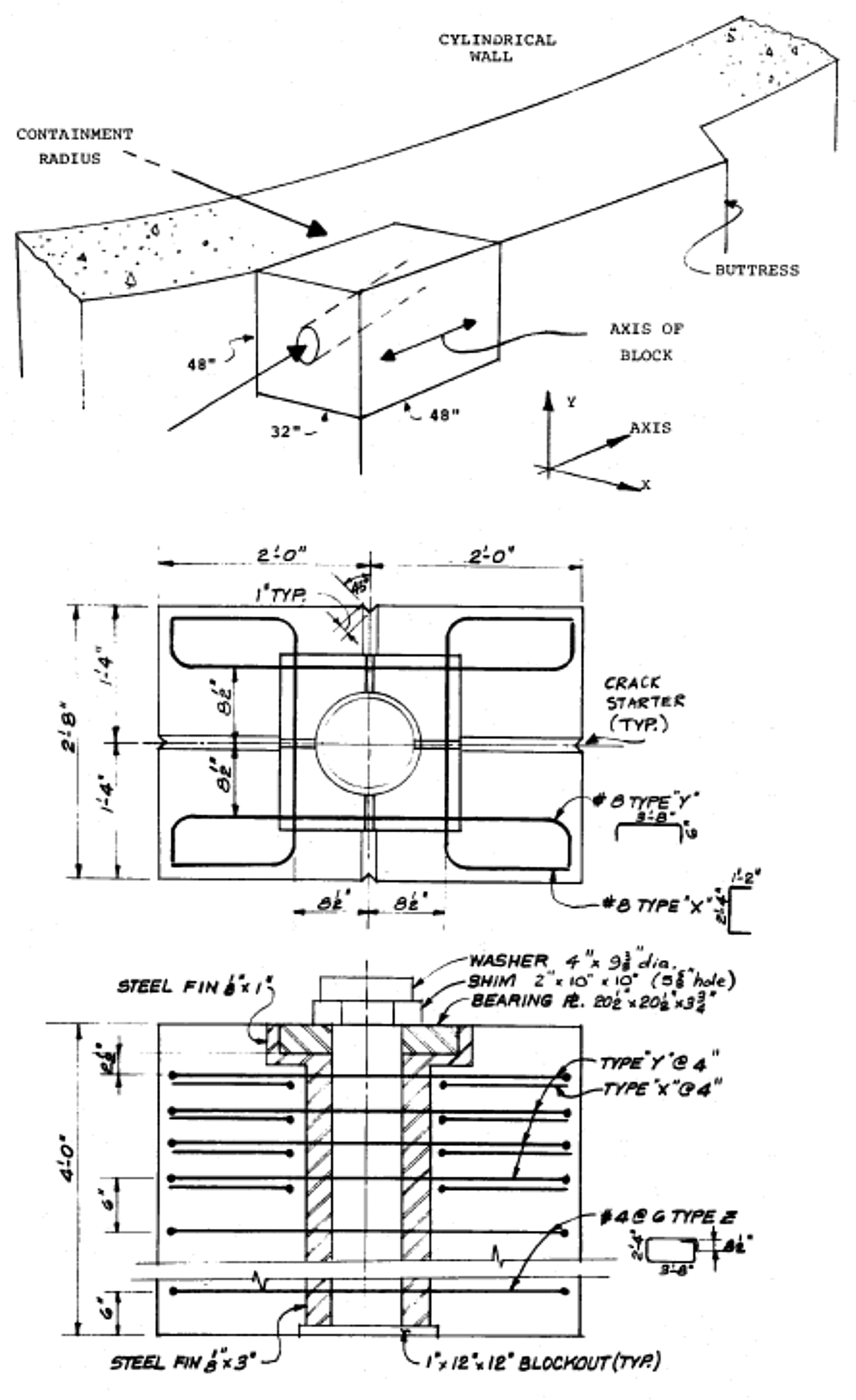

Fig 1: Prestressed anchorage block testing at a buttress [15]
Prestressed containments also require careful consideration of radial tension reinforcement because of several instances of delaminations [17]. It is recommended that prestressing tendons should not be placed near a free edge. In addition, radial tension reinforcement be provided if detailed analysis is not carried out to confirm that delamination is not likely to occur [18,19].

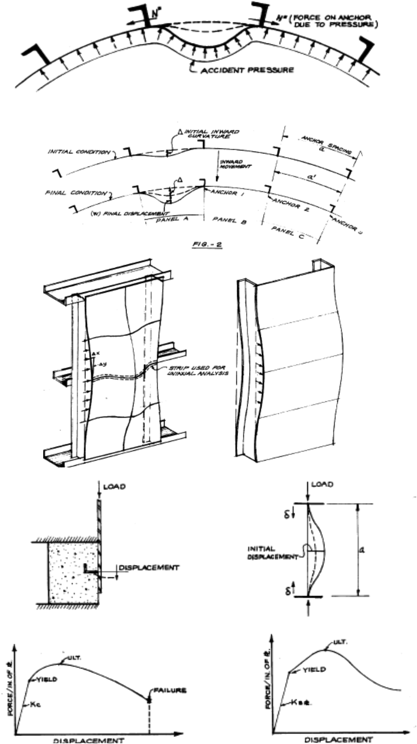

Liner and liner anchor design
A liner plate, generally 6 mm (1/4 in) to 12 mm (1/2 in) thick, is attached to inside face of concrete containment for leak protection. The liner is erected first during construction process and serves as a form for concrete placement. The liner is braced with structural steel sections (channels and angles at regular spacing) or welded studs which serve as embeds in the concrete. Although the code does not allow the liner to be considered as a stiffness or a strength element contributing to capacity, it should be ductile enough to accommodate the stresses/strains due to various imposed load conditions including accident thermal without jeopardising the leak tightness. Under accident thermal and pressure loads it is important to include the liner – concrete interaction to adequately determine stresses/strains in concrete and liner. The liner can, however, be used as a structural element to resist construction loads during concrete placement and small attachment loads from cable tray, conduit support and ladders. For large attachments, equipment and personal hatches, and piping penetrations, the liner plate is thickened locally to transfer loads to the concrete. The authors in [20–23] provide a comprehensive background on liner behaviour, design, detailing and testing (Fig 2).
Fig 2: Liner and Anchor behaviour and test simulation [20,21]
The limiting condition for liner is the strain and its impact on anchorage in concrete. There are no strength or buckling stability issues with liner as the liner is well restrained by the concrete and anchors. However, buckling needs to be considered for temporary loads during construction and installation prior to concrete placement. Hence, as long as the liner is able to perform its leak-tight boundary function, there is no limit on its strength or stability. The only issue relates to the effect of imposed deformations of the liner on anchors. The integrity of anchorage system must be maintained during the design. The liner has to be a ductile element so that it can exhibit good deformation capacity beyond yield. Consequently, full penetration butt welds are necessary to ensure leak tightness and adequate ductility of the liner plate.
The liner anchors are generally tested for the imposed ultimate deformation from the liner plate. The liner may assume an initial inward curvature during thermal accident load which is acceptable as there is no structural consequence of this deformation or resulting buckling. The force induced in the liner depends upon the liner strength and strain hardening. Therefore, liner strength is kept to a minimum with well-known yield and post-yield behaviour, if possible. Since it is practically difficult to get a well-defined yield for the plate material, higher anchor loads are induced due to higher actual yield for which high strength ductile anchors need to be used. Note that local crushing around the anchors is considered acceptable during a rare accident condition. Anchors also need to be designed for mechanical loads that may come from small attachments to the liner plate during construction or operation.
