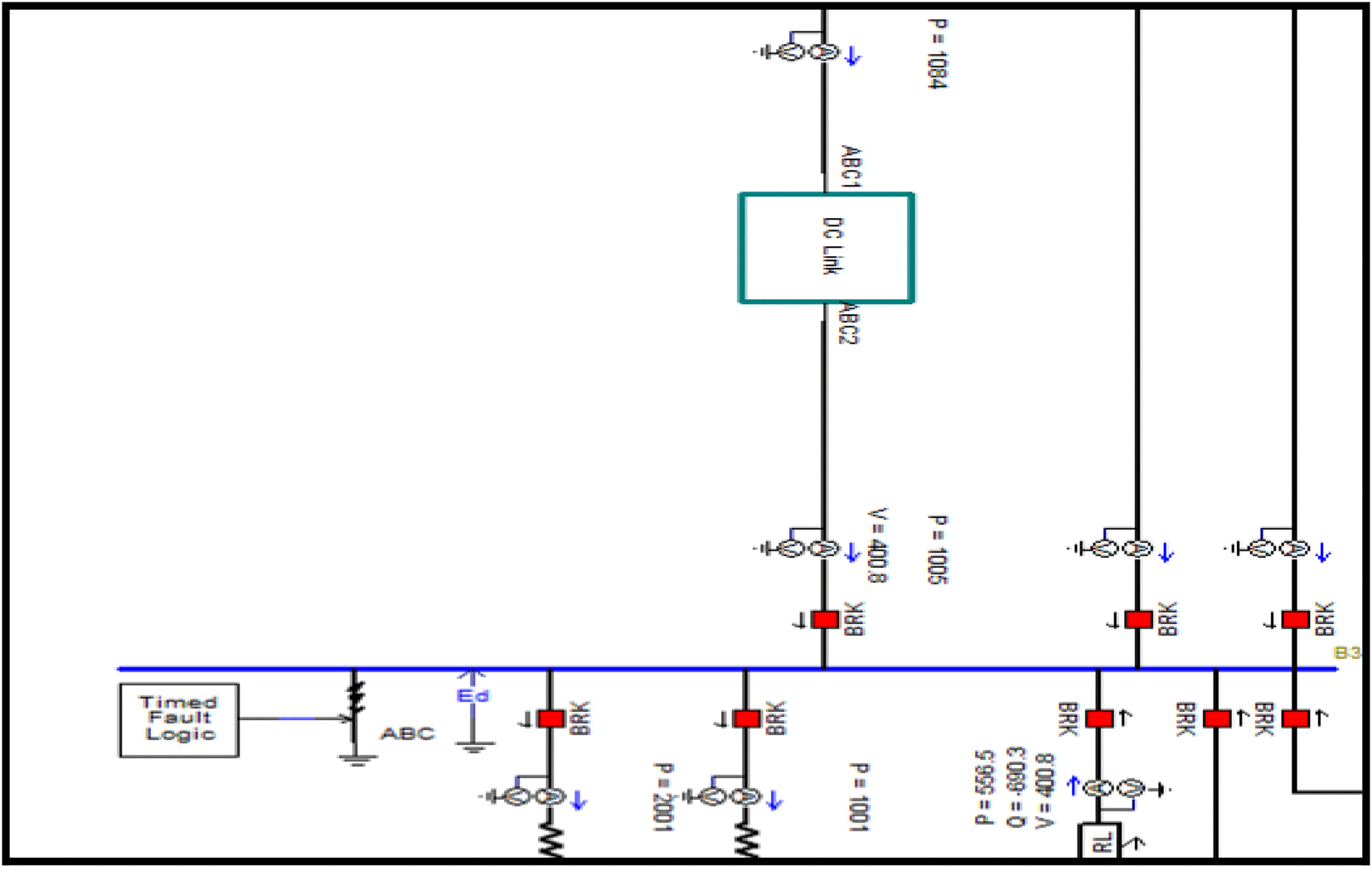

System simulations were carried out on the transient analysis software known as power systems computer-aided design (PSCAD) to analyse the system shown in Fig 1. A three-phase fault condition located on busbar 3 at the inverter end of the dc link was analysed for the two separate cases. Case 1 involves the CSC HVDC link and case 2 involves the VSC HVDC link (Fig 2).
Fig 2: Three-phase fault applied to busbar 3
In Fig 1, the 400 kV double circuit ac overhead lines (O1–O5) interconnect the four networks shown (A1–A4) to form the surrounding ac system. Each of the two nuclear reactors and associated ac switchyards are shown as N1 and N2. Nuclear Reactor 1 station (N1) is connected to the northern part of the ac system by a 400 kV double circuit ac overhead line. Nuclear Reactor number 2 station is connected in the southern part of the ac network by the HVDC link (H1). The data used for the power system components have been supplied internally by national grid electricity transmission. The dc link is represented as a ‘black box’ solution where greater detail of the inner model components is available. The loads and generators are reminiscent of those used on the NETS. Each of the reactor stations are kept separate to avoid a fault/outage on one affecting that of the other.
The parameters used for the ac system are shown in Table 1and the parameters for the HVDC link are shown in Table 2.

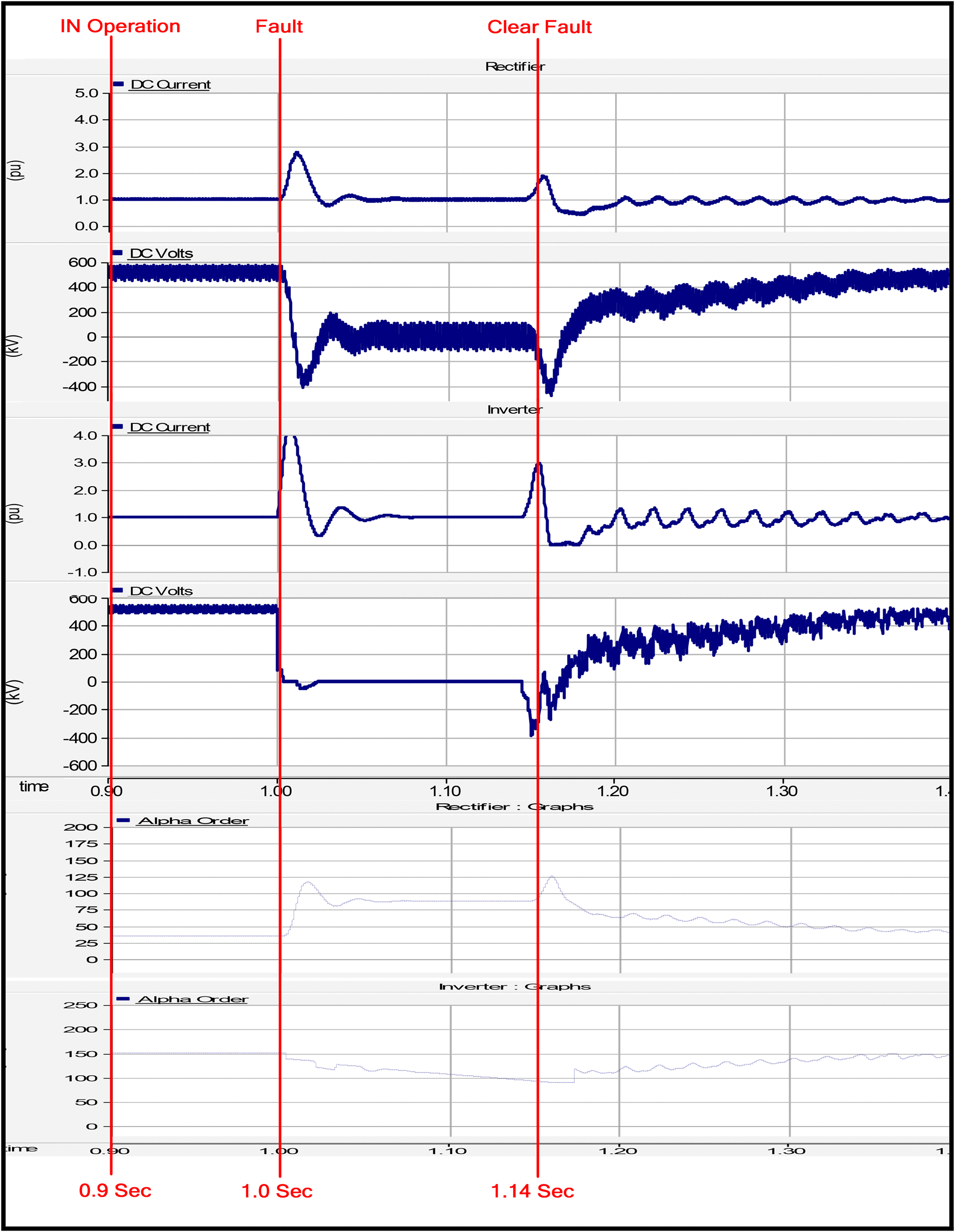

Case study 1 simulation results
In Fig 3, the dc voltage at both the rectifier and the inverter has collapsed due to the commutation failure at the inverter. Owing to the sudden reduction in dc voltage, the current shoots up to 3.0 and 4.0 per unit at both the rectifier and the inverter. The rectifier current controller attempts to reduce the dc current by increasing the firing angle as shown. The rectifier enters into the inverter region approximately 10 ms into the fault. Here the angle order of the rectifier advances to 110° (minimum limit) by the commutation prevention function, increasing the commutation margin and eliminating consecutive failure during recovery. The firing angle at the inverter is reduced according to the voltage-dependant current order limiter (VDCOL) function to help increase system recovery [9].
Fig 3: Dc system profiles for three-phase fault applied to busbar 3

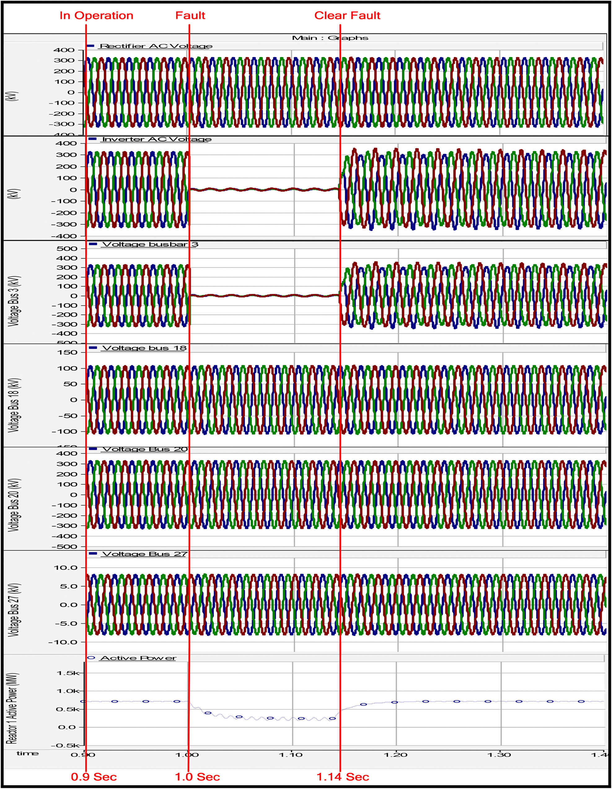

In Fig 4, after successful fault clearance there are current spikes at both the rectifier and the inverter once the ac voltage at the inverter has recovered. Owing to the commutation failure, as soon as the fault is cleared, the dc-link voltage reduces momentarily during recovery, causing an abrupt decrease in current order. This triggers an abrupt firing angle advance at the rectifier, which in turn causes a dip in both inverter and rectifier currents until normal order is resumed. During the system recovery harmonic and oscillations are present in both the rectifier and inverter dc voltages, respectively. During system recovery harmonics and oscillations are present in the dc voltage profiles of the rectifier and the inverter caused by the commutation failure and weak ac system connection. The voltage profiles on busbars 18, 20 and 27 have been unaffected by the fault due to the firewall function provided by the HVDC link. Owing to the large voltage depression at the inverter and temporary removal of the load, the reactor output power has experienced a slight decrease in output power during the fault. Once the fault has been cleared the reactor returns to nominal approximately 50 ms after fault clearance. The severity of the commutation failure has resulted in a longer recovery time of the reactor output power returning to nominal value. The commutation prevention function available within the dc control system can help aid recovery after the fault unless the voltage depression is high when the connecting ac system at the inverter is too weak. If commutation failure persists, this will result in the removal of the dc link from service by the protection and control system. The NPP will have to survive this contingency and depending on the running arrangements of the system at the time, some additional control actions may be required from the dc link to ensure the integrity of both the NPP and the surrounding ac system is maintained.
Fig 4: Ac system profiles for three-phase fault applied to busbar 3
