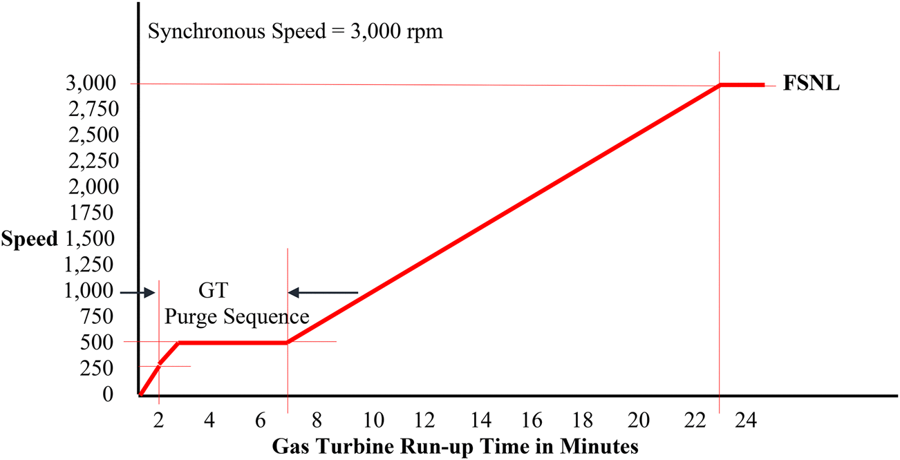

Large output gas turbine generator (GTG) start-up
To demonstrate the start-up superiority of large output industrial GTG units, depending on design, a typical start-up time sketch is shown, for circa 150–250 MW (Megawatt) units. The sketch indicates turbine/generator shaft rotational acceleration rates and the time taken to get to full speed no load (FSNL) prior to ‘auto’ synchronising with the local grid network.
Note: All GT generating unit operation is now almost completely computer controlled. GT run-up to FSNL and synchronising is computer controlled, as is online load changing and plant shut-down (Fig 1).
Fig 1: GT Run-up time to full speed no-load (synchronous speed)
Typical large output GTG start-up time to FSNL (large output GT generator unit FSNL)
Depending on design, an equivalent sized multi-cylinder steam turbine (ST) generating unit in the ‘cold’ or ‘warm’ rotor metal temperature condition (discussed in Part 3) would be started and reach synchronous speed in readiness for synchronising between one-and-a-half and two-and-a-half hours.
GTG loading rates are also higher than that of STs; however, a significant constraint becomes apparent in combined cycle GT (CCGT) power plants – that of allowable steam pressure raising rates and high-pressure (HP) turbine, and if reheat is used, intermediate pressure (IP) turbine, rotor metal temperature. Thus, during CC start-up – the first GT generating unit is the heat source to its associated heat recovery steam generator (HRSG) – thus controlling allowable steam pressure raising rates together with steam temperatures for ST start-up and loading.

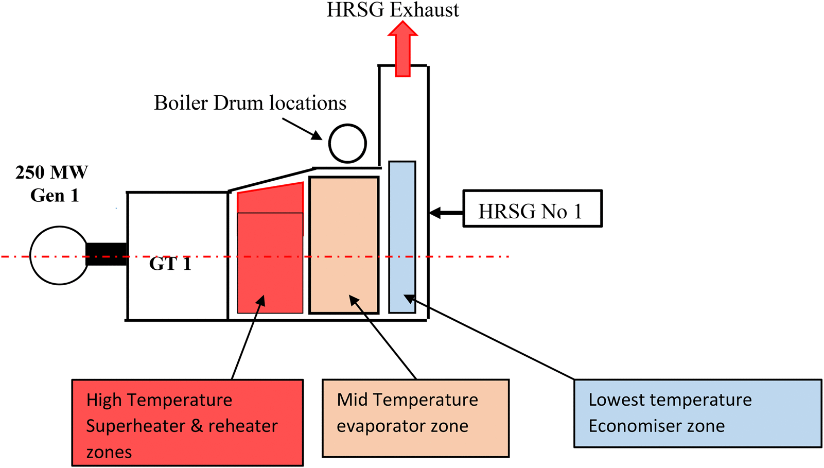

From the commencement of GT ignition and start-up, the engine exhaust gasses are ducted directly in to the machine’s HRSG – thus pressure raising, in keeping within allowable steam drum pressure raising rates, together with steam temperature control to match ST metal temperatures, means GT loading rates are initially constrained to allow CC ST start-up and loading.
GT ‘hot gas path’
Exotic, high cost, difficult to machine and process material makes up the GT ‘gas path’ components. These components rotating at high rotational (synchronous) speeds, or in gearbox applications, at even higher speeds – have a finite lifespan before metal fatigue and expensive component replacement or extremely expensive failure in service occurs (Fig 2).
Fig 2: CCGT ‘Watch and maintain’ areas
Diagrammatic and notional CCGT ‘watch and maintain’ areas
Failure of a metal component in service means debris (some very large and some very small) is swept by the compressor air plus combustion gases mass flow throughout the machine, thus severely damaging and in some cases completely destroying, downstream blading, vanes, seals and other segments of the overall machine. In fact, in service failure and ‘foreign object’ ingress – of whatever type or for whatever reason/s – into the axial-flow compressor and/or the GT units, let them be in open or CC configuration, has always remained the No. 1 Scourge, curse, enemy and topic of great concern for all GT power generator operators.

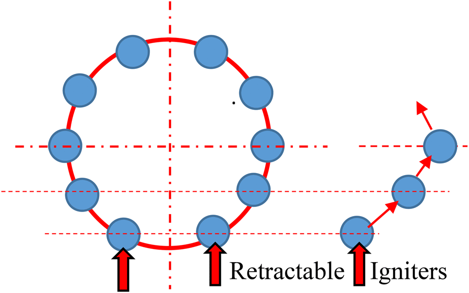

Sketch – uneven flame spread
Starting can also be most damaging and contributes to the reduction in shelf life of GT gas path blades and components (Fig 3).
Fig 3: Sketch – GT uneven flame spread
Indicative sketch of combustion chambers arranged around GT inlet.
Flame tubes connect combustion chambers, thus allowing and assisting the flame to almost instantly spread upwards to all combustion chambers on ignition and machine start-up.
On GT start-up, retractable electric powered spark igniters – are interlocked to be inserted after the GT purge sequence has been completed, and before fuel admission. With igniters in service and heavily sparking, when atomised fuels/or gas fuels are admitted, ignition occurs immediately and the flame spreads upwards to each combustion chamber via flame tubes, thus achieving complete and almost simultaneous ignition in all combustors; thus, no large temperature differences and extreme thermal gradients are allowed to occur.
  • Note 1: should for any reasons, ignition not occur in any given combustion chamber/s – the flame spread temperature difference – would cause very large temperature differences and hugely varying thermal gradients across the turbine rotor discs and blade rows. As GT rotors commence to rotate, these components are subjected to high then low flame temperatures (thermal cycling) at an ever-increasing speed change rate. Thus, flame spread temperature difference – when detected – will cause machine shut-down.
  • Note 2: flame spread temperature difference protection is provided on all modern, large output GT units.
  • Note 3: When flame spread temperature difference protection operation occurs and GT shut-down is initiated, it is classed as a GT failed start, and thus contributes to the equivalent running hours count.

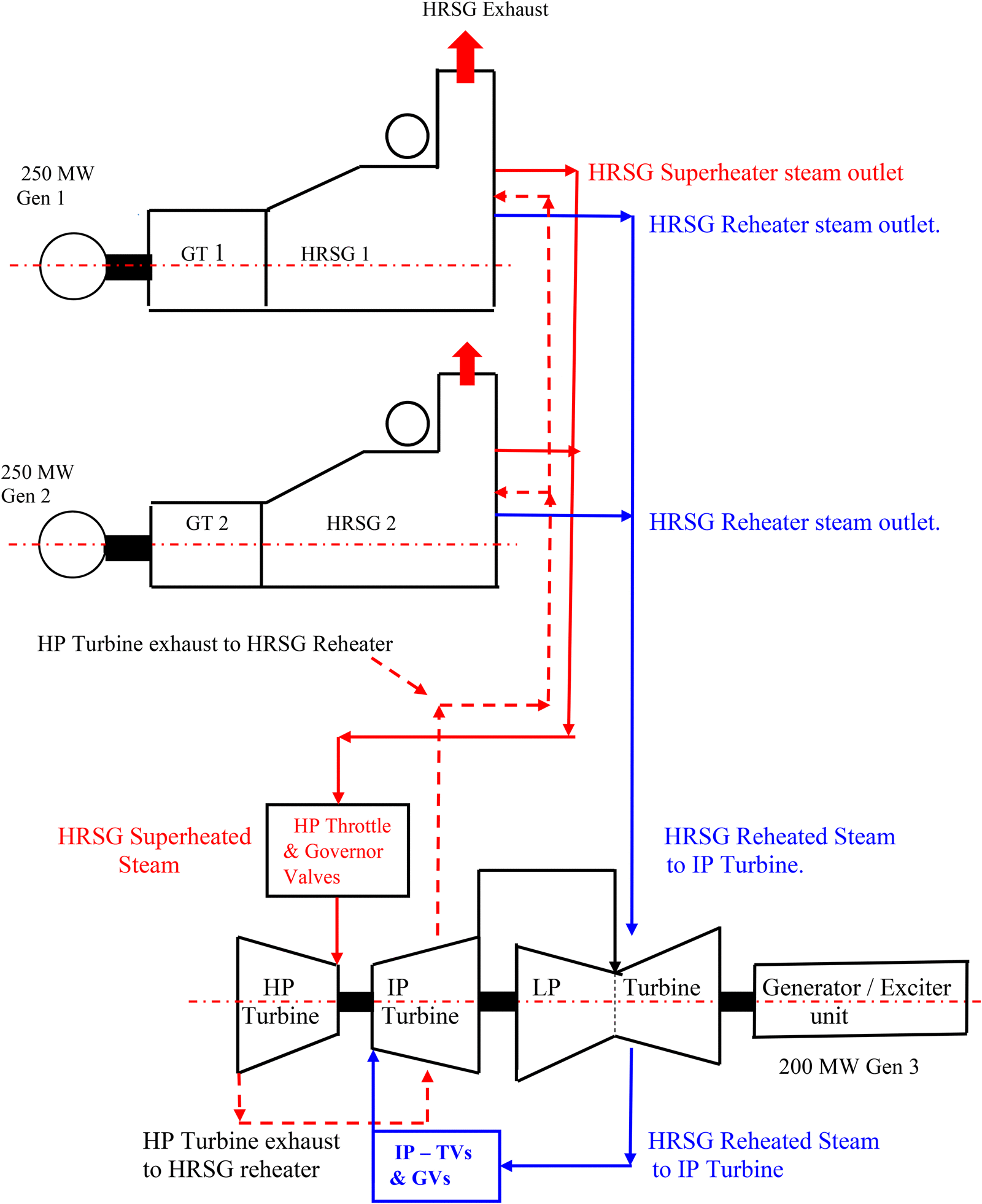

To present the complexities of operations and maintenance of CCGT plants, a diagrammatic example of a large output (700 MW) reheat, STG CCGT plant is shown.
Whilst the key asset management thinking required for GTs operation has been presented, GT units are nevertheless rotating machines – and as such, require extra short-term operational tactical thinking and longer-term trend and strategic ‘condition monitoring’ maintenance thinking. Other operational and maintenance (O&M) methods such as reliability-based maintenance thinking can also be profitably applied just as in all large rotating machine maintenance management regimes. GTG units together with STG units and BOP OEM specific recommendations must be studied and included in all on-going O&M philosophy, practises and procedures.
Plants are run year round, in all weathers and thermal conditions in accordance with the OEM, power purchase agreement (PPA), insurance, national standards and other industrial legal requirements; furthermore, CCGT plants are operated in ‘hot’ ‘warm’ and ‘cold’ thermal conditions.
Note: large output ‘reheat’ steam cycle CCGT plants usually generate three steam systems – and hence three low pressure (LP), IP and HP boiler drums and steam systems plus the reheat system are incorporated into the ST design.
Starting, operating and shutting down CCGT plants are computerised; thus, the entire CCGT unit plant, all unit BOP Plus the CCGT unit electrical supplies and high-voltage station electrical switchyard – must be – pre – checked and put into service – or – be in a ‘Click-to-go’ … ‘Ready to Start’ press ‘Enter’ to start/stop condition at a control-room computer workstation.
In the commercial times that prevail, all maintenance planning includes permit-to-work preparation times, parts delivery and scheduling, scaffolding scheduling, contractor and manpower scheduling and work scheduling, down to the last nut and bolt levels are commonplaces for all GT/generator/exciter/BOP maintenance outages (Fig 4).
Fig 4: Basic configuration – 700 MW CCGT reheat plant
Basic schematic configuration – 700 MW CCGT reheat installation
Hot, warm and cold plant start-up conditions are specified by the OEMs. The PPA agreement with the grid authority usually includes identical or very similar recommendations. Generally, international best practise summarises and defines these conditions as follows:
  • (a) ‘Hot’ start: is defined as CCGT unit that has been off-load for up to 8 h.
  • (b) ‘Warm’ start: is defined as a CCGT unit that has been off-load for 8–48 h.
  • (c) ‘Cold’ start: is defined as a CCGT unit that has been off-load for more than 48 h.

combustion
initial combustion is dependent on spark igniters being brought into service after the GT start-up purge sequence and before fuel is admitted
listen and look! – when starting up GTs – dull explosion or ‘Puff’ of smoke from exhaust stack – means too much fuel not being ignited sufficiently and early enough – dangerous explosive situation in GT turbine and/or exhaust area
combustion
fail to start – and/or several failed starts
very dangerous – leaving accumulated fuel inside the turbine. Gas accumulations and/or pools of liquid fuels can accumulate inside the GT after several failed starts – finally, getting a start could potentially result in re-ignition of unburnt fuel – explosion – in turbine or turbine exhaust area  note – GT purging removes oil vapour or gas concentrations, however, accumulations of liquid fuel can potentially still remain and would potentially vaporise when GT ignition was ultimately achieved resulting in explosion. GT purging systems are now installed and used before all GT starts. If there is a sequence of failed starts – apart from exhaustive fuel ignition systems checking – inspect turbine exhaust area – before – re-initiating turbine start sequence
combustion
flame spread temperature difference, depending on design, usually set at 69°C
flame must very quickly spread to all combustion chambers – otherwise, there will be a discrepancy between temperatures emanating from each combustion chamber and presented to the GT blades, thus giving a large and uneven spread of flame path temperatures. Results in damaging thermal shock and thermal cycling of turbine blades as machine increases in speed leading to quicker turbine blade deterioration and failure  oil firing – oil nozzles can conceivably get choked or carboned up – leading to a restriction of fuel to some burners – turbine blades encounter hot flame zones and cooler flame zones – in rapid succession as rotors accelerate to synchronous speed and run at synchronous speeds  this leads to blade thermal cycling and ultimate quicker blade deterioration and failure

GT section 4: HRSG gas passes
Essential basics: HRSGs are heat exchangers which are horizontally laid out directly behind the GT exhaust outlets (see sketch below) and are exposed to the considerable GT exhaust gas mass flow and gas temperatures (Fig 5).
Fig 5: HRSG gas passes illustration
Superheater, reheater and any process intermediate and/or LP superheaters are thus arranged to be nearest to the GT high-temperature exhaust zone; natural circulation and/or forced circulation evaporator tube banks follow after the superheater zone and the economiser tube banks are located in the latter sections of the overall HRSG collecting as much heat as possible from the exiting GT exhaust gasses prior to stack discharge to atmosphere (Table 8).
