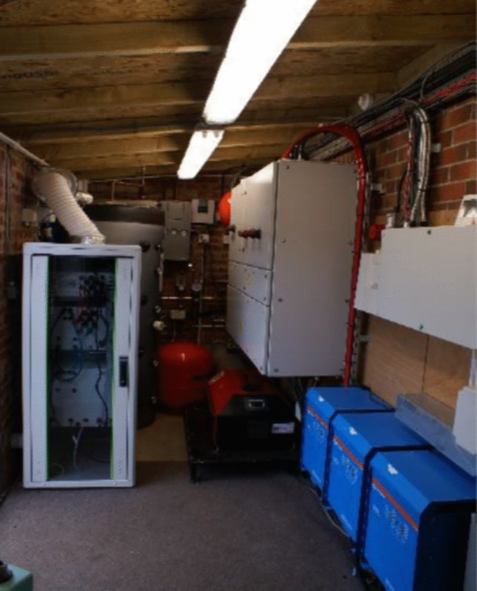

The test site uses an Acta Spa electrolyser on the trial site in Cheshire; the electrolyser is producing hydrogen which in turn powers a Giacomini catalytic burner providing heat and domestic hot water (Fig 2).
Fig 2: Acta Spa electrolyser

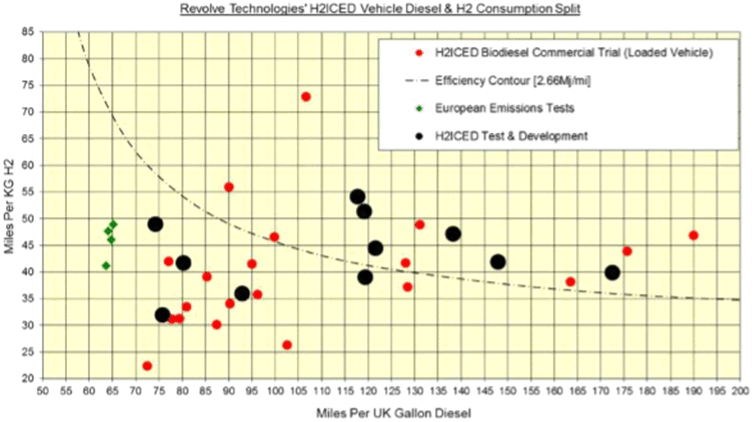

The test site has been further developed and now able to further use this co-generational system to store greater amounts of hydrogen which enables them to use the hydrogen in a hybrid diesel vehicle. In Fig 3, Revolve Technologies (R&D partner for ULEMCo Ltd) have illustrated the performance of hydrogen vehicles.
Fig 3: Performance of hydrogen vehicles
Using this information Clean Power Solutions Ltd (CPSL) have created a design that ULEMCo Ltd in Liverpool are collaborating on to provide a whole system energy approach to hydrogen vehicles. The project entails creating a techno-commercial model for assessing the value of balancing the storage of onsite renewably generated hydrogen, located within the curtilage of a commercial building, with integrated storage and then used as fuel for light commercial vehicles (Fig 4).
Fig 4: Techno-commercial model for assessing the value of balancing the storage of onsite renewably generated hydrogen
NB: Revolve have recently advised, based on averages and for illustration purposes only, that the easiest estimate to convert H 2 into a diesel equivalent, would be 1 kg of H2=4 L diesel. So, however far you can travel on 4 L of diesel is how far you will travel on a kg of H2 [2]. This is with a diesel/hydrogen hybrid vehicle, a pure hydrogen fuel cell vehicle will exceed this.

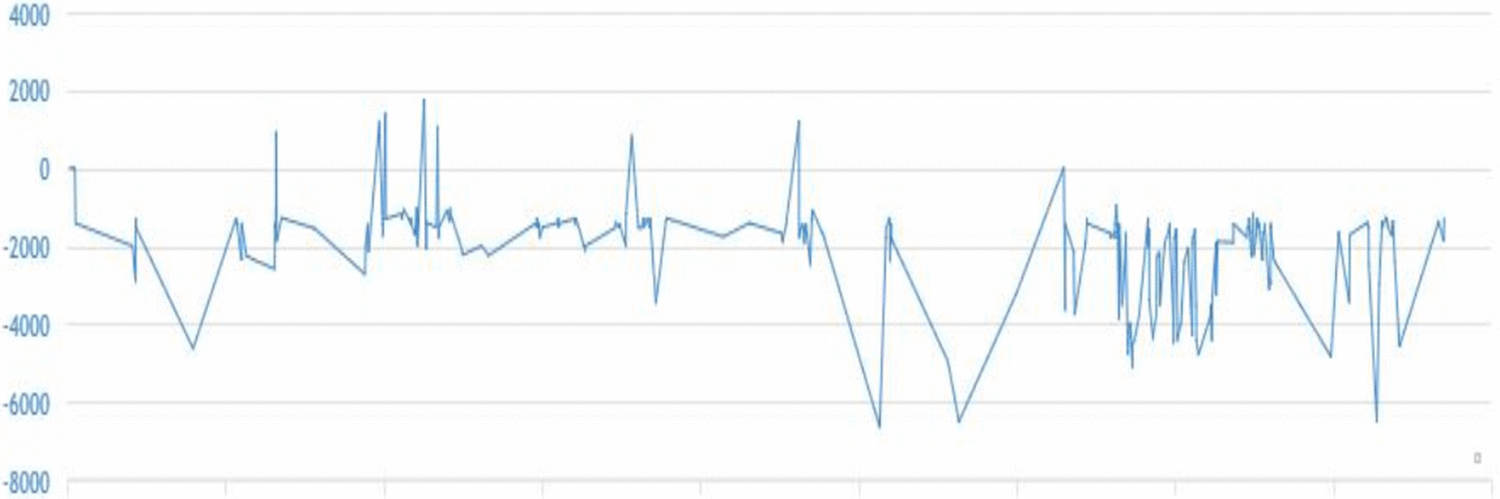

Production is measured by the energy management system (EMMA) along with the demand from the batteries at any time by the two current transducers located in the circuit. The site electricity demand is met from the renewables and supported by batteries via a synthetic grid. The voltage transducer records the battery condition and signals EMMA. When the batteries reach a 90% charge, export at 16 A begins via a G83/2 certificated inverter and remains until the batteries drop to 80%.
If the batteries drop below 20% (in times of low wind or lack of sunlight for more than a day), power is drawn from the grid to recharge the batteries back to 50% capacity.
When the batteries are at 90% and exporting, power is sent, via SSR’s in 5 kW bytes to the electrolyser. The electrolyser produces, from rainwater using 5 kW of generated power, 2.1 kg of hydrogen per day, this is stored in the hydrogen tank at 30 bar pressure for use in a Giacomini hydrogen catalytic burner when required (Fig 5). The data in Fig 5 are from test site showing current profile.
Fig 5: Data from test site showing current profile
