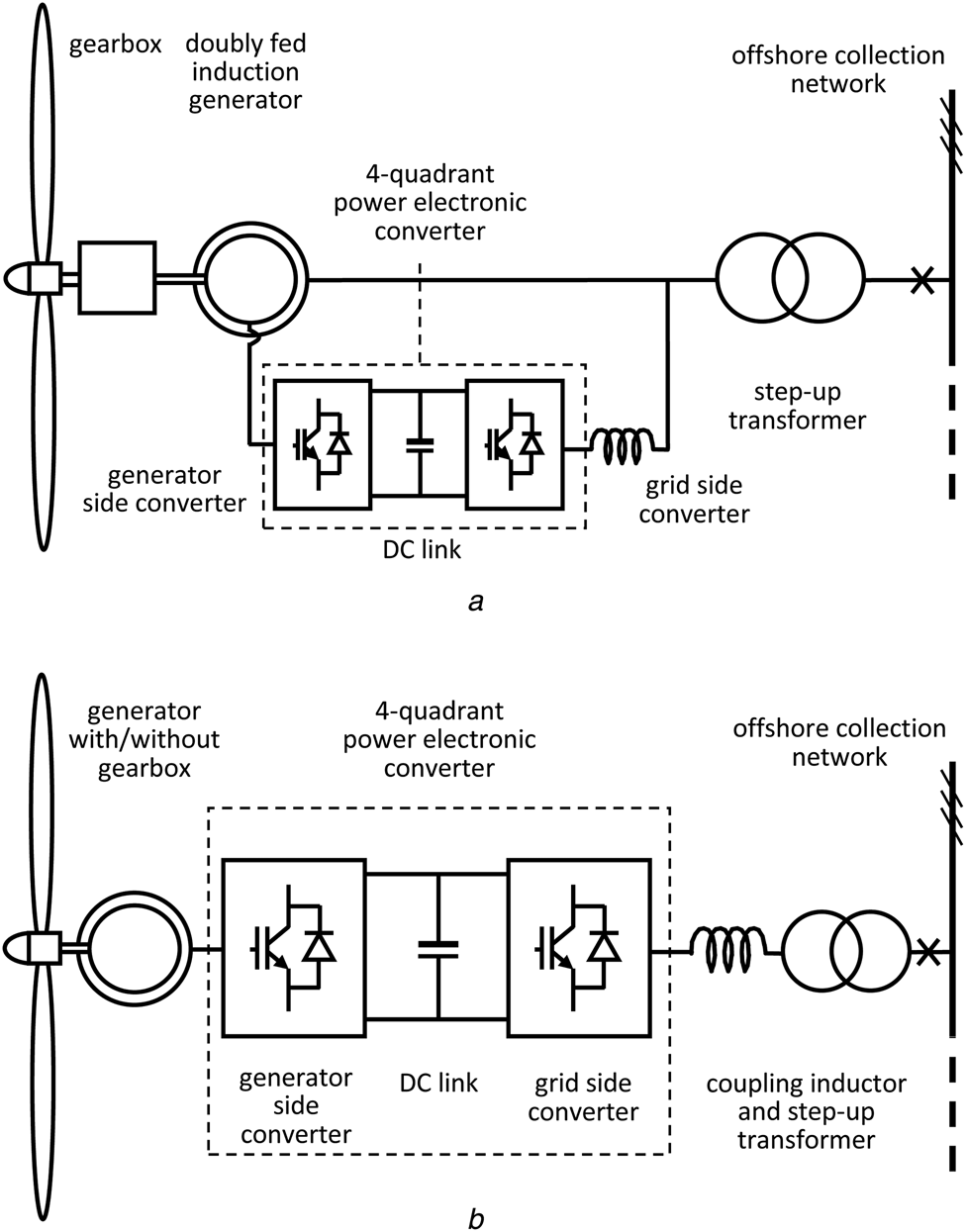

Offshore wind turbines were initially rated at 2–3 MW; currently this has gone up to 5–8 MW and is expected to reach 15–20 MW in the future. They are of variable speed drive trains to manage the stresses on the mechanical components. Except for the concept of using a variable ratio hydraulic gearbox and synchronous generator directly connected to the AC grid, all wind turbines include a power-electronic stage to control the power flow and manipulate the rotor speed [6]. From an electrical system point of view, there are two main configurations as shown in Fig 1:
  • the doubly-fed induction generator (DFIG) with a partially rated converter between the machine rotor and grid;
  • the arrangement with a fully rated converter connected direct-in-line (DIL) with the stator windings of an induction or permanent magnet generator and the grid (this latter type comprises several modular designs [7]).
Onshore statistics indicate that, on average, the power-electronic converters contribute to about 13% of the wind turbine failure rate and about 18% of the downtime [8 – 11], which makes them the second most susceptible subassembly after the blade pitch mechanism. At the same time, the average availability of onshore turbines is typically above 95%. For an offshore deployment, however, the same failure rate (even if the failures are trivial) can amplify the downtime impact because of the difficulty of access. This impact will be even more pronounced during windier spells which can otherwise be prime time for generation.
Fig 1: Two converter arrangements for wind turbine
a DFIG
b Generator with DIL converter

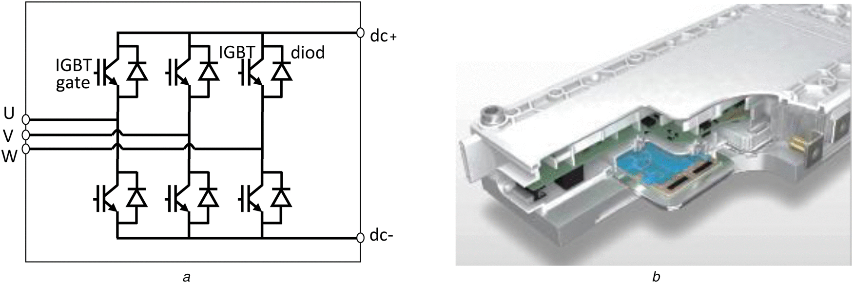

Regardless of the turbine type, the basic circuit configuration of the converter is similar. Two voltage-source converters (VSCs) share a DC-link, allowing four-quadrant real and reactive power flow viewed from the AC sides of the generator and the grid. Fig 2 a shows a VSC diagram, which is typically of three-phase and consists of six insulated gate bipolar transistor (IGBT) arms, each with a diode in antiparallel. They are packaged in the form of a power semiconductor device module which can be rated up to hundreds of kilowatts. Fig 2 b is the image of such a power module complete with its packaging. To form a four-quadrant commercial converter module, two of these are used in a back-to-back (BTB) topology with added DC-link capacitors, instrumentation circuitry, control/protection schemes and forced air/water cooling arrangements. The fully rated converter in a wind turbine (in the multi-MW range) can be constructed by paralleling several converter modules [12].
Fig 2: VSC circuit configuration and a power device module (Source: Semikron)
a Circuit diagram of a VSC module
b Picture of a power module for VSC
In the BTB topology, although the grid-side VSC operates at the grid frequency, the frequency of the machine-side converter depends on the generator design and the speed. For reasons to be explained later, the frequency will affect the device module thermal cycling, a dominant root cause of failure. Previously, the converters were often based on drive designs, but nowadays the special requirements of wind turbine operation are increasingly recognised.

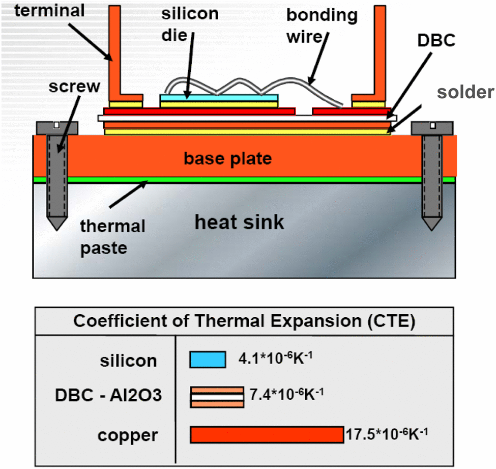

Fig 3 shows a cross-sectional view of the power device module similar to what is widely used in the current generation of power-electronic converters for wind turbines. The structure is made of materials with different coefficients of thermal expansion (CTE). The mismatch between CTEs gives rise to the fatigue stresses during thermal cycling. In this process, cracks and voids can develop across the interfaces between layers of the vertical structure, increasing the thermal resistance along the path of heat dissipation. As a result, the semiconductor junctions will operate at increasingly higher temperatures leading to destruction.
Fig 3: Power device module structure (Source: Semikron)
This mechanism is considered [14] a root cause of both bond wire lift-off, which reduces the electrical conductivity, and solder pad degradation, which reduces the thermal conductivity. To avoid/reduce the use of bond wires and solder, press-pack architecture has been developed for the semiconductor devices. It is believed that the press-pack structure could slow down the degradation process by at least an order of magnitude. Fault tolerance through on-line redundancy can also be easily achieved using press-packs since they fail short circuited. This has been suggested as the best way currently available for dramatically improving offshore wind converter reliability [15] and is now being introduced to wind turbines in spite of the higher cost.
It must be pointed out, however, that although more reliable, the press-pack devices can still degrade: during the formation of their conducting alloy and at later operation stages, molten aluminium attacking molybdenum (Mo) can form cracks in the base plate, reducing its thermal conductivity; given time, the electrical conductivity can also deteriorate owing to the generation of intermetallics.
Another peculiarity of press-pack devices is that the metal plates compressing the semiconductor chips conduct both electricity and heat out of the device. They are a live component that cannot be connected to traditional heat sinks. Press-pack systems are therefore cooled by direct flow of non-conductive liquid, such as de-ionised water. Such converters have a monitoring unit that samples the cooling water flow and shuts down if the water dissolved particulates or the ion content reaches certain level when the water can potentially become conductive. Although this is not a failure as such, it necessitates human involvement to change the liquid, and in offshore environments this may be an extra source of downtime (depending on how often it happens).

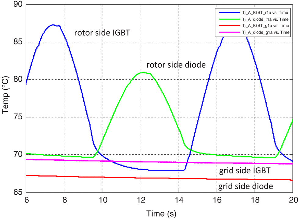

In the context of existing wind turbine technology, it was mentioned that there is evidence of the machine rotor-side VSC failing more quickly than the grid-side VSC in DFIG systems, although the two converters process roughly with the same real power. This is because, close to the synchronous speed, the machine-side converter operates at very low frequency. However, the rotor current will not be zero because it is necessary to maintain magnetomotive force balance with the stator current, even though the real power processed by the converters is about zero. As a consequence, the thermal capacitance of the power module will have little attenuation effect on the slow variation of the junction temperatures which will then cause deep thermal cycling. Fig 4 shows the simulated junction temperature curves for the machine and grid-side converters near synchronous speed. The junction temperatures of the machine-side IGBT and diode excurse by 10–20°C, whereas those on the grid side the changes are hardly visible. A solution recently proposed is to de-rate the whole turbine system near the synchronous speed, with a reduction of generation efficiency [16].
Fig 4: Simulated temperature variations in VSCs in a DFIG system
The speed of a DFIG machine typically varies ±30% around the synchronous speed. At the maximum speed, the stator real power isP sn , and the rotor real power is P rn = 0.3 P sn. The total real power is P DFIG = 1.3 P sn. As the speed reduces, the turbine power would reduce in a cubic relationship. At the synchronous speed, the total real power is then
This will be purely from the stator side as the rotor power at zero slip is about zero. Therefore, the stator real power and hence stator current will still be as high as 60% of the maximum value assuming a unity power factor. The rotor current will remain correspondingly high. The fact that the rotor real power is zero is due to the rotor voltage (fundamental component) being zero. If the reactive power is to be increased because the wind turbine is not fully loaded, the rotor current provided from the machine-side converter will also increase, thereby increasing losses and the junction temperature variation – a parameter directly related to the power device degradation.

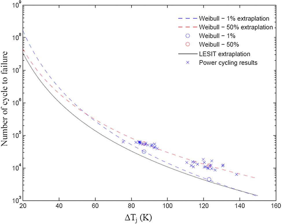

Several lifetime models have been proposed to characterise the ageing process. To account for the effect of thermal cycling, the Coffin–Manson law [17] states that the number of cycles to failure, N f, reduces as the range of junction temperature variation, Δ T j, increases
where n is a model parameter. N f also depends on the mean temperature in a complex way. Some self-healing effect may be observed at high temperatures.
For a given mean temperature, a simplified lifetime model of a power device module may be similar to Fig 5, assuming uniform cycling. For a complicated profile of thermal cycling in practice, the total relative damage is usually calculated in a manner of linear accumulation
where R i is the fractional damage produced in N i cycles at stress level i, and N f i represents the number of cycles to failure at that stress level that is, as shown in Fig 5. Full damage is reached when D = 1. It has been pointed out, however, that purely linear methods may not be able to represent the complicated damage accumulation process in the solder pads [18].
Fig 5: Lifetime model [17]

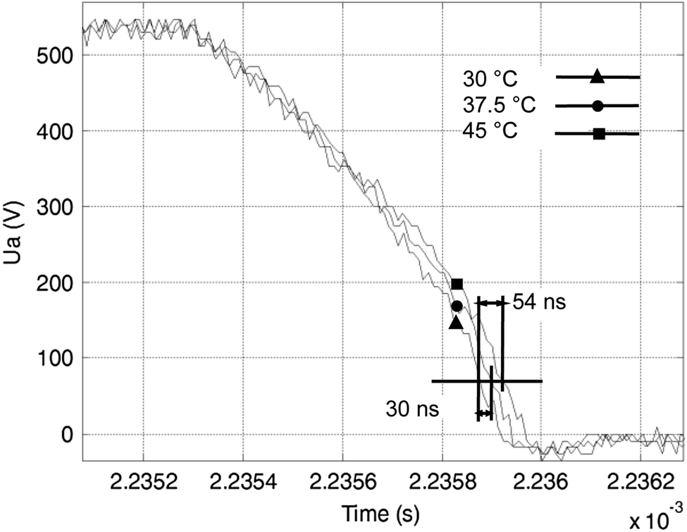

Changes in the electrical characteristics, for example, switching edges and on-state voltage, are also noticeable with the increase of degradation. Some of these changes, such as on-state voltage, are related to the physical properties of the materials and the interfaces between them. Other signatures, such as the prolonged switching-off edges and increased power losses, are the consequence of elevated junction temperature after the internal thermal resistance has increased owing to ageing. These signatures are generally very sensitive to the operating point of the converter.
To detect the relatively weak signatures, techniques at the device level have been proposed [22–25], but it is still difficult to integrate sensors within the power devices which operate at fast switching frequencies and in a very noisy environment. Converter-level techniques are also being pursued with the incentive of cost saving through the use of the same sensors as for protection, control and normal metering [26–28]. Fig 6 shows the switching-off transient of an IGBT at different case temperatures; the junction temperature is differentiated by a similar amount as between the different case temperatures. In practice, degradation of the heat conduction property in the module can easily cause the junction temperature to change to such an extent. From Fig 6, a difference of 15°C causes the switching edge to slow down by about 50 ns for recombination. This is short compared to the total turn off time, about 1 µs. But depending on the switching frequency and DC-link voltage, this can cause a detectable discrepancy in the AC output voltage of the converter whose effect can be captured in the controller signals [28]. The effects of degradation in other drive train components of the wind turbine, such as generator or gearbox, may also propagate into the control system. This is subject to further investigation.
Fig 6: Dependence of switching edge on temperature [28]

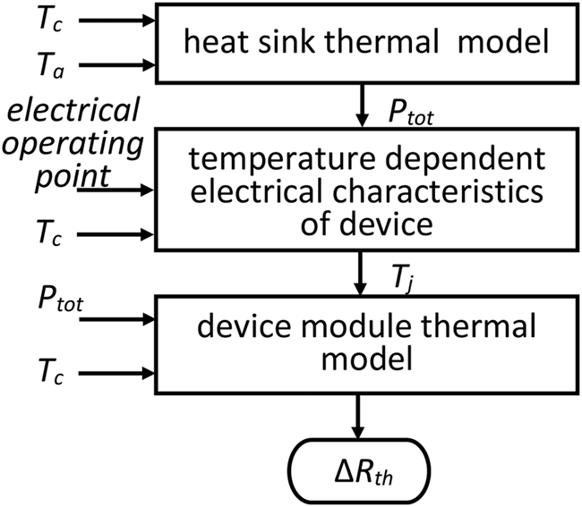

In addition to electrical signals, temperature measurements can also be used to extract important indications of the device condition during operation. Internal temperature is sensed in modern power device modules but direct measurement of the junction temperature is still impossible. The junction temperature affects the power losses inside the module. As a result, condition-dependent temperature signatures can be captured from the outside [26]. The complexity here is that temperature also changes with the operating point which for a wind turbine inherently varies, masking the signatures associated with degradation. Also, temperature measurements can sometimes be deceptive because they depend not only on the electrical operating point at the given moment but also on the history of operation (up to 10–15 min back from the given moment in time). For this reason, electro-thermal modelling is necessary to unmask the effect of the variable operating point. Fig 7 outlines an algorithm to extract the change in the thermal resistance inside the power device module as an indication of its degree of degradation. With such a temperature-based method, as long as the electrical operating point is closely tracked, it is believed that the degradation in other components of the drive train will not have significant effect on the condition monitoring results.
Fig 7: A model-based condition monitoring algorithm
The algorithm shown in Fig 7 works as follows: The temperature measurement external to the module, case temperature T c and ambient temperature T a, are applied to the heatsink thermal model to calculate the variation in power losses P tot over time. After the dynamic calculations have converged, P tot is used to determine the junction temperature T j that will cause this power loss (switching and conduction losses) at the given electrical operating point expressed in current, voltage, power factor and so on. The dependence of electrical characteristics of the devices on the temperature has to be known. The increment of the internal thermal resistance, Δ Rth with respect to the nominal value R th0, is then calculated as a condition monitoring signature. Fig 8 illustrates graphically the calculation result of Δ R th for a small module over a range of converter operating points (with different output current and case temperature), showing that it is indeed possible to extract the change of the internal thermal resistance.

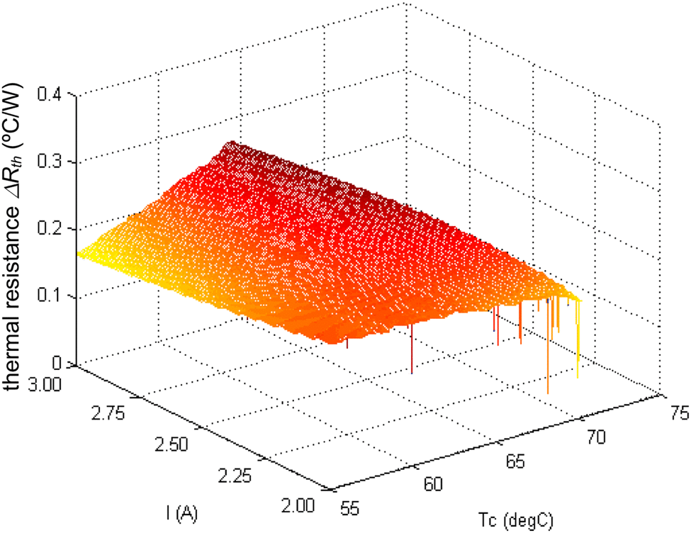

Fig 8: On-line detection of increase in internal thermal resistance [27]
The above description is perhaps simplified to the extreme in some aspects. For example, the thermal capacitance of the device module is ignored, and so is the geometric distribution of multiple power loss sources in the dimensionally larger power module in practice. But it is expected that combined electrical and thermal modelling can provide a platform for condition monitoring power-electronic converters.

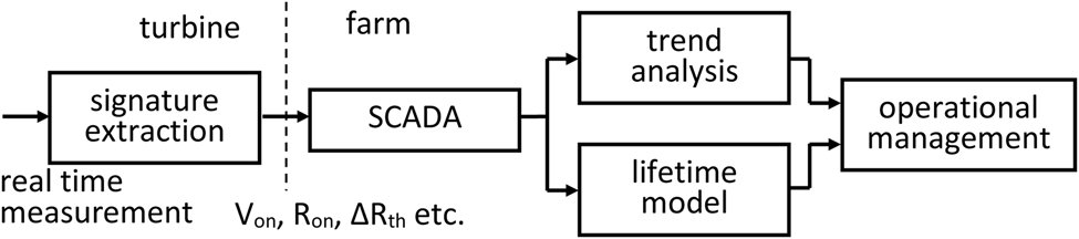

In terms of the application of condition monitoring in practice, it is fundamentally important to establish the relationship between the strength of the signatures captured and the level of degradation in the component. In other words, a prognostic approach will be extremely valuable. It will work like a calibration process that is used to predict the remaining time to failure, so that preventive maintenance can be scheduled.
Integration of the condition monitoring functionality into the SCADA system at the turbine or wind farm levels needs to be considered. Local information regarding individual turbine components will be valuable from a maintenance point of view. But such information may become overwhelming when all are collected at a wind farm or higher level. Therefore some local diagnosis and prognosis functionalities should be developed for individual turbines. On the other hand, given that it may be attractive to manage maintenance at the farm level, information about individual turbines could be centrally collected for analysis. For this reason, it is desirable to define some simple indices that measure the condition of the components. For power device modules, percent increase of the internal thermal resistance because of solder fatigue and increase of on-state voltage because of resistance can often be used for this purpose. One complexity here is that the future development of the degradation depends on the current condition of the component [29]. A model-based approach that derives the condition signatures and data-based approach that analyses the trend of change of such signatures could be combined to give an effective solution, as shown in Fig 9.
Fig 9: Configuration of condition monitoring system
