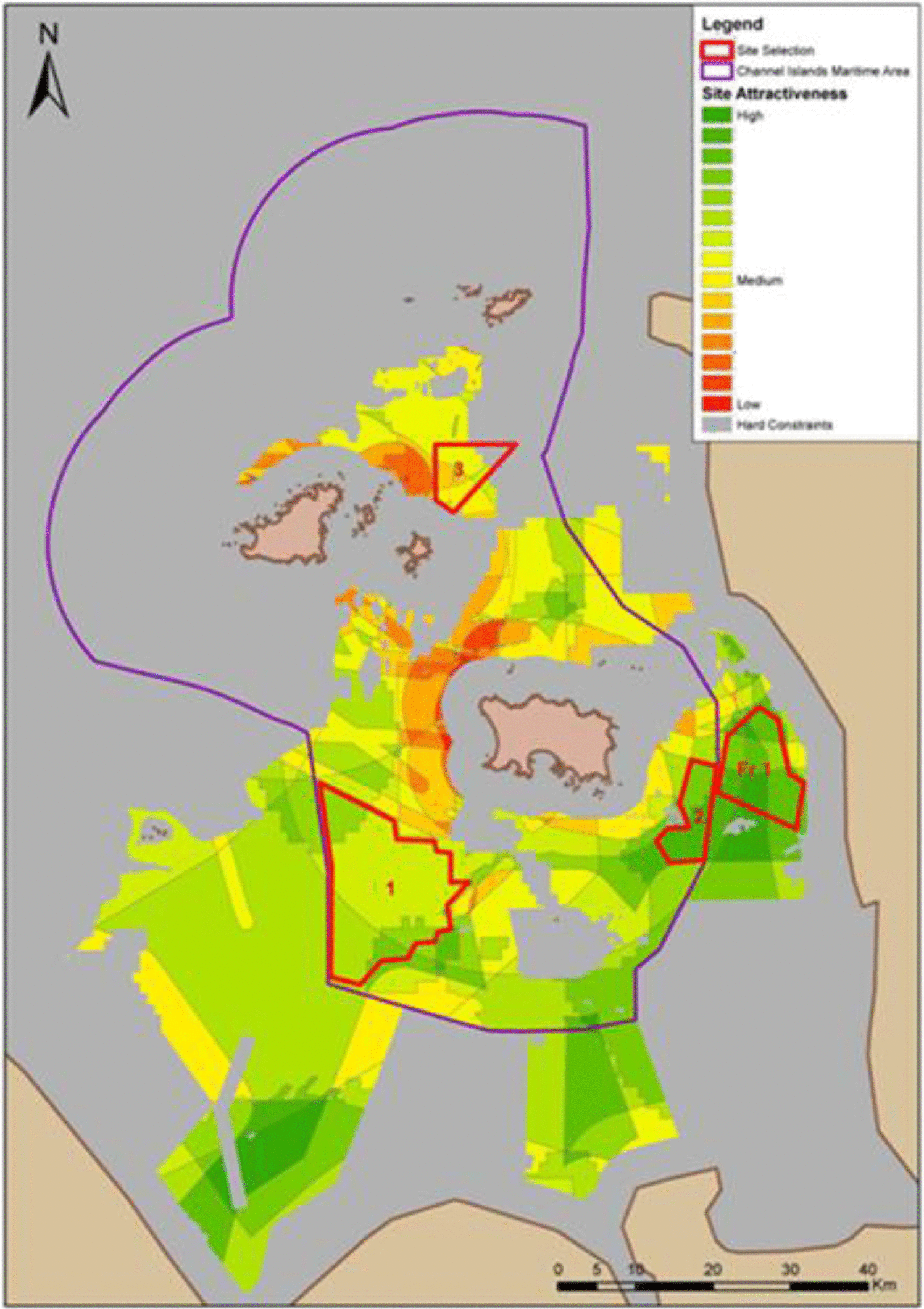

A site selection exercise was undertaken to identify appropriate sites for offshore wind development in the Channel Islands. Although clearly not onshore development the principles apply nevertheless. In this example SgurrEnergy identified all relevant constraints at the regional level and scored then in accordance with level of risk. A matrix approach was used to then rank each constraint and assign an overall score for each 1 km square on the map. The resulting data was presented in GIS format (see Fig 1) and allowed a number of preferred sites to be identified.

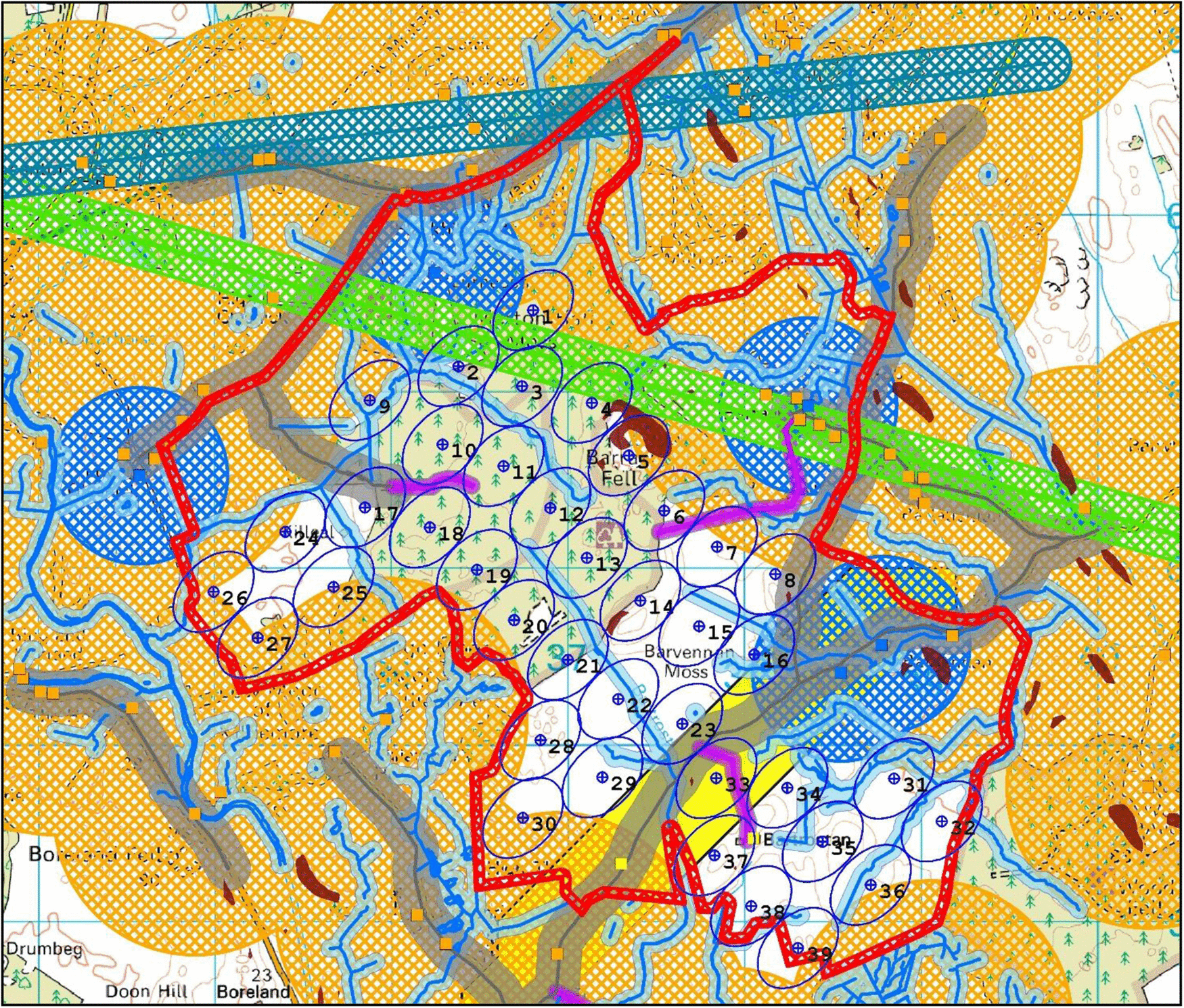

Following the initial site selection process it is common practise for developers to undertake further feasibility studies to determine whether the site is likely able to support an onshore wind development and whether it will be financially viable. An important step in this process is the development of a constraints map using GIS software. The constraints map will build up layers of appropriate data including roads and infrastructure, residential properties, protected sites, watercourses and cultural heritage sites. An appropriate buffer is applied to each feature to identify the amount of available land (Fig 2). The initial layout should then be developed on the basis of the available unconstrained land. Although often viewed as a separate exercise to the main EIA, it is important that the initial constraints mapping is viewed as part of the same process.

Fig 1: Example site selection exercise (Channel Islands)
Fig 2: Example constraints map

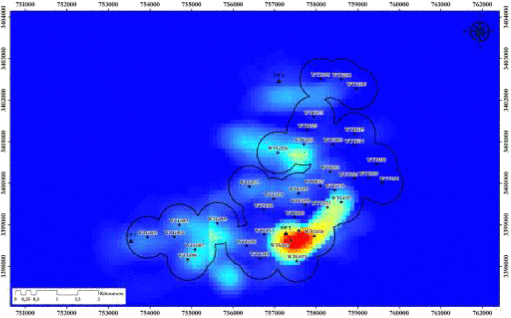

Assessment of cumulative effects
Cumulative impacts are an important issue to be considered for the project. Cumulative impacts are those effects that may result from the combination of past, present or future actions of existing or planned activities. While a single activity may itself result in an insignificant impact, it may, when combined with other impacts (significant or insignificant) in the same geographical area and occurring at the same time, result in a cumulative impact that is significant.
The assessment of the cumulative impact depends very much on the type of impact. For example, issues such as noise can be modelled by adding additional turbines into the project noise model using commercially available software packages whilst the cumulative visual impacts of multiple wind farm developments relies on professional judgement within an assessment framework. When considering cumulative impacts of other planned development in the area, the worst case scenario should be considered for all sites and generally only projects that have been built, consented or are subject of a valid planning application should be considered.
Case study

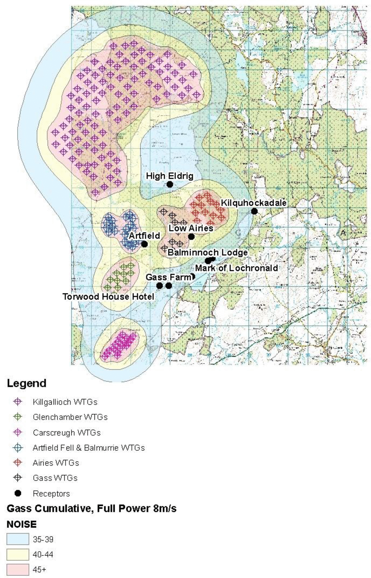

A cumulative noise impact assessment was carried out in support of the planning application for Gass Wind Farm, Dumfries and Galloway. The assessment found that the impacts of Gass Wind Farm on its own were within required noise limits, however, the proximity of a number of consented and operational wind farms resulted in noise levels in exceedance of allowable limits (see Fig. 3 ). In this example, the worst case scenario would have been 40.9 dB(A) at a wind speed of 6 ms −1at the nearest property. The allowable limit was 35 dB(A). A possible means of addressing this would be to reach a commercial agreement with neighbouring properties which would increase the allowable limit to 45 dB(A). This could be achieved by agreeing access to the site through neighbouring land. In this example, financial involvement was not agreed therefore the impacts were mitigated by reducing the development from 19 turbines to 9 turbines with additional mitigation required. This required turbines to be operated in a reduced noise mode at certain wind speeds. Following the implementation of this mitigation the project was accepted by the local authority and was granted planning permission in August 2015.
Case study

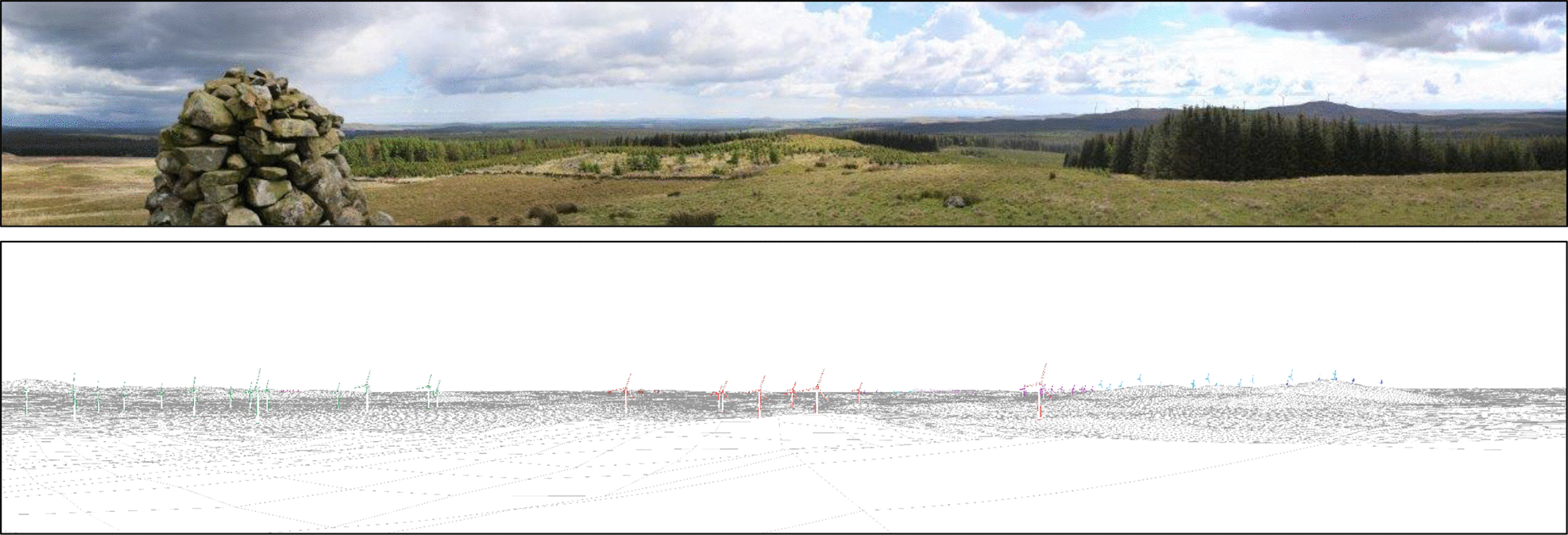

A cumulative Landscape and Visual Impact Assessment (LVIA) was carried out also at Gass Wind Farm, Dumfries and Galloway. As noted in Fig 2 there are a large number of wind farms in the general vicinity of Gass. The initial assessment highlighted that the original site layout appeared disjointed when viewed against neighbouring wind farms would did not accord with relevant guidance. In this example, the worst case scenario would have resulted in a high level of overlap and clustering between turbines when viewed at key viewpoints. To address this, a landscape design study was undertaken to redesign the wind farm as an extension to the neighbouring wind farm at Aires (Fig 4). With appropriate redesign the assessment found that the impact was not unacceptable and allowed the project to proceed with minimal number of local objections.

Fig 3: Example cumulative noise impact assessment (noise contour map of Gass Wind Farm, Dumfries and Galloway)
Fig 4: Existing view and example cumulative wireframe to aid assessment (Gass Wind Farm, Dumfries and Galloway)

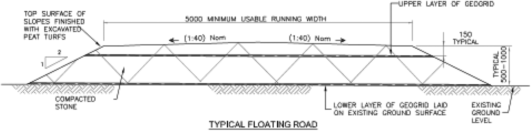

Fig 6: Typical floating track design
Fig 7: GIS-based heat map showing bird movements across a wind farm site
