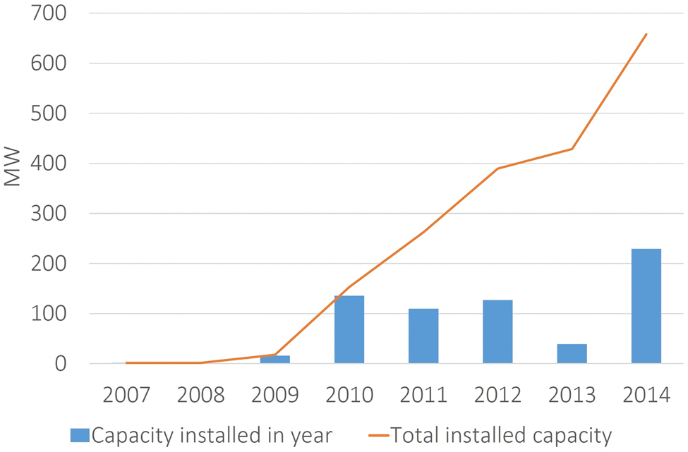

In 2014, China had the fourth highest installed capacity of offshore wind in the world, accounting for 7.5% of the global total [1]. Over two-thirds of this capacity is installed in the intertidal zone. The growth rate of the sector (Fig 1) is comparable with that of Europe as a whole during the early years of European growth after the year 2000. In 2011, China's National Energy Administration (NEA) published a target of 5 GW of offshore wind by 2015 and 30 GW by 2020. Despite a high growth rate, the 2015 target has been missed by a significant margin.
Fig 1: Offshore wind installed capacity in China [2, 3]

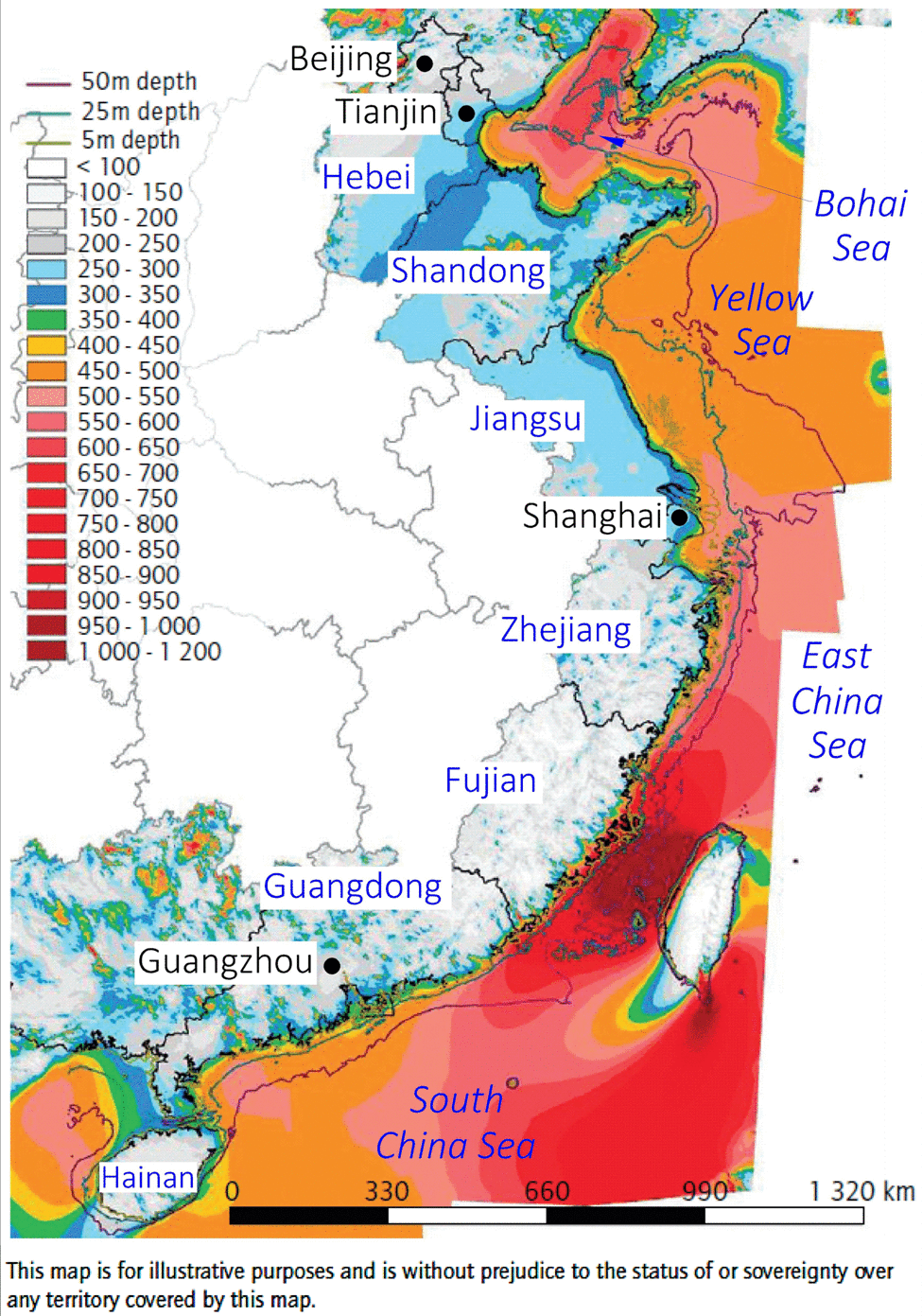

The offshore wind resource in China is greatest off the coast of the provinces of Fujian and Zhejiang, where it is comparable with that of offshore sites in northern Europe, with wind power densities from 550 to 1000 W/m 2 at 100 m height (Fig 2). This corresponds to mean wind speeds of ∼7.5–9.5 m/s.
Fig 2: Wind power density (watt per square metres) at 100 m height and water depth contours on the East China coast [4]
At the centre of the Bohai Sea, the wind power density varies from 450 to 650 W/m 2 at 100 m height. The Bohai Sea has a mean depth of around 20 m, and a maximum depth of 70 m.
The coast of the Jiangsu and Shandong provinces that faces out toward the Yellow Sea has wind power densities from 350 to 500 W/m 2 at 100 m height. The water depth is favourable, with areas <25 m deep that extend up to 160 km from shore. This coast also has extensive intertidal mud flats.
The waters around the island province of Hainan have similar resource to that on the coast of the Yellow Sea; however, the water depth increases quickly away from the shore and there is only a thin strip of coast with depths of <25 m.
The total exploitable offshore wind resource up to a depth of 50 m in Chinese waters has been estimated at 500 GW [5] at a 70 m hub height. About 200 GW of this is estimated to be within water depths <25 m [6].

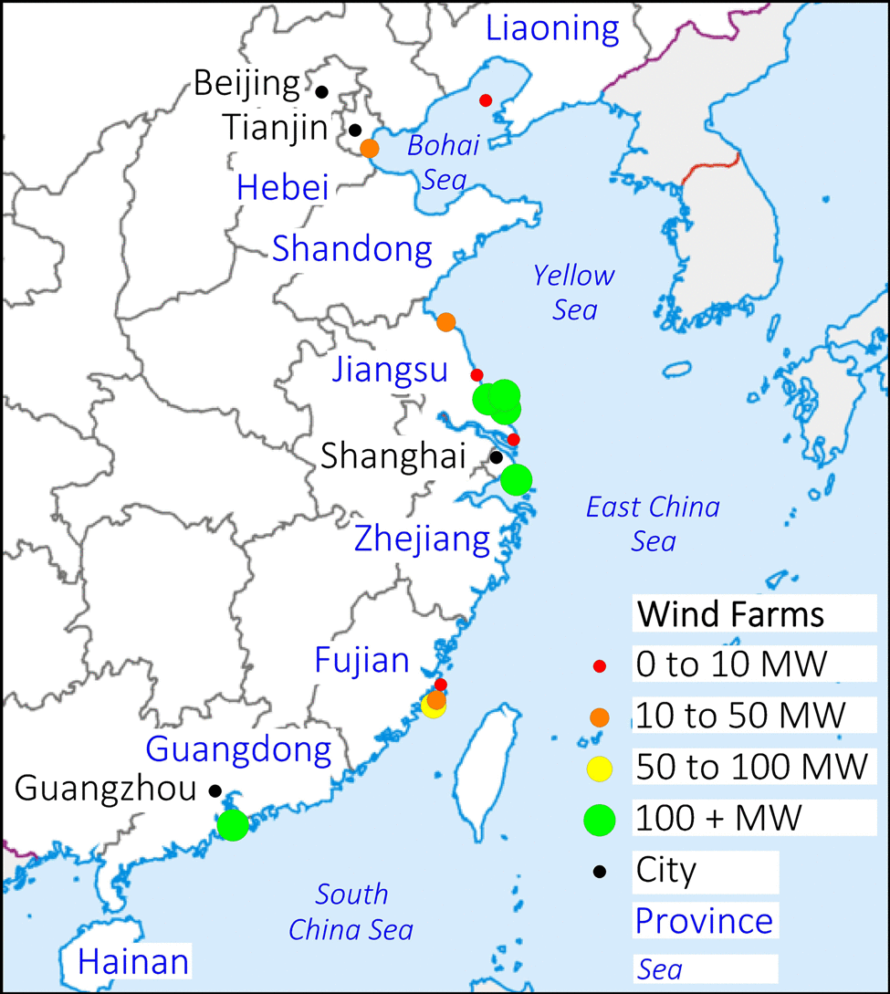

Fig 3: Offshore wind farms commissioned and under construction in China as of August 2015 [7]
Offshore wind projects installed and under construction
The first offshore wind turbine was installed in China in 2007 onto a disused offshore hydrocarbons platform. The first commercial offshore wind farm, the Donghai Bridge 102 MW wind farm, was installed in 2010 southeast of Shanghai. Installed cost of the wind farm was ¥23,000/kW, almost double the cost of UK Round 1 offshore wind [8]. The high cost is due to the use of available but expensive assets for the foundation construction and turbine installation [8]. A feed in tariff (export price + subsidy) of ¥0.978/kWh was agreed, nearly double the tariff paid to onshore wind farms in China [9]. The capacity factor for the Donghai Bridge wind farm was 25.3% in 2011 and 27.5% in 2012 [10].
Following the Dong Hai project, development has been concentrated in the Rudong area of the Jiangsu Province (see Fig 3), with a total capacity of over 250 MW installed by 2014 [11]. Despite not having the best wind resource, the area is out of the main typhoon path and consists of large areas of intertidal mudflats close to shore which enabled installation using existing construction equipment and vessels.
The China Longyuan Power Group Corporation (CLYPG) is the major developer of offshore wind in the Rudong area, having started with the Longyuan Rudong intertidal trial project. This project, which commenced in 2009, was unusual as it featured 11 types of turbines, and multiple types of foundation including gravity base, high-rise pile cap, and tripod type designs [11]. The project was used to allow the developers, turbine manufacturers, and installers to gain experience and test designs without committing to a full wind farm. Extension of the trial site began in 2013, again with a variety of turbines and foundations including 5 MW+ wind turbines.
CLYPG has continued development in the area. Following completion of the projects under construction in 2015, CLYPG's total capacity in the area is expected to be just under 500 MW. Further details on the CLYPG's Jiangsu Rudong intertidal demonstration wind farm can be found in the case study. CLYPG has also developed a 33 MW wind farm in intertidal waters close to Tianjin using 1.5 MW turbines supplied by Guodian United Power [11].
The Rudong area is also being developed by other companies, with over 200 MW currently being installed. Further developments are also planned, with projects moving further offshore out of the intertidal zone.
Two wind farms are currently under construction off the Fujian coast, the 16 MW Longyuan Putian Nanri Island phase 1, consisting of Siemens 4 MW geared turbines and the 50 MW Putian Pinghai Ba demonstration phase A, consisting of ten XEMC-Darwind 5 MW direct drive permanent magnet variable speed turbines. Both of these turbines are rated to International Electrotechnical Commission (IEC) Class I wind conditions [11].
The construction of the Zhuhai Guishan demonstration 200 MW wind farm has started off the coast of Guangdong. This will consist of a mixture of Guodian United Power and Mingyang wind turbines, all of 3 MW rating [11].
The current feed in tariff (export price + subsidy) is set at ¥0.75/kWh for intertidal sites and ¥0.85/kWh for nearshore sites, which many developers claim is too low and does not take into account regional variation in project costs [12]. The feed in tariff is still significantly higher than the tariff paid for electricity from thermal sources, which is around ¥0.36/kWh [13].

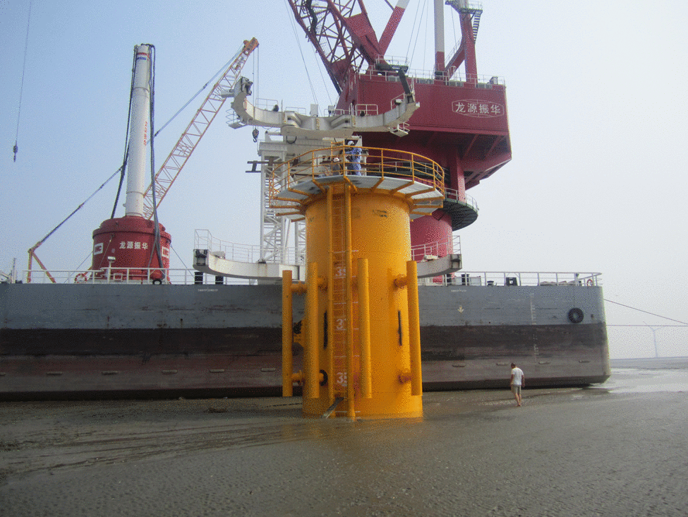

Transition pieces act as an interface between the turbine tower and foundation and are used to correct minor vertical misalignments of the pile via a grouted connection. Where monopiles have been used in China, they have typically integrated the foundation, transition piece, and secondary steel (Fig 4) rather than having a separate transition piece. The single piece foundation is well suited for use at intertidal sites and does not require specialist grouting equipment. The omission of a transition piece, however, requires the monopile to be installed with a smaller deviation from the vertical than would otherwise be required. Equipment and techniques to enable pile driving of a single piece foundation have been developed by Chinese firms such as Jiangsu Longyuan Zhenhua Marine Engineering Co. Ltd. using specialist equipment such as hydraulic piling hammers supplied by IHC Hydrohammer of the Netherlands. Piles have been installed to a high vertical tolerance, with deviations typically <0.1° from the vertical [23].
Fig 4: Single pile foundation installed at the Jiangsu Rudong intertidal wind farm. Anodes providing galvanic protection are attached to the pile below the mud line [IHC Hydrohammer]
Foundations located at intertidal locations are at high risk of corrosion due to the frequent exposure to both air and water and the effects of scour increase the likelihood of abrasion to protective coatings at the mudline. Parts of the pile which will be exposed above or close to the mudline are provided with galvanic protection by applying a thermally sprayed metal layer. Marine grade protective coatings are applied to the foundation and additional galvanic protection is provided by sacrificial zinc or aluminium anodes.

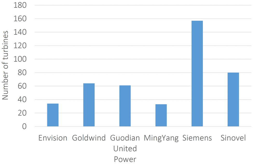

About 12 different turbine manufacturers have installed or are installing wind turbines offshore. The Chinese market is more diverse than Europe's, which is dominated by Siemens and Vestas. The number of turbines installed offshore by the six leading manufacturers is given in Fig 5. The Siemens/Shanghai Electric joint venture leads the market, having gained an early foothold with the installation of 21 turbines in 2011 (Fig 6).
Fig 5: Six manufacturers with the most number of wind turbines either installed or to be installed as part of projects for which construction had started as of August 2015 [11]

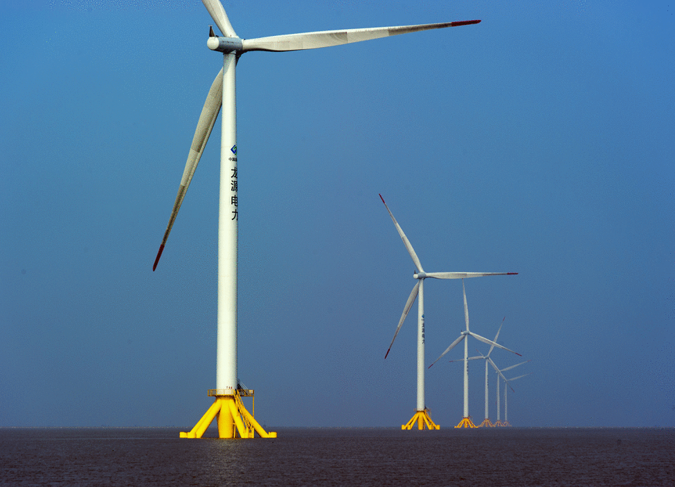

Fig 6: Siemens 2.3 MW wind turbines installed at the Jiangsu Rudong 150 MW intertidal demonstration wind farm [http://www.siemens.com/press]
The capacity of offshore wind turbines installed in China ranges from 1.5 to 6.0 MW, with most of the projects under construction in 2015 having turbines rated between 3.0 and 5.0 MW.

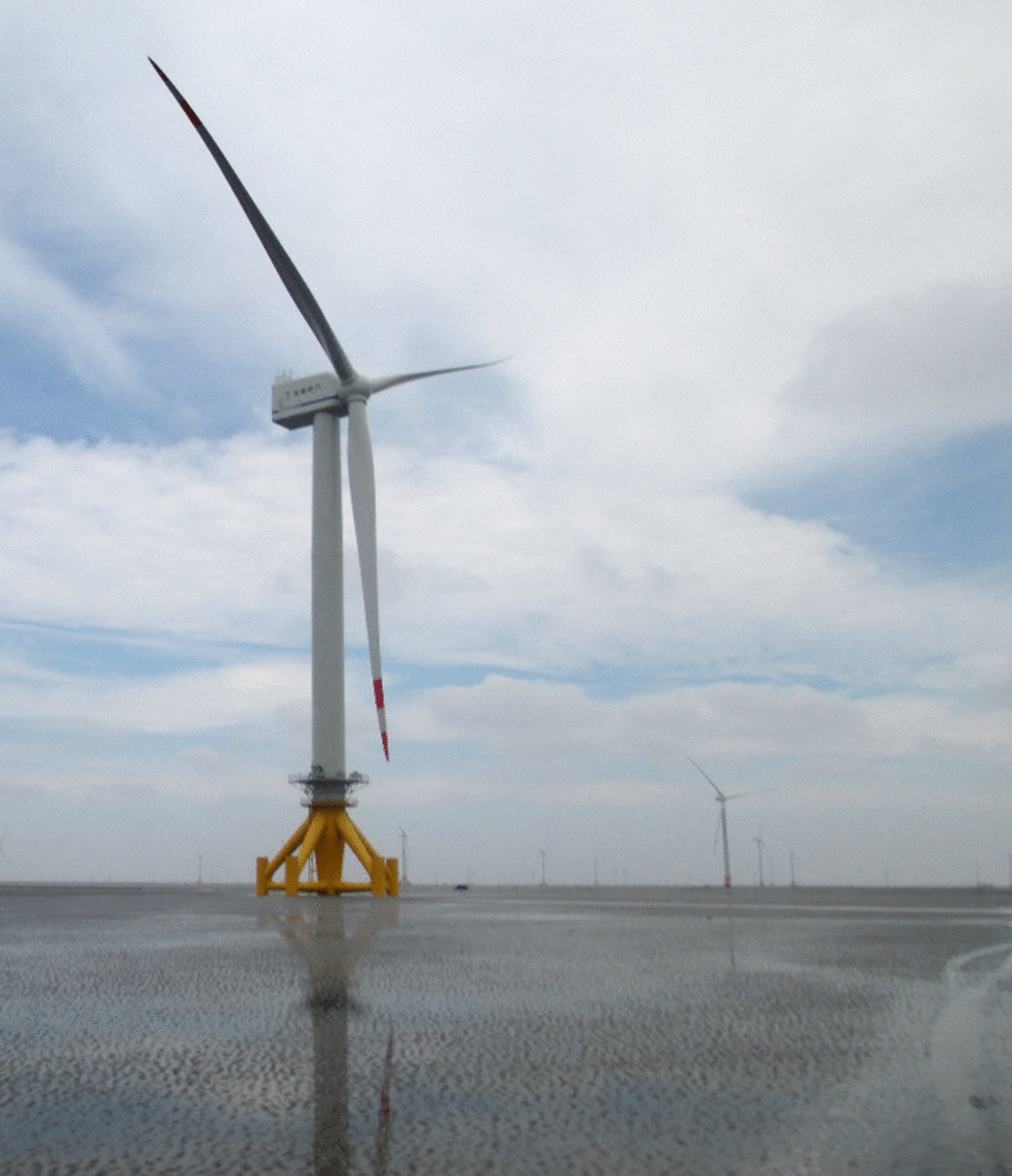

Fig 7: Dongfang 5.5 MW turbine installed at the extension to the Longyuan Rudong intertidal trial wind turbine test site. A tripod type foundation consisting of five piles was used [Orbital2]

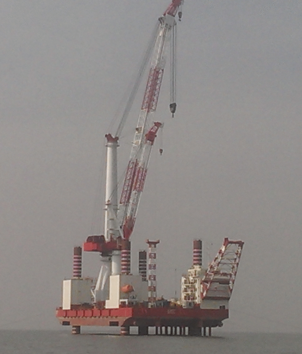

Vessels and installation
Projects in the intertidal zone have used flat bottomed crane barges for foundation and turbine installation. Foundations have been installed at low tide with the crane barge sat on the mud. The availability of these vessels has been a significant driver in the selection of intertidal sites, along with their proximity to the shore. The use of jack-up vessels is problematic at many of the sites in China due to the soft sea bed material; however, installations have recently been carried out using purpose built wind turbine installation jack-up vessels (Fig 8). One example of a purpose built jack-up vessel is the Longyuan Zhenhua II, operated by China Communications Construction Company Limited, fitted with a 725 tonne crane and able to operate in water depths up to 30 m [27]. Owing to the soft sea bed, the footprint of the jack-up legs is usually larger than those used in Europe [28].
Fig 8: Jack-up vessel operating at the Jiangsu Rudong wind farm in 2014 [IHC Hydrohammer]
The Donghai Bridge wind farm used an installation technique pioneered by the UK's Beatrice demonstration project: turbines were fully assembled onshore and a crane vessel was used to lift the turbines and transport them from the port out to the waiting foundations. The vessel used, Endeavour, is operated by China Communications Construction Company Limited and fitted with a shear leg crane with a total lifting capacity of 2300 tonnes.

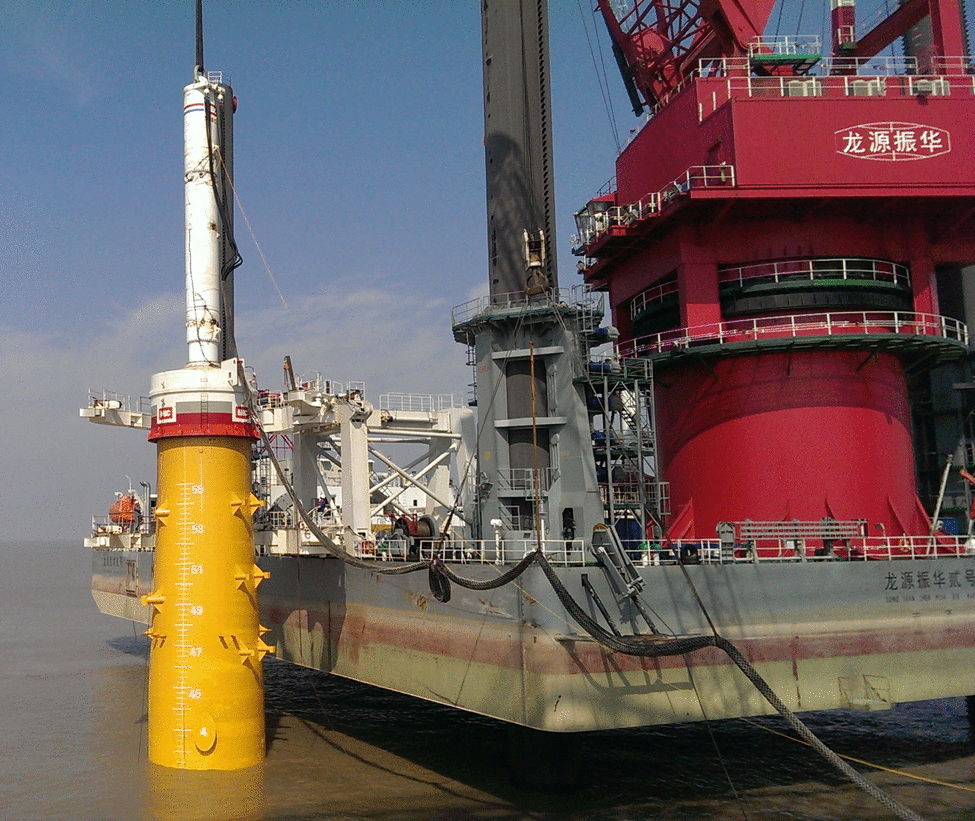

A 200 MW extension of the project was approved in 2013 by the NEA. Turbine installation began in late 2014, starting with 25 Envision 4 MW turbines, followed by 25 Siemens 4 MW turbines [11].
Following the trial of different foundation types in the initial demonstration phase, single or tripod type foundation types were selected for the commercial phases of the project. Before the start of phase I of the project, a dedicated flat bottomed crane barge was commissioned to enable installation of monopile foundations. Other vessels were adapted or commissioned for the wind industry including cable installation vessels, anchor handling boats, and transport vessels. The crane barge was used to install foundations during low tide for the first phases of the project [29]. A jack-up vessel fitted with an IHC Hydrohammer hydraulic pile hammer has been used on the 200 MW extension (Fig 9) [28].
Fig 9: Jack-up vessel installing monopiles at the 200 MW extension of the Jiangsu Rudong Offshore Wind Farm in 2014 [IHC Hydrohammer]
