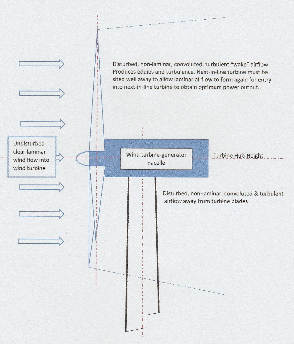

Wind turbines arranged in arrays have been found to form a cone shaped, turbulent, slower, downstream airflow to form a ‘wake’ thus, creating turbulence swirls and large eddies that adversely affect the performance of the next-in-line turbine … and so on down the line of turbines; turbulence persists no matter what the direction of the wind.
It has been found were the next-in-line turbine to be positioned too close to this turbulence, the output of the turbine would be significantly reduced and blade vibration damage would result.

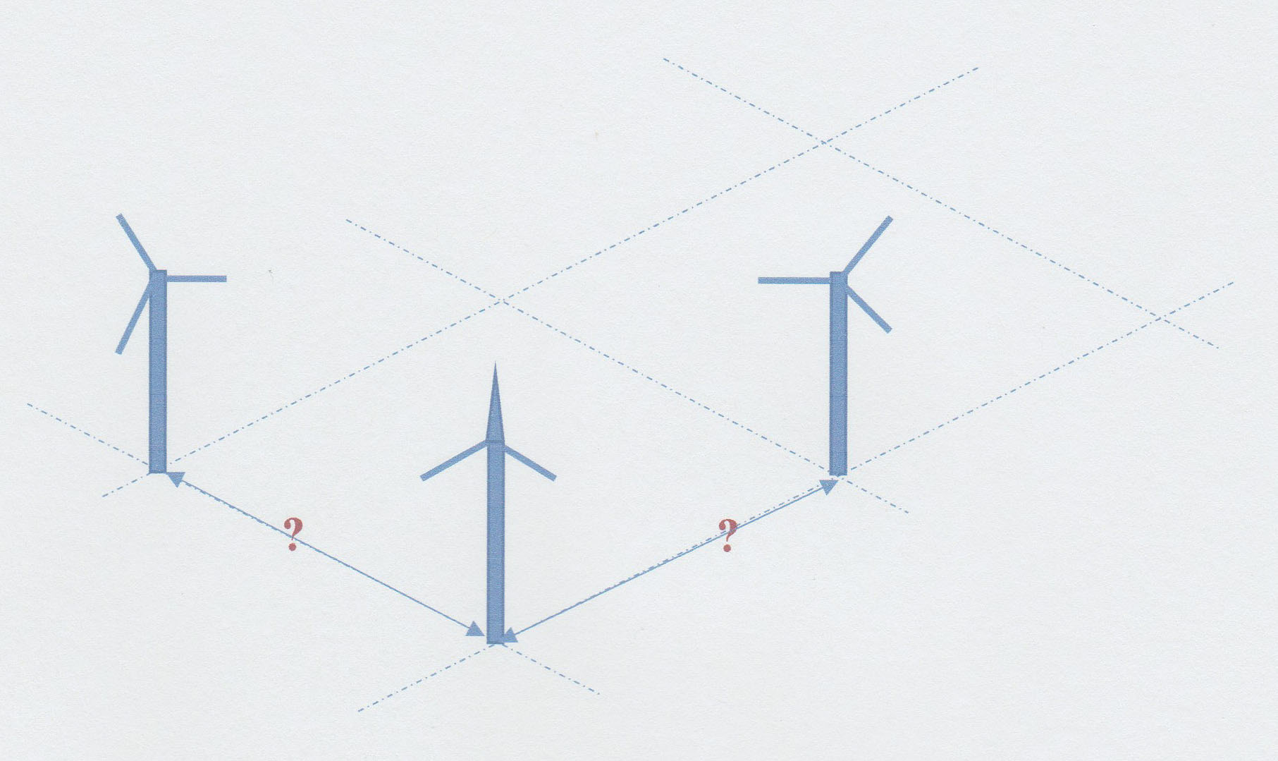

Windfarm developers and owners have thus sought to ‘optimise’ the spacing of wind turbines within arrays such that that the next-in-line turbine is spaced a sufficient distance away thereby allowing laminar airflow formation again - for entry into the next turbine. Optimal power output from all turbines within the windfarm array is obtained by this type of positioning design.
Fig 3 – Sketch indicating disturbed & turbulent airflow leaving wind turbine
Beautifully simplified industry favoured distances appear to be 4D to 5D (D = rotor diameter) across or abreast the array line and 6D to 7D in the downwind direction of the array. It should be noted this optimization also takes into account the commercial aspect of cable runs between towers and between towers and offshore sub-stations.  A further realisation would be the further apart the wind turbines, the less installed capacity and ultimately revenue earnings from a given project acreage.
Extensive computer studies have been undertaken to further quantify these various parameters to obtain project development costs. The results indicate the spacing of wind turbines in offshore arrays should be greater. In typical project trade-off circumstances, whilst cable lengths etc., increase, the electrical output of all wind turbines in the array now having more laminar, less turbulent inlet airflow increases generation output to a significant extent. A number of studies, depending on world location and specific details, suggest that a 15 to 30 per cent increase in turbine output can be expected [7] - thereby increasing the revenue stream considerably over the life of the project. Coincidentally, greater wind power output in the national energy-mix reduces emissions to assist national climate change targets.

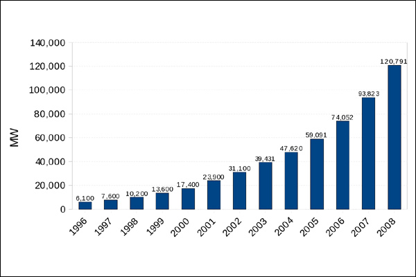

Growth in wind-turbine installed capacity. [8] – has increasing grown in the last decade.
Fig 4 – UK wind power annual MW capacity increases to year 2008.
Reference - Centrica Lincs offshore project. [8]

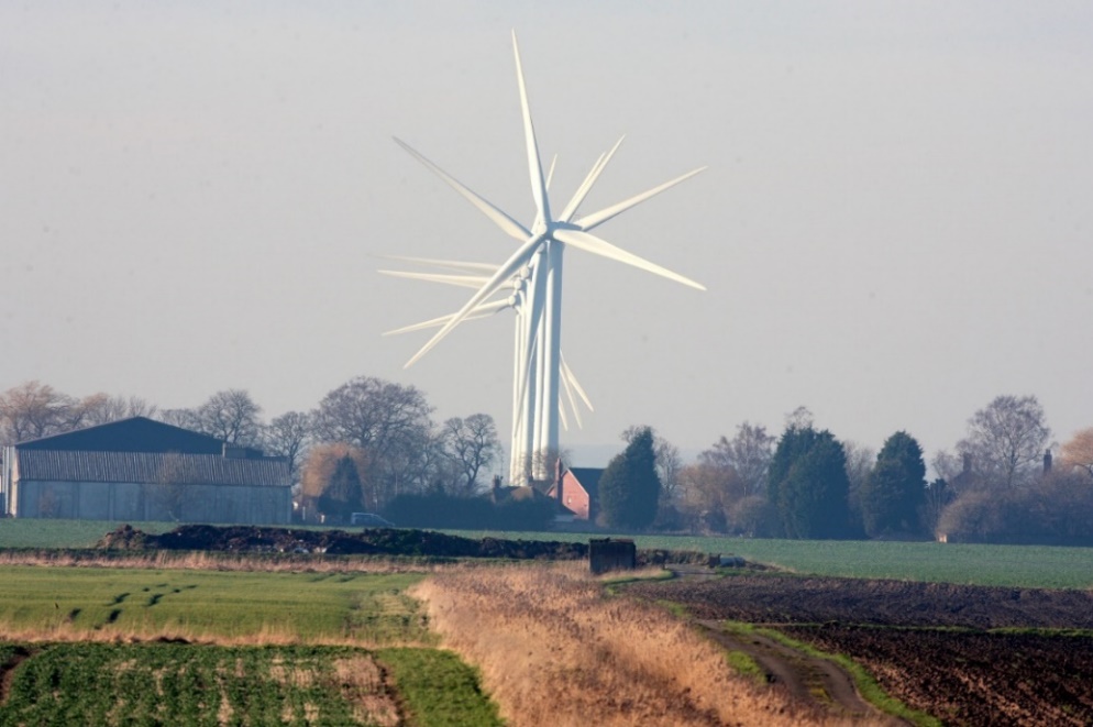

Onshore, the visual impact and noise perceptions were not just the pique of a few, how planning permission was given to projects like this - ‘on the other side of the road’ - to picturesque villages did nothing for understanding government renewable energy policy or the wind power industry at large. Check former Prime Minister David Cameron’s reaction. [9]
Fig 6 – Windfarm proximity (just the other side of the road) to scenic Lincolnshire village

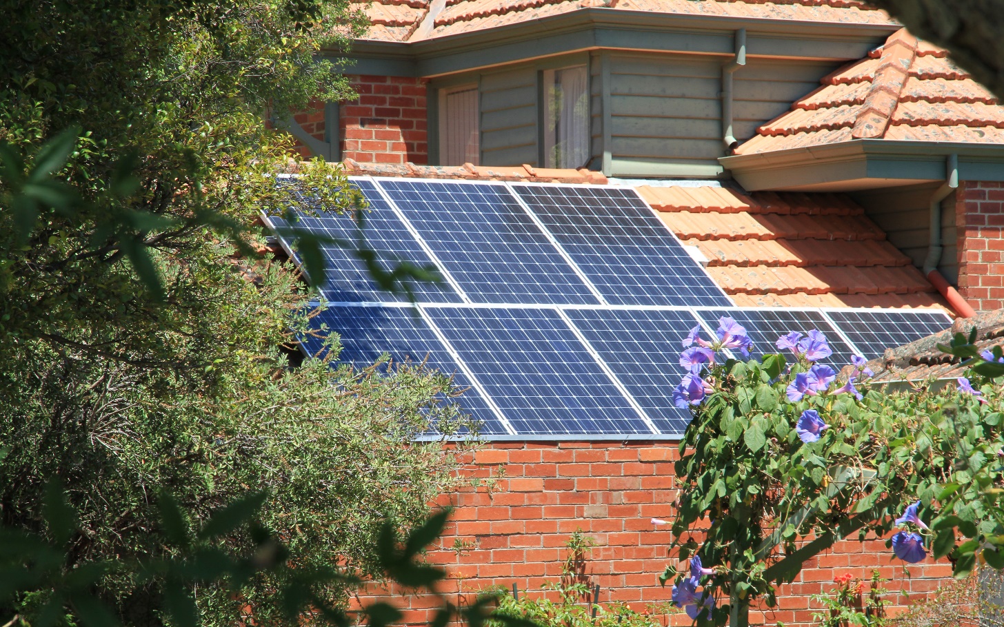

By contrast, the acceptability of solar voltaic and heating systems is virtually uncontested.
Fig 7 – Typical ‘unobtrusive’ household solar installation.
