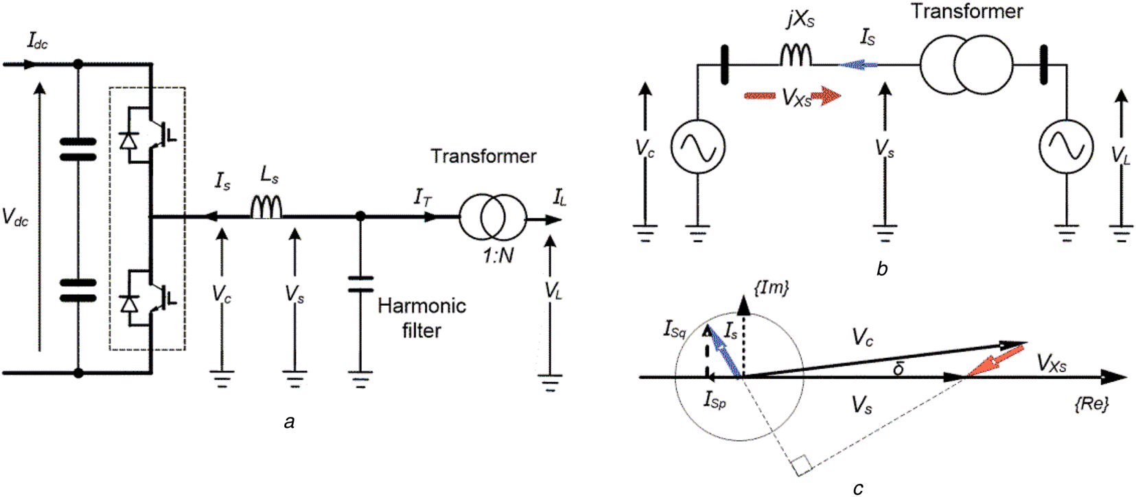

VSC technology provides the means by which a transmission level AC voltage can be synthesised from a HVDC supply. The fundamentals of VSC based HVDC transmission operation may be explained in simple terms by considering each terminal as shown in Fig 2 a. The equivalent circuit at fundamental frequency can be represented by considering a voltage source generated by the converter connected to the AC main via a three-phase reactor and power transformer as shown in Fig 2 b. Both the amplitude and the phase angle of the output fundamental voltage V c are controlled with respect to the voltage V s.
Fig 2: Basic VSC based HVDC Transmission
According to the fundamental frequency phasor diagram shown in Fig 2 c, the active and reactive power at the grid V s side can be expressed, respectively as
where δ is the phase angle between the V c and V s and X s is the reactance of the coupling inductor at fundamental frequency.
From (1), it can be seen that the active and reactive power are controlled independently through V csin δ and V ccos δ, respectively. As shown in Fig 2 c and (1), for active power flows
  • if V c phase-lags V s, active power P s (appears negative in (1)) flows from the AC to the DC side;
  • if V c phase-leads V s, the active power P s (appears positive in (1)) flows from the DC to the AC side.
For reactive power flows considering δ is usually very small (cosδ≃1)(cos⁡δ≃1)
  • if V c > V s, reactive power Q s in (1) appears positive referring to the converter providing capacitive reactive power to the AC network;
  • if V c < V s, reactive power Q s in (1) appears negative referring to the converter absorbing inductive reactive power from the AC network.

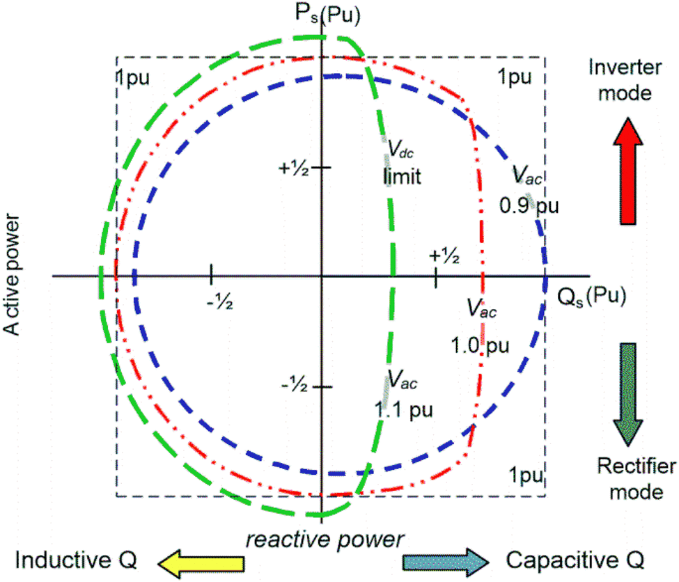

The typical P-Q diagram which is valid within the whole steady-state AC network voltage is shown in Fig 3. It illustrates the real power, P s and reactive power, Q s , capability of a VSC converter terminal, as a function of AC system voltage. Normally converters are sized based on the specific P-Q envelope, Q-V envelope and DC link voltage.
Fig 3: PQ diagram of VSC transmission
With the pulse width modulation (PWM) controlled VSC it is possible to create any phase angle and voltage amplitude (within limits set by the dc-link voltage magnitude) by changing the PWM modulation depth and the relative phase displacement, respectively. This allows independent control of the active and reactive power.

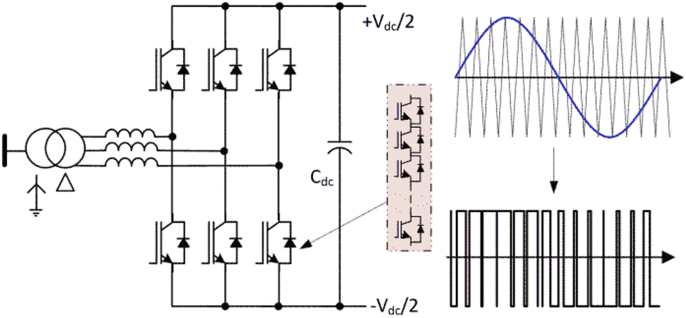

Fig 4 shows the circuit diagram for a two-level VSC of the type used in the early deployment of VSC based HVDC transmission systems. High voltage IGBT devices in the top and bottom of the converter leg allow the output to be switched between the positive (+½V dc) and negative (−½V dc) DC poles. The output voltage is thus made up of a series of rectangular pulses of controllable width as shown in Fig 4. By controlling the output pulse width, the converter output can generate a fundamental component with controllable frequency, phase and magnitude.
Fig 4: Two-level VSC circuit and waveforms
In addition to the controlled fundamental, the converter output voltage also contains significant switching frequency components. Power filters are therefore placed between the converter output and the AC network to prevent the injection of harmonic current into the AC network. The use of relatively high switching frequencies means that filter requirements are substantially reduced relative to thyristor based LCC HVDC systems.
To reach the operating voltages required for HVDC, high voltage switches within two-level converters must be implemented as a series combination of many low voltage devices, each of which must be operated such that voltage is shared evenly at all times. Dynamic voltage sharing during switching is particularly challenging by the speed of the IGBT devices where turn-off and turn-on times are in the order of a few microseconds. The need for a series of connected devices imposes a number of conflicting design compromises. Slowing the IGBT switching time can assist with dynamic voltage sharing but will tend to increase switching loss which in turn limits switching frequency. High switching frequency will allow PWM to achieve improved power quality and reduced filter size but will result in increased losses. Electromagnetic interference (EMI) is present in all power electronic systems and presents additional problems for two-level, high voltage VSC, where many devices must switch simultaneously. EMI may be controlled by slowing the switching times which will have a negative impact on switching loss and conversion efficiency.

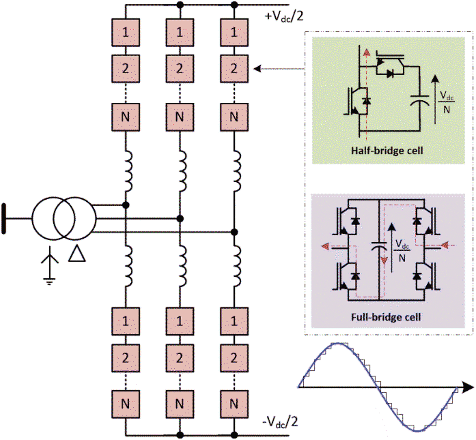

Fig 5 shows the circuit diagram and voltage waveform for the MMC converter. The MMC consists of a number of series connected cells which can be based on either half-bridge [6] or full-bridge circuits [7]. The capacitor of each cell supports a fraction of the total DC voltage and acts as a virtual voltage source that may be switched in and out of the series path according to the state of the cell switches. This allows the use of a stepped modulation scheme, as illustrated in Fig 5. This type of modulation requires cells to switch close to the fundamental frequency, resulting in very low switching loss. Practical MMC employs many cells and can achieve an output voltage that is a close approximation to a sine wave with low harmonic content. Additional power filters, other than the arm inductance, are not generally required.
Fig 5: MMC converter circuit and voltage waveforms
Unlike the DC link capacitor of a two-level converter the MMC cell capacitors contribute to the phase energy transfer between converter and AC grid and therefore experience energy oscillation at twice the AC network frequency. The cell capacitance must therefore be sized to ensure that the resulting voltage ripple is held to an acceptable level. The requirement to limit cell voltage ripple results in a total converter capacitance value in excess of that required by the two-level converter. However, the stepped modulation in Fig 5 shows that different cells are active at different points of the modulation cycle. The result of this is that the loading of cells is not equal. To avoid voltage unbalance between converter cells it is necessary to impose another layer of control which monitors cell voltage and manages the cell rotation such that their average energy transfer and voltage are equalised.
The main difference between cells using half-bridge and full-bridge circuits as shown in Fig 5 is in the behaviour during DC faults. As shown as the dashed red lines in Fig 5, during a DC fault and after the blocking of the IGBTs, AC fault current continues feeding the DC fault points through the diodes of the half-bridge cells. However, for full-bridge cells, the cell capacitor voltages act as an opposing voltage to block any AC fault current from flowing to the DC fault points, in the expense of extra semi-conductor devices and increase power losses during normal operation. Further details on DC fault will be discussed in DC Fault Response.

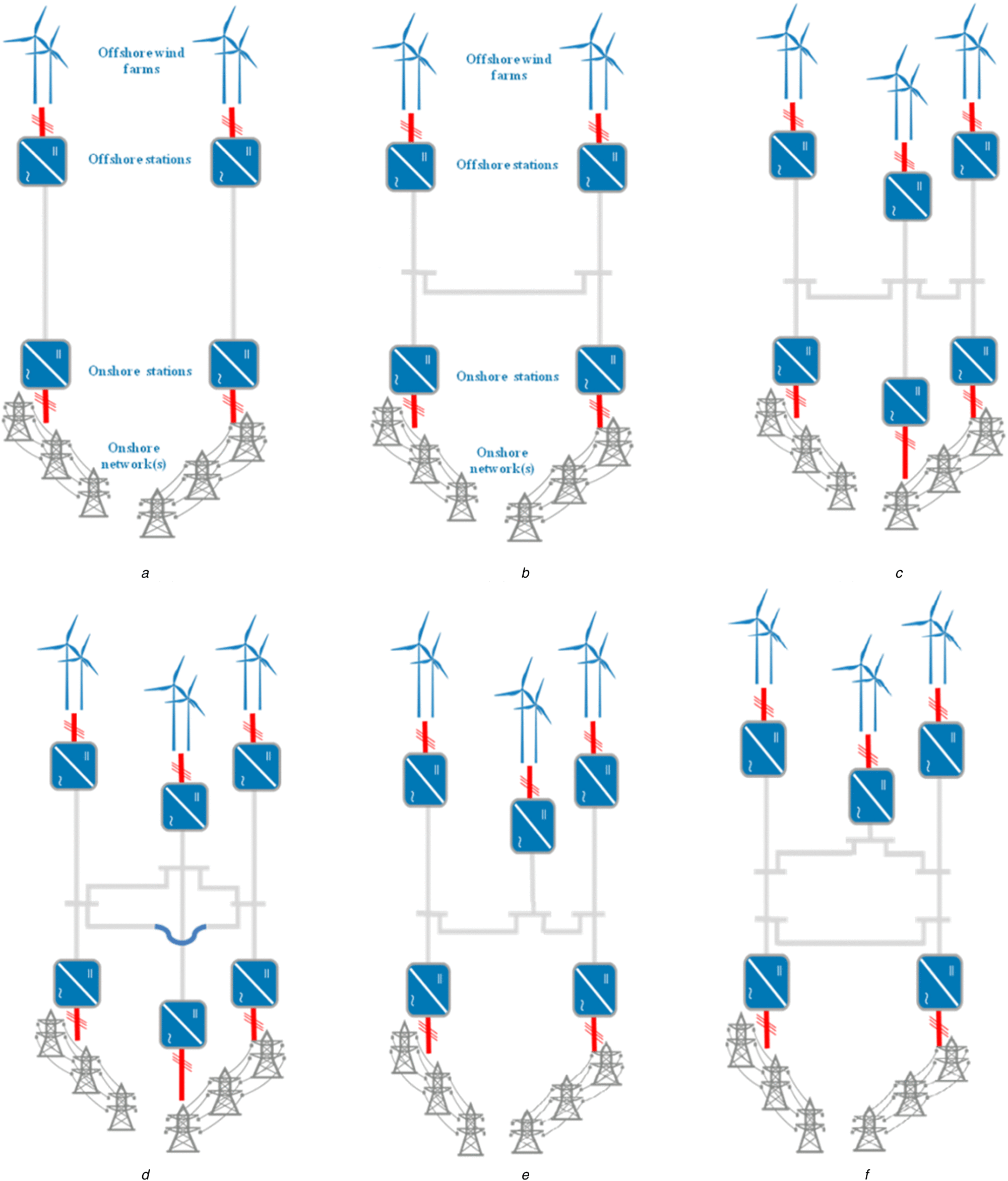

MTDC systems are likely to be developed and built up gradually, either starting from existing point-to-point DC connections linked together via a DC tie, or via different project phases (as planned for the Atlantic Wind Connection project in [9]). A consequence of this process is that the wide variety of layouts in which a MTDC network may result, because of various possible topological extensions and the different development policies. As an illustration for the latter, national codes may differ with respect to the capacity requirements to connect offshore wind farms (fully rated or not, for instance), thus resulting in possible wind spillage and finally, different MTDC requirements and layouts.
Several kinds of MTDC configurations, either tree-like or meshed ones, have to be considered even for a limited number of converters. This is depicted in Fig 6, which illustrates a simple scenario. A simple MTDC shown in Fig 6 b is resulted from linking two point-to-point connections shown in Fig 6 a with a DC tie. More complex layouts could be designed at this stage, and Fig 6 b is the simplest tree-like backbone grid, also referred to as the ‘H’ grid. Assuming the connection of a third wind farm to the ‘H’ grid, a number of different layouts may appear, as shown in Figs 6 cf. The two layouts shown in Figs 6 c and d are fully rated (that is, with a supplementary point-to-point connection which prevents wind spillage) backbone topologies, either tree-like or meshed. On contrary the ones shown in Figs 6 e and f take advantage of the existing assets to connect the new wind farm without developing new transmission capacity for the MTDC system, assuming wind spillage is allowed.
Fig 6: Simple MTDC layouts, starting from a simple ‘H’ grid, to possible extensions for connecting a new wind farm to the existing grid
a Two point-to-point connections
b A simple ‘H’ grid
c Fully-rated extension of the ‘H’ grid: tree-like backbone
d Fully-rated extension of the ‘H’ grid: meshed backbone
e ‘H’ grid extension to connect a new wind farm with possible wind spillage: tree-like
f ‘H’ grid extension to connect a new wind farm with possible wind spillage: meshed

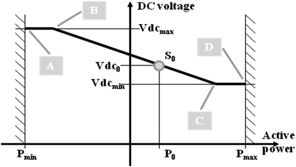

As for point-to-point connections where one converter controls the DC voltage while active power is managed on the other end, there should be at least one converter station to set the DC voltage reference for a MTDC network. As described in [10], this task can only be allocated to onshore converters, as the offshore ones must control the island frequency and voltage of the offshore wind farms. For security reasons, it is commonly recognised that several converters should be responsible for controlling the DC voltage.
Control during normal operation
A simple and robust way to control the power share of the converters responsible for the DC voltage (and the amount of active power they transmit to the AC networks) is the use of voltage droop control [11], in which active power injections are adjusted by changing DC voltage set points according to linear characteristics between points B and C as shown in Fig 7.
Fig 7: DC voltage droop control including active power and voltage limits
The voltage droop characteristic between points B and C in Fig 7 can be interpreted as follows: intermittent offshore power injections (from offshore wind farms) lead to DC voltage variations. Considering one single onshore converter in charge of the DC voltage control, a voltage falling from V dc0to V dc, (that is: a decrease in offshore active power injected into the DC network) should be compensated by injecting less active power to the onshore AC network (and vice versa in case of an increase of DC voltage). Hence, multiple parallel onshore converters with the same droop characteristic can respond to the fall in DC voltage by decreasing their active power outputs simultaneously. Such decrease will counteract the reduction in DC voltage and the converters will settle the active power outputs and DC voltage at a steady-state point on the droop characteristic. The droop characteristic therefore allows multiple stations to share power using local measurements only, in an autonomous manner without communication.
In addition, the droop characteristics may be complemented to take into account the DC voltage limits and the power limits of the converter (see portions A-B and C-D in Fig. 7). Finally, constant power (or voltage) reference may be desired for some converters, while ensuring their support in case of large DC voltage variations; this feature is provided by combining droop control with some fixed point characteristics as shown in Fig 8.
Fig 8: DC voltage droop control combined with fixed voltage (left) or power (right)
In a MTDC system connecting offshore wind farms, onshore converters are usually the only ones to actively control power flows, via the DC voltage and power droops mentioned above. As they represent a limited number of control variables in the overall system, the ratio between onshore and offshore converters and the meshing of the grid have an influence on the capability to control power flows either for all the branches of the grid, or for some only. This capability, or the lack of it, is hereafter referred to as ‘full’ or ‘partial’ power flow control.
As demonstrated in [12], backbone topologies (including the ‘H’ grid) depicted in Fig. 6 are fully controllable with respect to power flow. Topologies where power flow can only be partially controlled require more stringent needs with respect to a MTDC master control, in order to prevent the grid from any overcurrent or overvoltage. Alternatively, new equipments [13] connected to some branches are proposed to provide additional flexibility on the overall power flow. Those devices can be controlled to modulate the branches resistance, thus shifting power towards the preferred path. As illustrated in [12], a coordinated control of onshore converters (using the droop control) with those devices can lead to significant savings in offshore wind spillage.

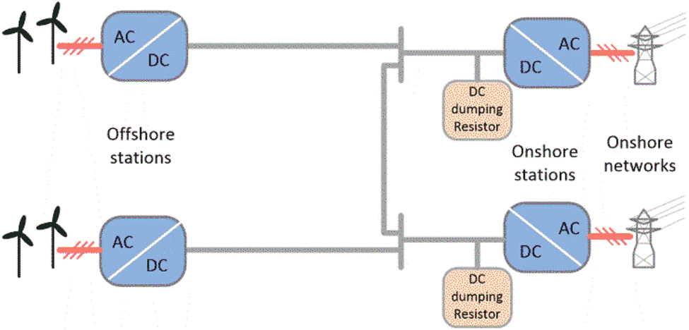

For the purpose of active power balancing during potential DC over voltage caused by onshore AC faults, a number of strategies may be employed [3]
  • Fast wind farm output power reduction. This can be achieved by using either fast telecommunication between the offshore converters and the wind turbines [14] or offshore wind farm network AC voltage and/or frequency modulation [15]. In the later case, the offshore AC system voltage and/or frequency is rapidly changed using the offshore HVDC converter when DC overvoltage is detected. Active power from the wind turbines which are specially designed to response to fast AC voltage and frequency variation is then automatically reduced. For such schemes, their reliability can be the main problem.
  • DC dumping resistors on the onshore converters. DC dumping resistors are place on the DC side of each (or selected) onshore converter and they are switched in during DC overvoltage. Thus the wind farms and offshore converters can operate as normal during the fault period with no disruption [16]. However, this method incurs extra hardware cost.
Fig 9 shows an example of using DC dumping resistors on two of the onshore converter DC terminals for dumping excessive power when the onshore converters cannot maintain DC voltage control because of faults on the onshore AC networks.
Fig 9: Example of using DC dumping resistors on onshore converter terminals for a 4-terminal MTDC system

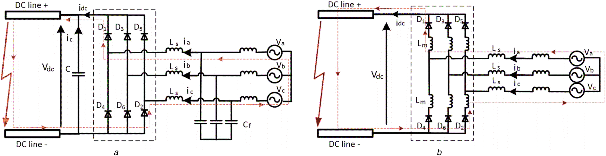

DC faults on VSC based HVDC systems can generate large over-current and rapid collapse of DC voltages because of the discharge of the capacitors on the DC link. This also results in a large increase in AC side current fed to the site of the DC fault because of the presence of freewheeling diodes within each converter branch. Figs 10 a and b show the one-terminal equivalent circuits after the blocking of the converters (IGBTs are switched off) during a DC line-to-line fault for two-level based and MMC (half-bridge) based HVDC systems, respectively.
Fig 10: Equivalent circuit during a DC line-to-line fault after the blocking of the converters
a Two-level converter
b MMC converter using half-bridge cells

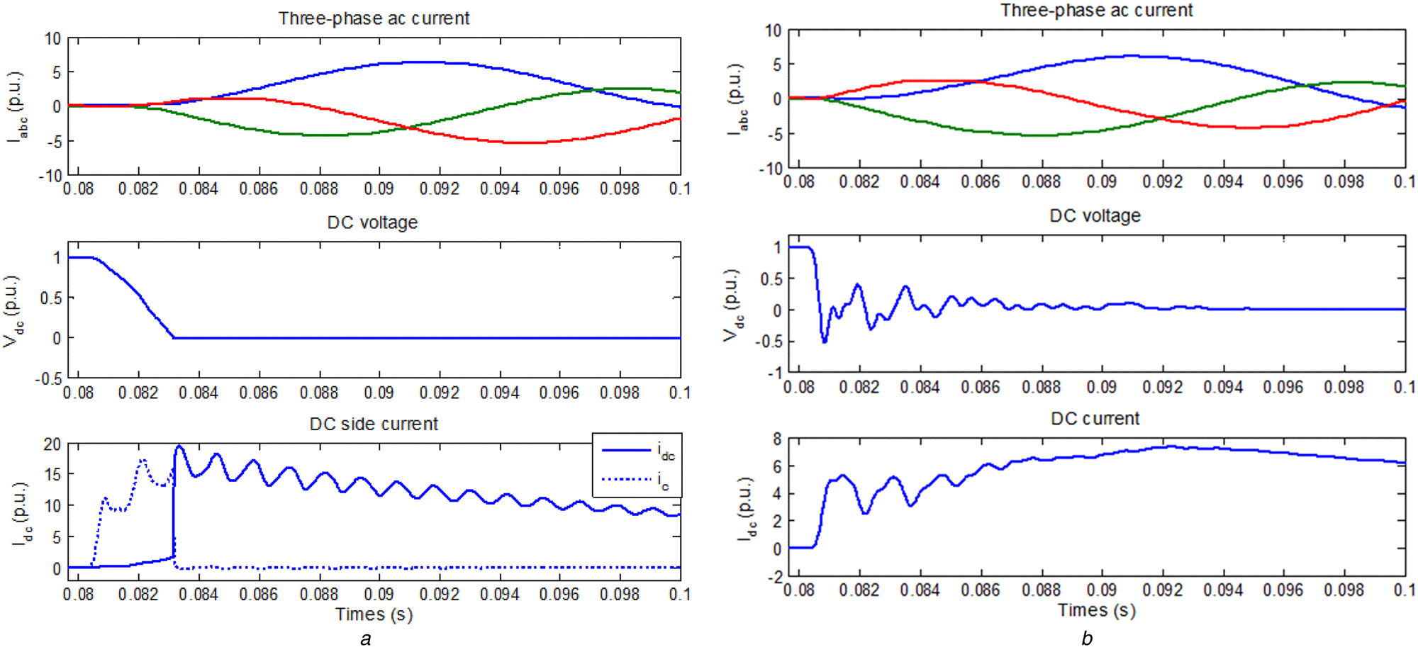

Figs 11 a and b show simulation results during a DC line-to-line fault for two-level based and MMC based point-to-point HVDC systems, respectively. Both schemes are rated at 1000 MW at ±400 kV. The DC cable length is 80 km and the fault occurs 40 km from both terminals. In the simulation, the faults occur at 0.08 s and prior to the faults both converters are operated at zero power. As can be seen from Fig 11 a, when the fault occurs, the DC capacitor on the converter terminal discharge quickly and consequently the DC voltage drops to zero within 3 ms in this case. This results in the increase of AC and DC fault current. The high capacitor discharging current i c is transferred to the converter diodes when the DC voltage becomes zero resulting in a large ‘jump’ of the DC fault current i dc at 0.083 s as seen in Fig 11 a. For MMC based system shown in Fig 11 b, the DC voltage collapses to zero in <1 ms because of the small DC capacitance (the MMC cell capacitors are bypassed after the blocking of the converters). Its maximum DC fault current is significantly lower compared with the two-level converter because of presence of the arm inductors and the absence of large DC capacitor discharging current. The presence of the arm inductors also results in considerable oscillations in the DC voltage as can be seen from Fig 11 b. For either configuration, the converter diodes need to be protected from such large fault current though the situation in two-level converter is much severe. In addition, the collapse of the DC voltage results in the complete loss of power transmission and adequate system recovery process needs to be designed to ensure a speedy ramp up of power transmission. The use of reverse blocking MMC based on full-bridge cells as shown in Fig 5 will eliminate any AC fault current though it does not prevent the collapse of the DC voltage.
Fig 11: Simulation results of a two-terminal HVDC system during a DC line-to-line fault on the middle of the DC cables
a Two-level converter based
b MMC based using half-bridge cells
The impact of faults on meshed MTDC networks will be severe, as the DC voltage across the entire system is likely to collapse within a few milliseconds because of the low DC network impedance. Consequently, a complete loss of power transmission capability, affecting both onshore AC networks and offshore wind farms, may be experienced during, and potentially after, faults. It might be expected that DC circuit breaker (DCCB) will be required to operate to ensure that single fault event neither causes disconnection of demand nor an excessive ‘loss of infeed’. To gain the benefits of DCCB in terms of allowing operation of un-faulted DC grid branches to ride-though faults on other branches, extremely fast fault detection and isolation (e.g. <5 ms) is required to minimise the currents interrupted by the DCCBs. However, the DC voltage across the entire system is likely to be severely affected and coordinated re-energisation of the entirely DC network would still be required prior to restoring power transmission.
